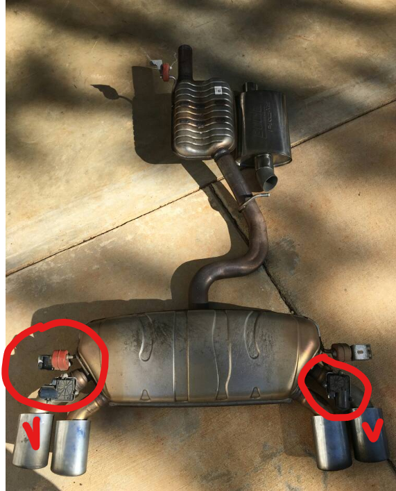

CUPRA models don’t have valved exhausts.
A number of commentators have mentioned that the R does have exhaust valves. In fact I am sure I have seen it in the Seat documentation. It is like the Porsche system.
The Golf R hatchback and S3 have exhaust valves...
...the Cupra Carbon Edition and Cupra R ST that all have the Golf R Estate based system, don't have valves...

About right ish, dont forget twin GPF'S on front of Cupra R ST, no mid box delete available, just GPF back or Full system, GPF delete Milltek Full system etc...
Absolutely nothing wrong with what I posted :p The Carbon has the Golf R Estate system without valves, the Cupra R ST has a Golf R Estate system without valves. Wasn't over complicating it by getting into the whole GPF cars not having the mid resonator as I was replying about whether they had valves or not.
For the sake of clarity: GPF based Golf R Estate/Cupra R ST system, still no valves:
The white does look a bit naff. The black would be nice. Through Europe there were originally 4 colours available, all left hand drive. Only the darkness grey was available in the UK. I notice that the example doesn't have that little ABT on the rear left hand side and is second hand, and is more expensive than mine, unregistered!!!!
On the valve issue.... then why is the exhaust tone completely different in Cupra?..... are they over feeding fuel in order to get the snarl noise? It is a party piece of the car to switch modes and listen to the change in the exhaust noise, right from tickover through to overrun.
For the UK the first ones only came in Blackness Grey, if you wanted the other colours you had to wait. Not sure why Seat UK did that, but you could always have the other colours if you were willing to wait. But UK didn't get the matt grey I think (same with 5 door).
Unlike the Cupra R 5 door, the Carbon Cupra R ST is not a limited edition, just a different model you can order. That's why you don't get a No XXX of XXX on your internal trim. However like the Carbon, Seat UK only decided only to bring a set number into the UK to give it some kind of exclusivity. For the carbon it was officially 50, although some say only 42 actually came across in the end.
As for the price on the white one, who knows?!
As for the valve. You have a soundactuator and change to fueling. Soundactuator is a speaker like device in the engine bay that makes the car sound louder (turned mine off). The fuelling is more to improve throttle response when the gearbox in sport mode. So that's why you get off throttle pops and bangs (depending on how loud your exhaust is/isn't).
So yeah no valves.
