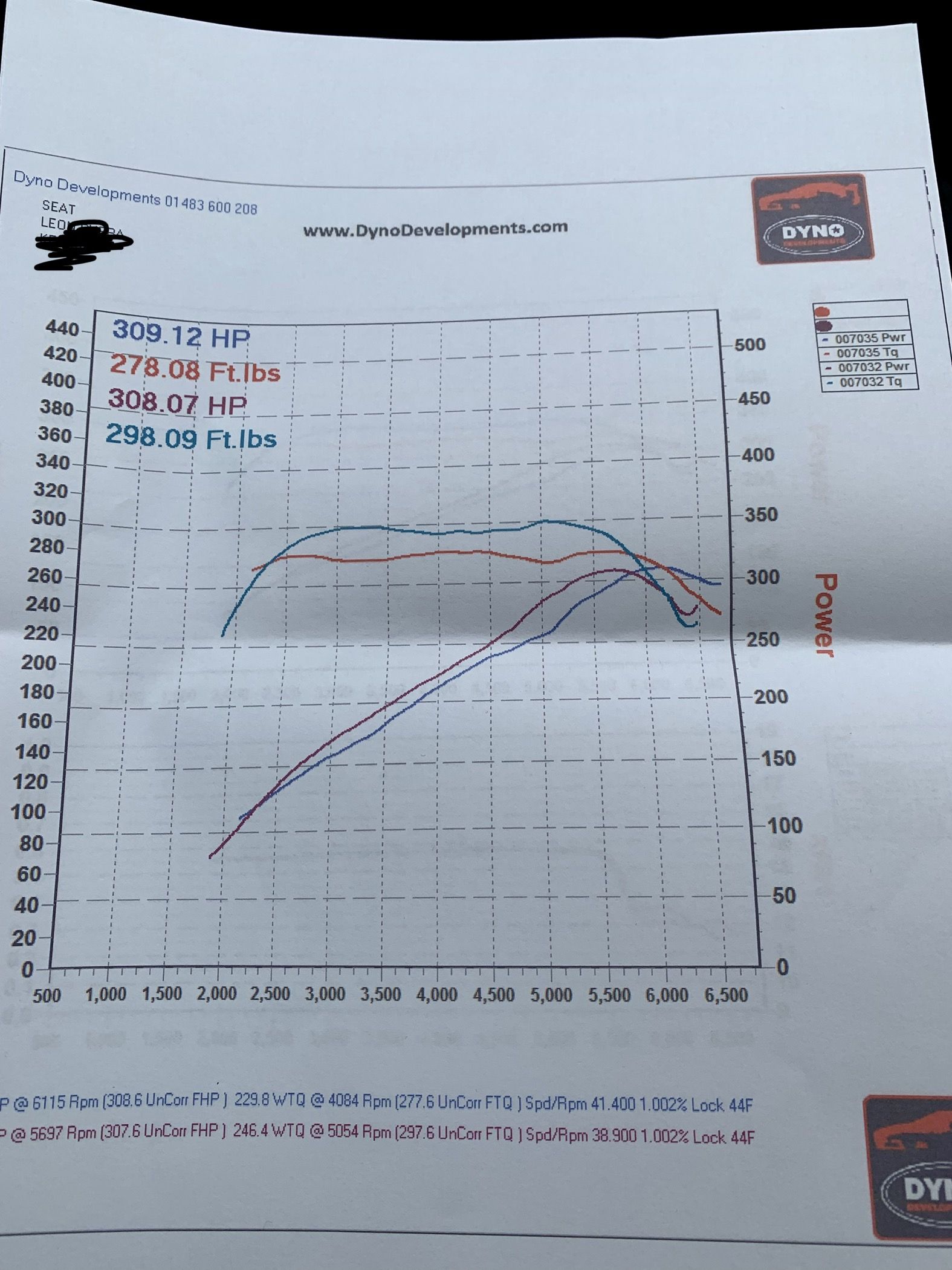

I went away and thought I’d get the car dynoed to see what it was actually putting out. I’ve taken the car to two places and it put out between 306-309 at both. Obviously well down on what’s claimed. (I only run it on a min of 98ron).
I complained to both ABT and seat UK, they looked at my car and said that the kit was fitted properly and when hooked up to the diagnostic equipment was told it was functioning fine. It was explained to me that the ABT kit is standalone from The cars ECU and if it thinks it’s too hot it will cut the power to stock. It is a lot more sensitive than the cars heat sensor. I was told that the car would only show putting out the claimed power if it was put on ABTs rolling road in Germany because it’s temperature controlled. This is why after around half a lap the kit would stop working and car would only put out stock power.

One point. The figures you saw on that dyno bear no relation to ABT's figures on their dyno. Correct me if I'm wrong, but SEAT and ABT are quoting engine HP.
I would also expect that a factory approved upgrade would have more conservative safety margins in their settings than aftermarket suppliers.
Which is why SEAT will not cover a non approved Remap.

The dyno calculates the BHP after measuring WHP and then some weird thing it does on the slow down. Not saying its accurate, always better to compare cars against other cars on the same day.

As per the last comment it’s not whp. As a comparison one of the garages had a stock 2018 S3 in the day before and they showed me the print out and it was nearly the same as mine. I knew that it was going to be a conservative map when I brought the car it’s the fact it doesn’t work at all in certain situations that annoyed me.
Yes, inertial dynos. But they are subject to forces that a proper engine dyno isn't, tyre slippage, alignment of the car on the rollers, etc.
Hub dynos are a bit better in that regard.

I only put the post up to make people aware of the issues I was having in case others were having the same. I’m not having a dig at anyone just stating facts.
Here’s one of the dyno print outs people can make what they want of it
