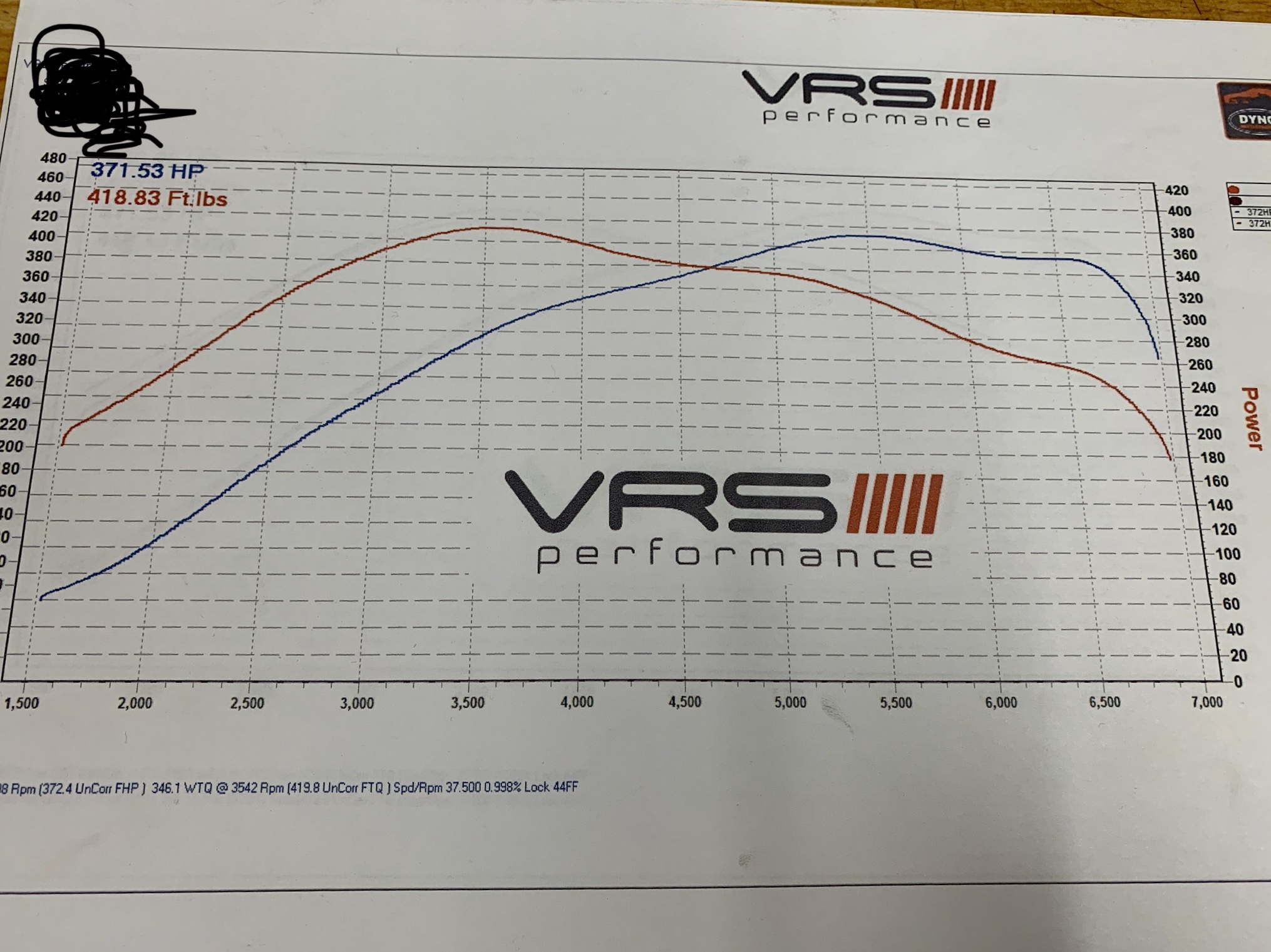

***update***
So had the ABT kit taken off, and dynoed with nothing else on put out 296bhp with 280ftlb so the kit was actually doing something just not much.
Then had my car re mapped APR stage 1 with the DSG map, turbo intake and sports filter.
feels like a completely different car
***update***
What bhp did you get?
@Jenko which turbo intake and sports filter did you fit if you don't mind me asking?
Turbo technics intake and a BMC filter. I was seriously considering getting the R600 but think the mrs would have shot me.
It had a dyno run with just the map and it put out 356.22hp and 409.59ftlb so with the filter and intake it added 15.3 bhp and 9.24ftlb. Not bad at all.
Reactions: Slickric21 and Zer0
Wow this is a phenomenal result @Jenko
I knew I’d be jealous... but holy s**t.....that torque 566nm :clap:.
Also nice to see the TT intake/pipe and air filter making such a difference and getting it quantified.
I hope my MST elbow/pipe and AfE filter are giving me a similar boost !!
My next step is in intercooler and then I may enquire if anyone can do a TCU tune to compliment the (pretty weak it now seems) ABT to see if some more torque can be unlocked.
Wow yeah quite a difference with the intake and filter, think at least the intake is one of my first mods :)
So what about the dreaded GPF issue that ABT says restricts power.... not a problem so it seems.
