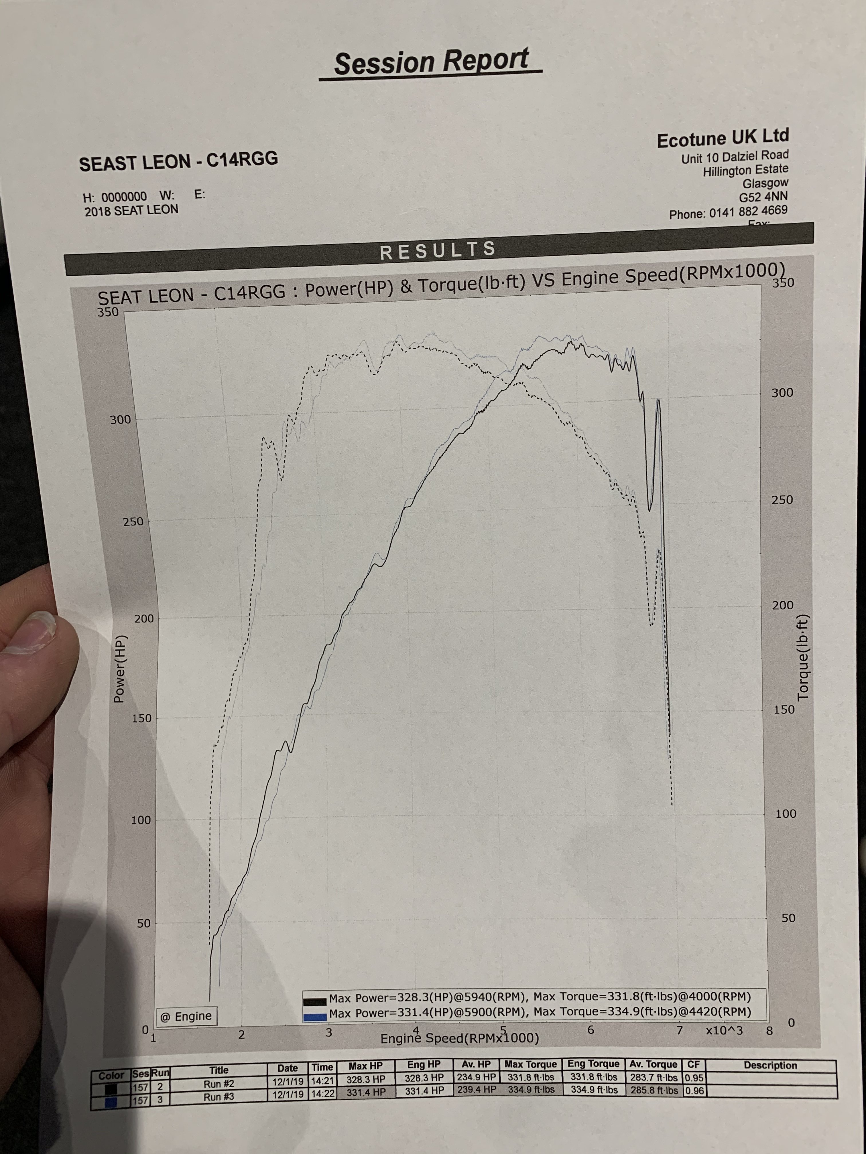

One thing I have taken heart with is the recent dyno results I mentioned the other week on the Facebook Cupra group where an ABT R ST was dyno’d at Ecotune Scotland at 331bhp.
This dyno was running a negative 4% correction apparently due to cold ambient temps....... 331hp plus 4% is........344hp....... pretty much bang on what ABT claim ?
I have also seen the MAHA dyno ABT use (on a YouTube video) for testing and it comes with a special fan that delivers wind/air into the front of the car with the same force of actually driving at 120mph, can’t remember the volume of air but it sounded impressive lol

Hi guys bit late on jumping Into this post. I was my car that was dyno at ecotune and made 331bhp with the ABT, the car also had MST intake and elbow along with Forge carbon intake.
It is a bit of a shame the ABT don’t seam to be quite what they where advertised as. They make a little difference to the car but it seams that potentially when pushing the car (and you want all its power) and if it gets a little hot you are basically back to a standard car. Makes you think what’s the point. I do hope to get the car RR again and see if it’s the same under different weather conditions.

That makes much more sense now I know what mods you had done already. Just a turbo intake and sports filter made 15bhp difference on mine. So the kit alone is probably giveing you somewhere around the 10bhp and 15ftlb it was giving my car. (When it worked) be interesting to see if you disconnected the ABT kit for a run what your car would put out.

that would be interesting to see if unplugging the box would make much of a difference. And would that affect the box in anyway (unplugging then plugging back in) i know the box is supposed to be ECU specific and can’t be swapped between cars.
Apparently not, when they were looking at my car they unplugged it and put it back in a couple of times. It’s just a piggy back system so no reason why it should have any adverse effect.
I think there’s a couple of different ECUs they use, I remember them saying something about the one in mine being the same as used in a clubsport.
