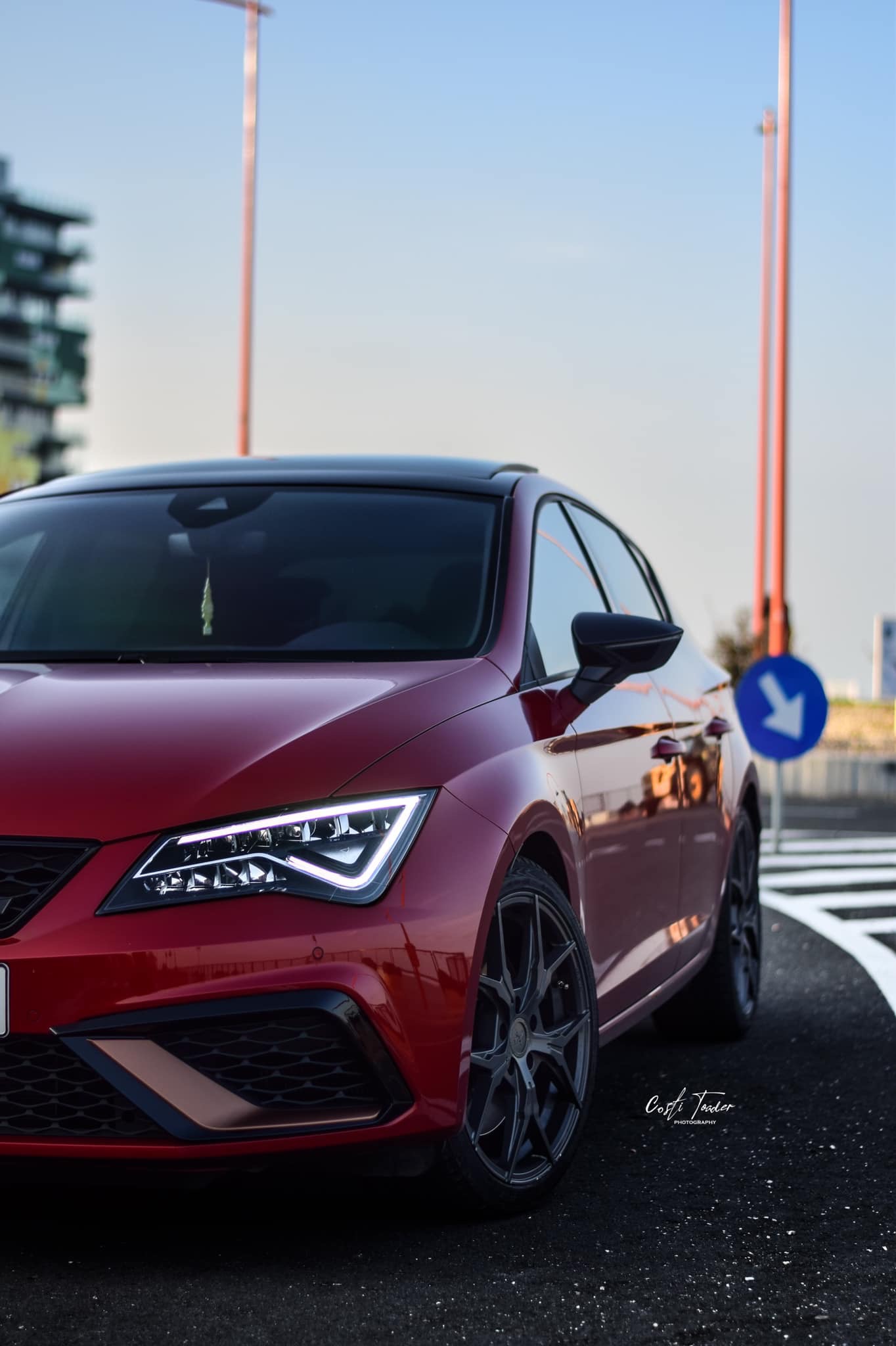

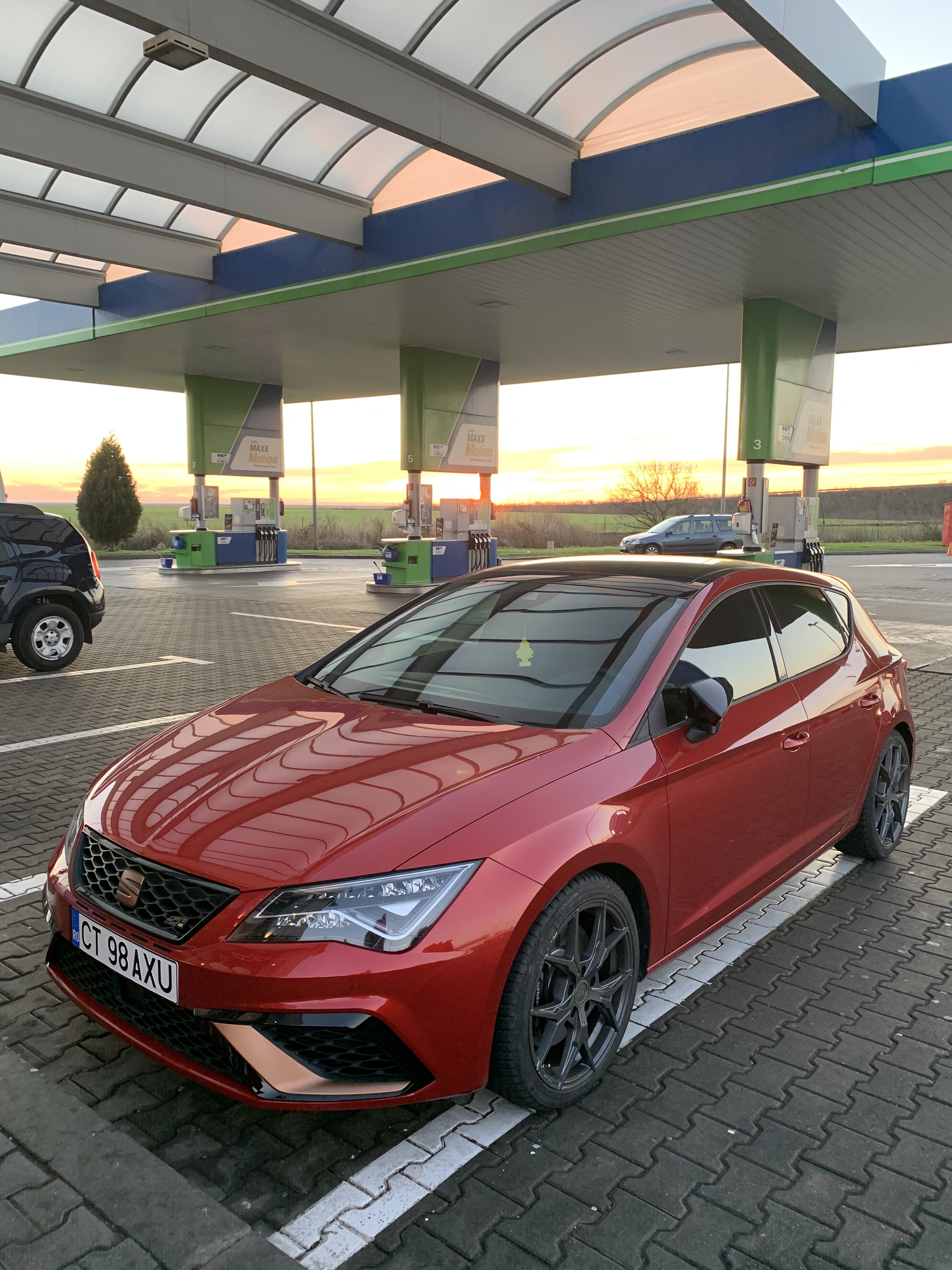

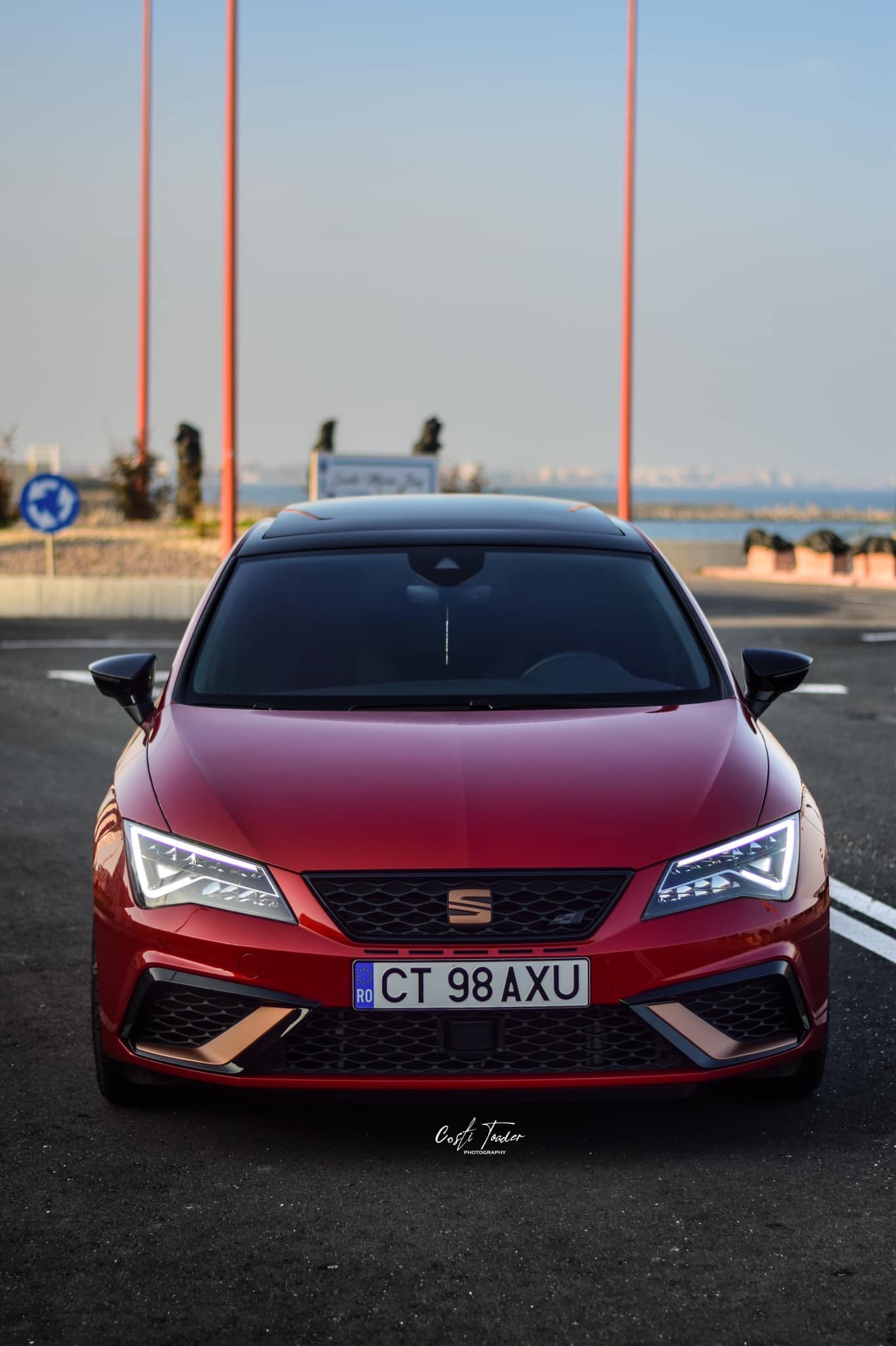

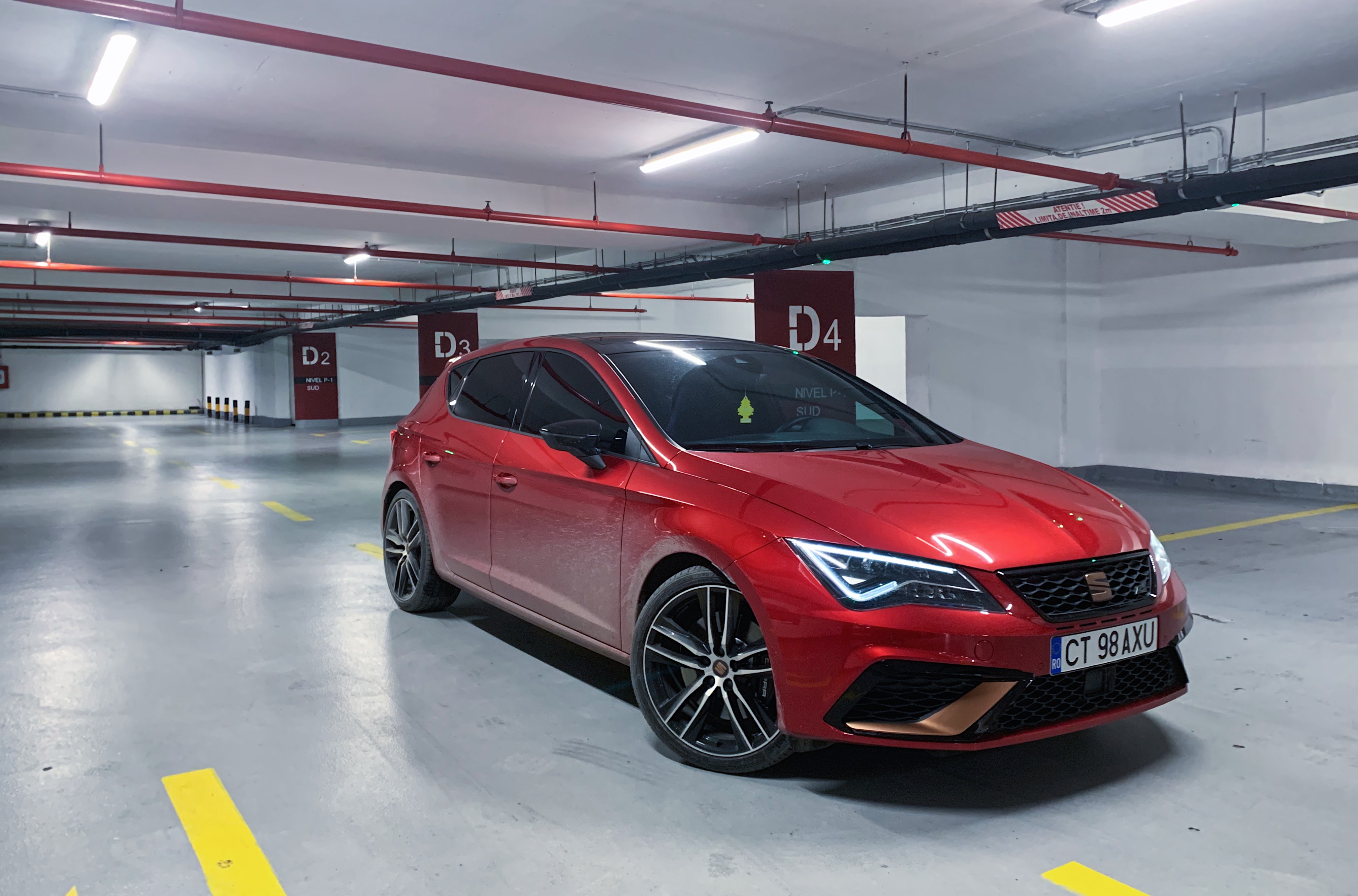

It s an easy job , you need a friend and some patience, the fog lights grill don t have any screw , try turning your wheel max left and right , unscrew the mud protectors and you get acces to the back of the fog lights grill , it has 2 pins that you have to push and another guy to pull the grill and it pops out ( i ve circled you where you find them , 2 on the left and one behind that radiator ) , after you ve done that unscrew the fog light and take it out , unplug the cable and put it behind a plastic ( you will see in the photos bellow ) then you will mount the new grille and that s it
Me and my friend are struggling at the moment but it’s a work in progress
