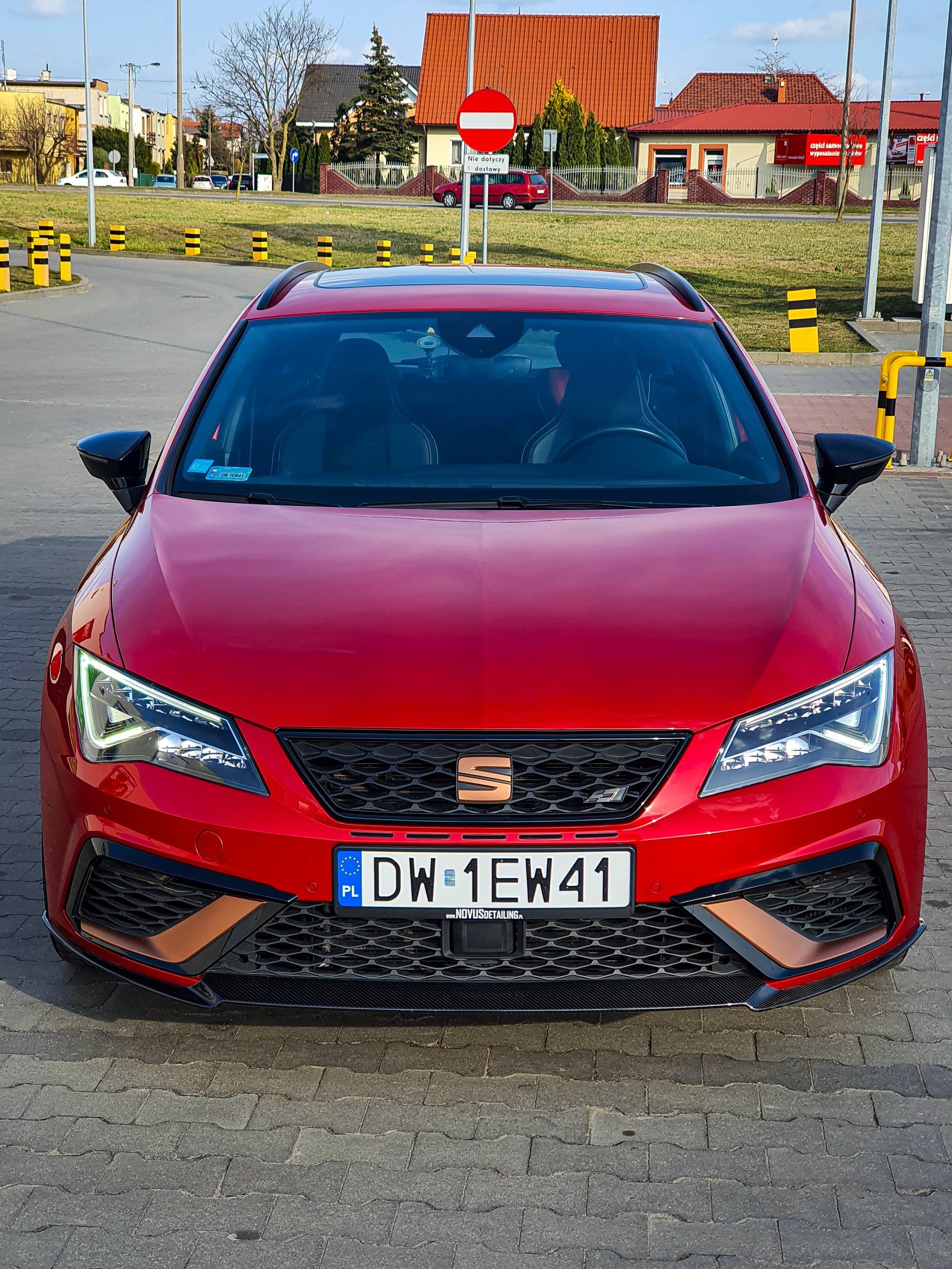

I fit it with fog lights. You have do a "little" cut with dremel ?
fb_img_1604382618978-jpg.19583
PM’d you
Hi! Great results indeed.
Are fog lights still fitted with OEM screws? Are only "some" cuts required on the new bumper inserts?
Close pics would be appreciated.
Thanks!
Hi Novus,
Just purchased the Cupra R inserts and want to do exactly as you've done on your Cupra. It looks fantastic, and great job on modding it!
Quick question, do you have any measurements/dimensions for the 'cuts', or did you just do it until it fitted? Do you have any close up photos?
Thanks in advance mate.
I cut piece by piece ? until it fitted exactly ?
One picture below Im done when Im fitted inserts. Second its when Im finished with dark PPF

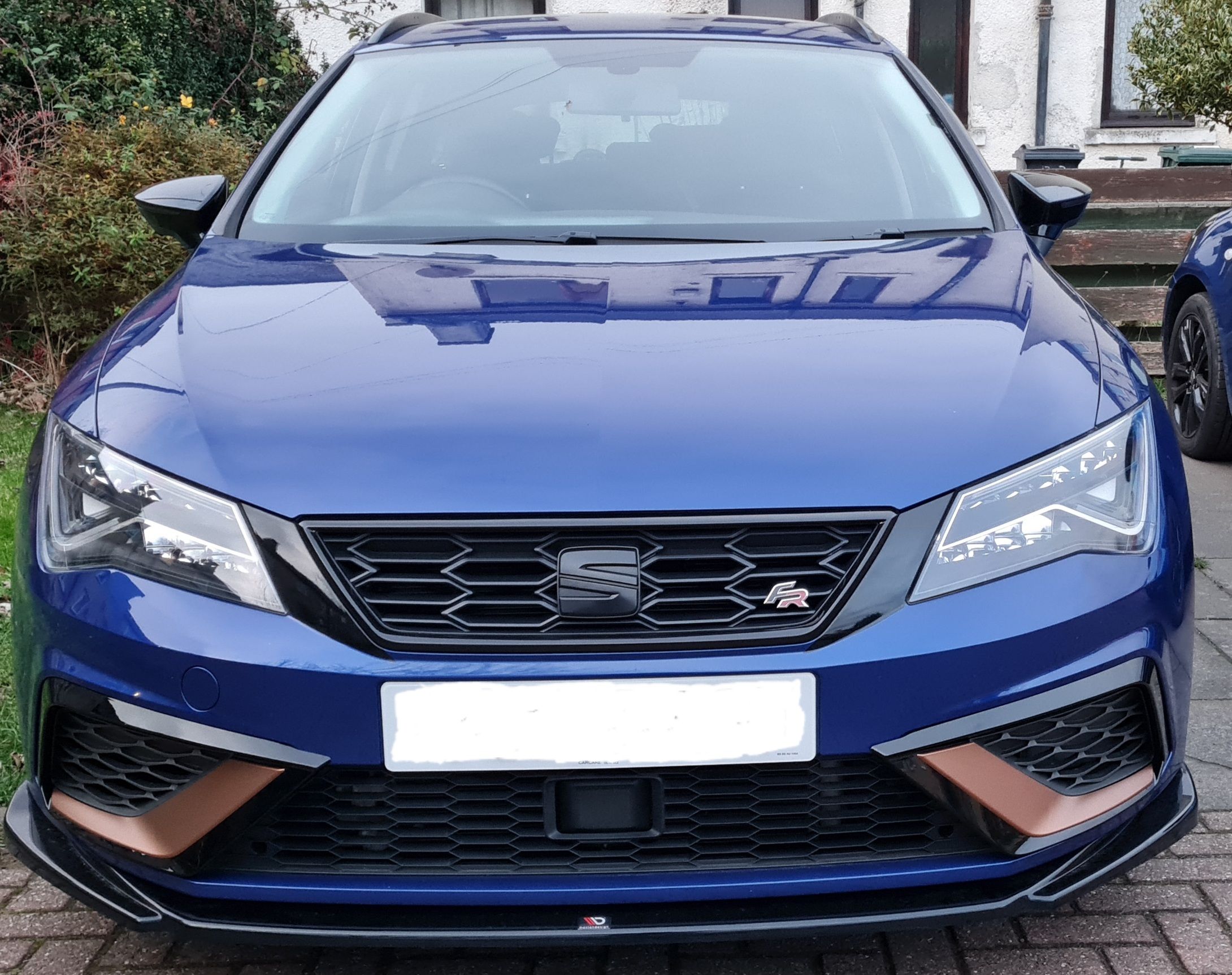

For anyone who still uses this thread for guides on these cupra r inserts....I managed to remove the standard inserts and fit the new cupra r ones without needing to unscrew the bit by the front wheel arches and under the bumper...I used panel remover tools to get in from the front nd pull it out that way. Saved a lot of time not having to fiddle from behind the wheel arch bit. Pic attached of the finished work.
