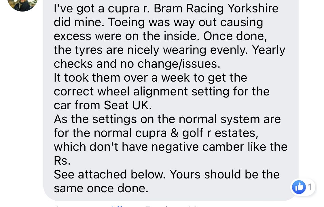

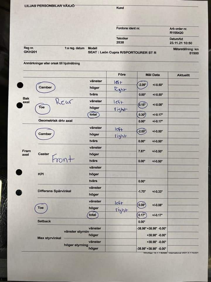

Just heard back from another R ST owner on Facebook.
Again Toe was out causing inside wear.
His adjusting garage contacted Seat UK and it took them a week to get the correct values.

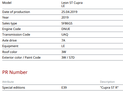

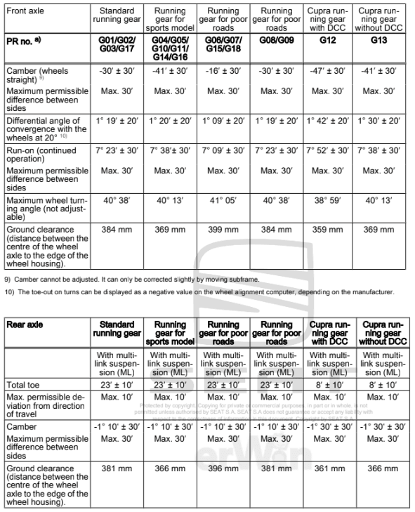

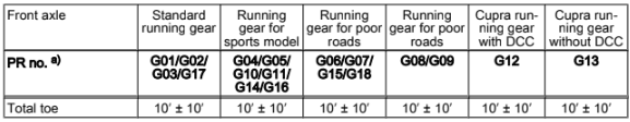

Maybe i'm missing something - not for the first time!
But looking at the PR codes for "Cupra ST R" I think a press car below:
Gives this data:
And this damper PR code:

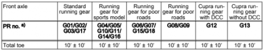

This G12 PR code is in the workshop manual for running gear:

Damo H
Oct 3, 2012
4,707
2,816
Car Length In Front
This one sits to me as being the correct one, the earlier one you posted is for a hatch I think as its rear camber was not mentioned as being tweaked...
Looking at the acceptable figures. the front toe and rear toe have a much wider acceptable range than the standard Cupra:
Front
Standard: 0°0' to 0°10' with 0°5' being the sweet spot.
Cupra R ST: 0°0' to 0°17' with 0°8' being the sweet spot.
Rear
Standard: -0°1' to 0°9' with 0°4' being the sweet spot.
Cupra R ST: 0°7' to 0°23' with 0°14' being the sweet spot.

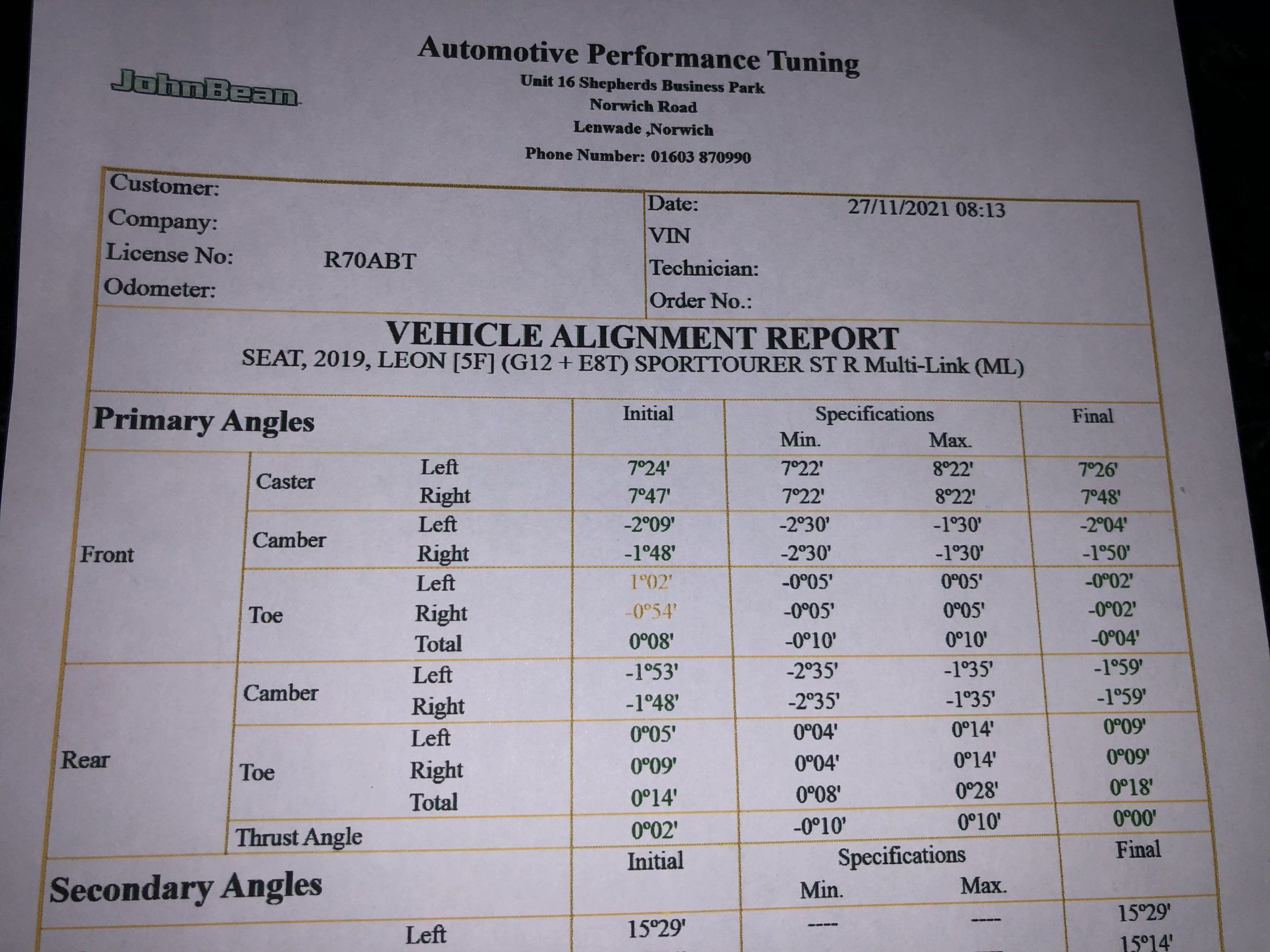

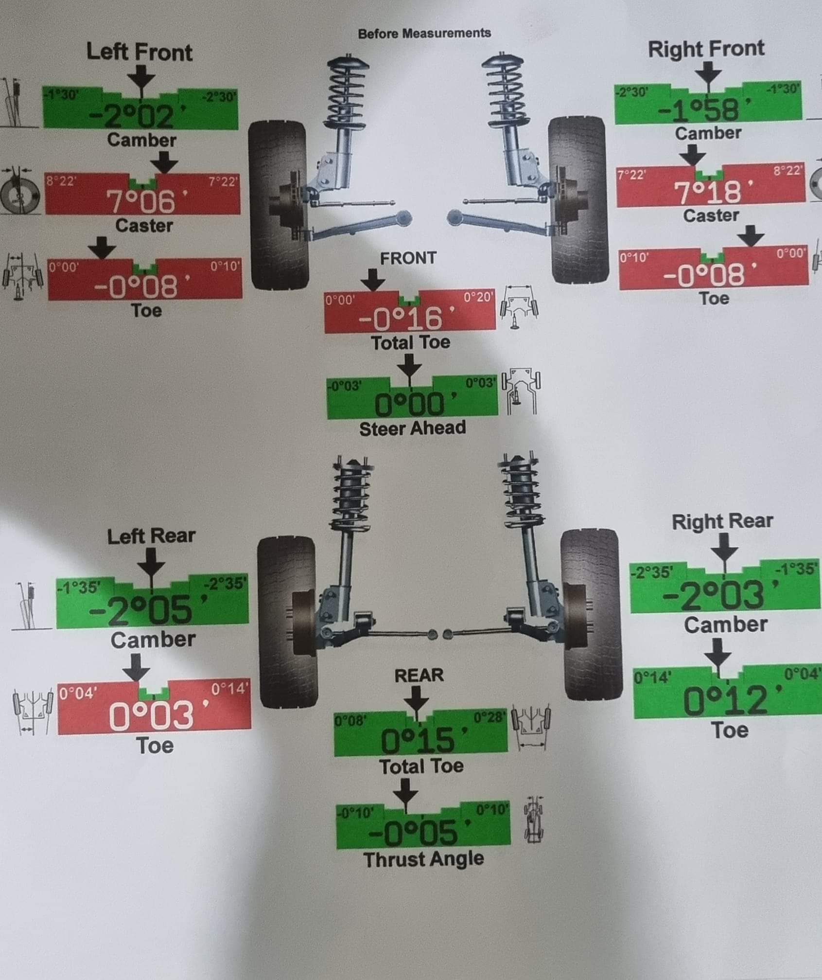

Had some PS4S’s put on yesterday at F1Autocentre, they didn’t want to do the alignment as they were unsure about the negative camber.
I had the alignment done at a local tuner this morning and as expected the TOE was out.
The car did appear to be on the database, although the recommended values are again different to what we have seen so far.
Not sure to be pleased with this or not for £84

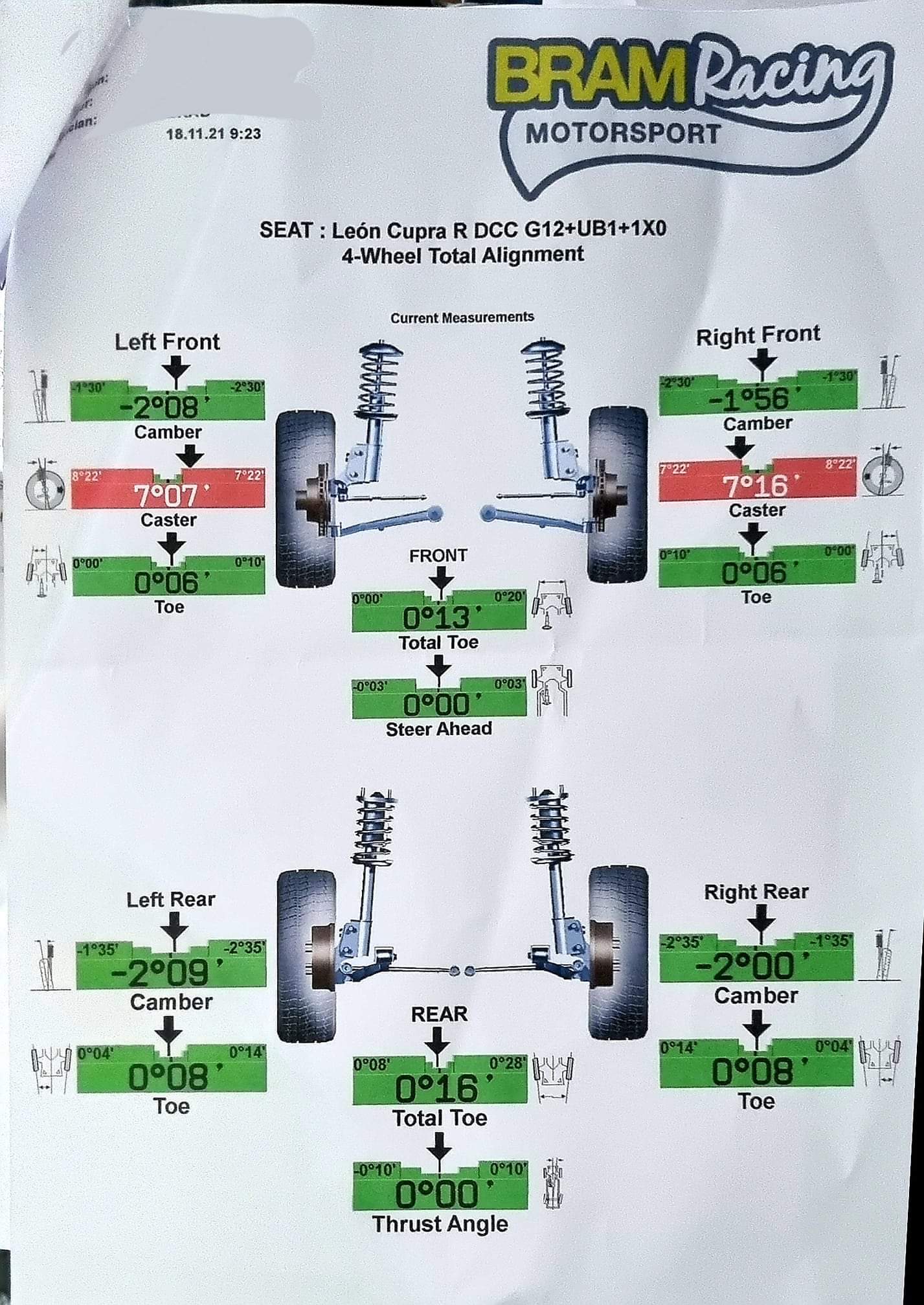

I went back to the local Kwikfit and asked them to check again that they had selected the settings for the correct model. They have now said that they had used the only settings that were on their Hunter database and although they previously told me they had double-checked the settings and that the database was always regularly updated, they have now said that it might not be up to date or include all models! So that has been a complete waste of time.
I have found another local Hunter specialist and they have confirmed that our model is on the database.
In the meantime, my car had its second-year service at a different Franchised dealership. A much better service experience to the other dealership. They managed to find the correct settings for our model, so I really do not understand why the other main dealer could not find the settings or tell me! Or even to tell me that they had to ask Seat UK for the settings.
I am unsure whether I can name these good or bad dealers on this forum.
Anyway, here is a copy of the specification from the other dealership - another VW group dealership, but not a Seat dealer, although the technicians all receive the same training, etc. I am not sure if it includes all the information required, but they were very helpful. They did comment that these settings are significantly different from all the other Leon models, including the five-door Cupra R. They are not able to do any tracking at their dealership and would just be subletting it, the same as the other dealership!
The dealer also commented that the settings are quite aggressive and would probably cause the front inside edges to wear significantly and prematurely anyway. So perhaps my car/our cars are set up correctly and will always wear out the inner edges prematurely and so possibly poorly specified by Seat for real-world driving, perhaps something to constantly watch out for in the future.
I will get the tracking checked at the other local specialist in the next week or so.

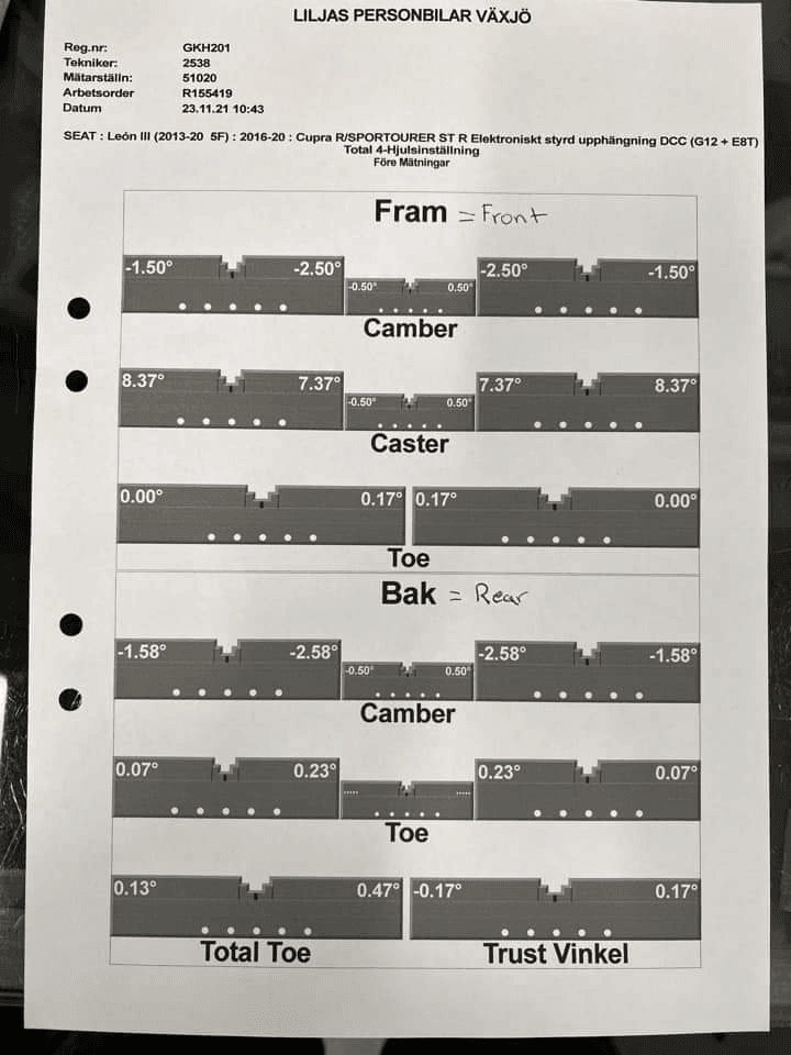

The difference in the front camber for each side is quite significant to me. It maybe worth looking at those Racingline spacers to better fit the subframe.
Reactions: Slickric21
Slickric21
Feb 23, 2019
554
254
Norfolk
Yeah I did notice that. It’s the same on the screenshot of the other R ST owner I posted also, front O/S camber only -1.5’.
Would that Racingline subframe kit definitely sort out that camber difference ? (If I can find someone who can fit this)
I’m half wondering if I should raise this with Seat as a warranty issue as it should be -2’ as advertised surely on the front, considering it can’t be adjusted ?
Alignment will be classed as wear and tear sadly.
Not sure if the Racingline kit will sort it. My understanding though is that the subframe is very "sloppy" in the amount of wiggle room it gives for fitting. Whether this is to speed the process up of assembling the car I don't know. However, I believe the kit is meant to reduce the tolerances and make it more central. So in theory, assuming everything is where it should be it should make an improvement. Downside is the cost and then another wheel alignment too.
If you were to do it, I'd also look at the Audi S3 Aluminium subframe swap as a weight saving improvement too.
