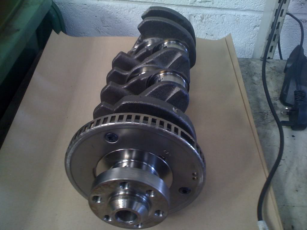

Fully lightened polished balanced crank

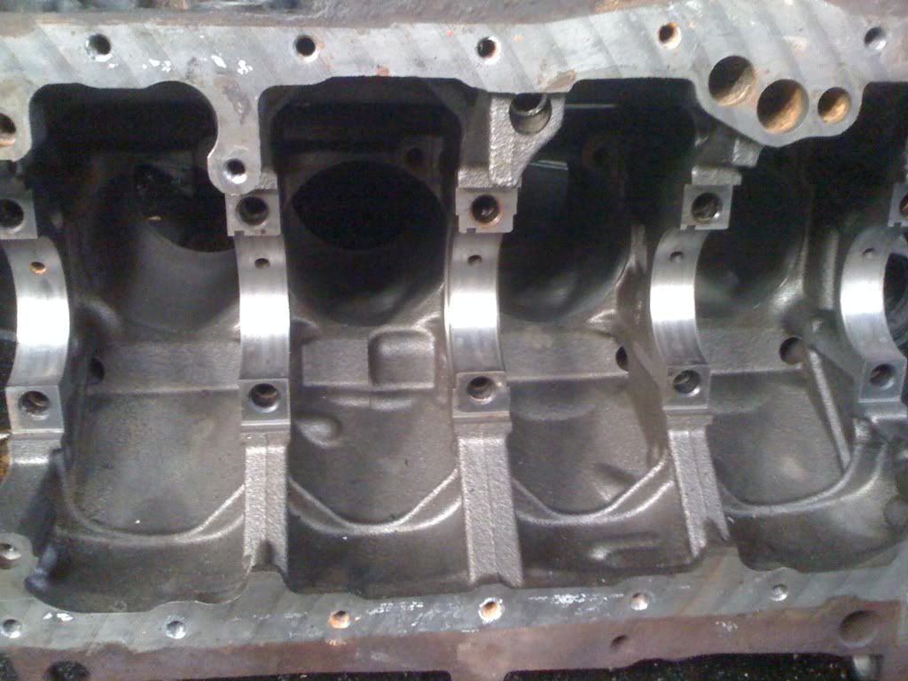

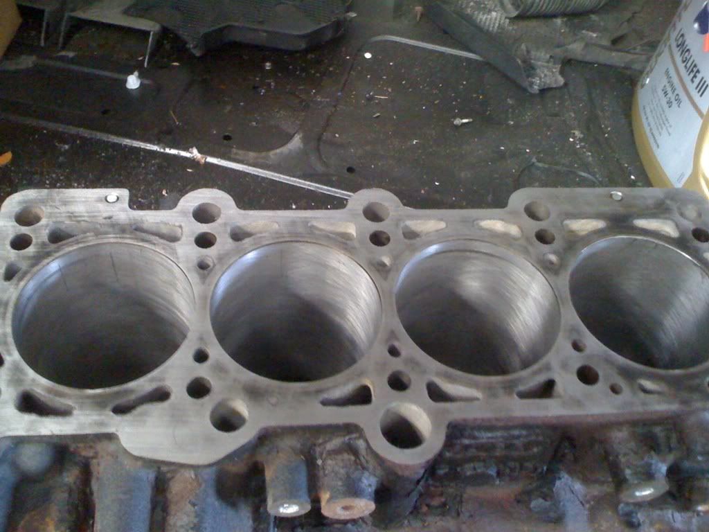

Had the block re honed new pistons and rings so clean up on the block

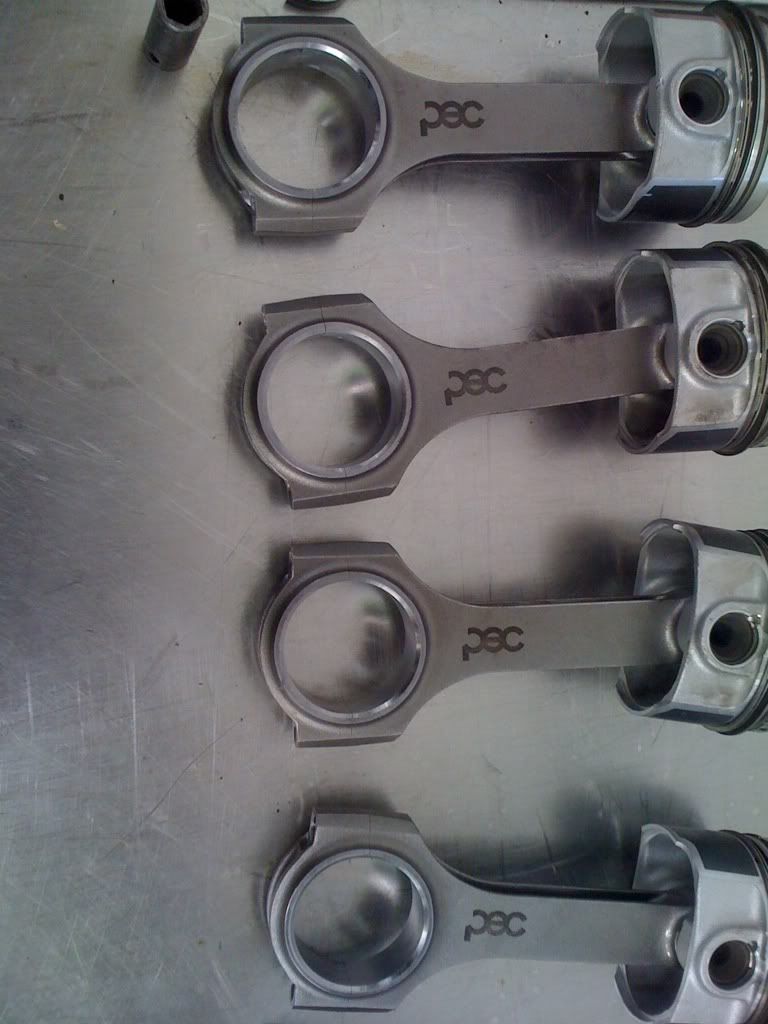

Conrods and pistons

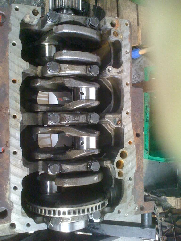

Crank fitted spinning nice and free in the block

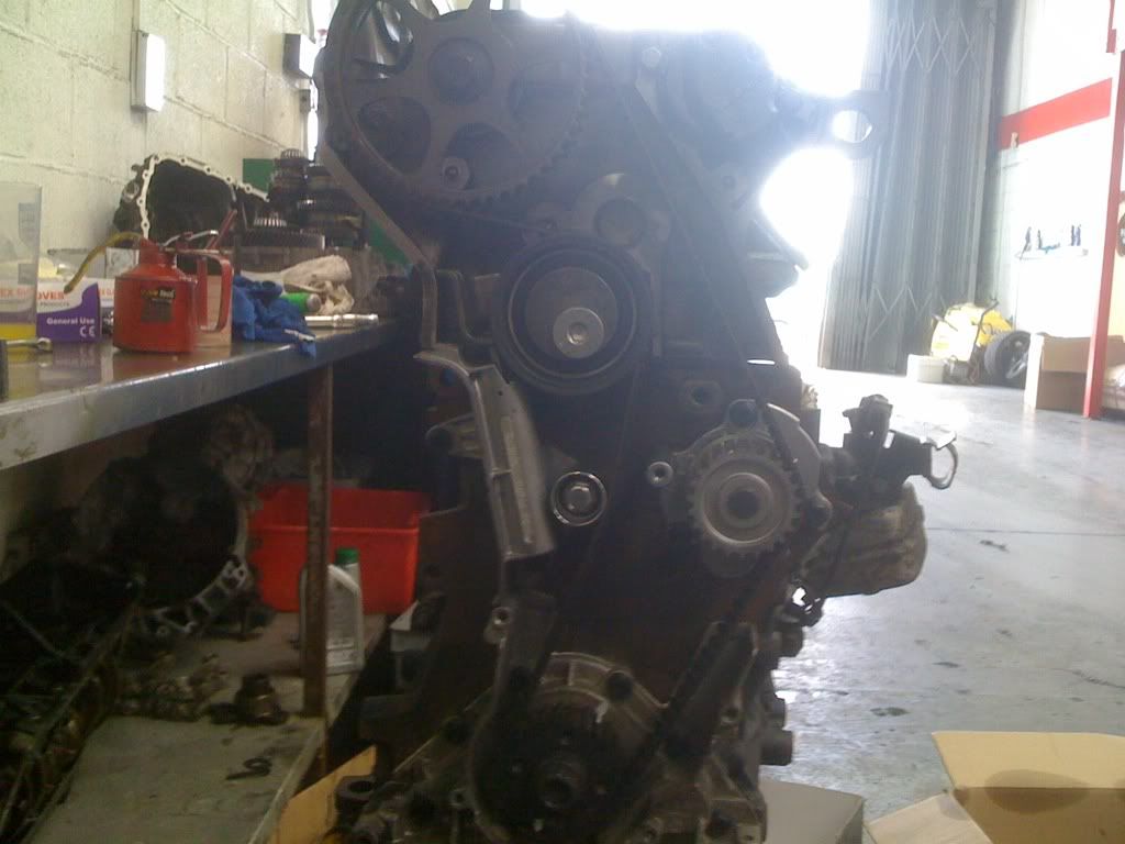

Head fitted cambelt timed up

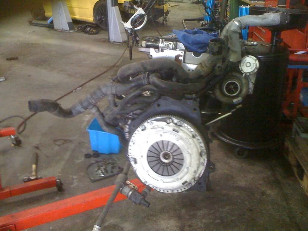

Stage 3 clutch and flywheel. all balanced up aswell

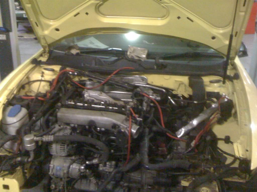

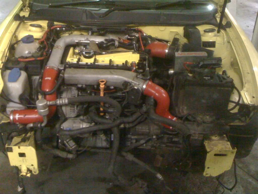

engine fitted

was just a clean up bore nuthing wrong with the block so only honed. i havent done anything to the head im not looking for more power im happy how it is just made it stronger.

Any idea how much weight was removed during the lightening of the crank and flywheel?
Do you feel a difference after this work has been done?

Paul : the Clutch http://www.ecstuning.com/Audi-TT_MKI-Quattro-225HP/Drivetrain/Clutch/ES2533/ so far is great needs a lot of miles to bed it in 500. feels OEM and bites really well i like it. not much rattle from it being lightened and the whole bottom end being balanced
Ash : yea i will be up there with my tools, big shame the exhaust manifold didnt get here, im very unsure if it will get fitted. its a huge job now to fit. while the engine was out head off it was simple.
Andy : its great to have the car back on the road 4 months is a long time
Willie : my car is running standard map so no boost feels different and revs up so freely now so i can tell a difference to the engine, i dont know how much was taken away with grinding and drilling but it all looked nice while i was fitting it.
only job left on my car was exhaust manifold, this being a huge restriction to the 1.8T engine and with the rebuild i wanted to fit while engine was out. fitting now means removing the turbo or even pulling the engine back out so can get up the back easier.
