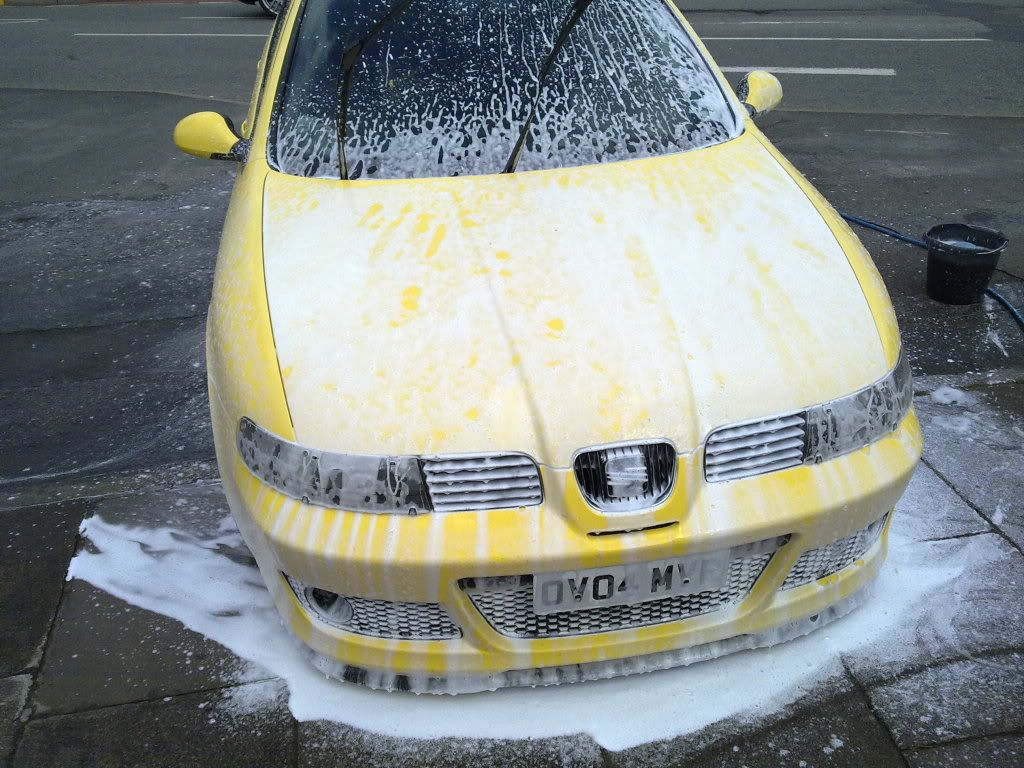

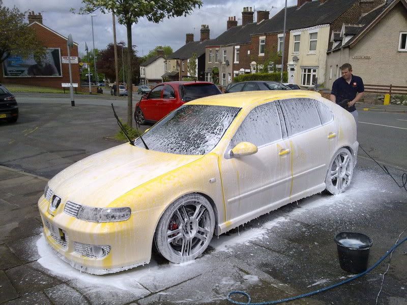

Had a busy day taking my car to be detailed :D
I do all the cleaning myself and normally looks great and shines for a week till the next wash. This time i took it for a pro to do the work while i watched, learnt how its done.
really good job done on the car and with a yellow car all the tar and fly poo is a pain to remove.

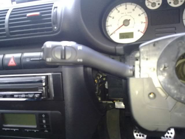

on friday night i was busy again fitting new cruise control to my car :D
All works fine and happy with it, i fit enough at work so did it on mine.

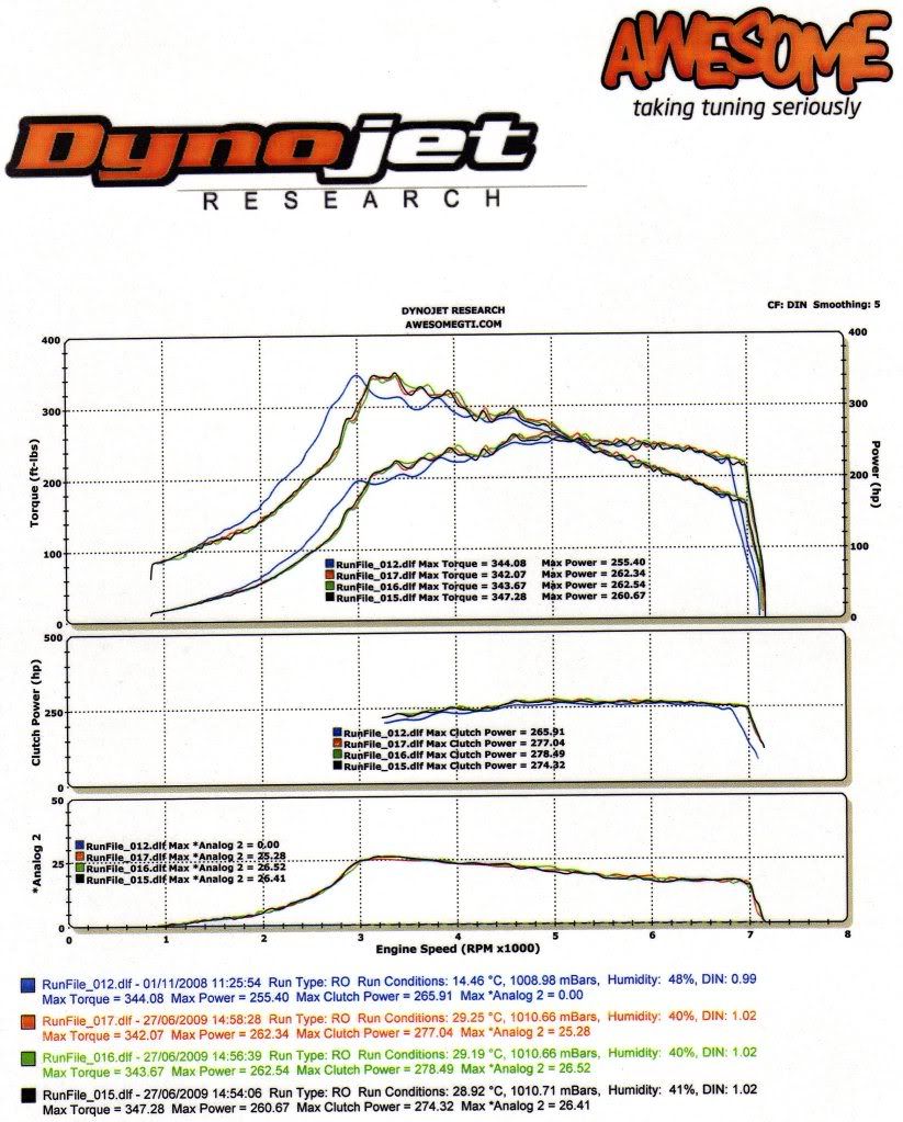

Well ive had my forge actuator fitted for about a month now and still is running fine , holds boost a lot better and defo pulls alot harder now.
The job it self was a bit of a pain, i did it over a pit (Demonpete). i think would be been bit easier on a ramp at work tho. Pretty much have to remove the turbo, undoing it from the exhaust manifold and moving it back a few inches, so you are able to undo the water banjo bolt that is in the way of 1 10mm bolt that is holding the standard actuator on, the lower 10mm bolt is easy to undo from under the car. once that was removed refit and adjust the rod with some pre load. i used a yellow spring in mine.
The last rolling road i did my car did 266 bhp and 344 lb ft.
this time it did 278 bhp
Ive got the graph to scan in so will do that in a bit.
That's a good change, did the torque drop?

so is that just the actuator that gave you the extra 12bhp then John? I know you mentioned this increase on the day but reading it really made me realise what a good increase you got!

The torque did go up aswell from 344 up 2 347 only 3 hehe but makes it pull like a train,
I think with the forge actuator helps it hold boost alot longer which is giving me the extra power.
