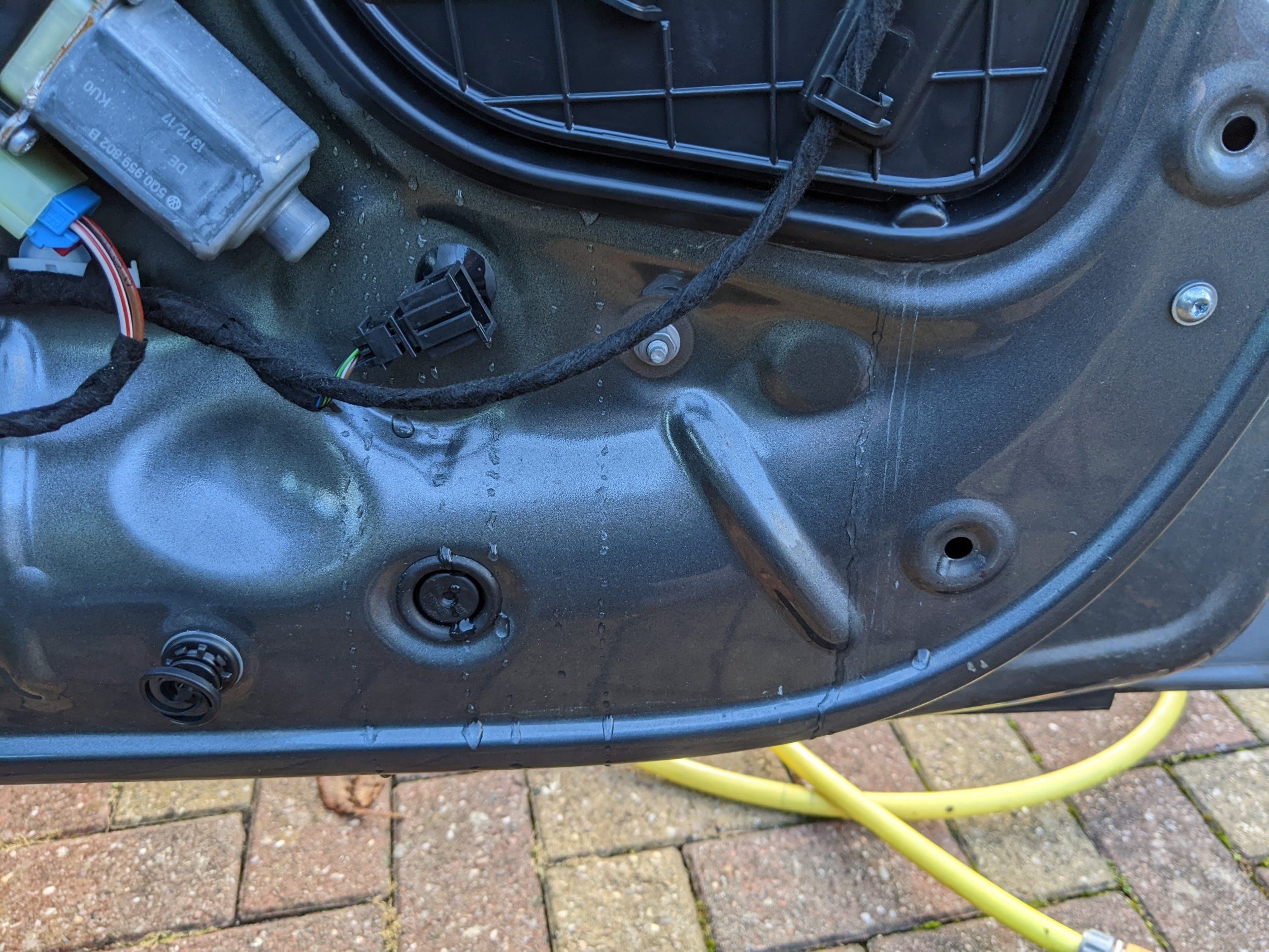

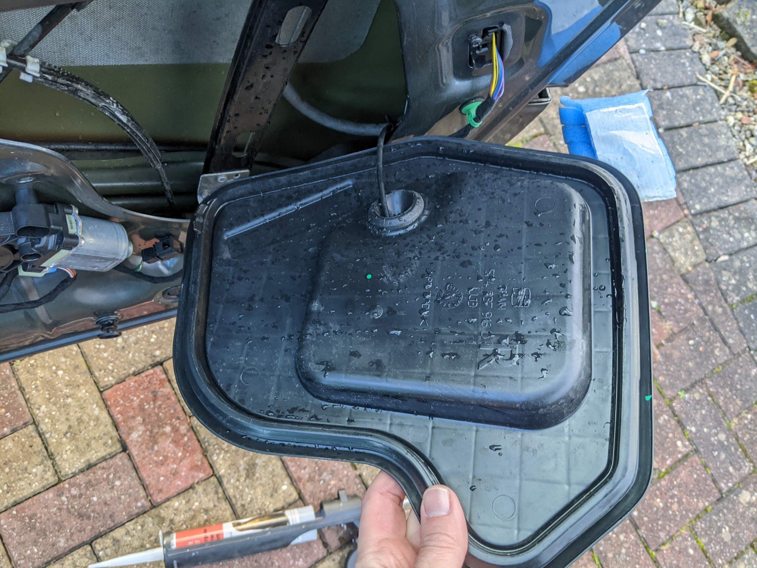

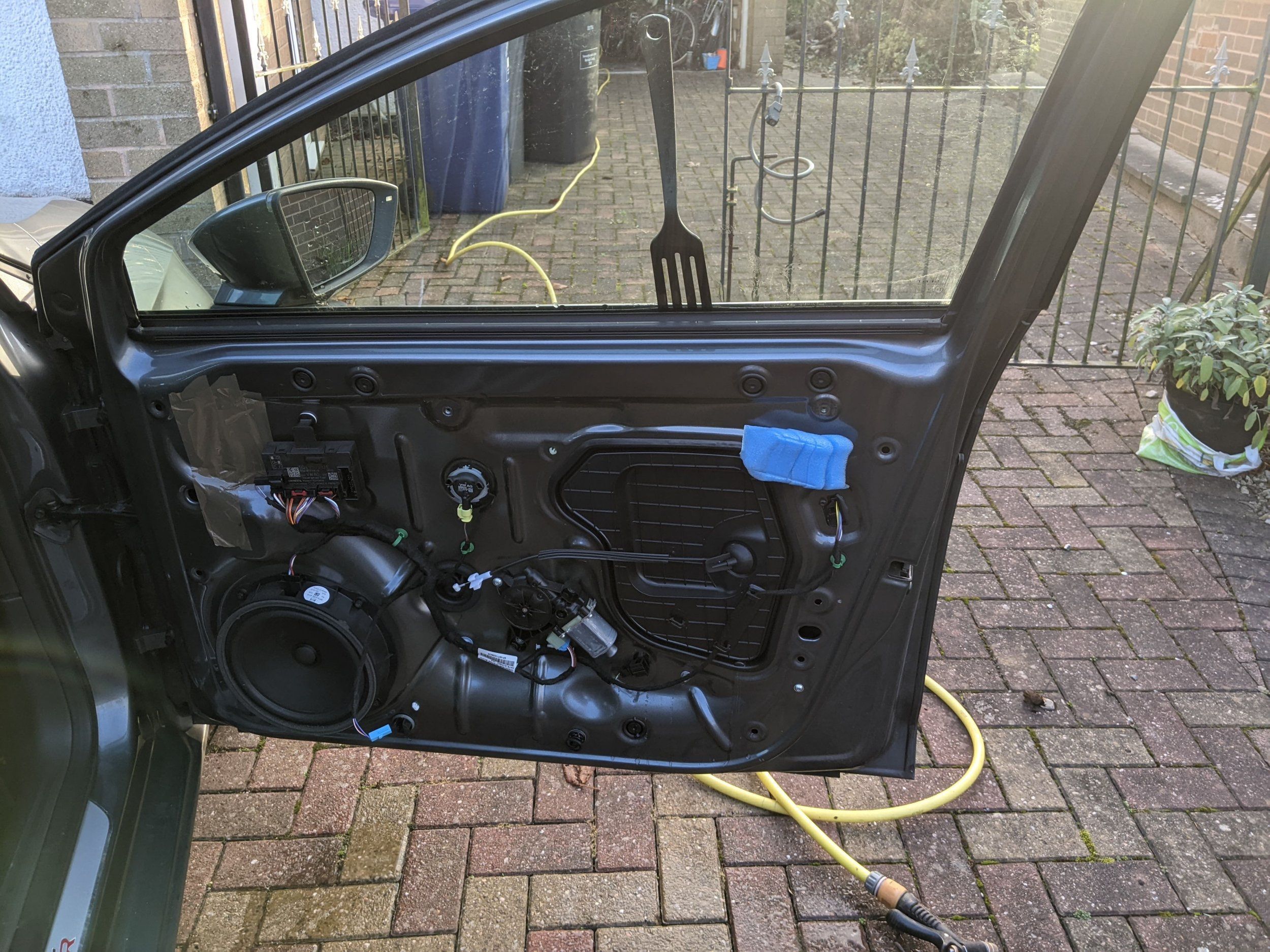

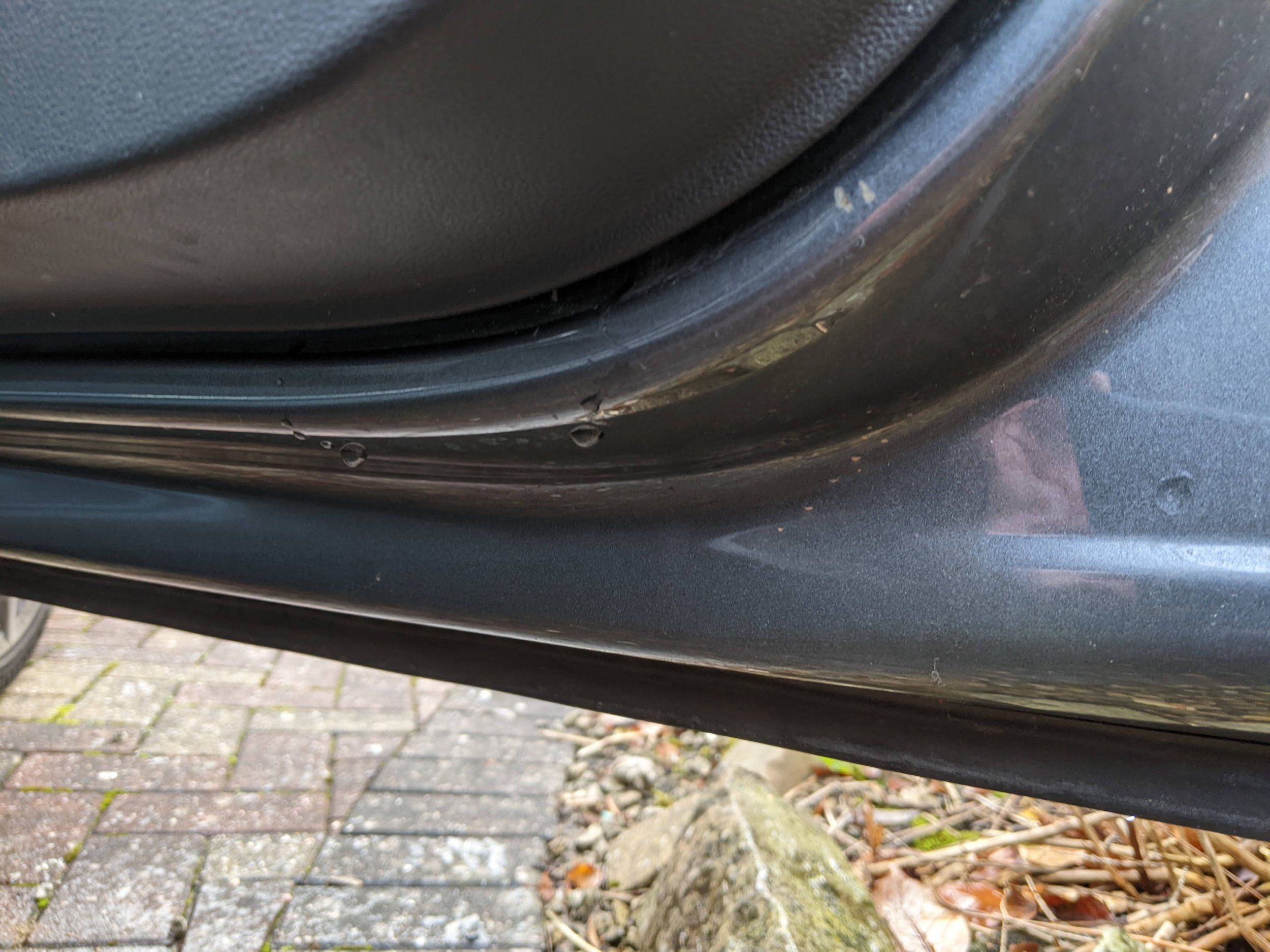

Think I may have found out my issue.
I put a spatula in between the windows and the seal on the outside and poured water down and noticed water was getting through under the door panel trim. I removed the door card / panel, useful removal guide here:
After the panel was removed, I could see water seeping through the bottom of the plastic infill panel, also stains where this had happened before. Presumably this water would seep into the footwell as on the inside of the main door seal. Not sure why it wasn’t sealed at manufacture.
Removed the black panel and sealed it back with silicone so hopefully should keep the water on the outer side and down to the door drain holes at the bottom of the door.
Hope this helps anyone else who is having the same issue.
View attachment 34656View attachment 34657View attachment 34658View attachment 34659

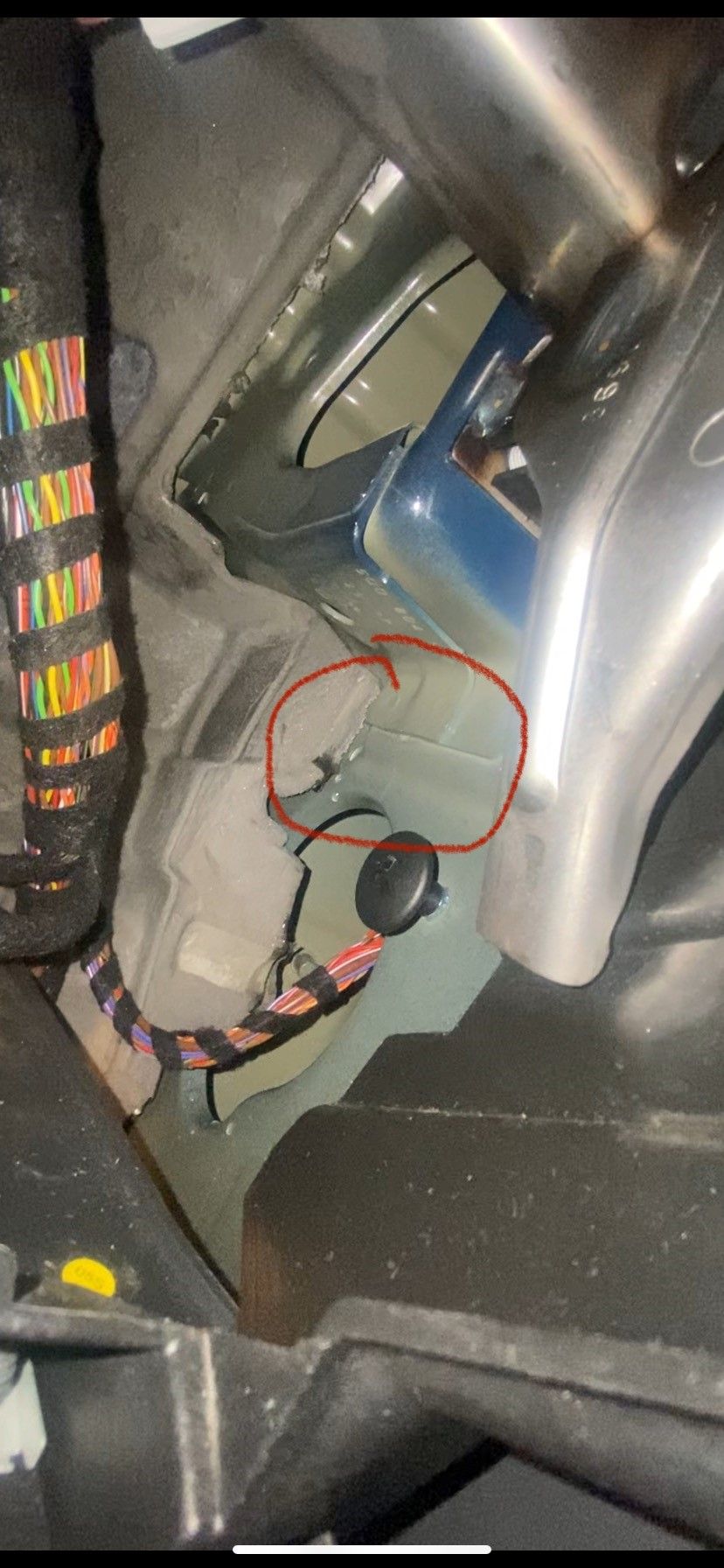

Please could i have some advise. My seat Leon 2018 estate is leaking water into my foot well (driver side). I have attached a photo where i can see the water dripping into the car but unsure how its getting to that point. the photo is taken in the top right near the fuse box. i have checked the scuttle grill

just been working on the areas where you have said. I am 99.9% confident with one #24 that you have said I have attached a photo of mine the seal has broken away from the two metal plates. I have poured water just there and it’s pissing in so tomorrow job is to dry it all and get it all sealed around it. Thanks leonardo for the great advice and great forum to get information from ?
