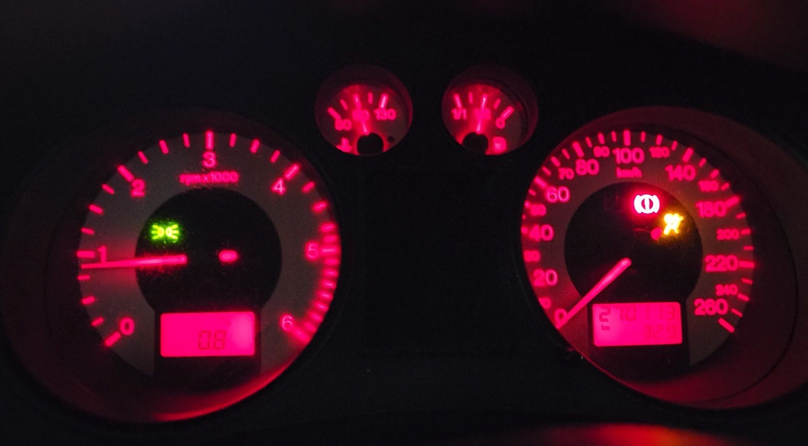

Hey guys,
Wonder if this has happened to anyone before, my Ibiza (1.9 TDI ASZ) sat outside in the sun all day and when I started it my dash board went crazy, flashing almost all error lights and beeping nonestop, I lost my power steering aswell.
Rev counter and speedo also intermitently going crazy with incorrect readings.
Tried on & off a couple of times but nothing worked, car drives fine, except for power steering, but lights keep flashing (almost like a bad contact sometimes).
Been in the garage now for a couple hours and looks like eveything is ok except for airbag light that stayed on. Power steering is working again.

Really could use some help with this, not sure where to start looking.
