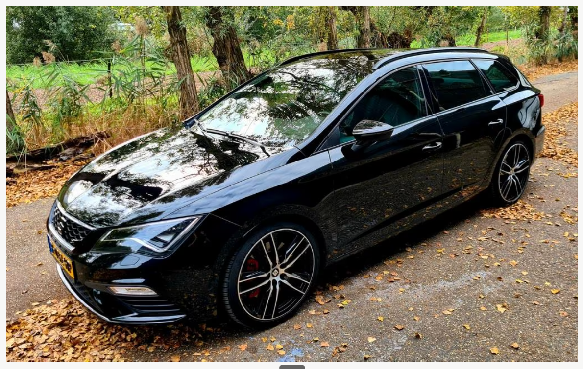

Bought my third Seat last month. After having owned an Ibiza 1.9TDI (110hp) from 1999-2007, an Alfa/Benz somewhere, and a Leon 1P 2.0TDI FR from 2013 to 2023, I am now on my third Seat: a shiney new second-hand Leon 5F Cupra ST from 2018. After 30 years of Diesels it certainly is taking some getting used to not having any torque in the low end but so much power in the high end.
It didn't have the ACC, Keyless, DAB or Rear Parking Camera options: basically I got a cheap-basturd version because I was clueless and needed a car fast (never a good combo). Despite the original advert saying it had ACC and the soundsystem, the seller was ofcourse "clueless" about the deviations. Lesson learned.... She's a shiny black beauty none the less, debadged with black seat emblems on the grille/boot. It really looks like a dad-car from the outside, nothing that screams "hey look at me".

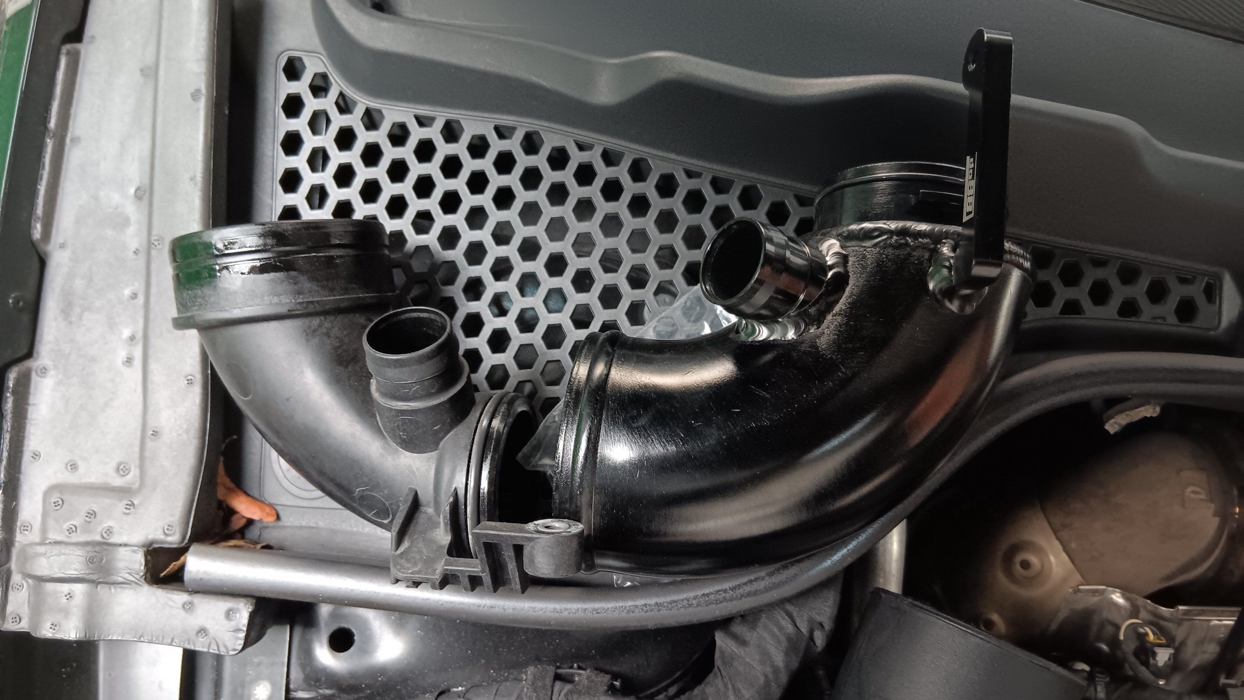

- Do88 Intake system (elbow, hose, filterbox cover)
- K&N filter
- modded airintake (dremel)

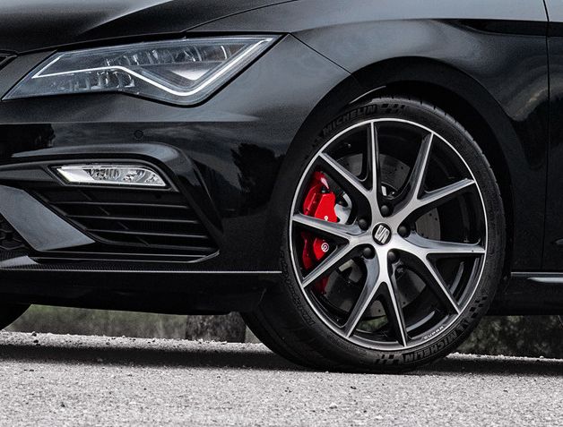

- New 19" alloys, those Y spoked cupra ones in black/silver. Waiting for tires to be switched next wednesday

New alloys and the do88 intake elbow attached (not my car in that photo with the wheels)
The alloys look fantastic
