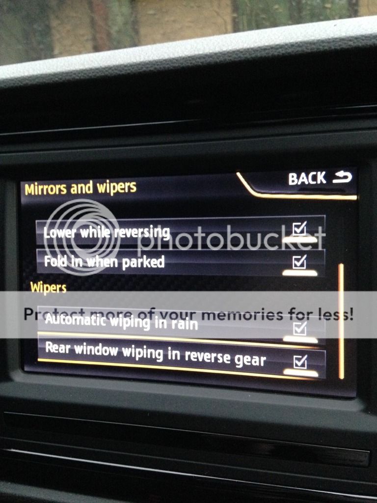

I thought that you could disable automatic rear windscreen wipe on reverse via the visibility options menu in the main touchscreen display?
Unfortunately I was being too optimistic - I checked this out on my car (October 2013 FR with Technology Pack) this afternoon and found that after all you cannot disable automatic rear windscreen wipe on reverse, using the options in the CAR menu, even though page 82 of the MY13 LEON Owner's manual makes it look as if you might be able to select or deselect this option.
I have that option in the menu, will take a look at the setting tonight. Thanks

No option to turn off/on auto rear wiper in a MY16 ST Cupra.
Vehicle settings -> Mirrors and wipers
Or use VCDS to unlock the magic setting in the CAR menu
If your user manual says it should be there, maybe you could convince your dealer to enable it? I noticed in the latest version of VCDS the option is now half in English and the other in German, just replace the first word in my previous post after the number with Rear wiper.
