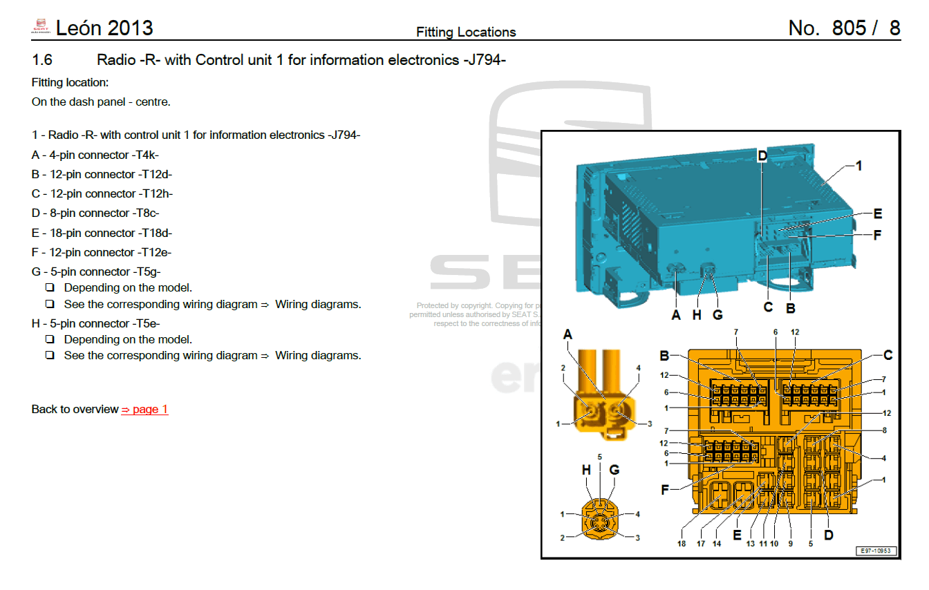

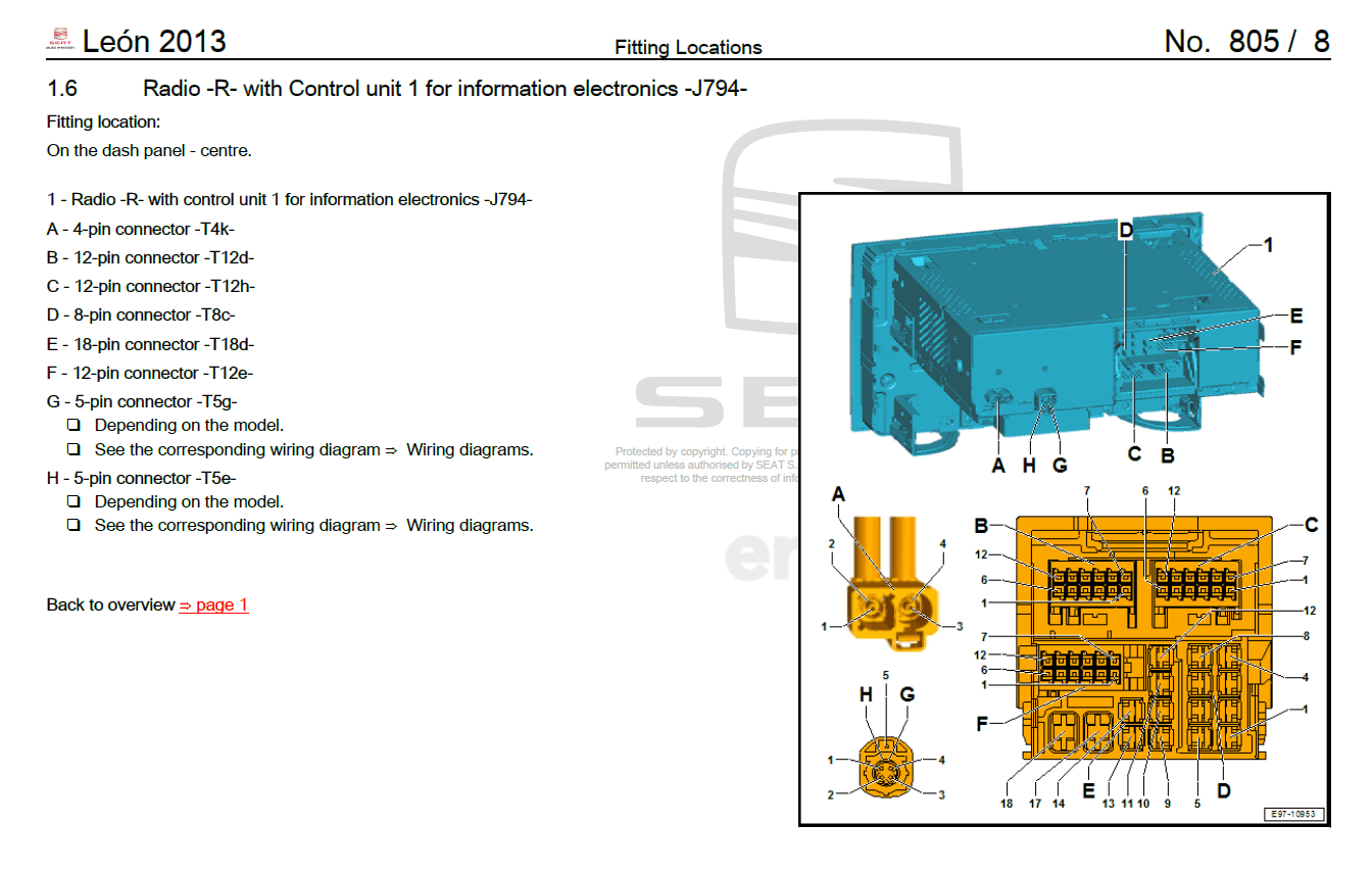

Thank you very much. Now I just need to find a diagram for the radio harness of this type, to know which wires are the rear speakers. Would you happen to have that at hand aswell?
Connector T8c (Marked with D in illustration below)
pin 4 : rear left positive (red/white)
pin 8 : rear left negative (brown/white)
pin 1 : rear right positive (red/purple)
pin 5 : rear right negative (brown/purple)

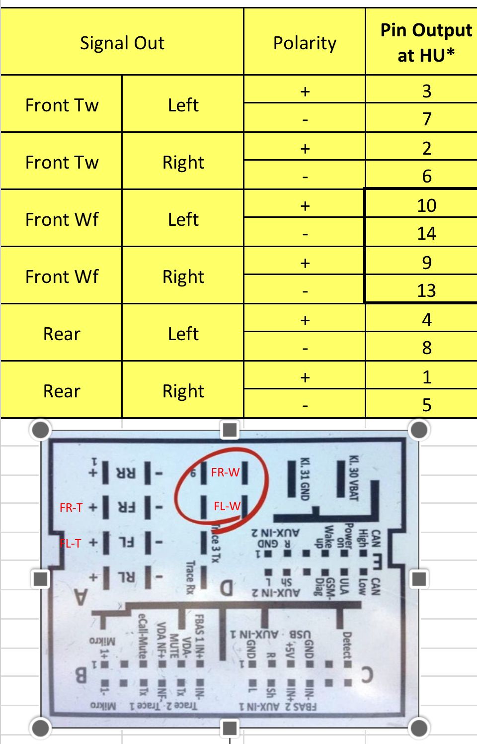

@mathyou78
Sorry, noob question, but just how much of this, is applicable to my setup? This seems to indicate the brown block (Area D):
Pin1 and 5 = Rear Right
Pin2 and 6 = ?
Pin3 and 7= ?
Pin4 and 8= Rear Left
In addition,
I also have wires in:
Pin9 and 13 =?
Pin10 and 14=?
In the brown block, can somebody help me identify the 2 other signals?

2-6 Front right +-
3-7 Front left +-
9-13 Subwoofer +-
10-14 Front center +-

Yep. I have these details. Here you go. Note that I annotated the picture of the HU connections with the actual connections for my car.

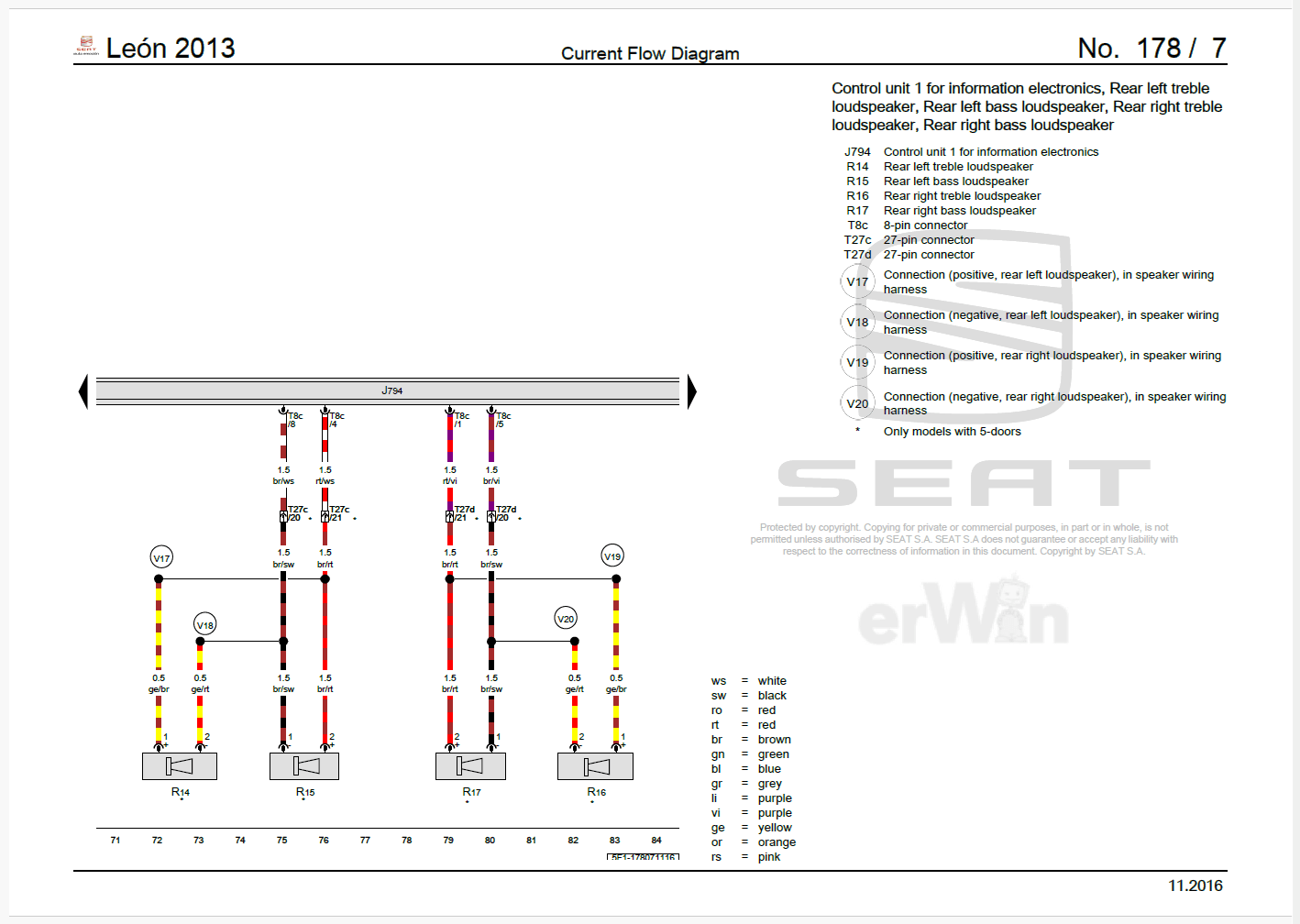

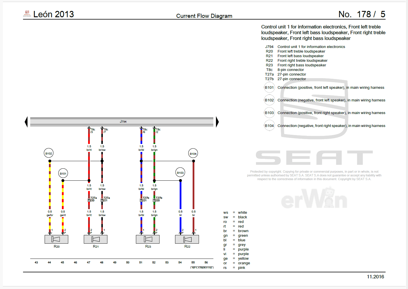

That’s not correct for the 8RM setup. I think you’re referring to Seatsound or Beats Audio, 9VD.
Sorry for the confusion, you're right but only to some extent.
According to the official service manuals, cars with the PR code 8RM built up to May 2016 uses separate pin 10/14 and pin 9/13 pairs for front bass speakers.
After that date, they changed the setup, so front bass and treble speakers are fed through the same pin pairs 2/6 and 3/7, like it was in 9VD.
I can provide screenshots from the manual if needed.
Mine is a 2018 FR Technology and 100% has front bass on pins 9 - 14. The front door speaker wire colours match the quad lock at pins 9-14 per my description too. I’ve also continuity tested the wires previously.
I have the manuals myself. I can tell you that none of the wire colours are a complete match to my car. Imagine the confusion I had working that out. Good eh!
OK, hands-on experience can't be beaten :)
I have come across with incorrect wire colours, but incorrect pin numbers ? That's really sloppy of SEAT.

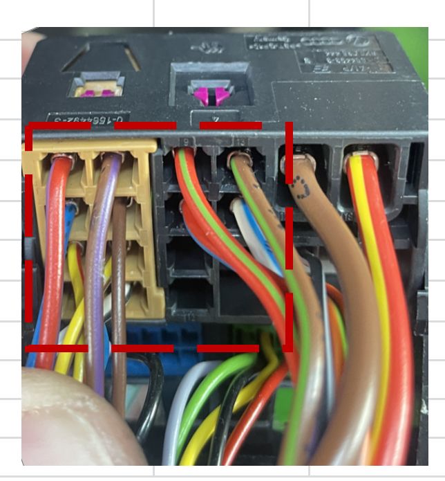

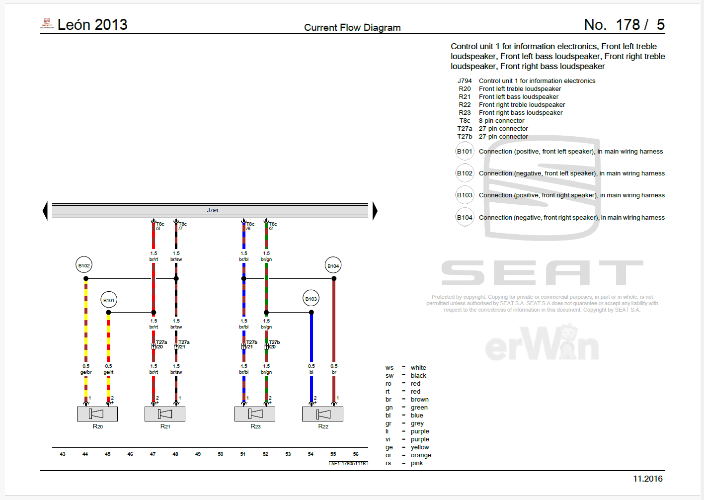

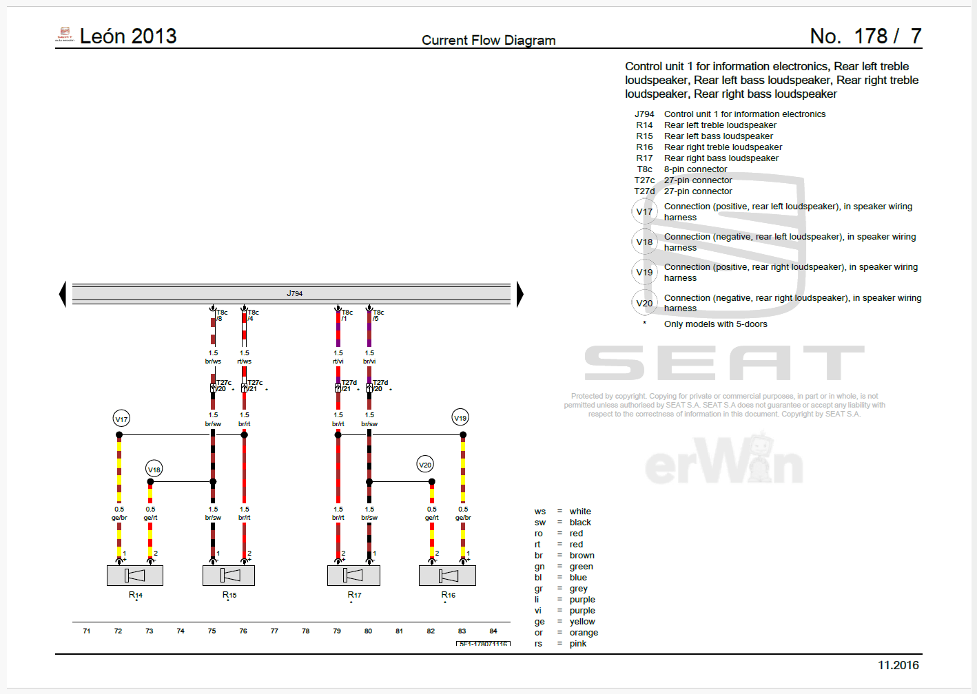

I have a 2017 xcellence 8RM With navigation, and would really like to see the screenshots?
Here they are, but after what @mathyou78 said, not sure that they're to be trusted.
I'd double-check the wire continuity.
Thank you very much! I am replacing a blown front bass speaker this weekend, I might try turning on the radio, when it is disconnected. If the tweeter stops playing they are connected as in your diagrams, if it works, the tweetet and bass is separate?
Think the car will throw fault codes if turned on With a speaker disconnected??
