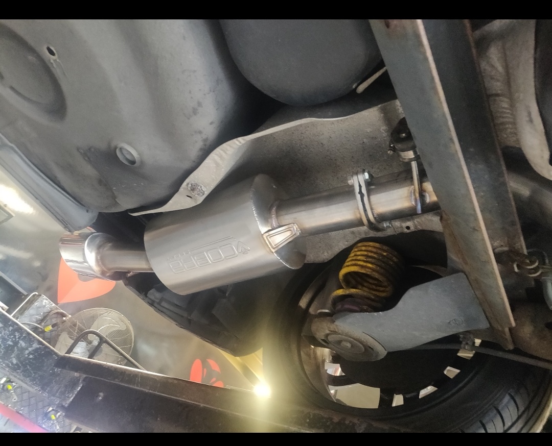

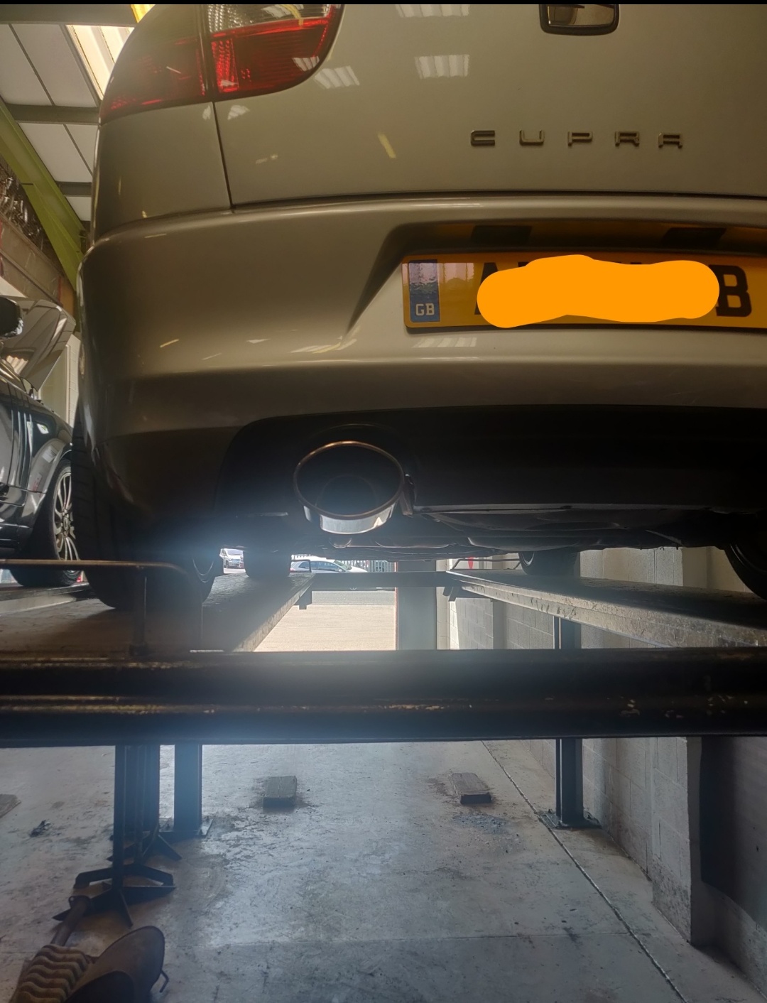

• New Cobra Decat and Cat back.

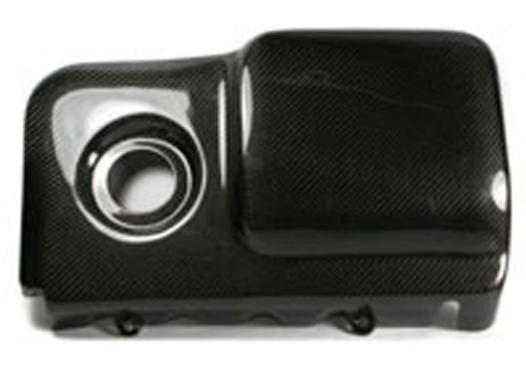

• ECS Carbon fibre engine cover.

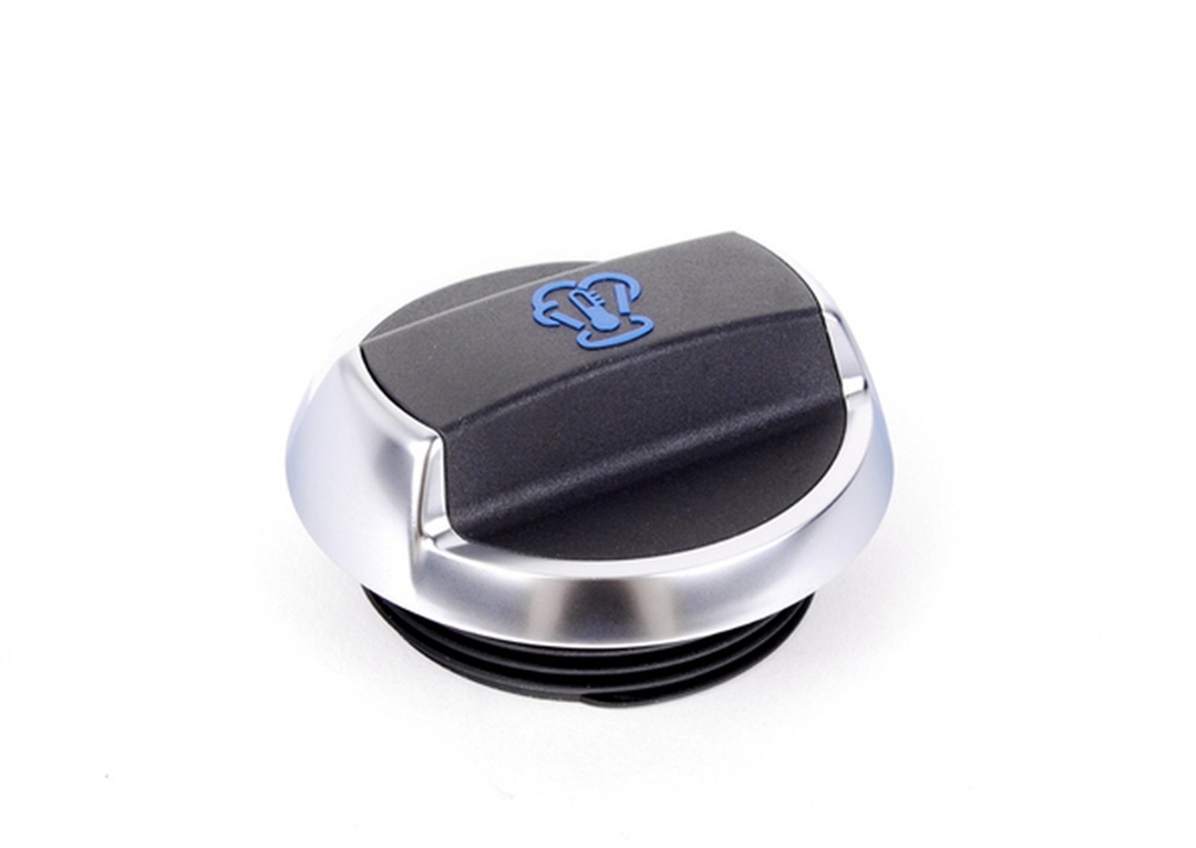

• Creation Motorsport coolant cap .

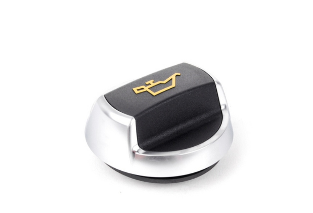

• Porsche oil cap.

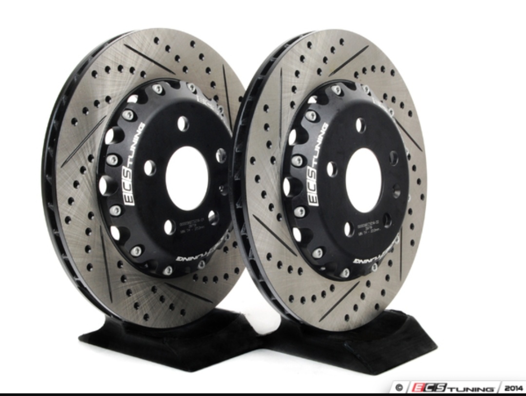

So as I said before a lot of my money recently has been spent on trying to get the car back to a reasonable state. It's 14 years old now and tbh the last few years the car has been a work horse. A few things I have ordered from ECS Tuning (still in USA I think) then they'll go on car.

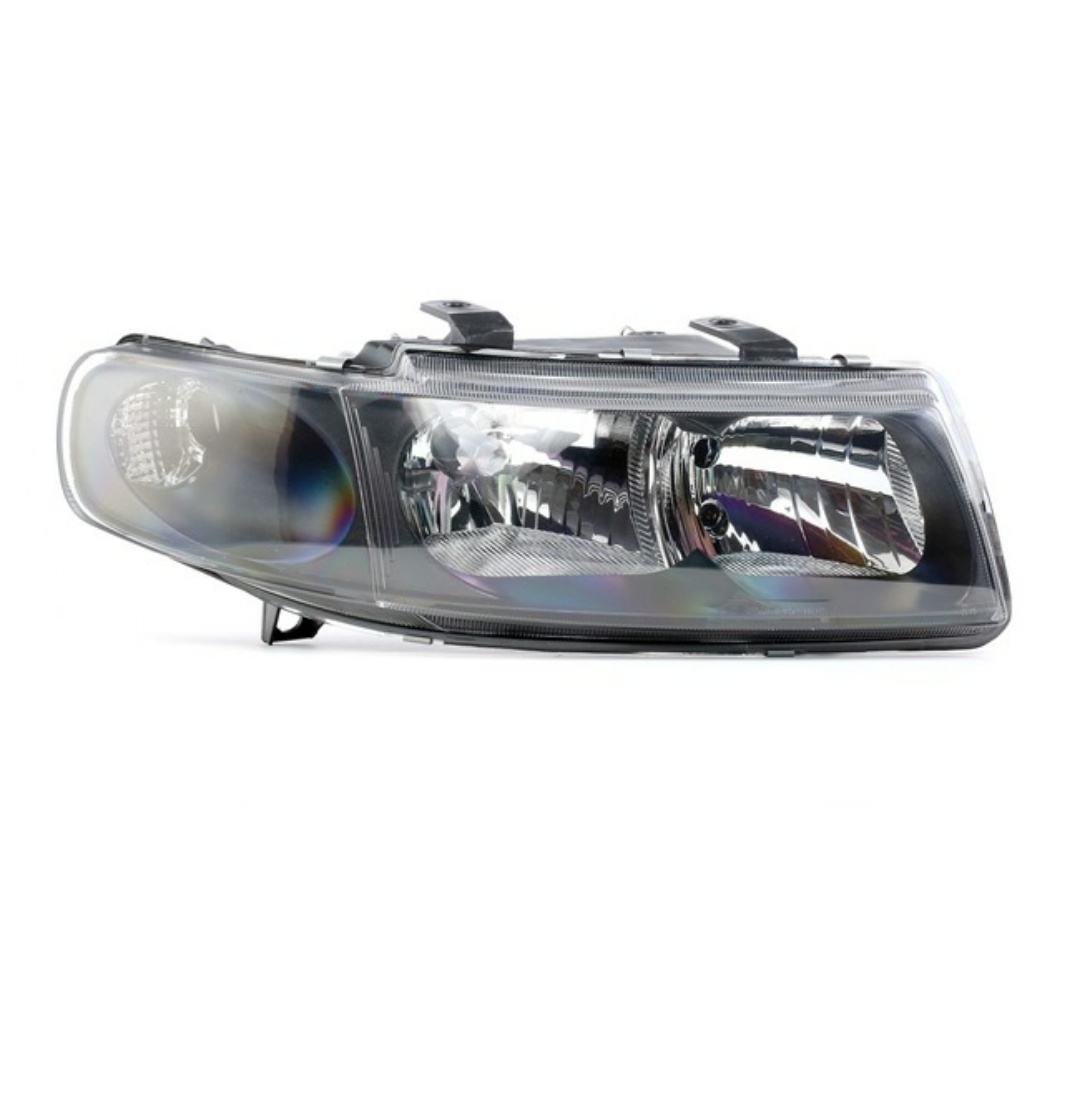

Then my front headlights needed changing due to the yellowing effect (which was temporary fixed but went back to normal). And also I had scratches on Windows so 2 new ones fitted. They were awful...an old work colleague stuck labels on my car which be couldn't remove!!!

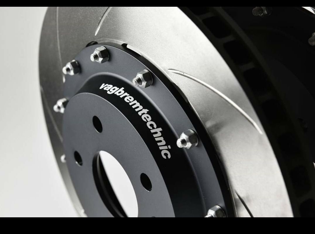

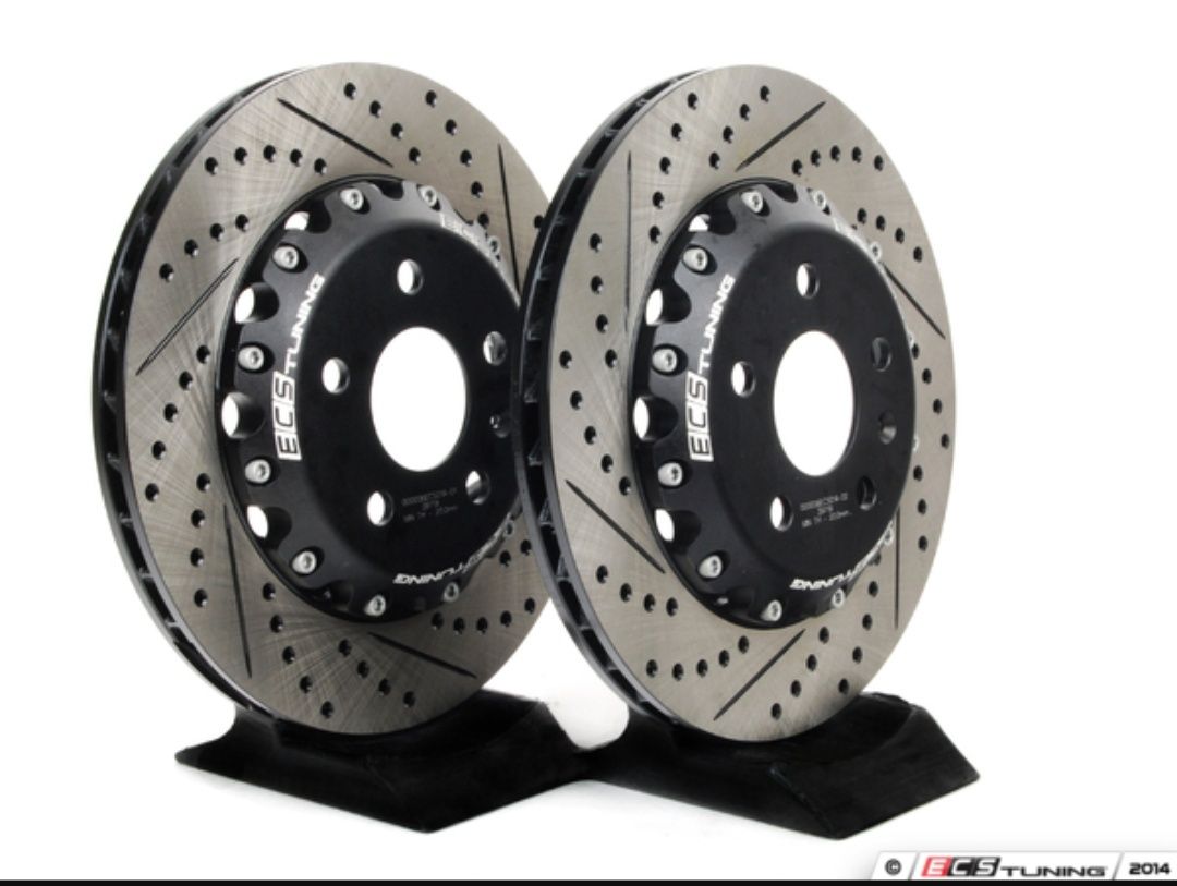

Lastly I have ordered these bad boys which are still actually on their way.

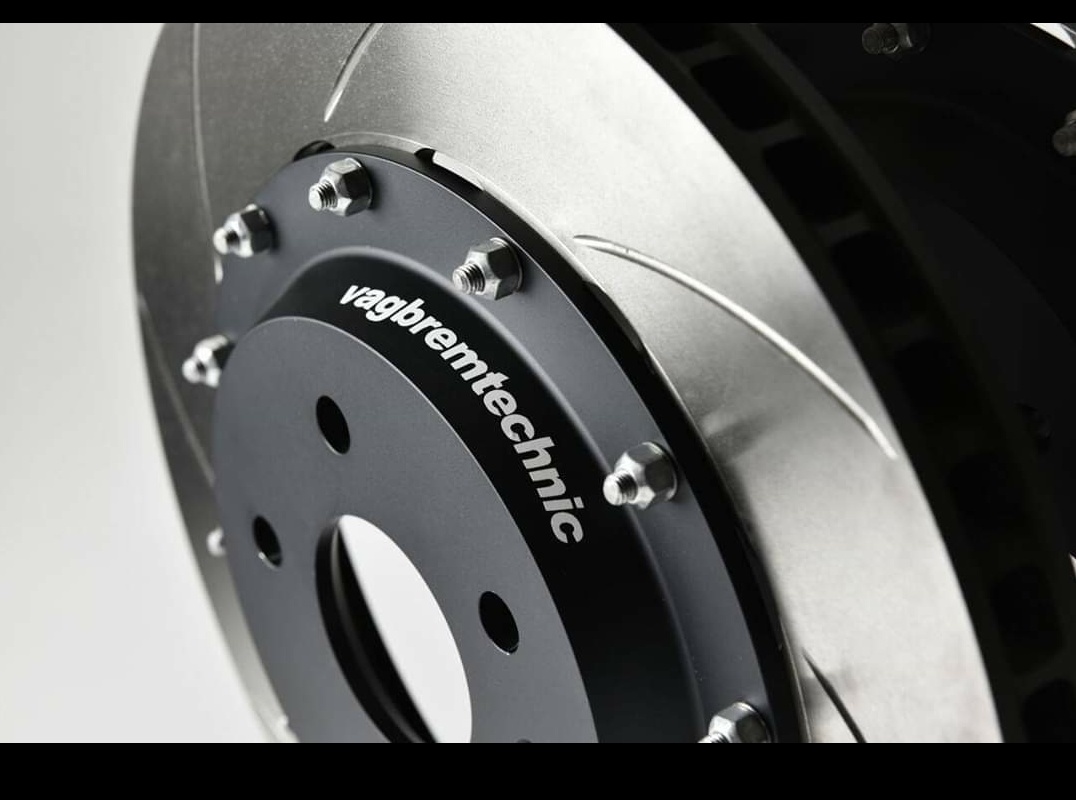

• VBT VagBremTechnic 330mm X 28mm semi floating front.
• ECS Tuning 306mm X 22mm semi floating..View attachment 8643 View attachment 8644
Hi mate, what happens when you need to replace these, do you change the whole lot including the bell or just the outer rotor??? and would they need balanced??
Cracking car by the way
Hi mate
Thanks for the compliment.
It's a strange time I'm having. I ordered the 330mm 2 piece discs and fully happy with that purchase, then I got a call from VagBremTechnic saying there's a delay getting the parts and would I be interested in the 343mm upgrade for a discounted price? It was quite a discount so I'm going for the upgrade.
As far as I know it's just the rotors and bolts and anti rattle bolts that need changing.
