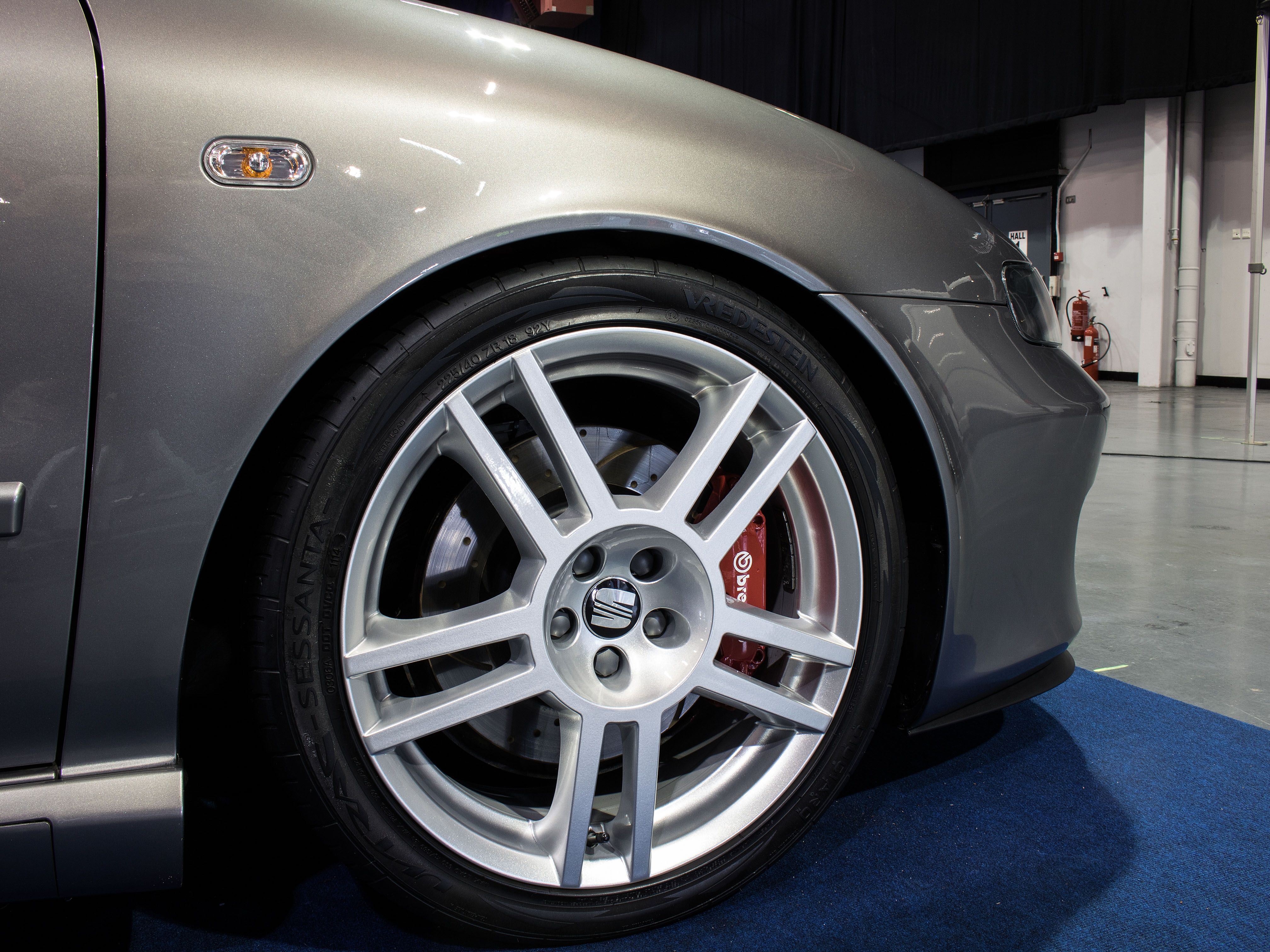

- Standard 4 Pot Brembo's
- EBC Turbo Grooved Brake Discs
- Ferodo DS Performance Pads
- Braided Brake Hose
- Standard 18" Ronal Alloys

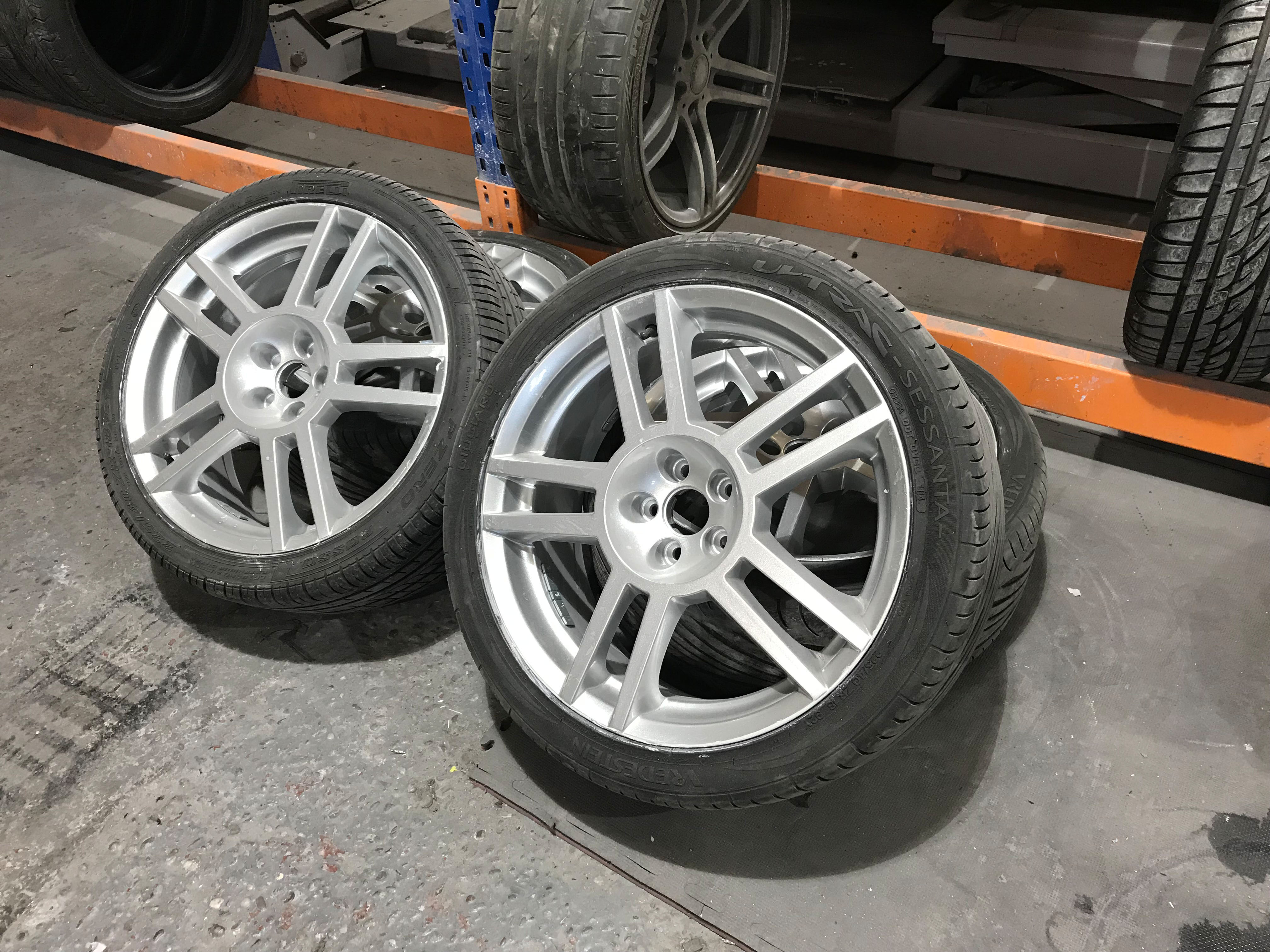

- Full Alloy Refurb in Silver

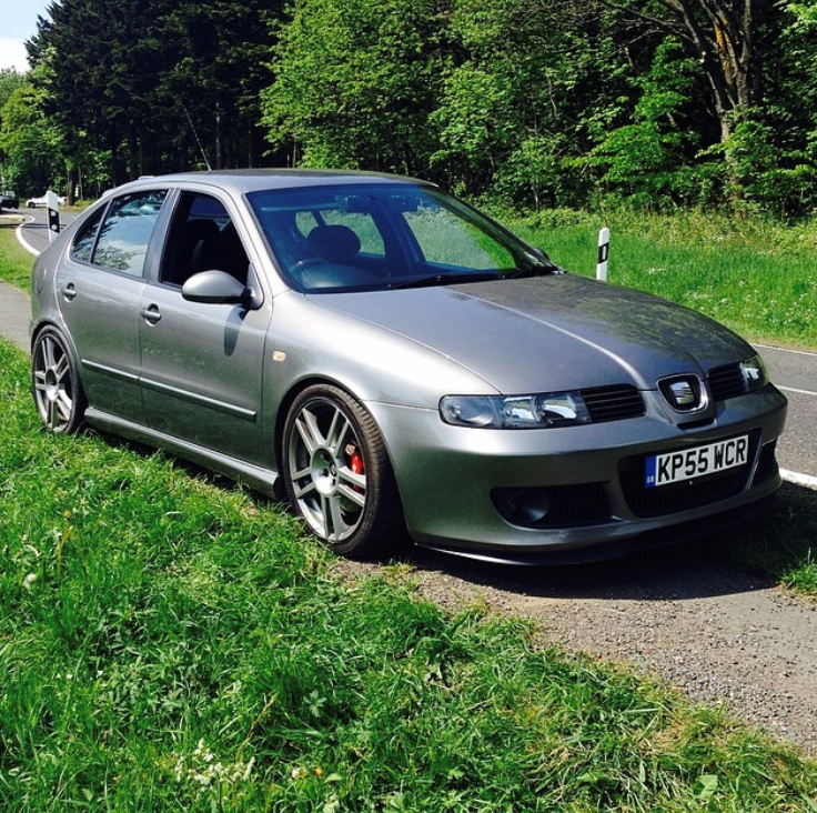

Here She is on collection day:

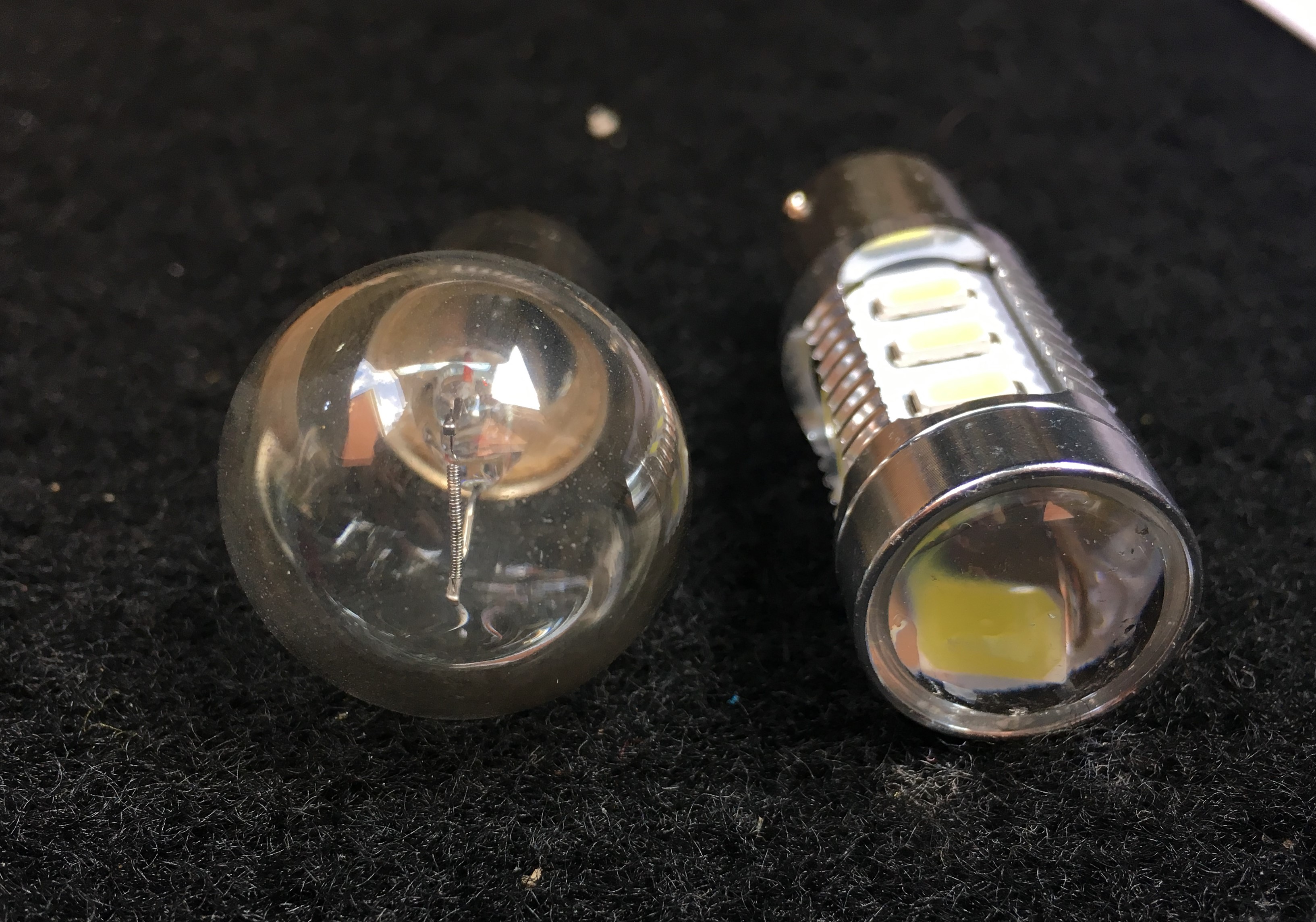

One of the first modifications that i did was changing all interior bulbs & Reverse Light bulbs to Bright White LED's
Unfortunately i have no images of the interior but the before and after is very much night and day, they look a lot smarter and clean.

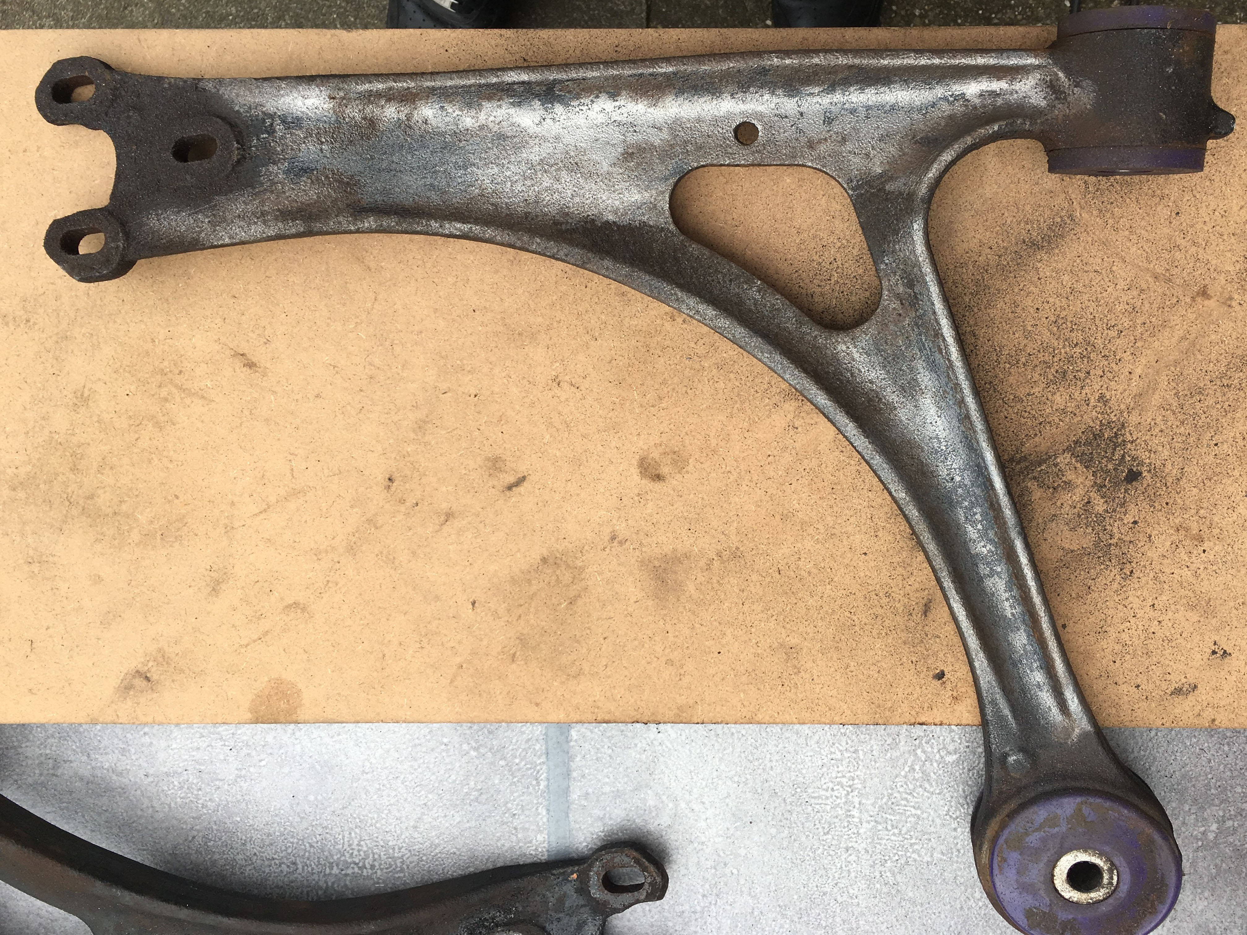

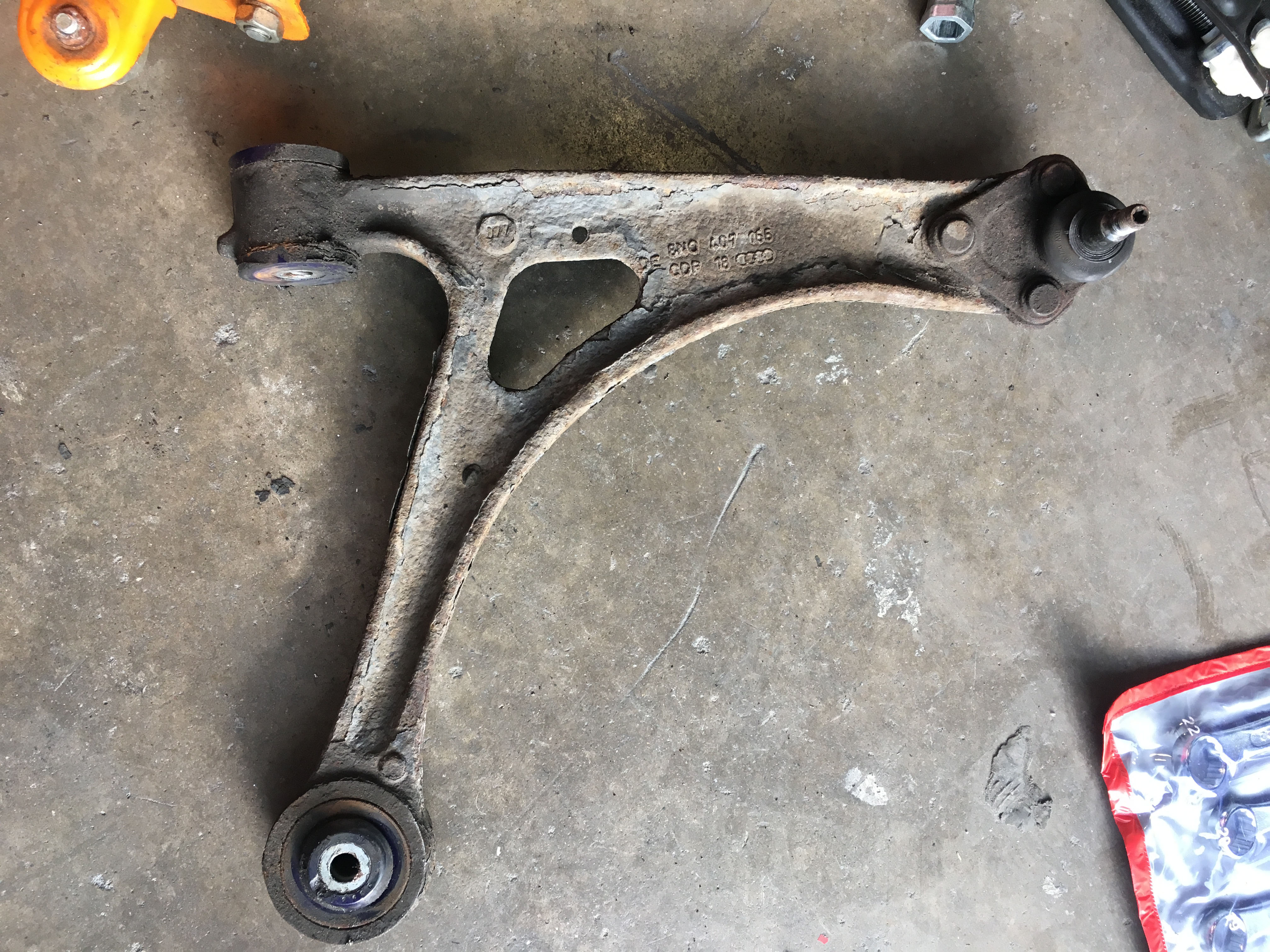

First was the wishbones, i decided to remove them to give them a cleanup and a fresh coat of Hammerite Hammered Black.
Before:
During:
After:
New Ball Joints where purchased too. (Disclaimer: Ball Joints not on the correct arms at this point)

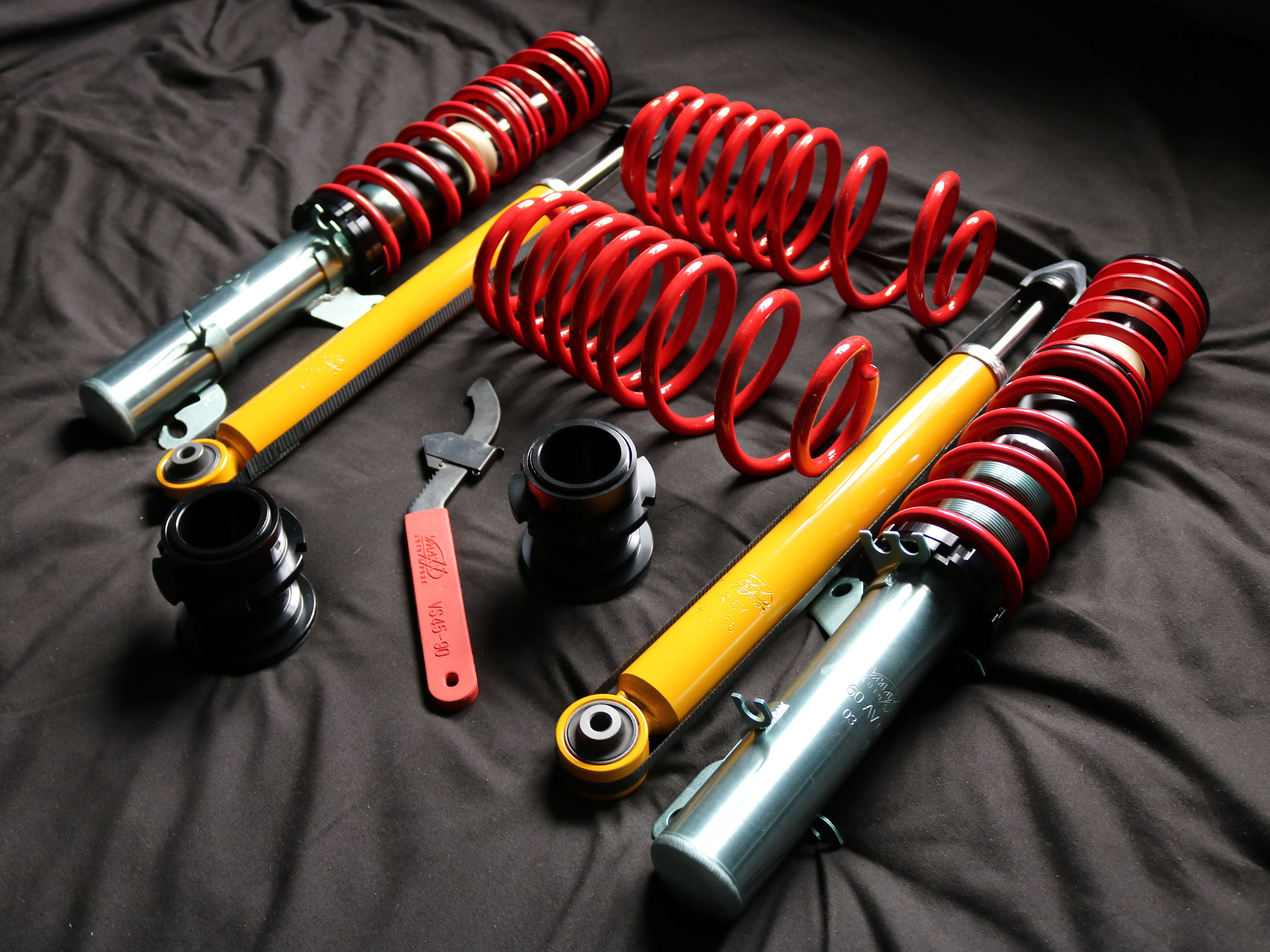

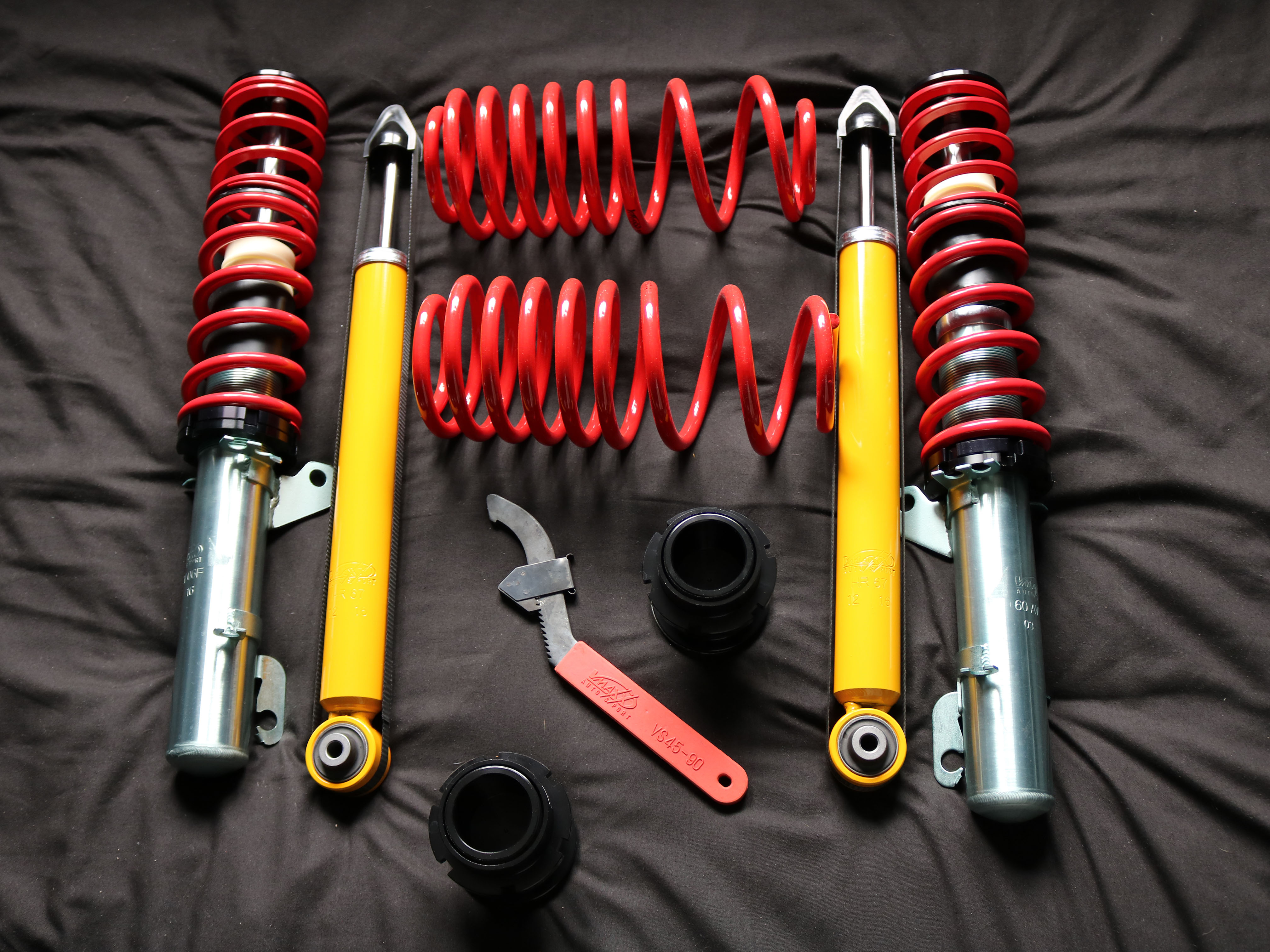

This work was all in anticipation of new Coilovers, not everyone's preferred brand and not the best out there but for the budget at the time they was ideal for me.
Amaxx Coilovers:

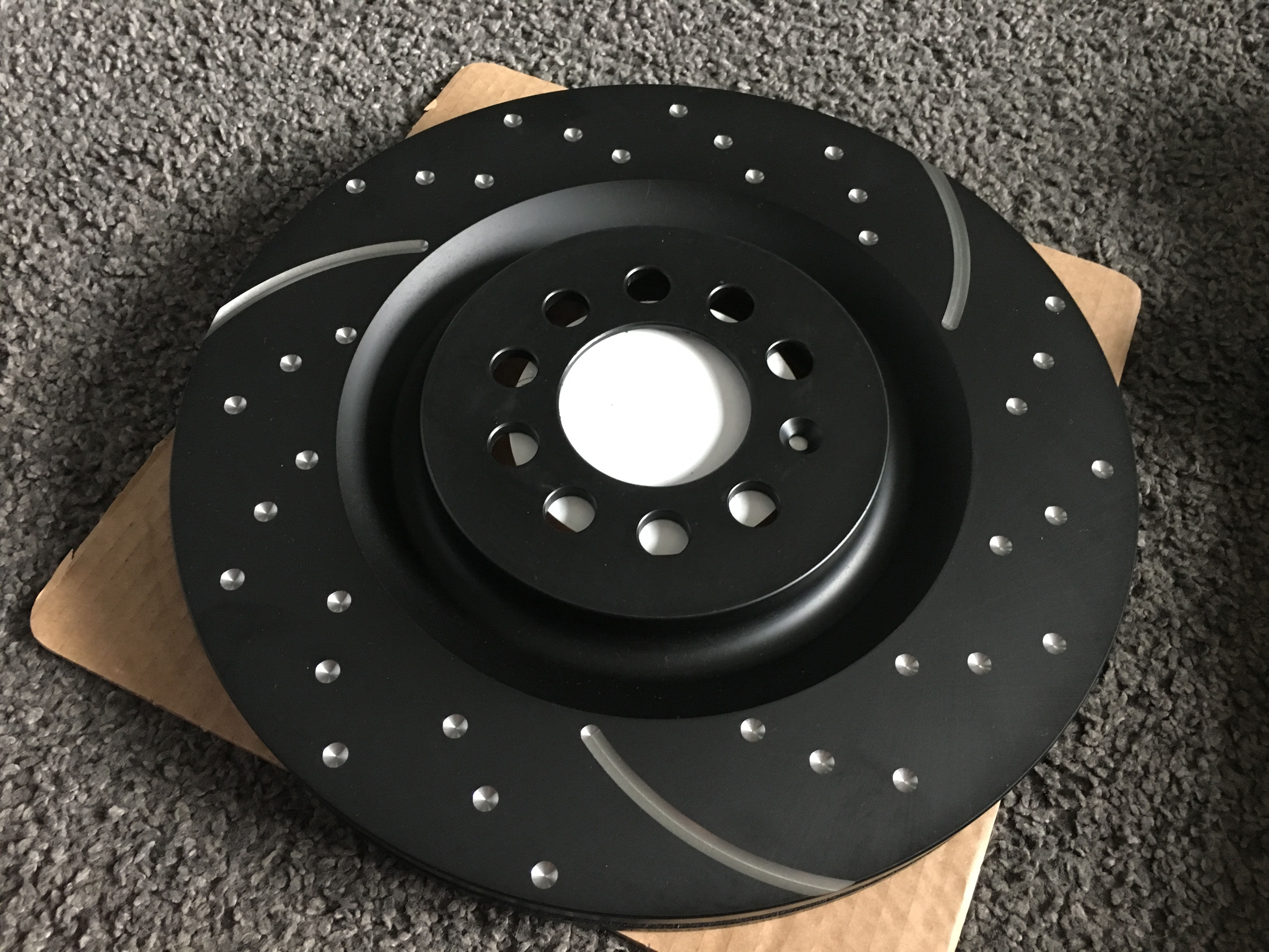

EBC Disc's & Ferodo DS Perfomance Pads:

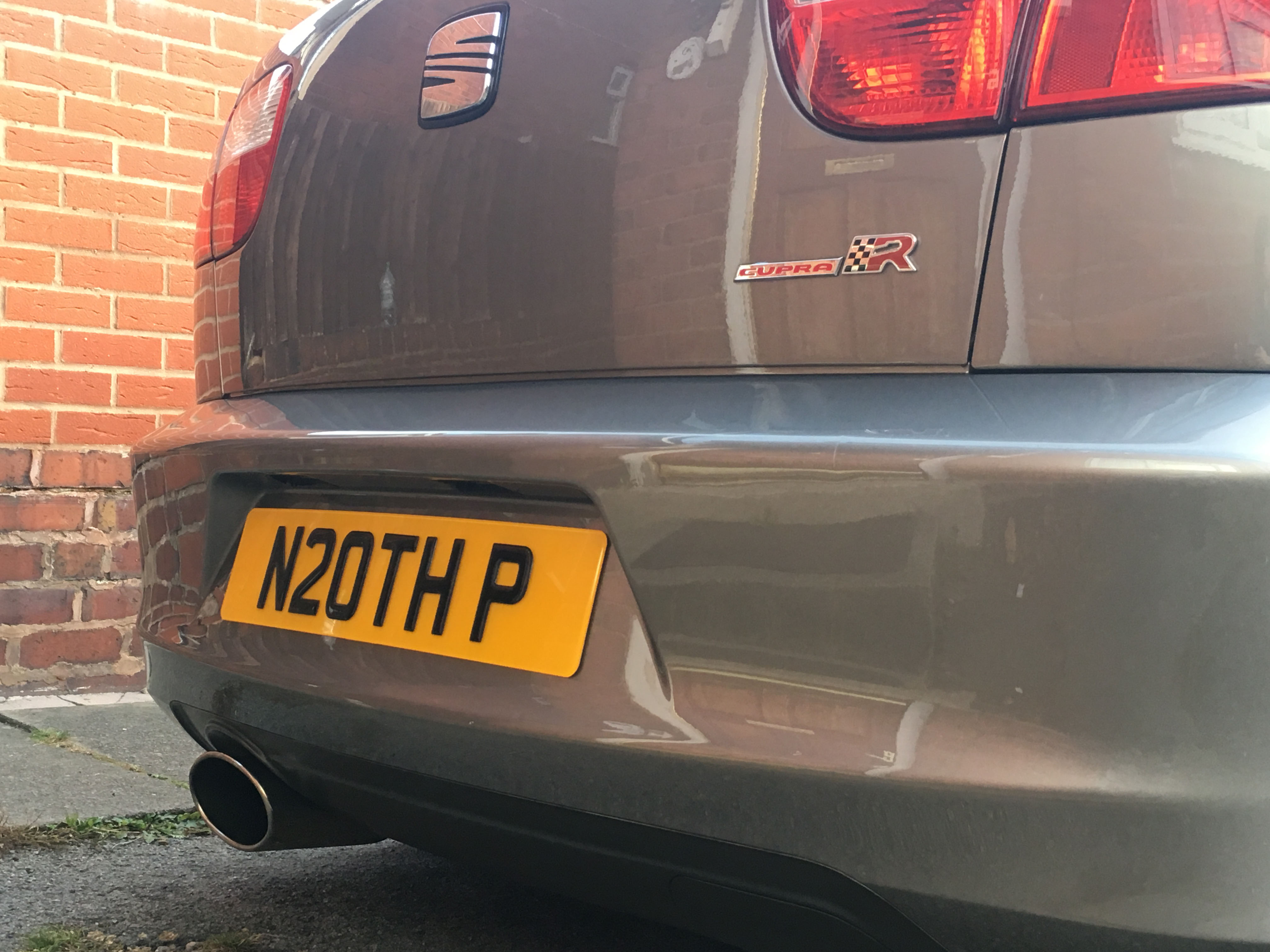

I got all these fitted over the weekend along with putting the private plate on, i could wind the coilovers down more but didn't want to be scraping over everything, plus getting on the drive would of been a struggle if i had of gone any further.

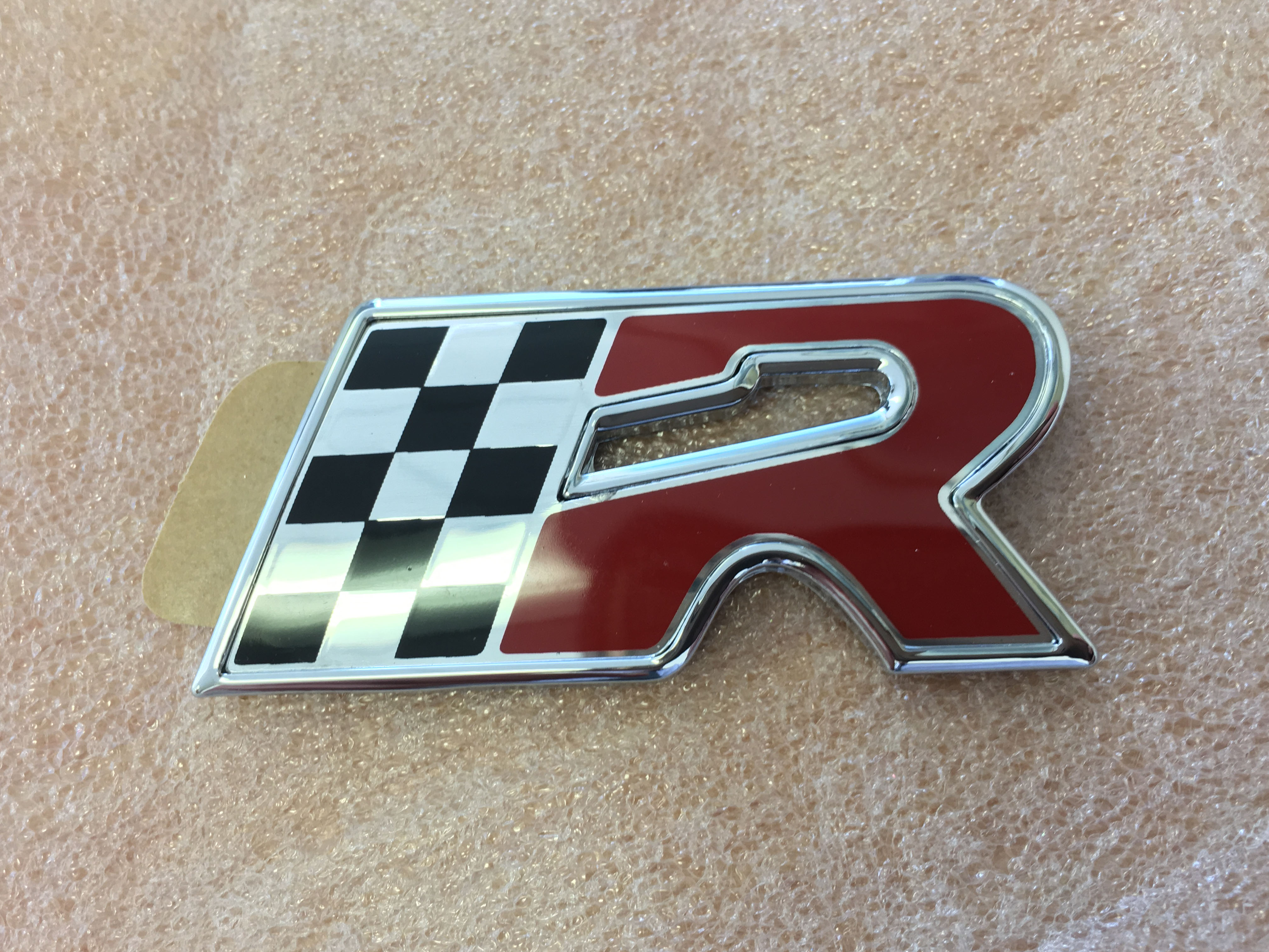

It was time to do a tidy up a couple of other areas, The Wheel Bolt Caps had faded, the Centre Caps where shot & the rear "R" badge was corroded.
Bolt Caps:
Centre Caps:

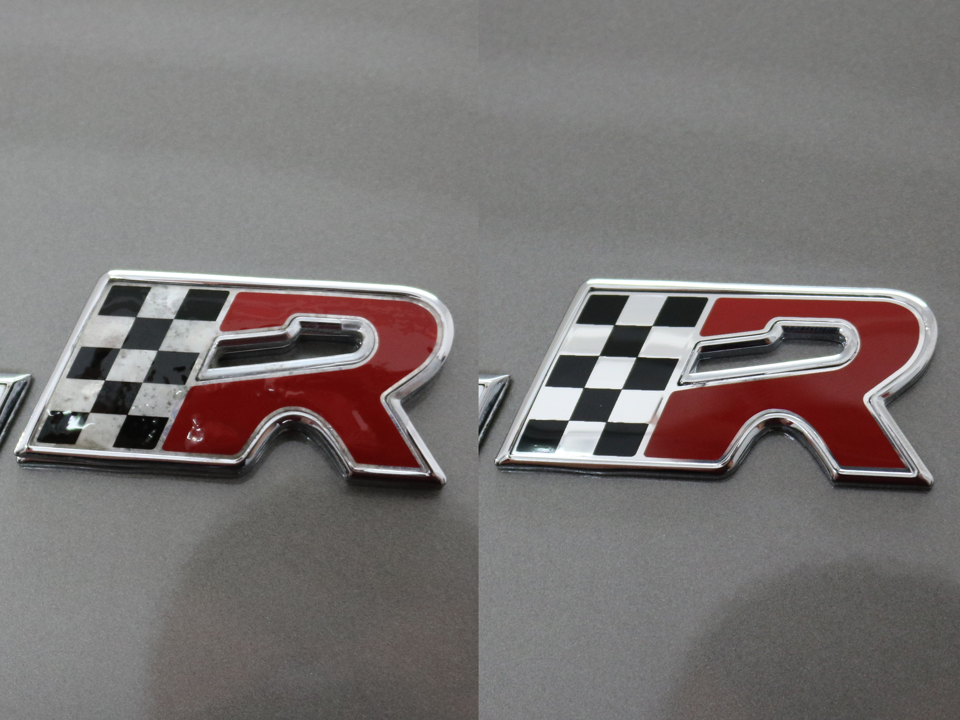

New "R" Badges:
Before & After "R" Badges:

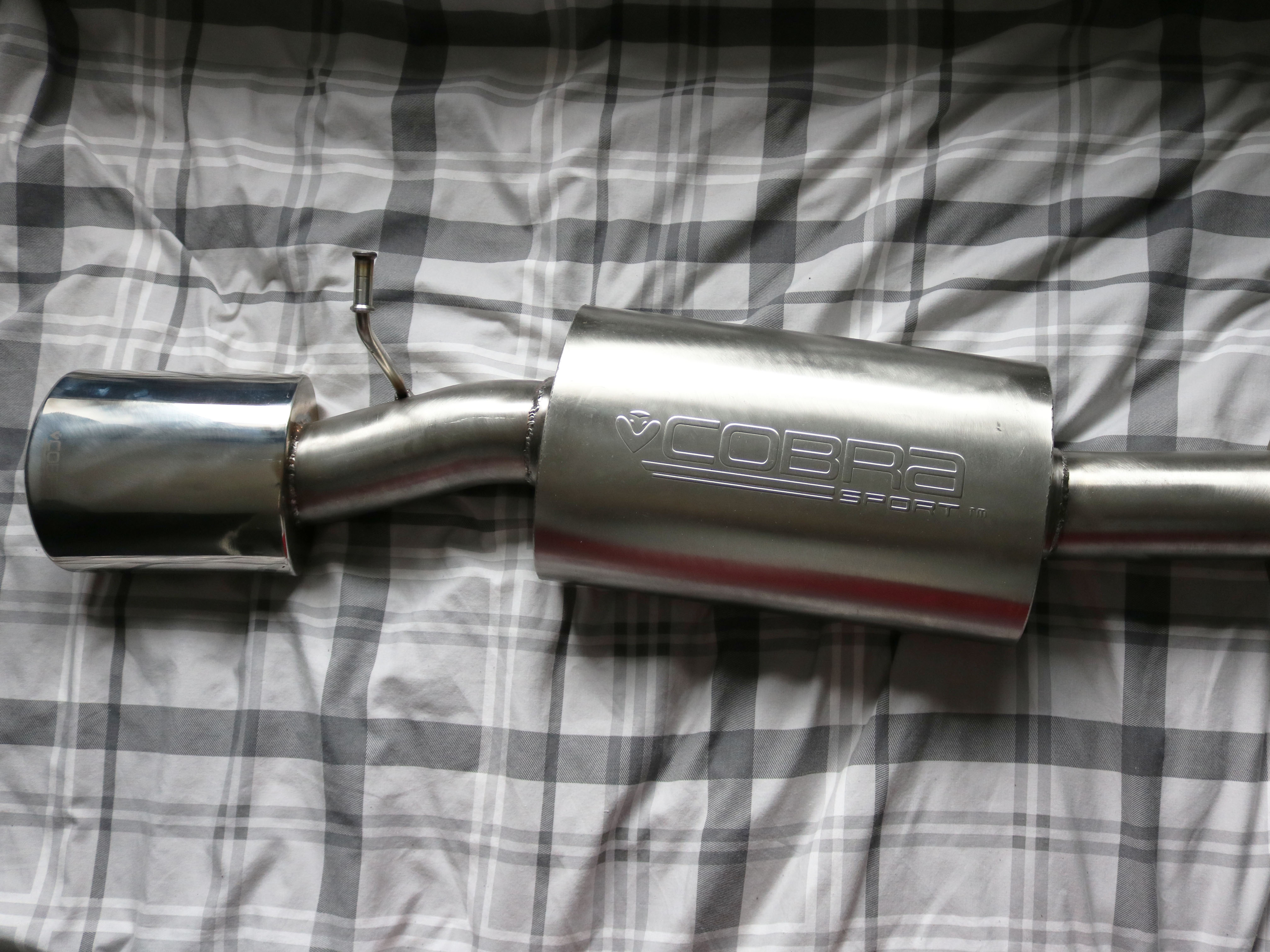

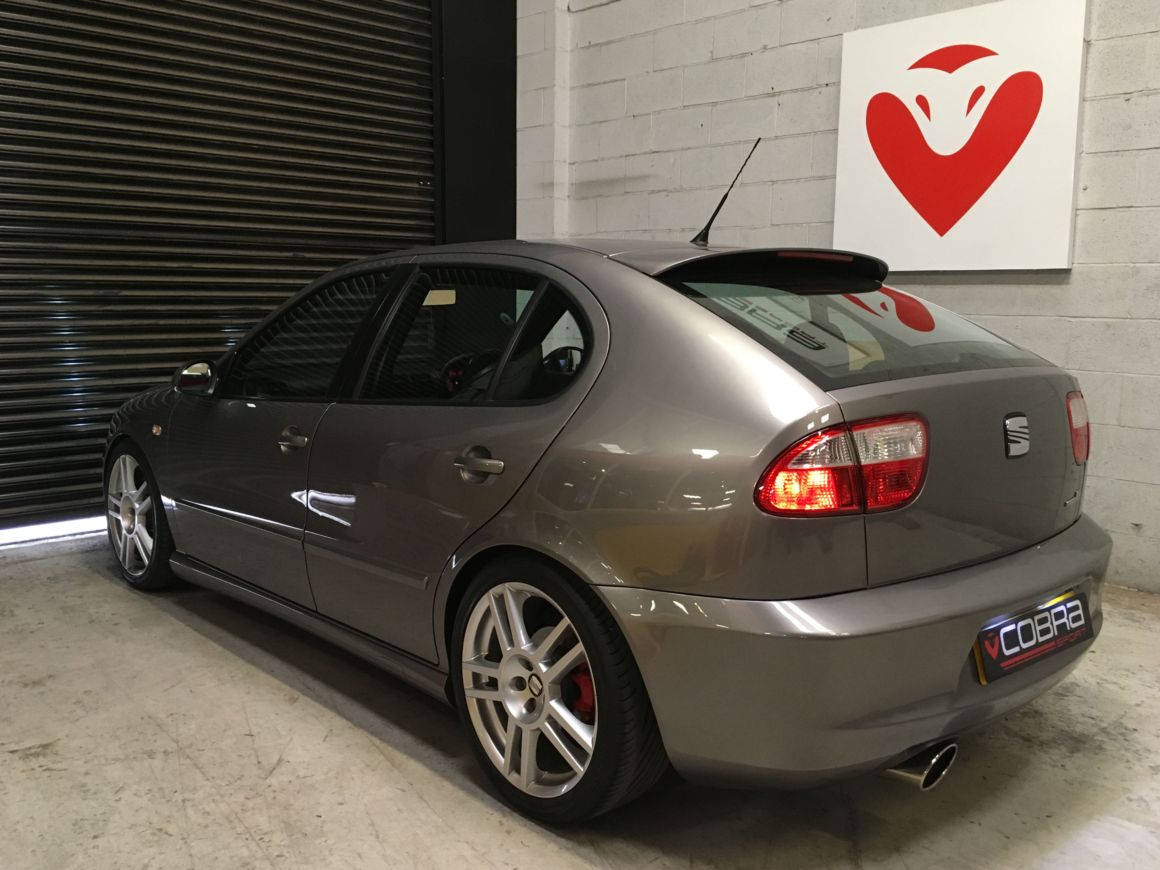

Exhaust!
This is probably the most expensive purchase I've made for the Leon to date, I purchased a full Cobra 3" Turbo Back Exhaust system.
Though I was happy it did come with challenges over the next couple of months, the gasket supplied was leaking from the downpipe which was just throwing fumes into the cab. I then contacted cobra who very helpfully sent me a replacement. again this did not work. After contacting them again with the same exhaust leak they asked for me to drive to their store in Sheffield. They tried a couple of things and resulted in us ordering a standard gasket from Seat. Unfortunately this wasn't in stock and we had to wait on parts.
A week later I made the 200 mile round trip back to Cobra to get the new gasket fitted, during this time i also purchased some original factory turbo bolts from TPS.
Thankfully this was all resolved and the exhaust was sounding perfect! No leaks and the tip was finally sitting correctly in the recess!
Exhaust Delivery Day:
Finally Sorted:
I have to say despite the issues I had along the way all this was sorted under warranty and only cost me the fuel to get to Cobra, the customer support was quick and helpful and the build quality is bang on, the exhaust sound is exactly what I was looking for a nice deep rumble and most importantly a better flowing system with mandrel bends rather than some systems I have seen.

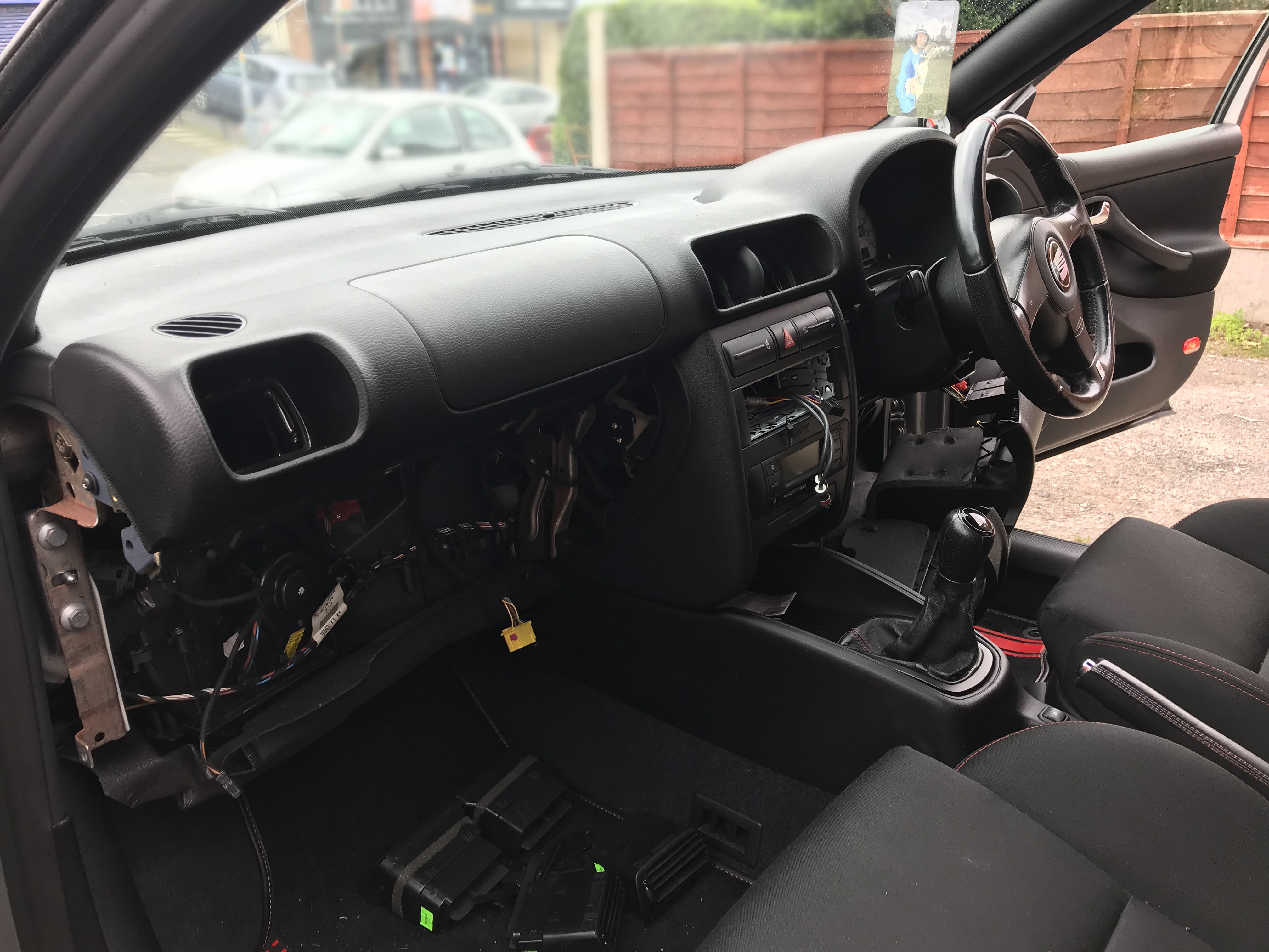

Water Leak!

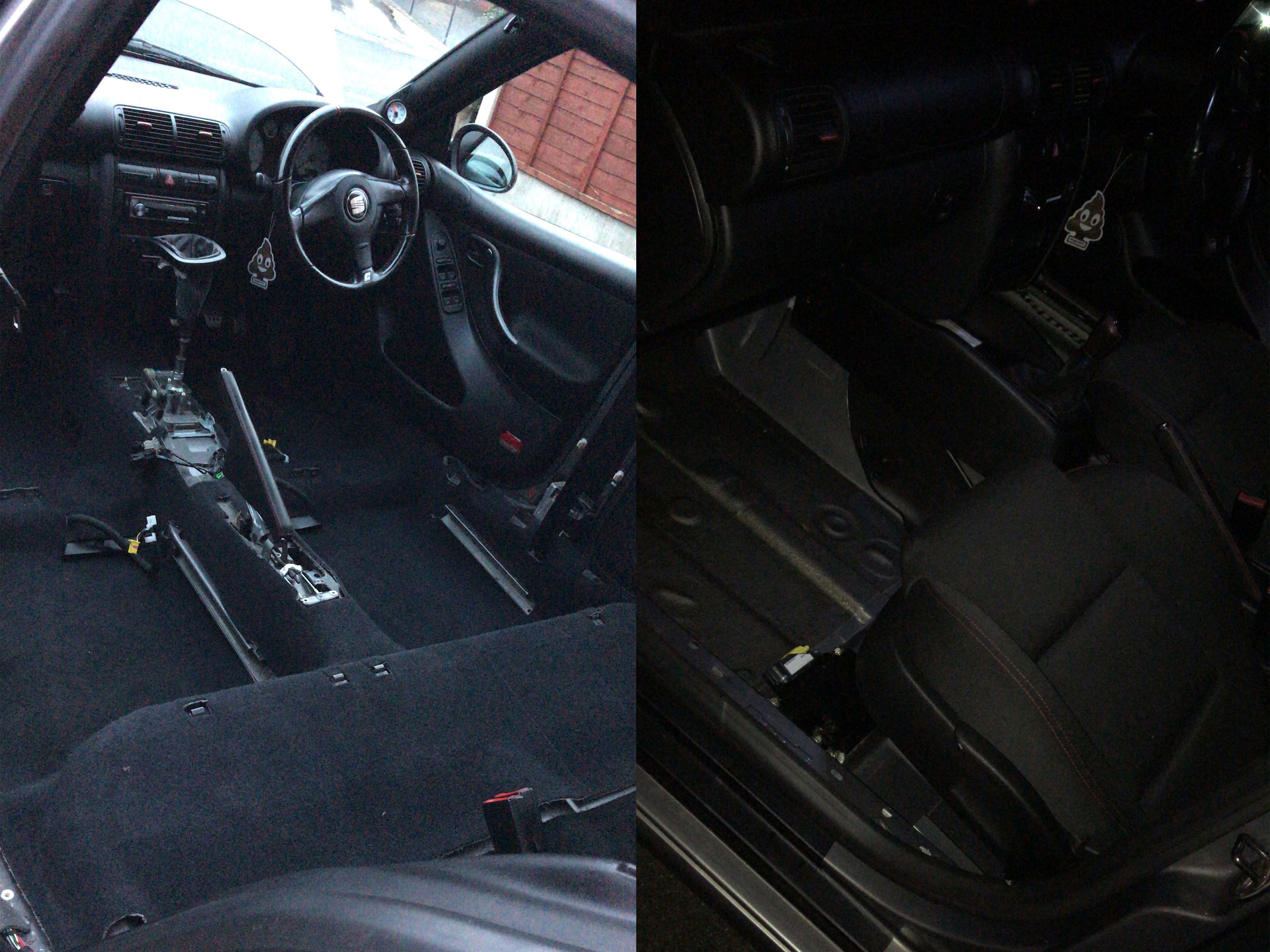

So during the cold of December the inevitable happened. The dreaded water leak, this was the last thing i wanted to happen 3 days before Christmas but so be it.
First was to remove all interior and carpets, I spent over new year driving round in what felt like a tin can while the carpets were drying at work in the office. although it was cold & damp it wasn't all bad, the exhaust note was a lot louder without the sound deadening & I managed to gain a couple of quid.
While the car was stripped and the water feature in the back was removed it was time to find the source of the issue, first point of call was door sills, after testing them all they looked fine, it seemed someone had already been at them as they were silicone'd all round. While it's not ideal I do plan to remove this, clean them up and reseal with Butle Tape.
Next was to look at the Pollen Filter and to my surprise the drain holes in both wings were completely blocked up with leaves and dirt! So when we had snow and it melted after sitting on the windscreen it flooded under the scuttle panel and the water had ruined the seal around the pollen filter.
The scuttle panel was removed, drain holes unblocked and cleaned, pollen filter re-sealed and new filter fitted. I continued to drive without the carpets until mid January when I had the time to put them back in and to ensure I was no longer having leaking issues.

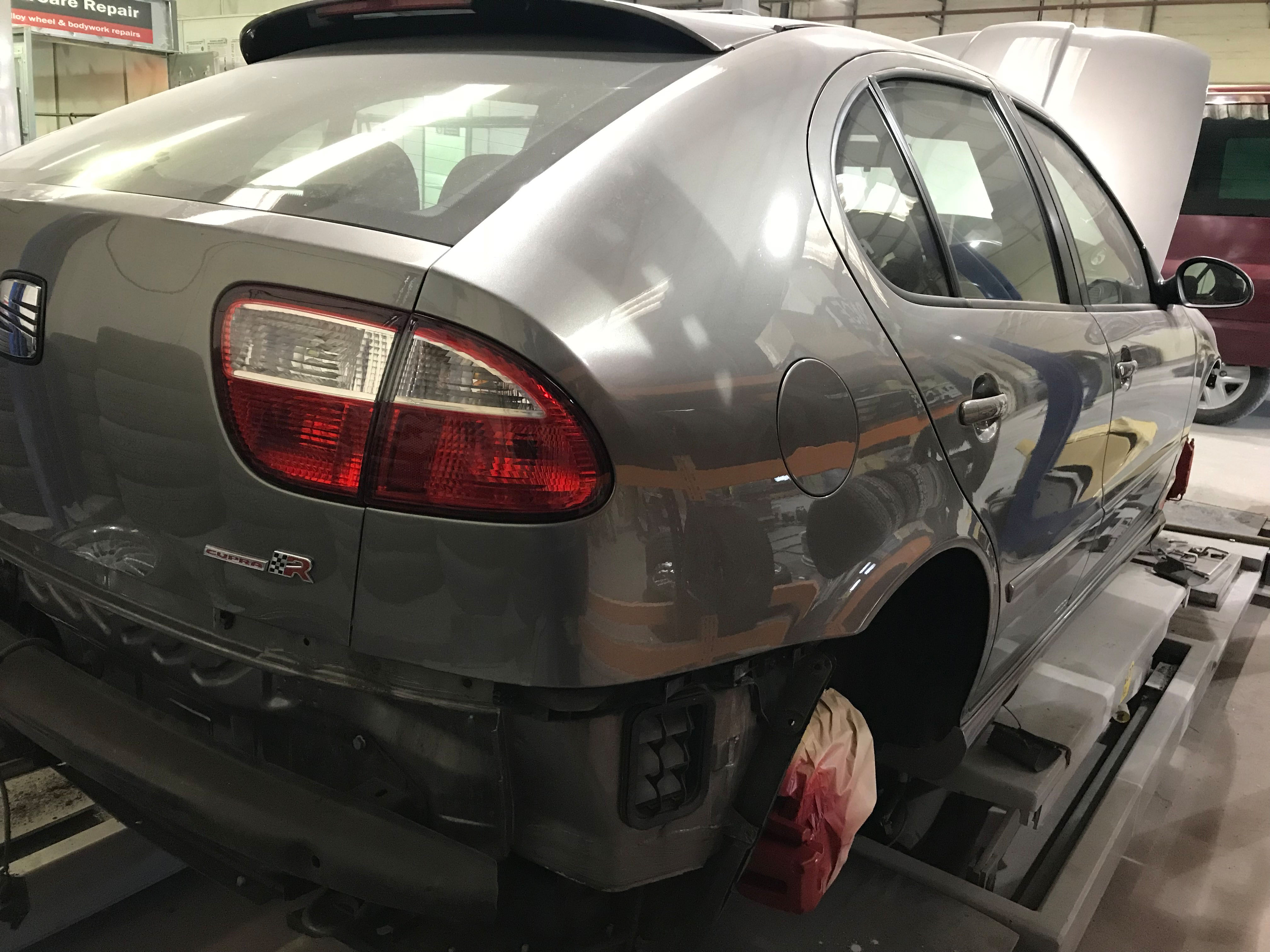

First call was to the bodyshop to ensure all area's on the car where perfect, the bumpers, calipers & wheels required some attention.
After agreeing a time scale and the reason for needing the work done the paint shop got straight on it and the finish is near perfection.
Whilst i was happy with the overall finish and how the paintwork came out it was a must for me to have a full paint correction and ceramic coat application at my local detailing shop...

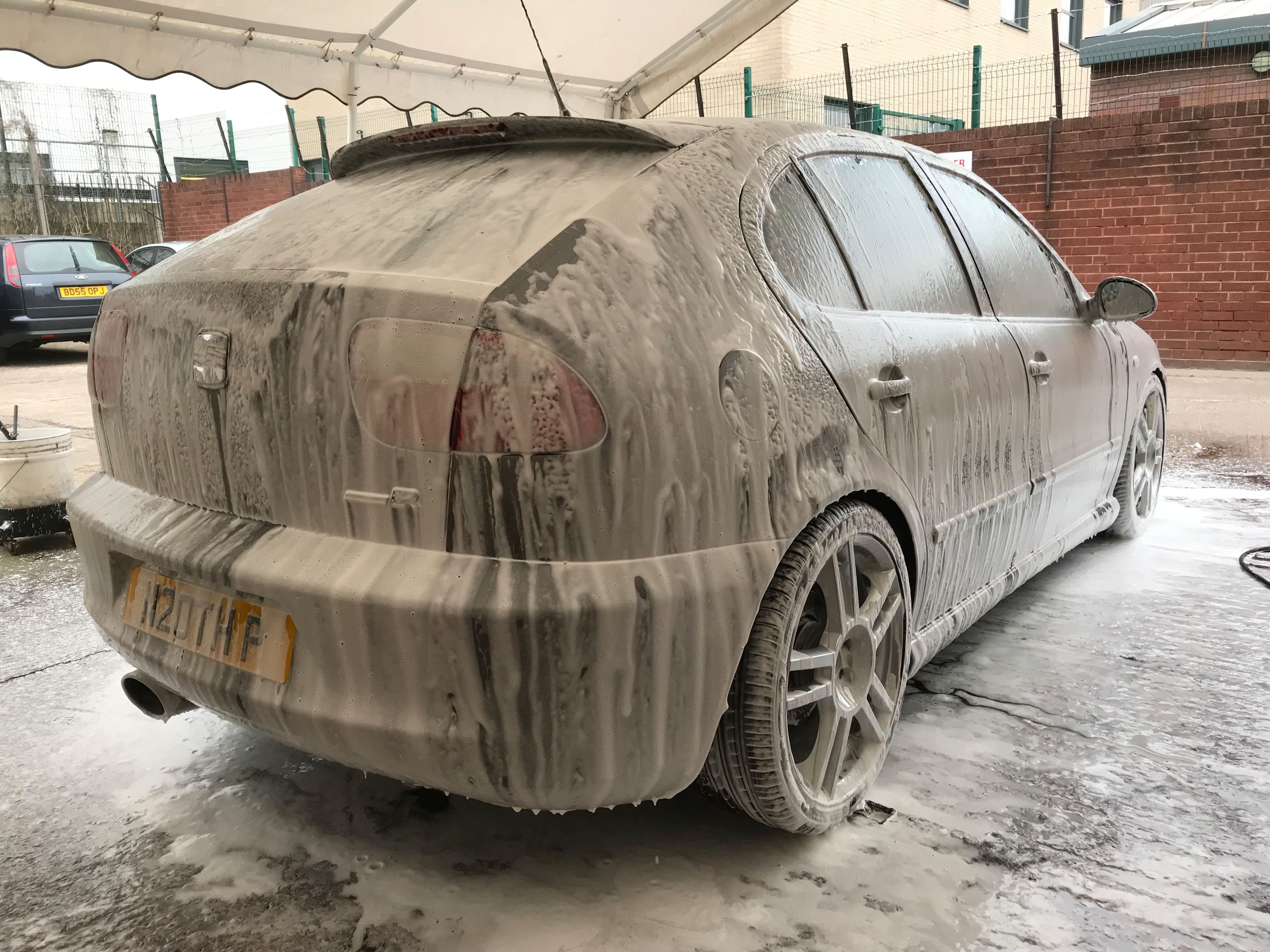

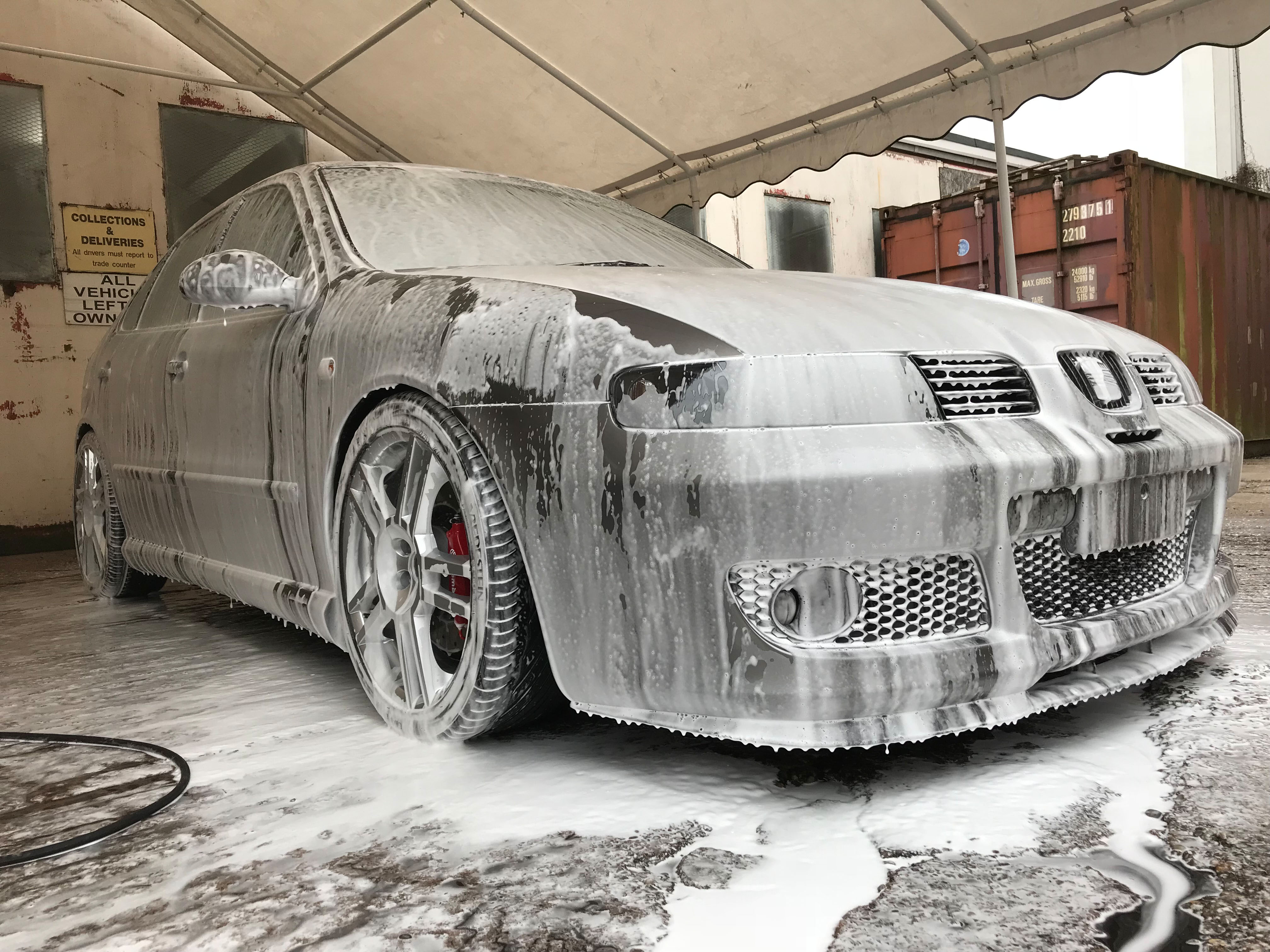

Once the paint had cured for a couple of weeks it was time to do a full detail, this included...

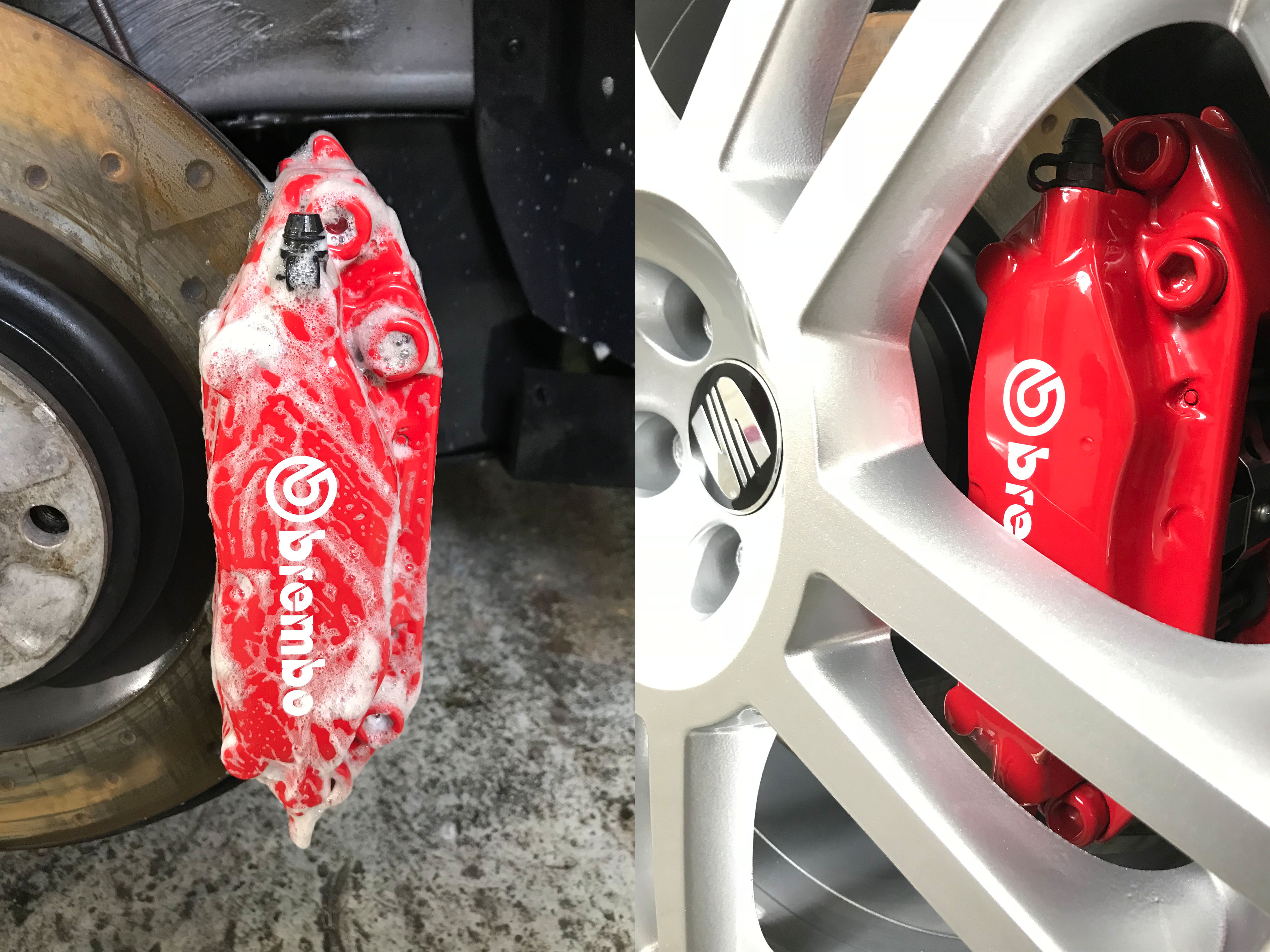

- 2 Step washing with snow foam & TFR
- Removal of Wheels to deep clean & Ceramic Coat Barrels/Arches & Calipers
- Colour/Wet Sanding any areas needed
- 2 Stage Machine Polishing Cut & Refine
- Ceramic Coat with Gtechniq Crystal Serum & Exo V2 on top covering the entire car
- Glass Sealant
- Exhaust Polishing
- Tyre Shine
- Deep Interior Clean with Wet Vac, Seats & Carpets also protected
Here is a handful of the pictures taken throughout the detailing process...

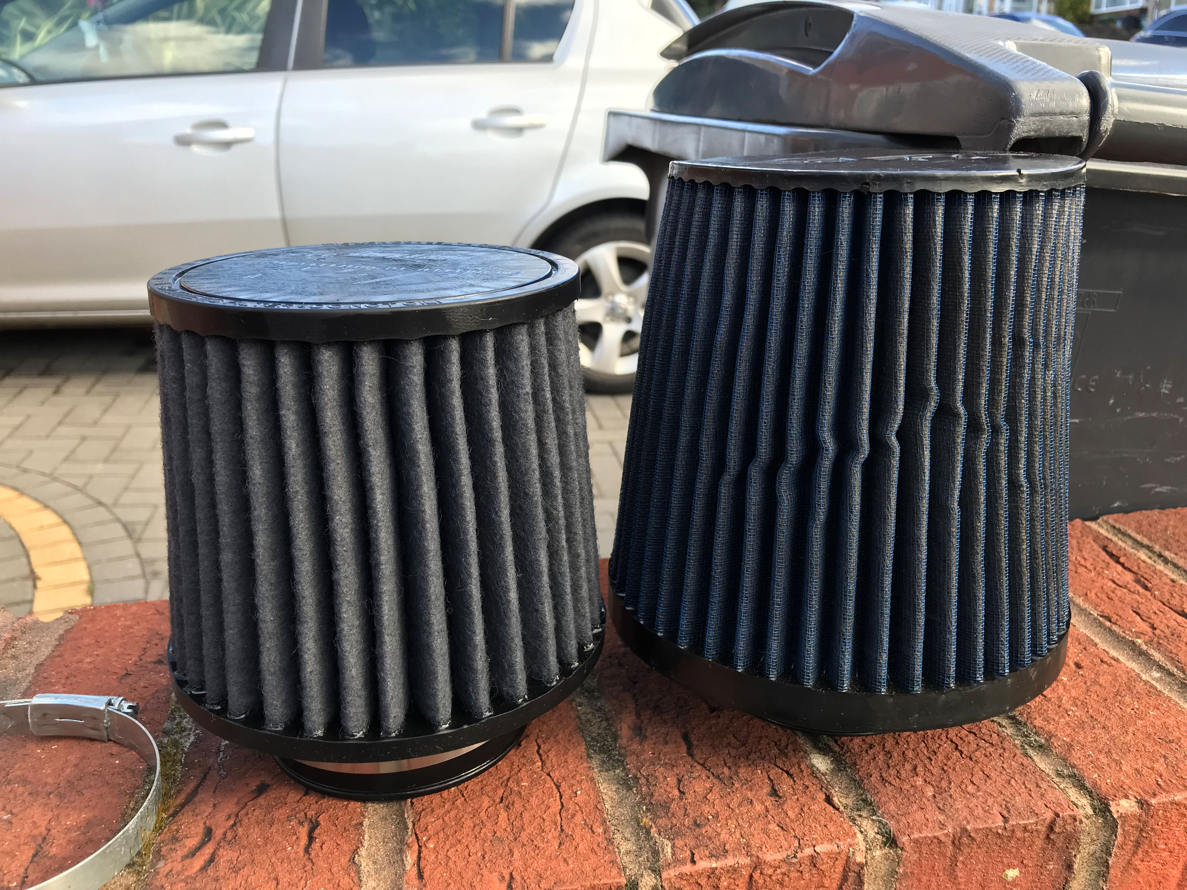

I heard good things about a dry cone air filter and my current one had seen better days so it was time to replace, at the same time i also purchased a new front splitter from TPS and a Shim Kit to prevent gearbox wear.
AEM Air Filter (Before/Difference/After):

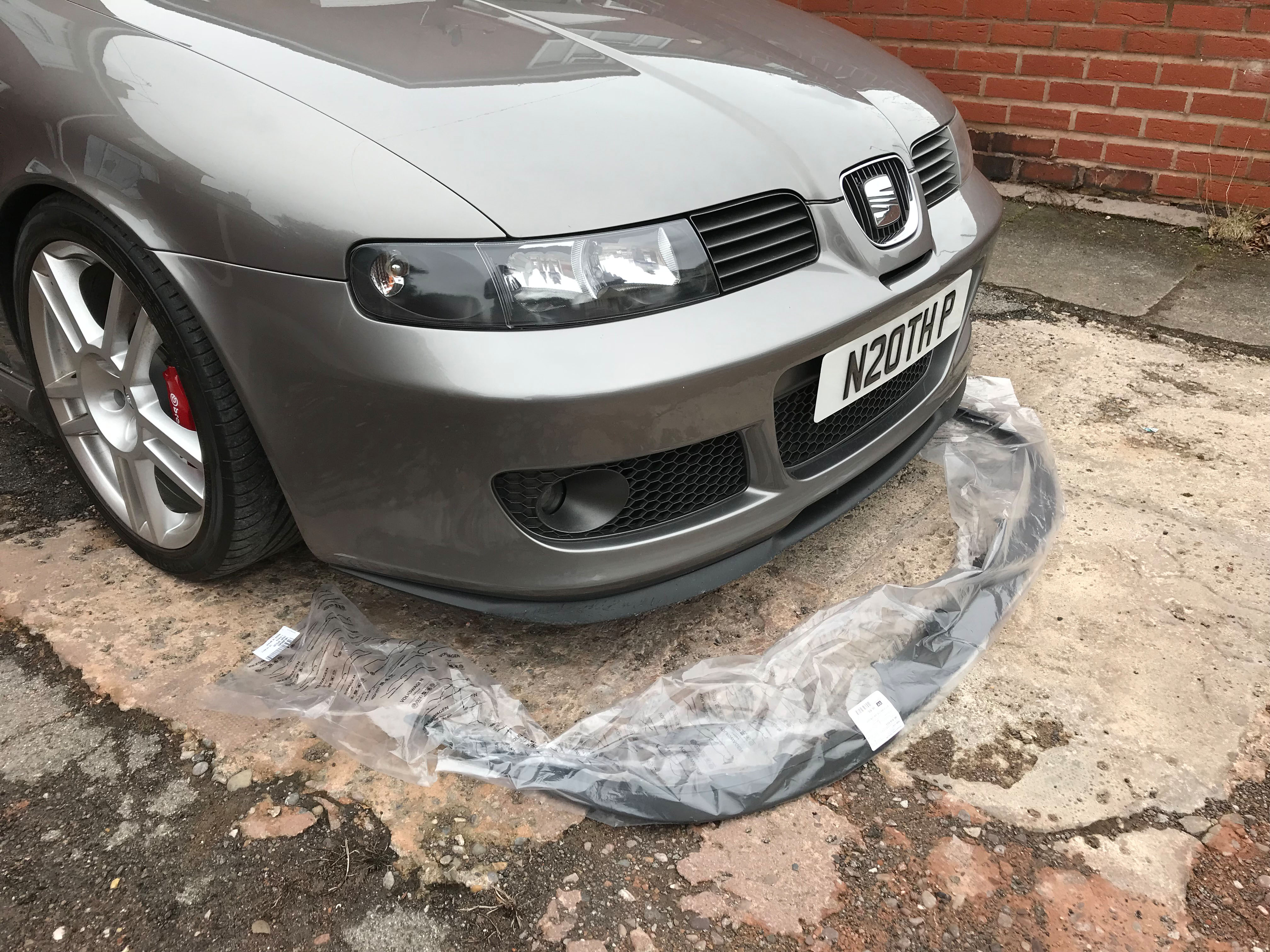

Front Splitter:

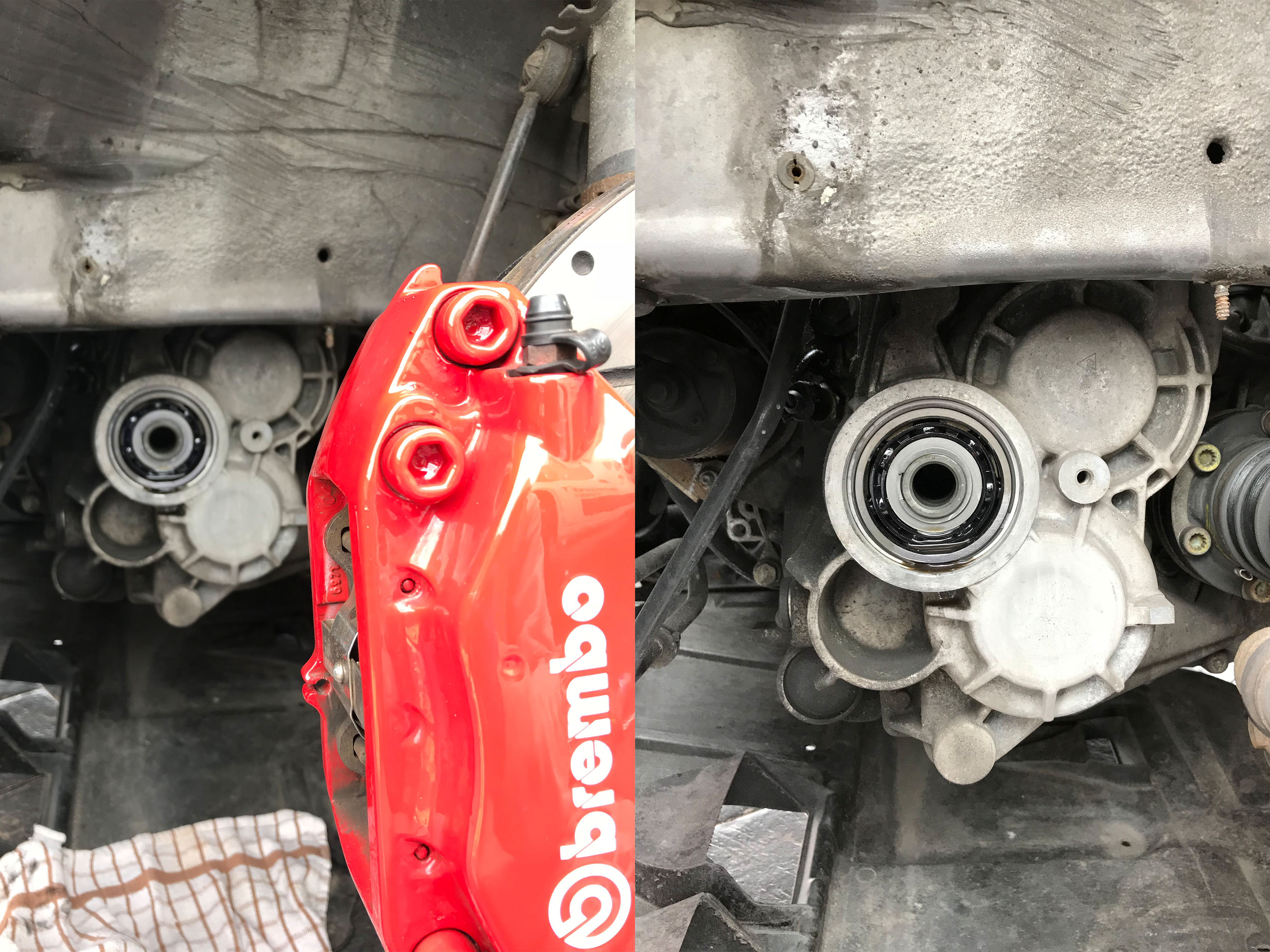

Shim Kit Fitting:
After fitting the Shim Kit i did notice there was no play at all when you give it a wiggle, however difference in gear changes and whining wasn't really noticeable, but not a problem in the first place. i suppose its just one of those things just for peace of mind.

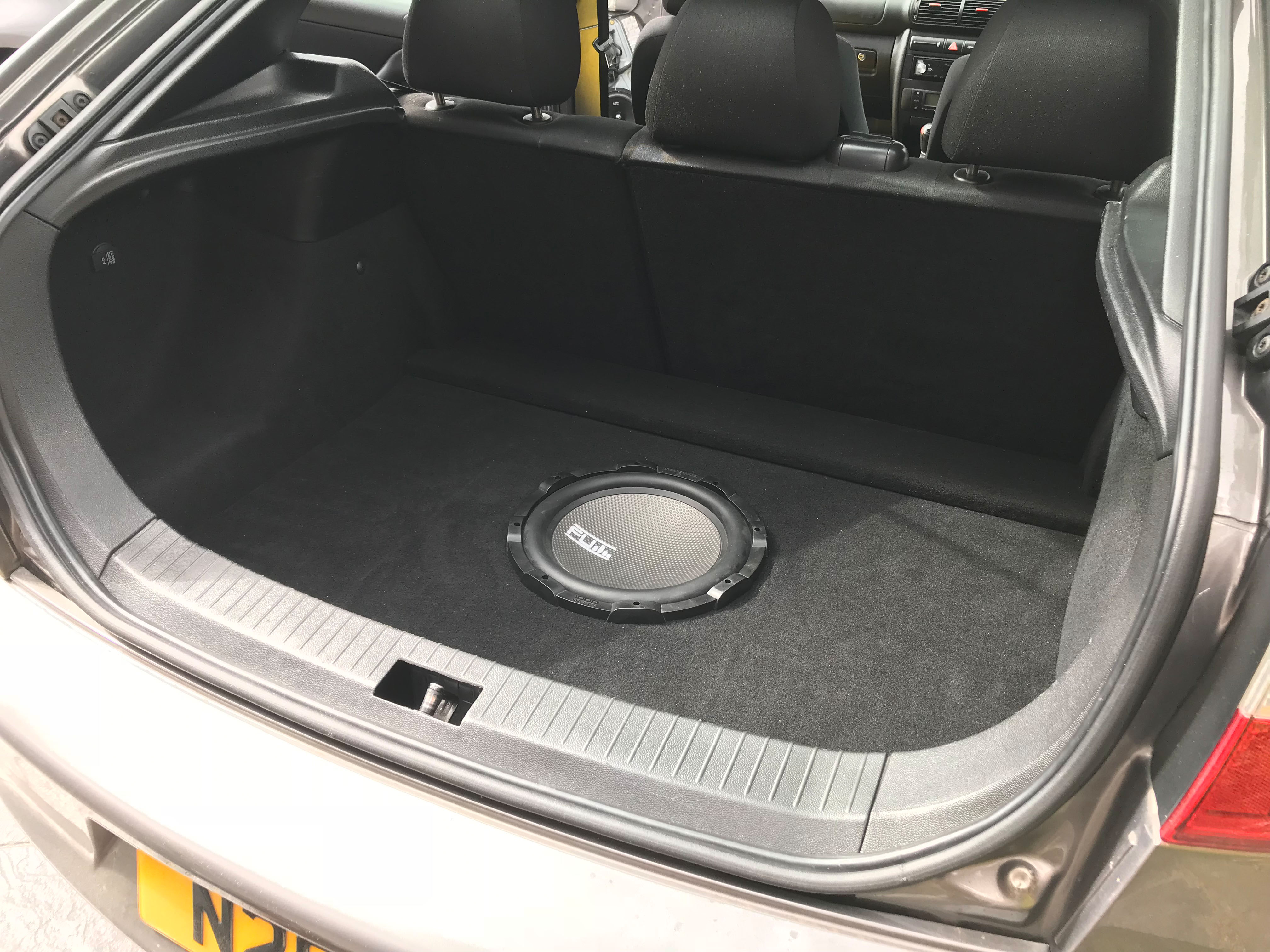

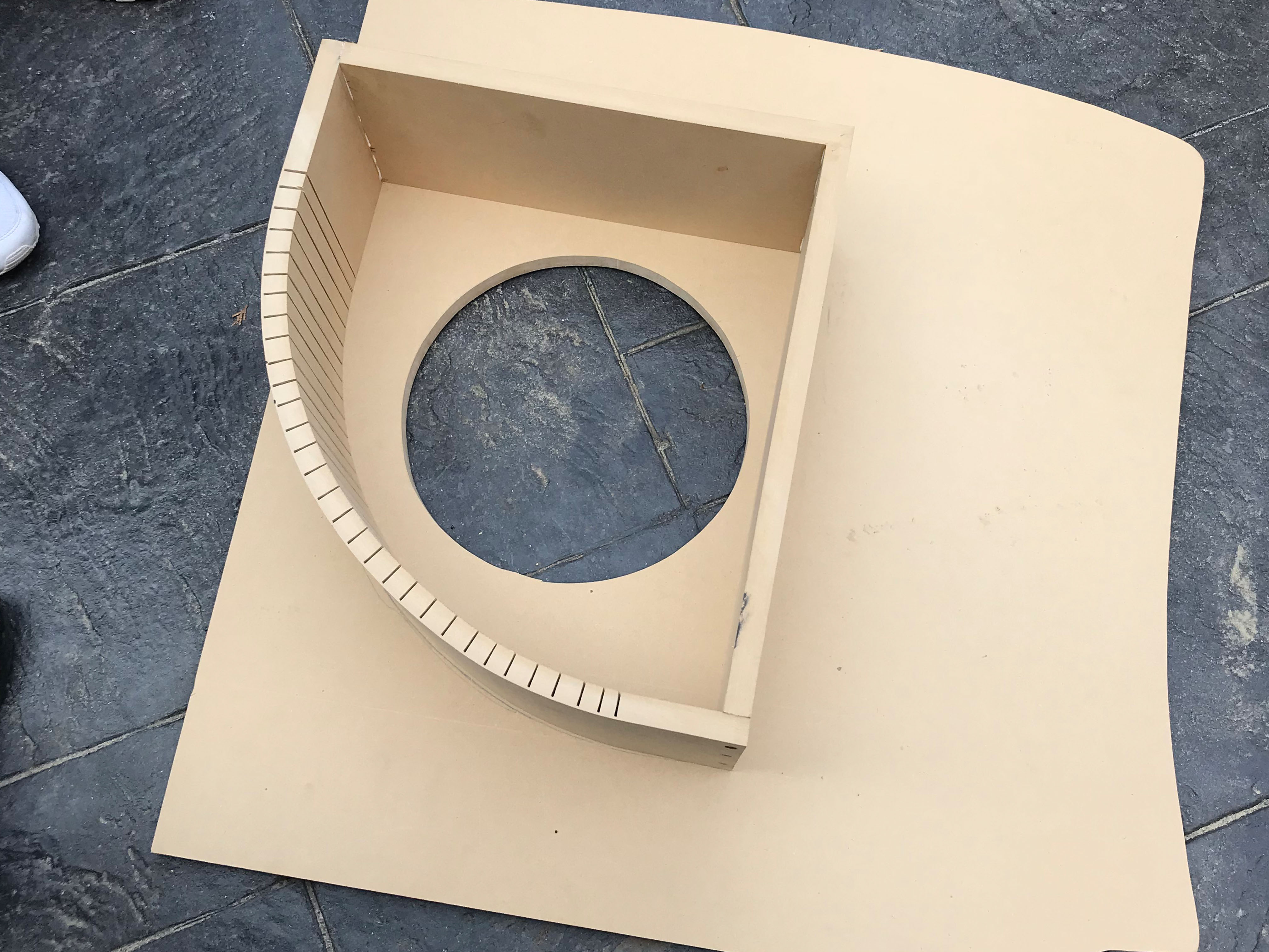

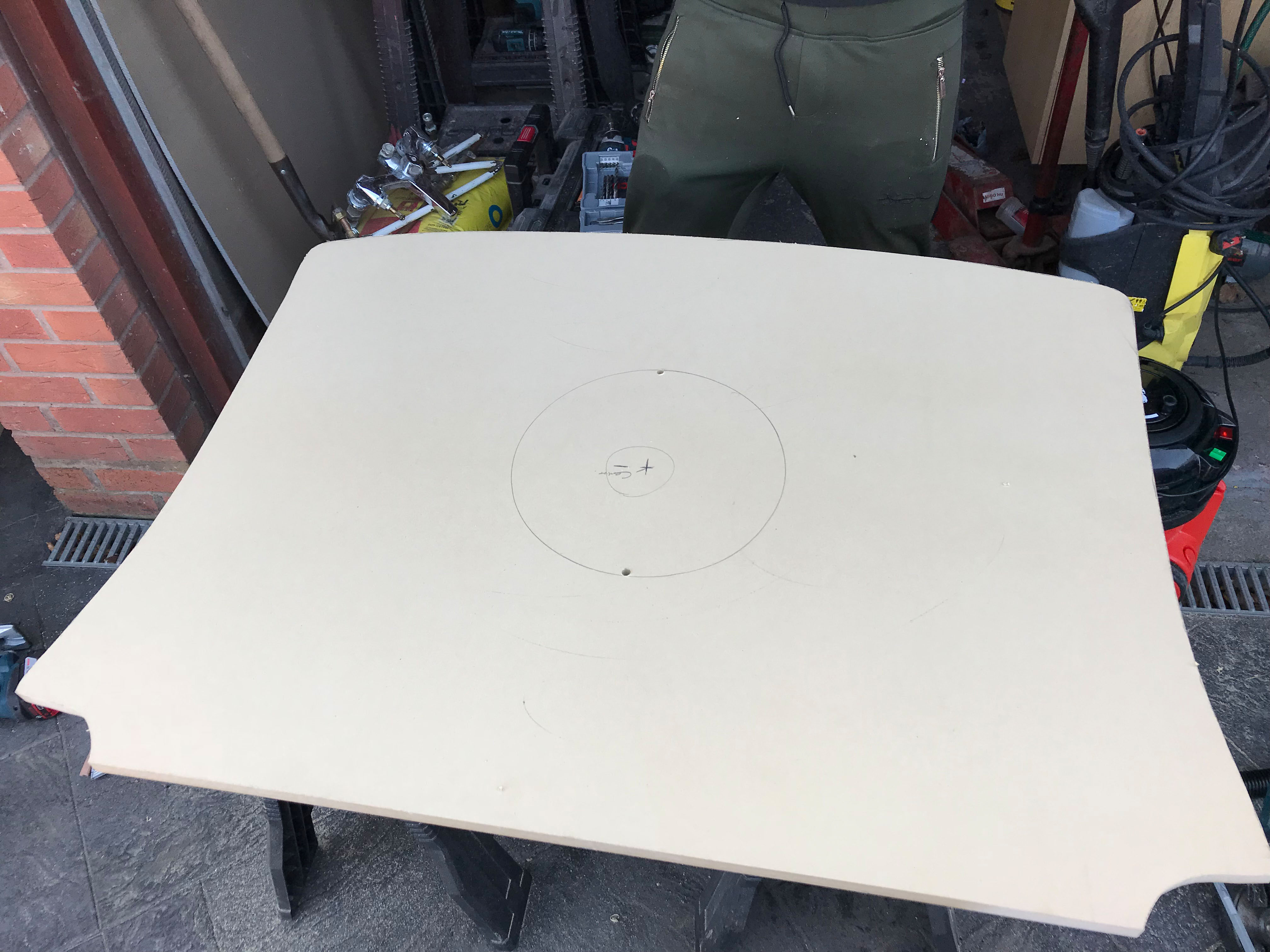

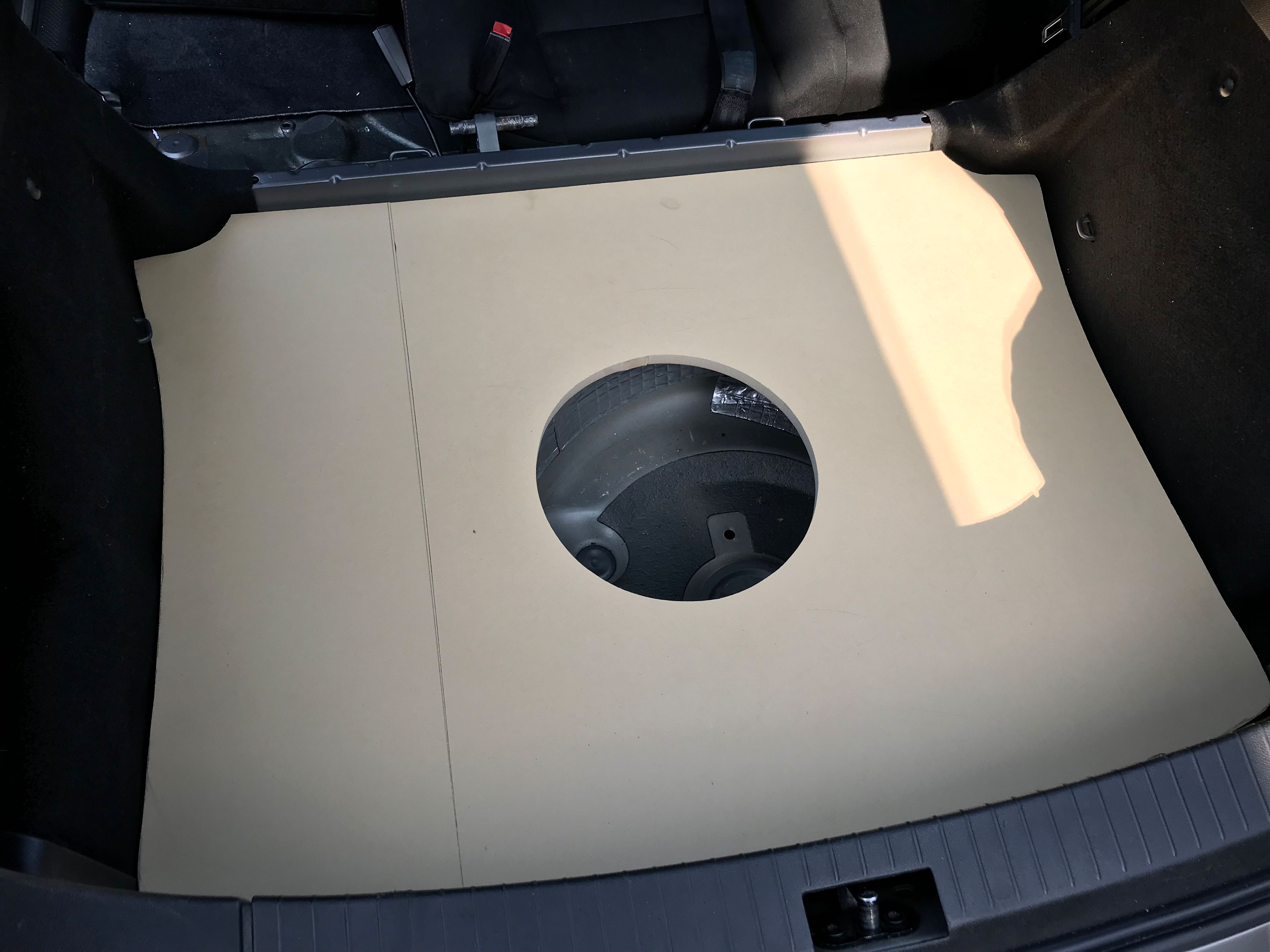

The time came at the end of April to do a few audio upgrades, I've always enjoyed sound systems since I started driving but have always wanted to make them as clean looking as possible, I've never been one to throw just a big woofer box in the boot with an amp at the side of it with flashing blue lights. I was searching for a clean look so decided to create a false floor style build in the boot.
I started out tracing around the boot carpet onto a sheet of 12mm MDF, then to build the box I attempted Kerfing Wood for the first time to fit in the wheel well, I was happy with how it came out and learned a lot for future projects.
The wood does have a cut down the one side to allow ease of access to the amp screwed underneath and also to make getting it in and out a lot easier.
I ordered some carpet online that was as close to OE finish as I could find.
Speakers were also installed in both Front & Rear doors along with sound deadening throughout although I have no pictures of this.
The Subwoofer was given to me by a friend who had no use for it, although this has served me well so far I'm still looking to upgrade to a VIBE one in the future to match with the VIBE Speakers and AMP installed in the car.
Here is how the build went:
I was really happy with how this turned out and the sound deadening makes for good bass throughout the car with no rattles at all! some will say doing this the boot becomes impractical however I never store anything in the boot or use it for that matter. the car is always left clutter free as I cannot stand rattles.

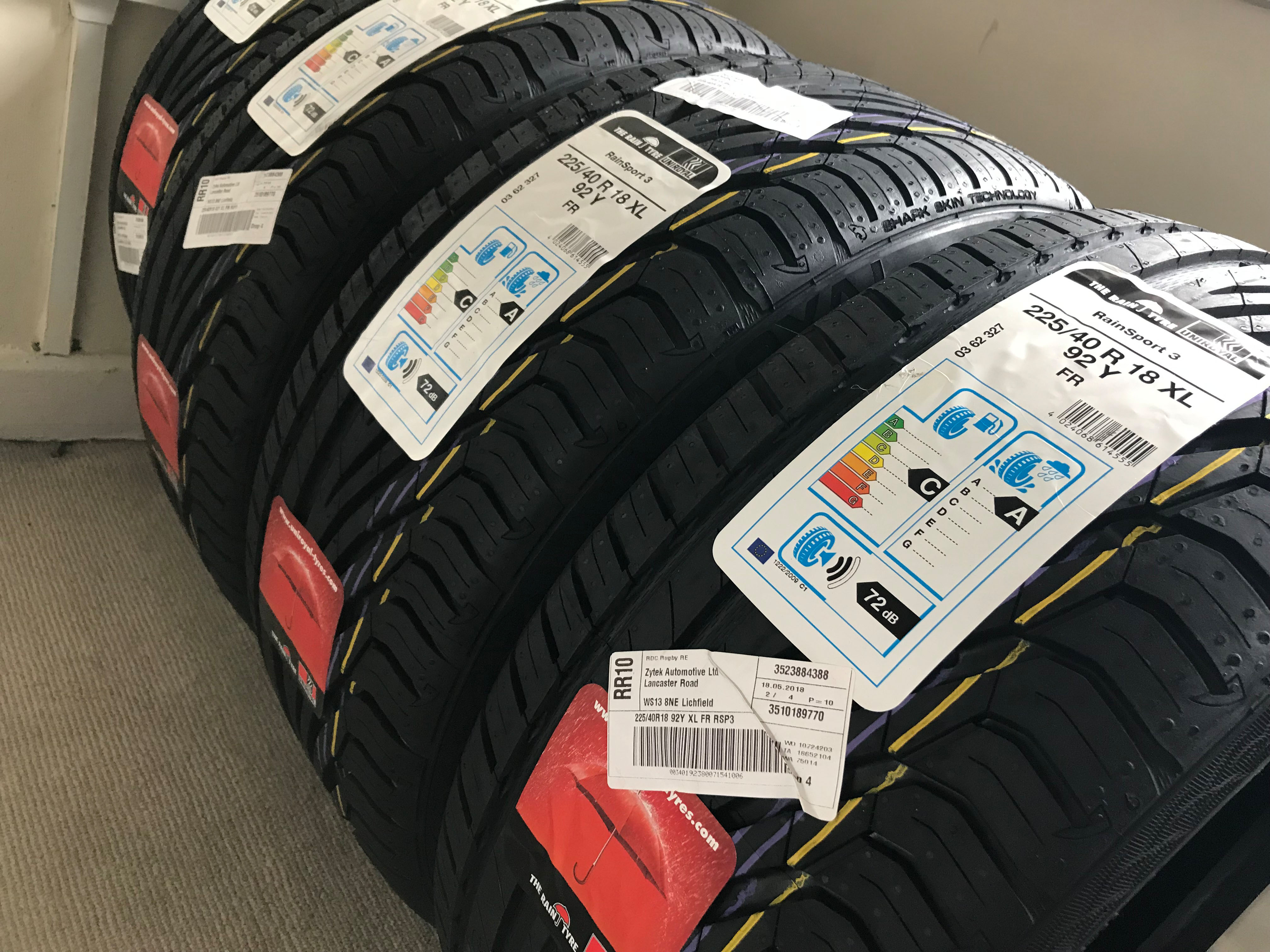

I wasn't to keen on having odd tyres and the tread was wearing low so I decided to get some new tyres, working for Continental I managed to get tyres relatively cheap so I opted for a set of Uniroyal Rain Sport 3's I believe they are made from the same rubber as the Conti equivalent and at the time the RS3's where rated higher than the like for like ContactSports.
I've ran the RS2's on other cars and had no issues, they're great in the wet and in England its what we see the most
Tyres:

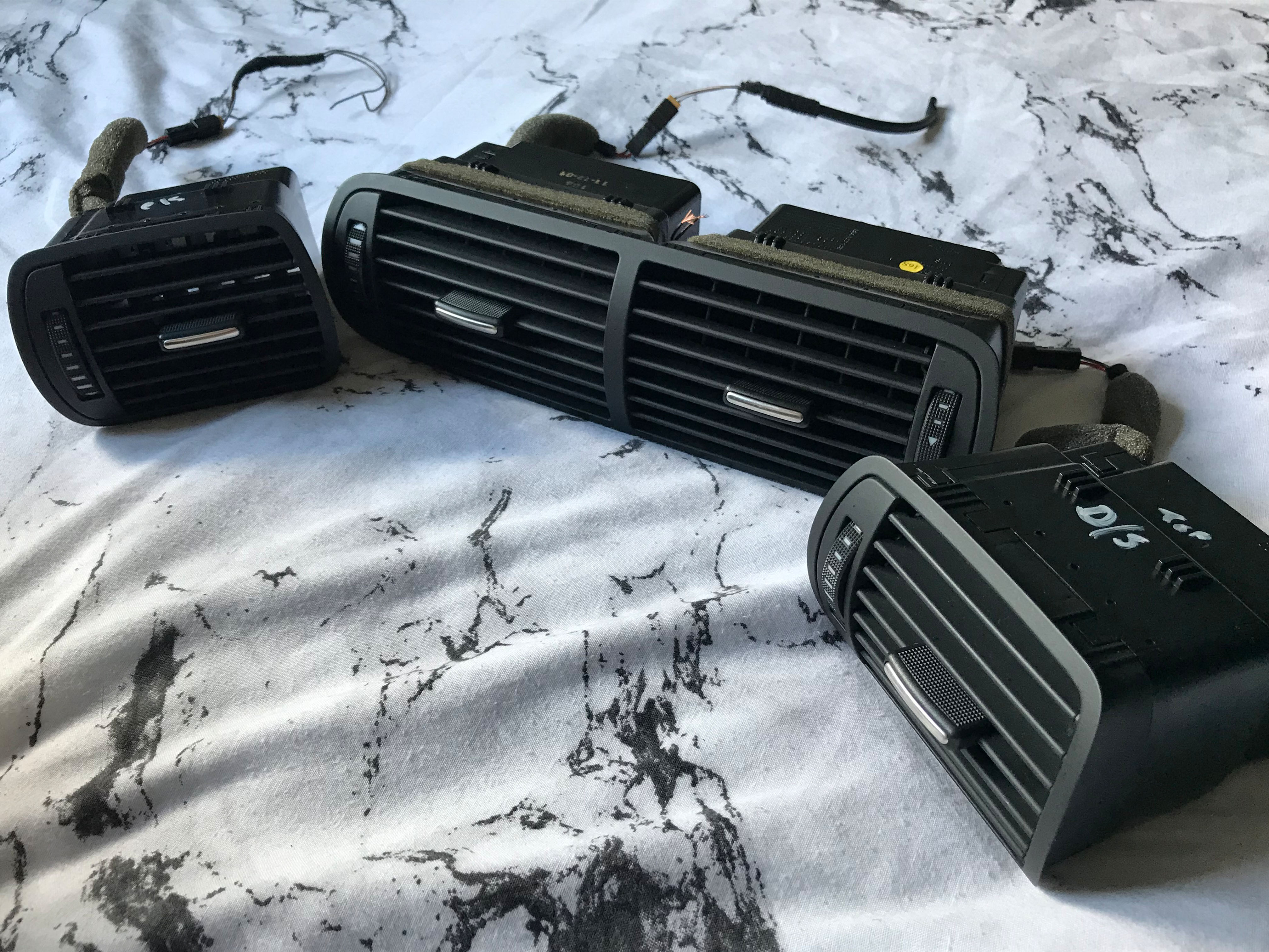

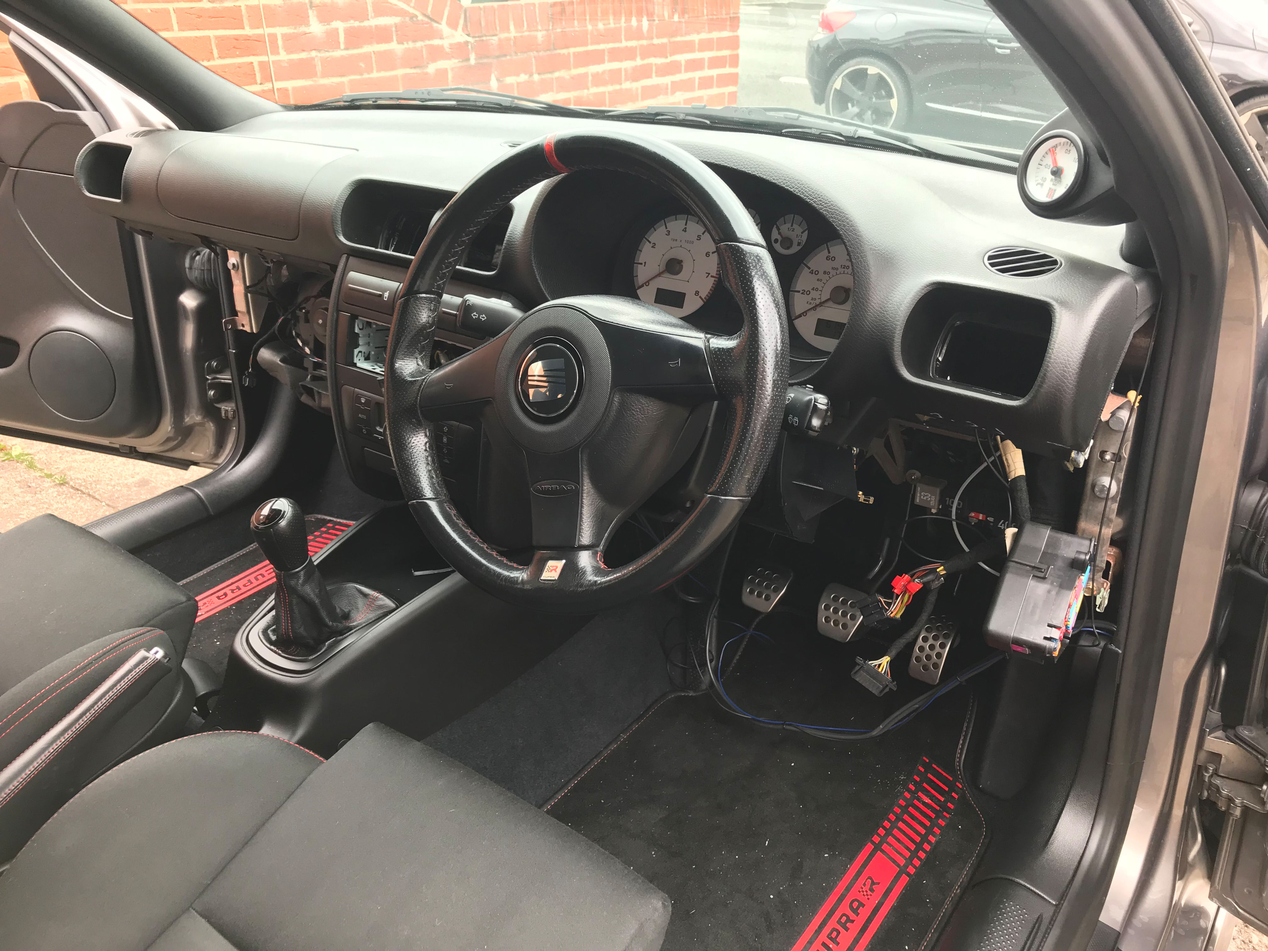

I managed to get my hands on a very clean set of Audi S3 Illuminated Vents with wiring loom attached, As soon as they arrived i broke out the wiring kit, soldering iron and got to work dismantling the lower dash and removing the old vents.
One thing I wanted to do with these vents was retain the red plastic insert to keep that OE feel and to tie in with the rest of the interior.
It was simply just a case of removing the tab from the old vent and replacing the ones on the new vents.
I wired the lights into the light switch so they come on when sidelights are on.
Arrival:
During:
After:
I was very pleased with how these turned out not chavy at all, a nice subtle touch to the interior.
