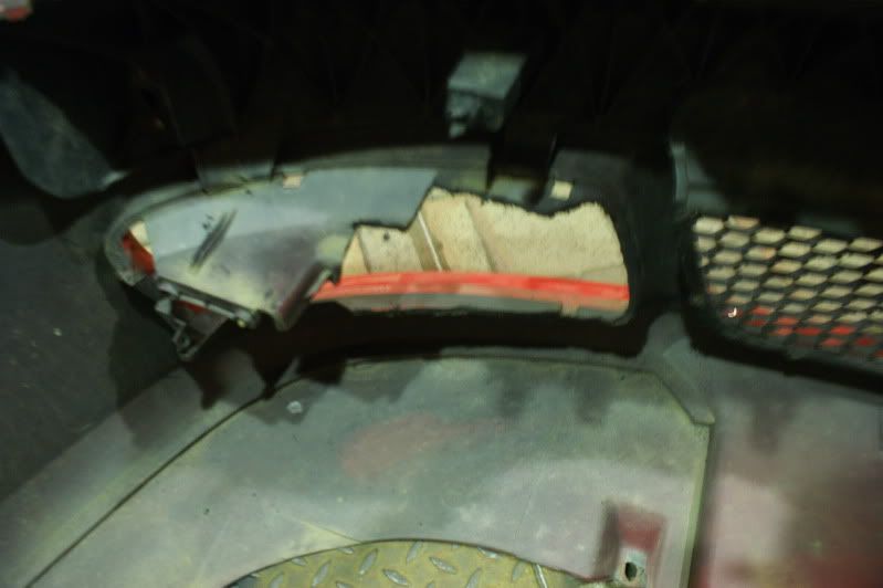

The ducts that feed air to the SMIC need to be more or less cut away all together, im still in process of finnishing mine off so i will stick up loads of pics to give you an idea. Its okay gives me sumthing to do

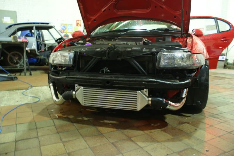

Me and my mate went round and did a number of jobs on the Lolf last night :whistle: pain in the arse

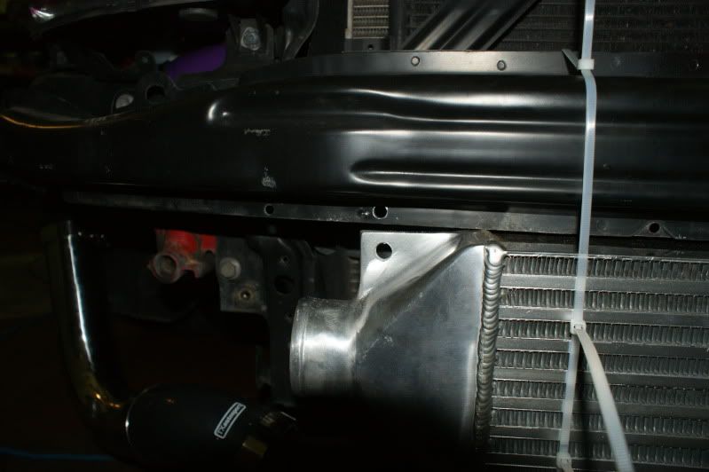

Holes drilled for the mounting brackets, watching out for cables in behind

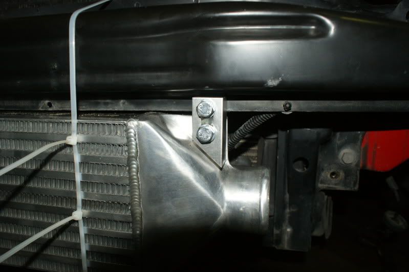

Bracket mounted on crash bar, but put the bracket behind the lip as i found out this way brings the FMIC forward and you will struggle to refit bumper [:@]

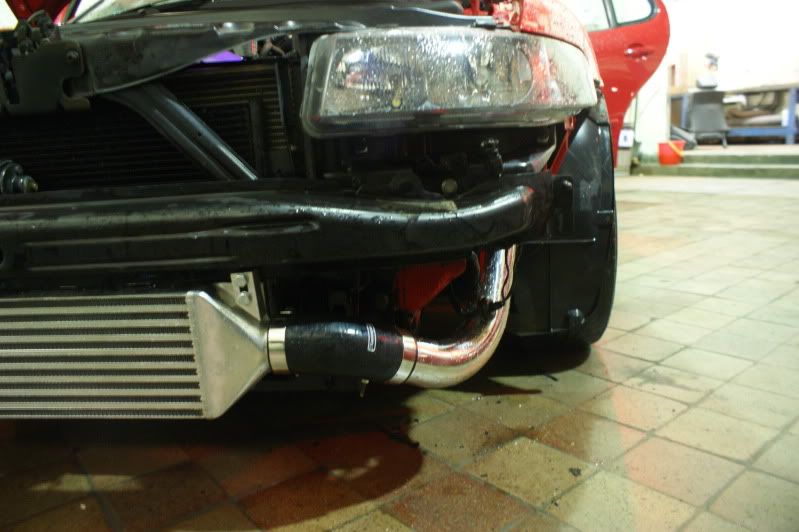

All plumbed up
Since the FMIC comes back a bit you will probly need to move your horns, i mounted mine like this
and for the bumper get crazy with the grinder and cut that bitch down
Hope this helps if your thinking of getting this kit mate, seems good just take more effort that the forge ones, but its so much cheaper
