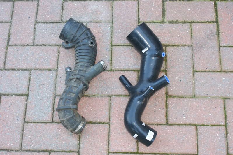

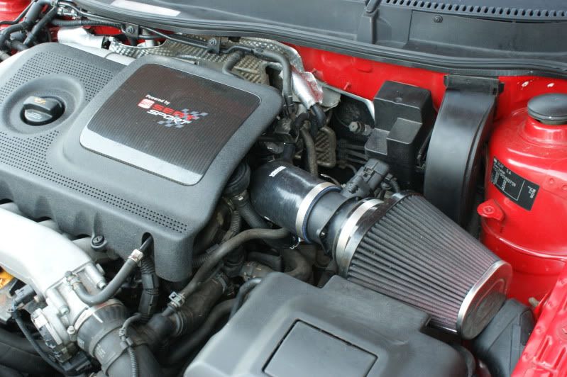

Allen logged my car when it was still totally standard shortly after I got it, it showed about 181.28g/s which works out to 226.6 or 231.1 BHP, depending whether you like to multiply by 1.25 or 1.275. This was with the OEM paper filter in the standard airbox. Between then and the RR day the only changes are a silicone TIP, 007p valve and big Jetex cone filter. The car doesn't feel like it's lost any power since i got it, if anything it feels slightly more responsive.

I shall see you there! Be nice to meet you at long last. I wouldn't exactly call mines sexy, yours it tho!! It will hopefully be clean anyway, needs a good few hours again! Not had a chance since my respray. TIP looking good btw! :)
