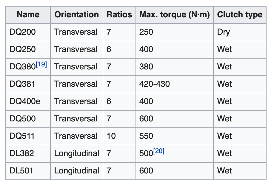

Just a word of warning, VW Group have two types of DSG Gearbox's
The DQ200 (Dry) gearbox is a different setup to the rest (Wet) so double check that what you are looking at is the correct type for your car.
I also seem to recall that the Dry Gearbox did not require an oil change but happy to be proved wrong.
Thanks @theoldboy I knew I had seen something somewhere. I know I am asking numpty questions here, but how do you tell which gearbox you have? Its a 7 speed, so that narrows it down a bit!
I would have thought you have the DQ200 Personally as this was designed for the smaller engines, however I currently don't have a site that can confirm it but if you talk to a seat garage they will be able to confirm I am sure.
