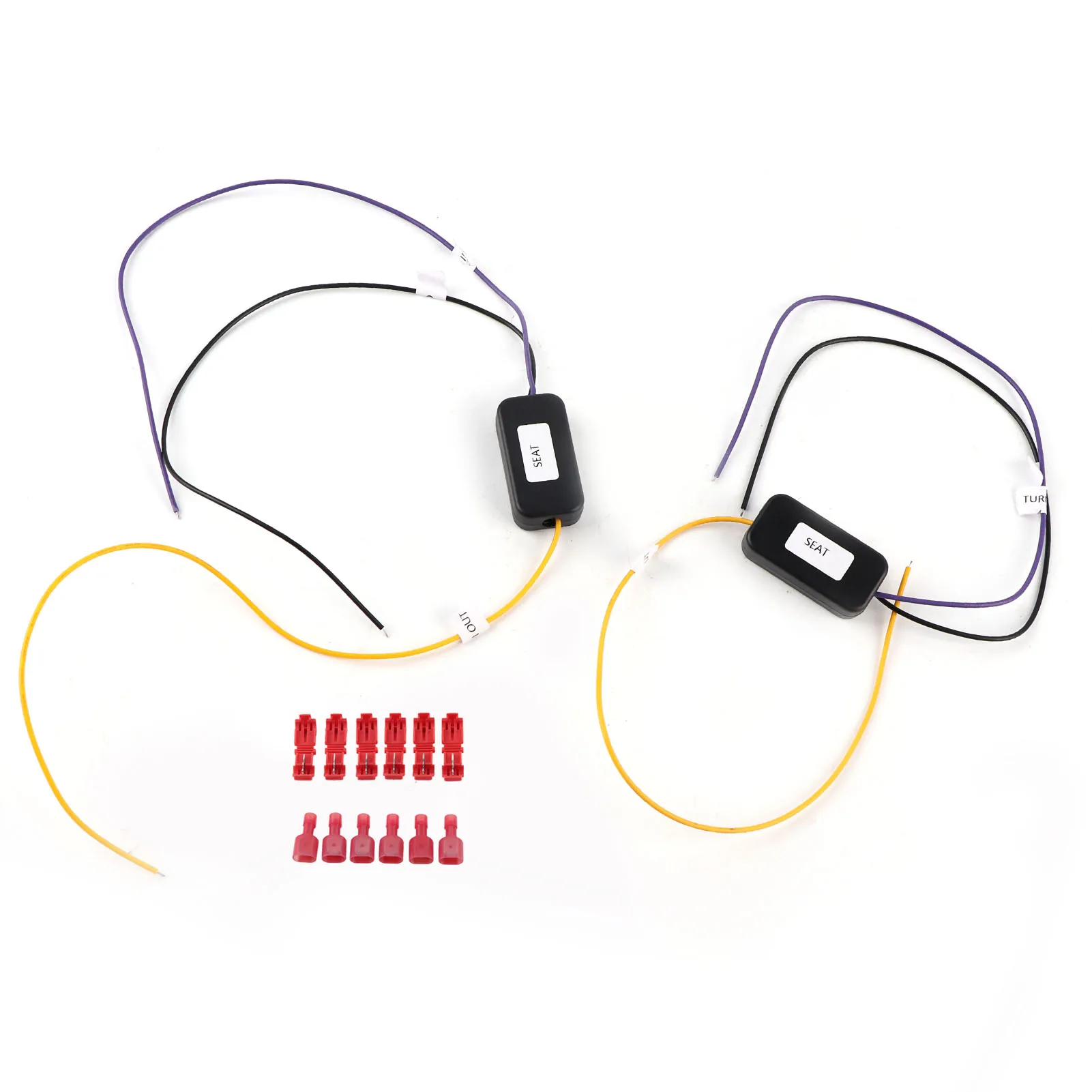

Hello, I have this issue too but after a lot of research its far too expensive to get the wiring installed. My plugs to the rear indicators only have 4 wires so the LIN communication wires are missing which means just fitting the dynamic LED units wont work. I had some looms made up and fitted a light control module to them. I think they look as near to the real thing as I am going to get. I'd share a video of them in action but this site doesn't allow video uplaods
What kind of control module did you use?
I've just uploaded this video to YouTube showing the conparison. If you slow the playback speed to x0.5 you can see how it works in slow motion.
This is what I used...
I just found this on AliExpress:
LED Tail Lights Dynamic Turn Signal Adapter Harness Blinker Module Kits Fit for Seat Leon MK3 5F 2013-2020 new
P.S. They were installed using genuine multiplugs and wiring to act as a form of bypass/piggy back system. So it means no cutting of any wiring on the car and they can be unplugged leaving no trace.
