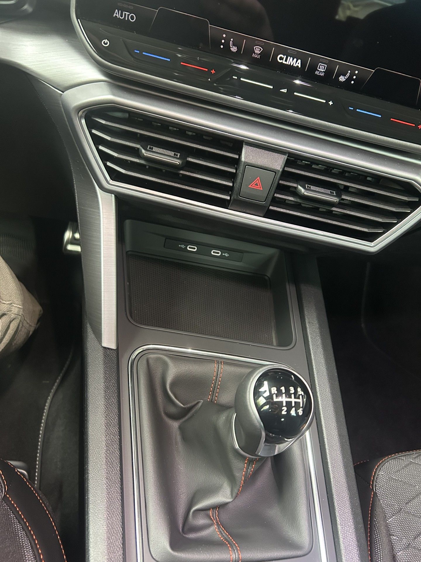

Yesterday I went to collect my new Leon ST 2026, all is well but to my surprise, the lightbar has no animation on unlock and the turn signals are not dynamic. Also there is no wireless charging spot in the center console. This area seems to be redesigned and just gets 2 usb c ports?

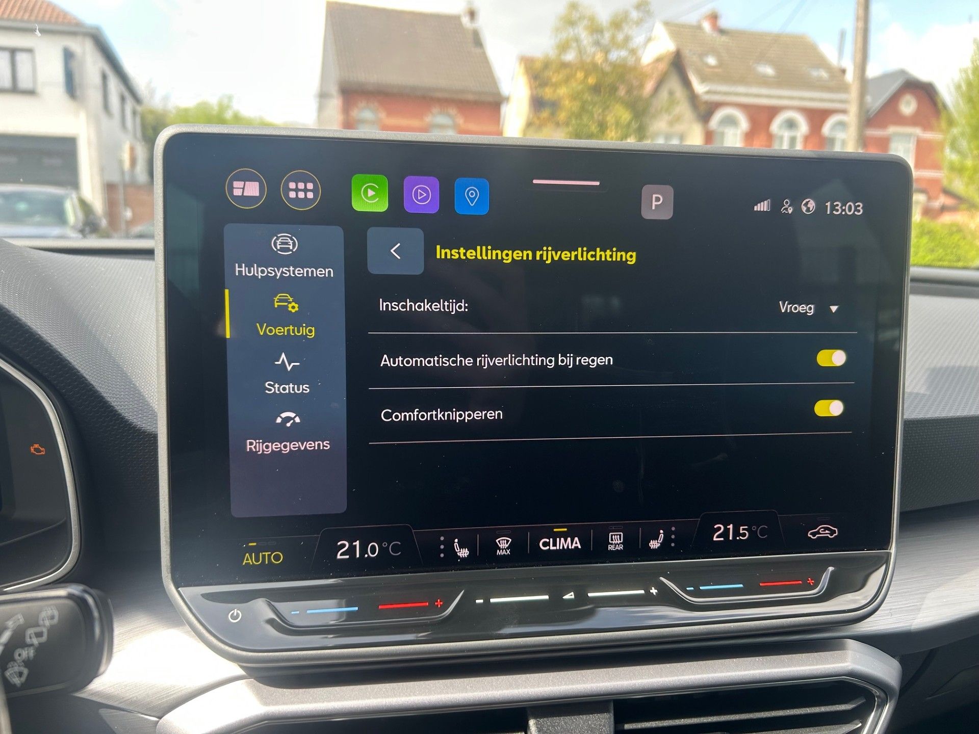

I'll double check but there are very limited options under lighting. I have the matrix headlights (they work) but even those have only one option, I can choose between slow medium and fast switching. I don't remember seeing an option for the animations. I'll update this thread with a picture this afternoon.

this is the view I get when chosing lighting in the car menu (sorry for the dutch language). But no options for any animations

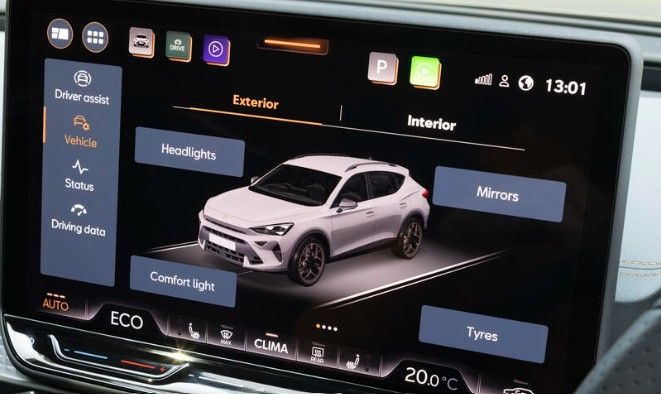

From your picture I believe you need to go back a level and you should see a screen like the one attached (may differ in Belgium).
But if get this select Exterior >> Headlights >> Comfort Lights >> Animation 1 (you may need to scroll the screen up) this should give you the lightbar animation.
But you see at the bottom the 4 dots, there are other 3 more option screens to the right and you may need to check those screens as the placement may be different in Belgium. There are a few videos on You Tube showing the process as well - hope you get it working

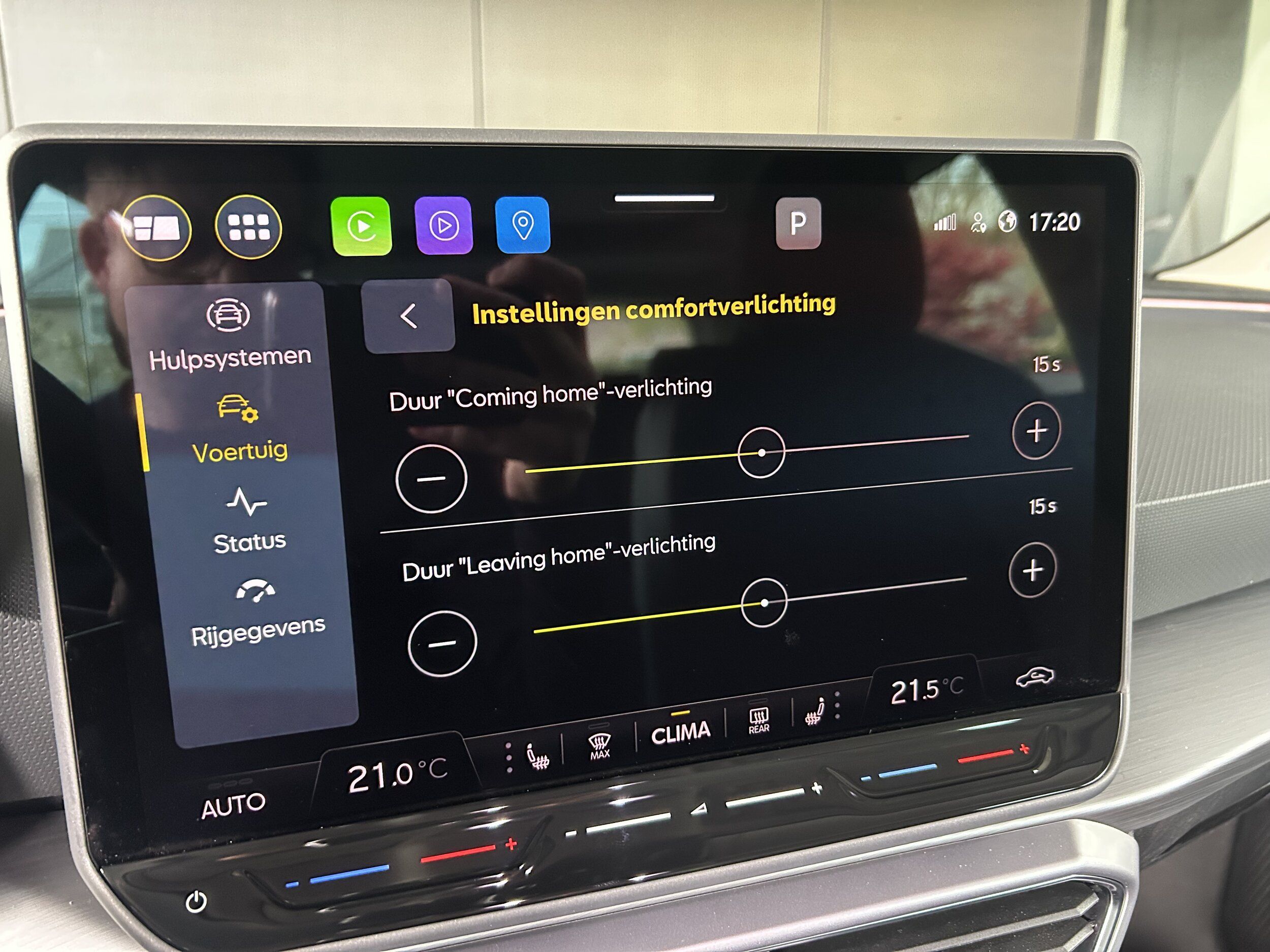

Thank you for your answer, however under comfort lights I only get 2 sliders for coming home and leaving home lighting (not sure what those do though), I think. I'll check this evening.

Coming home is a function when you open or close the car that your light stay on for the given seconds

Does your wireless charger look like this (see image) or is it deeper?
If I undersdtand correctly, your lightbar also does not have animations? Or does it?

Way deeper.

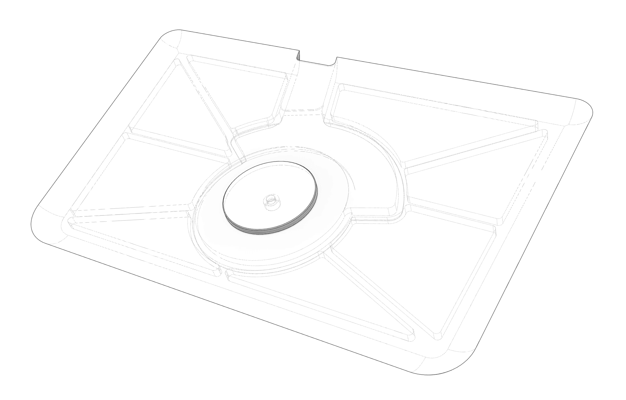

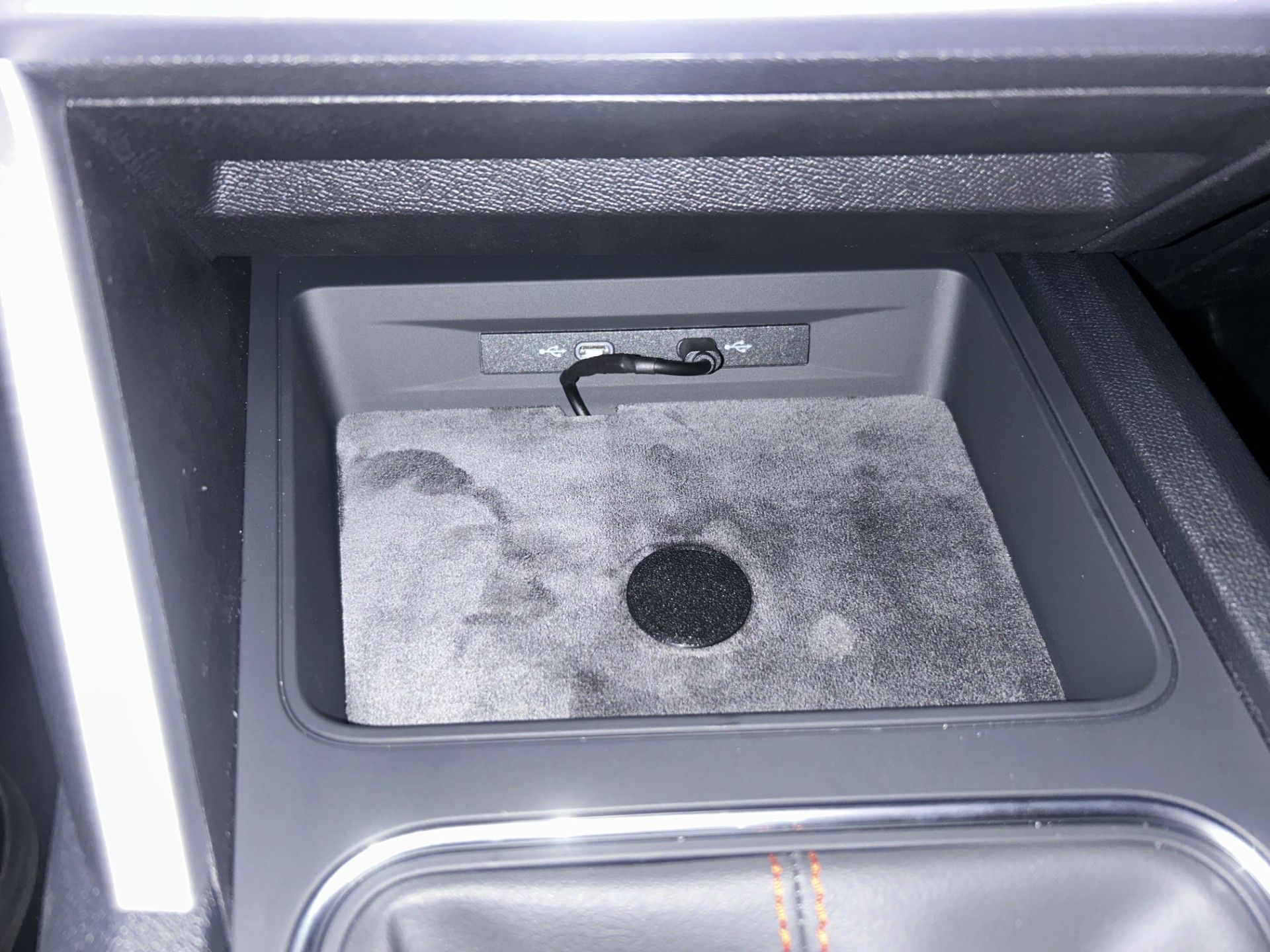

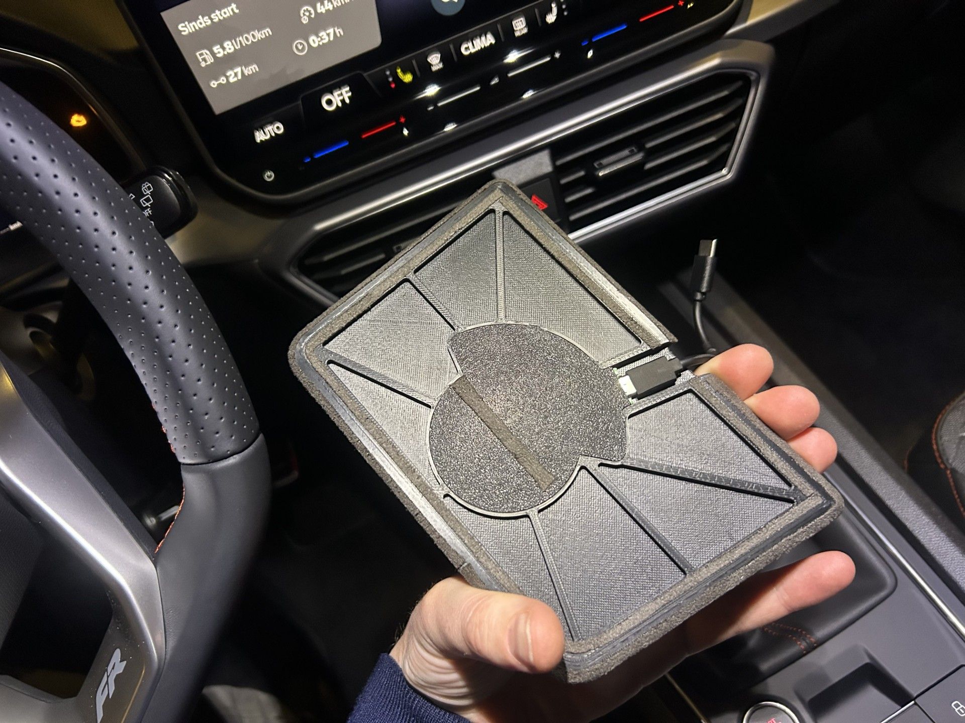

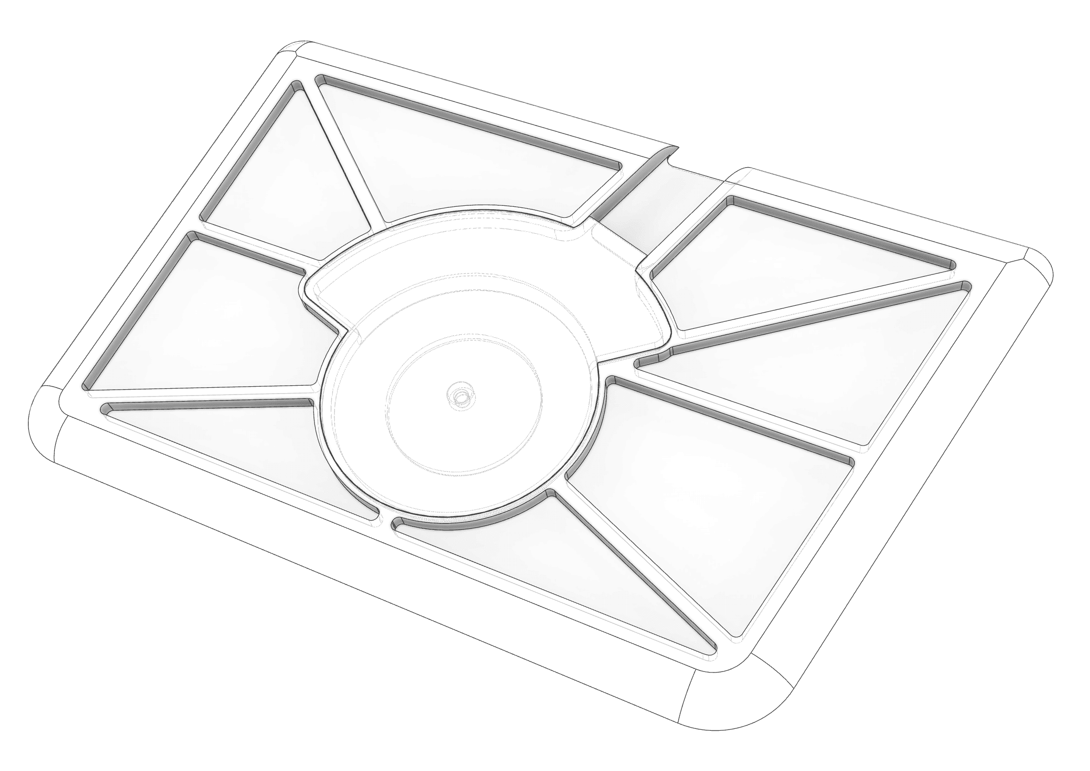

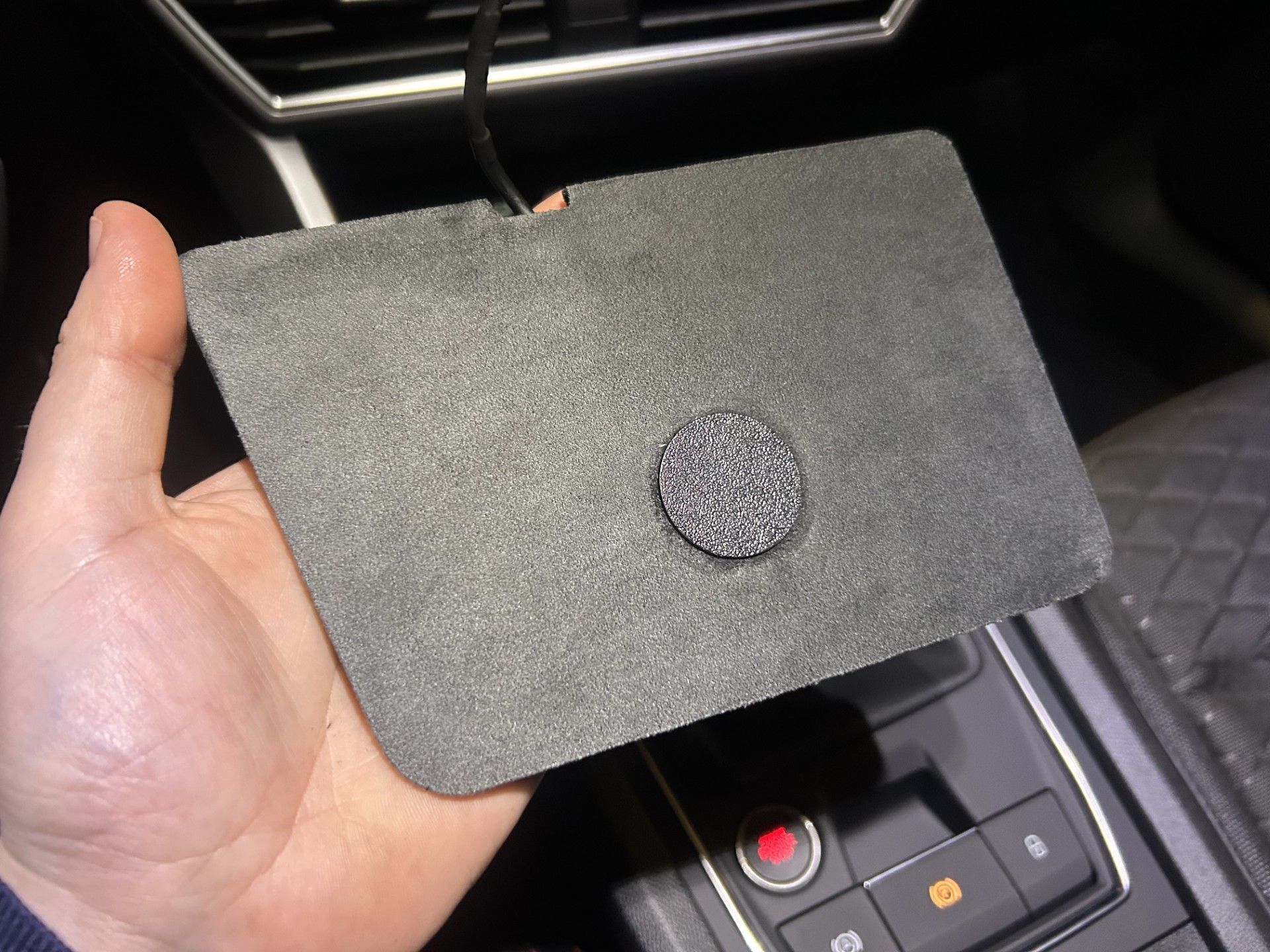

I created my own wireless charging pad like the one on etsy (posted earlier in the thread). Below are some CAD screenshots and pics from in the car (it was dark). I used an off the shelf 15W wireless charger pad that I pulled apart and put the guts into the 3D printed enclosure. Some adhesive felt on top and it looks ok. I use a quadlock case on my phone so I added a little raised puck so my phone is always centered. I'll see if it heats up to much or if it charges fast enough... I don't think that the USB ports in the car are all that powerfull. It was a fun afternoon of crafts.

I did a test of my self build wireless charging solution and it charges my phone about 10% in 15 minutes while having apple carplay running, playing music and navigating with it. That good for me. It gets only slightly warm, nowhere near problematic hot. If anyone wants the files let me know, getting the shape exact so it would fit without having play wasn't easy so happy to help if anyone wants to copy the design.

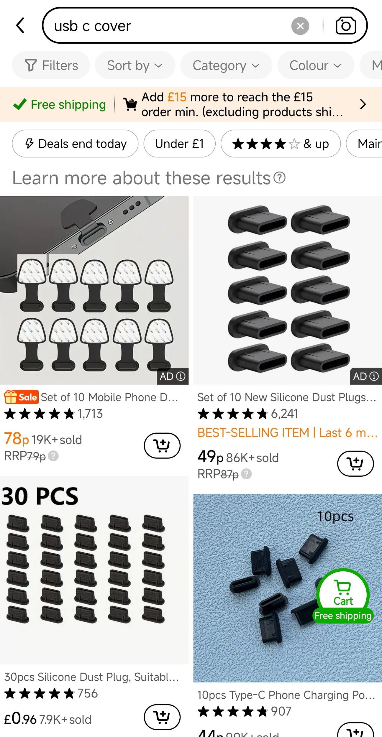

USB-C stop working properly after only 6 months? Where you live with so much dust and air pollution?
The USB ports are working perfectly fine for my 2 Android phones (bought in 2019 and 2025 respectively), both devices still in use daily. The one I bought in 2019 has had 2 battery replacements already over the years, and will have 3rd battery replacement probably end of this year or early 2027. The battery in the newer one may last for longer with the battery charging threshold function (similar to EVs) built in.
If you have concerns on USB port getting dusted, get a cheap USB port cover (dust plug) from Temu.
On the signal boost issue - not even know the car has this function or not, as I live in London and never have mobile signal / coverage complaint (for 4G LTE and 5G NSA). Even when travelling far on the motorway there is no data drop for listening to Spotify (via Android Auto). And during my trip in the Scottish Highlands in Oct 2025 in a rented Golf (on MIB4) never experienced any such issue.
