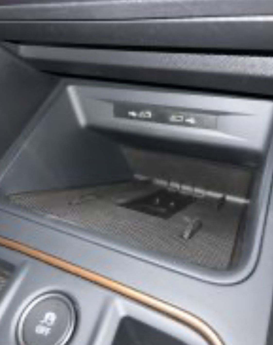

Hello,
does anyone knows what part number of wireless charger mat with vent holes in it? It’s from facelifted version. Want to replace existing one with 3P0035502 which has 15W and fan (if not mistaken it should be play and plug).

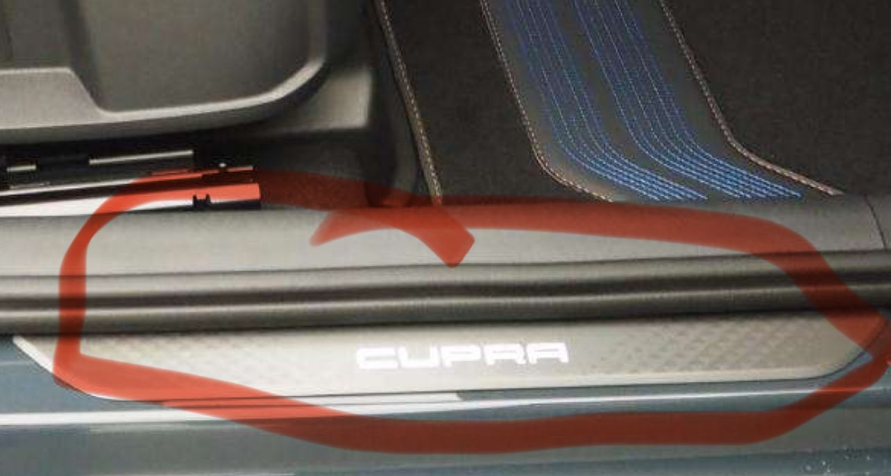

and maybe also somebody knows which part number new design door sills?
Thanks!

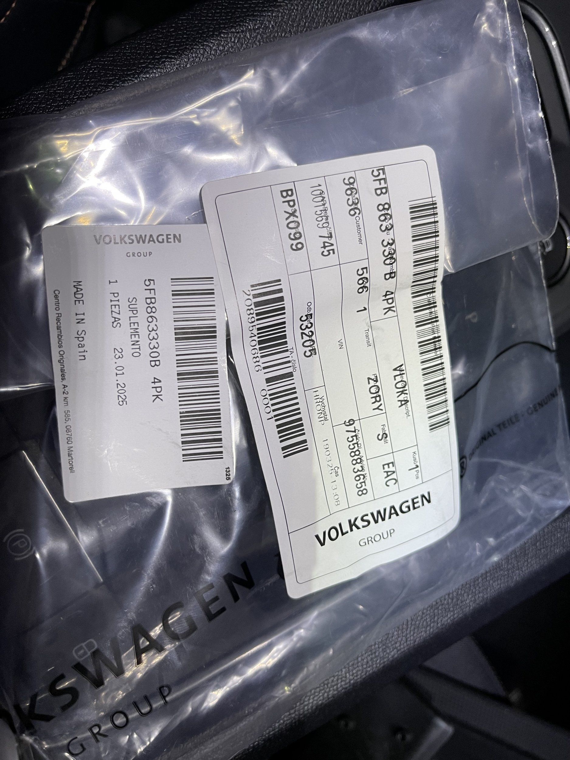

If not mistaken new cover part number is 5FB863330B 4PK
Ordered from dealer (12 EUR)

Does the charger cover fit? Is 5FB863330B 4PK right for the vented charger?

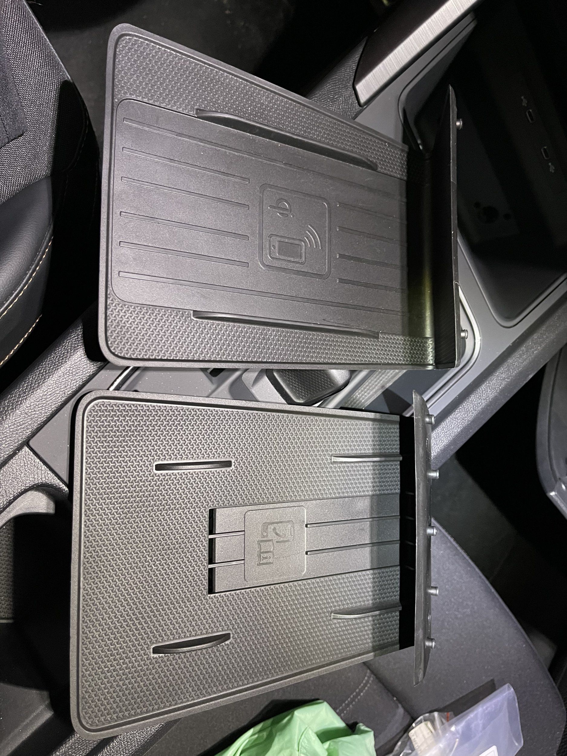

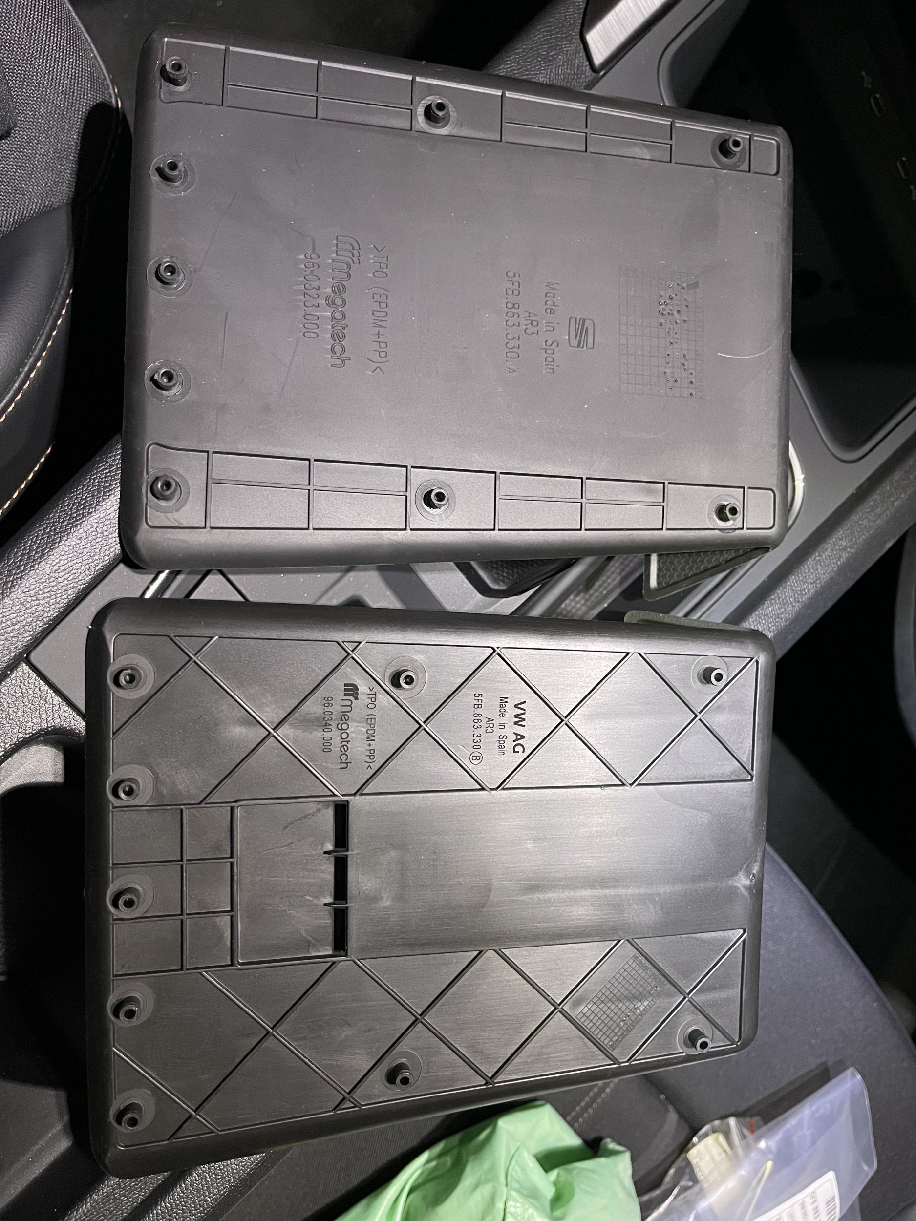

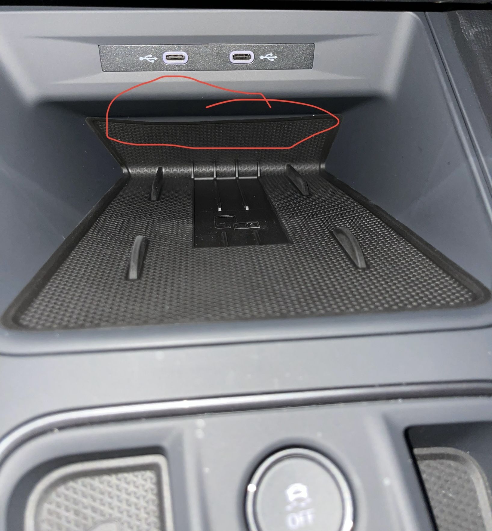

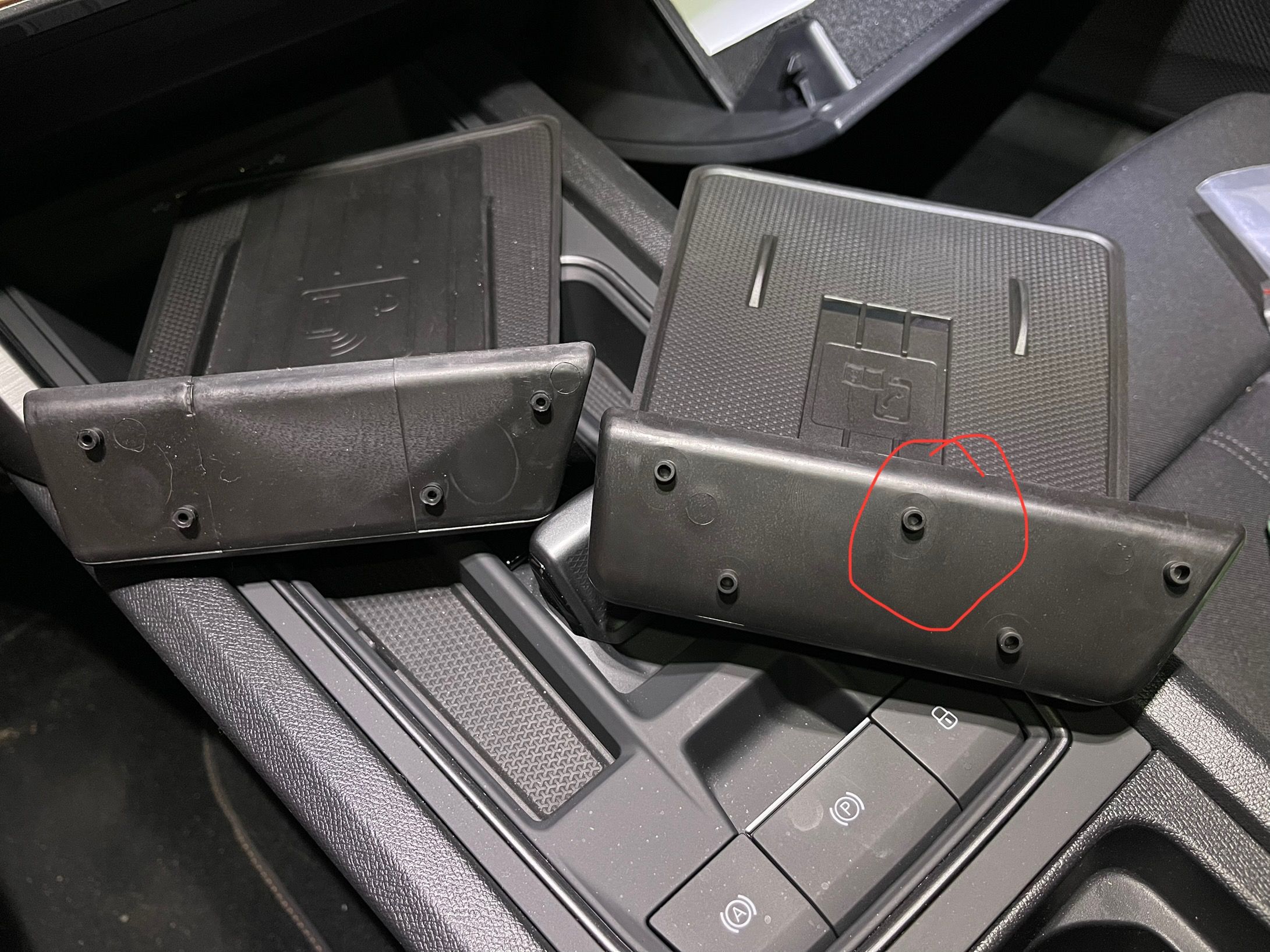

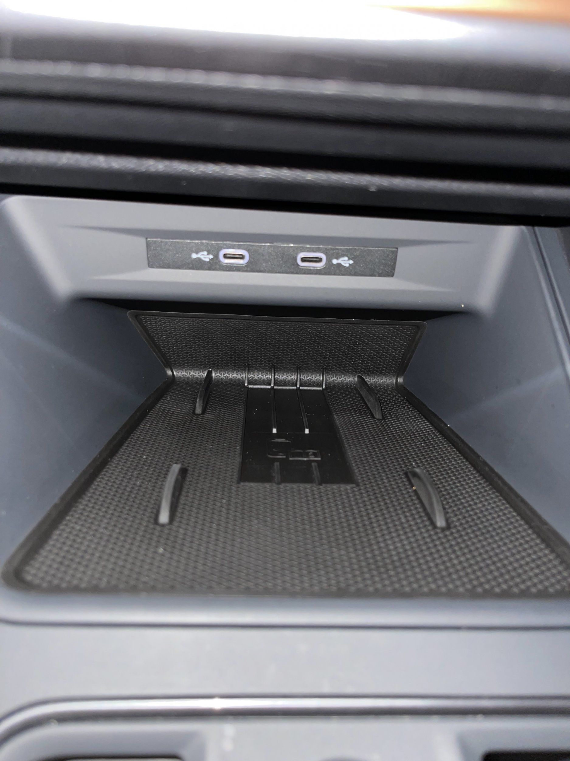

So added 6VA035502 and 5FB863330B 4PK mat. Here some faq.
1. Q: How does the cover fit?
A: The cover fits well with one small modification. You have two options to make it work:
• Option 1: Cut the extra holder from the cover.
• Option 2: Drill a hole in the plastic so the holder can fit.
I chose to cut the holder. However, after fitting, there’s a small gap that isn’t very noticeable from a distance but still bothers me because I know it’s there.
2. Q: What needs to be done for the charger to fit?
A: You’ll need to remove some plastic to make room for the charger. I found that using a heated knife worked perfectly for this task.
3. Q: Is there anything else I should do before assembling everything?
A: Yes, before fitting everything together, make sure to cover the antenna connector (it’s no longer needed) with tape. This will prevent it from making noise when moving around.
I didn’t had a chance to try out wireless charger yet for longer period of time but first imoressions:
• Performance: It charges my phone faster and recognizes it more quickly than my previous charger.
• Noise: There is some fan noise when it’s in use, but it’s not audible when you’re on the move.
• Compatibility: My iPhone 12 Pro Max fits perfectly, but wider phones might have some issues fitting
Will update later after more usage

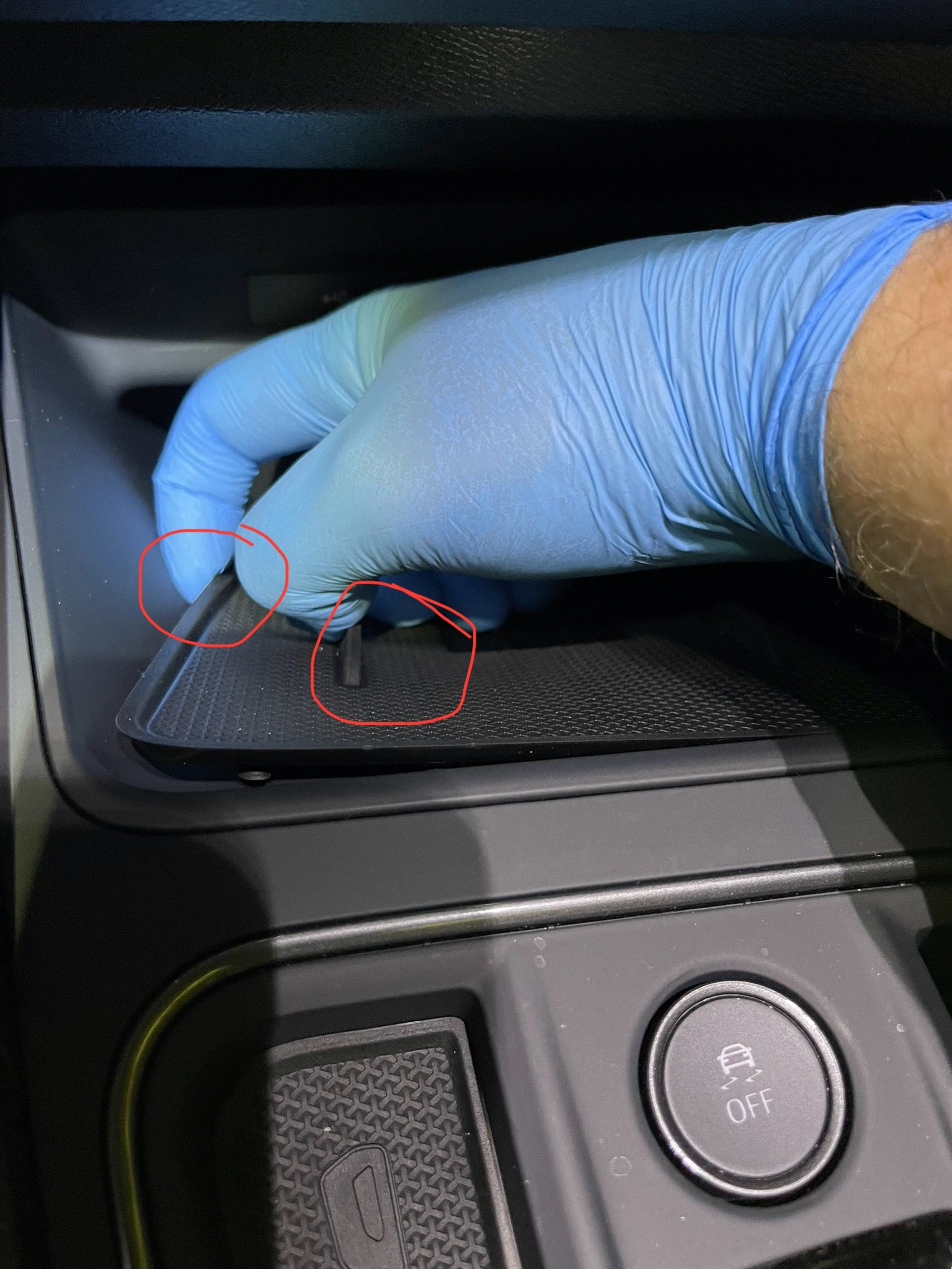

For rubber mat just lift it up. I pushed to side that rised border in middle of mat and squezzed finger to lift it. As it’s rubber you won’t brake it.
For charger i used some cleaning cloth and plastic card to squeze card under corner and lift it. Here you need to be carefull not
to scratch plastics around cubby hole.
will put some pictures tomorrow.
Reactions: MR T

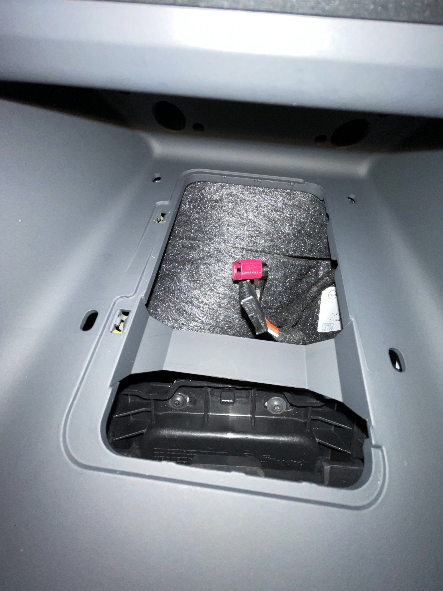

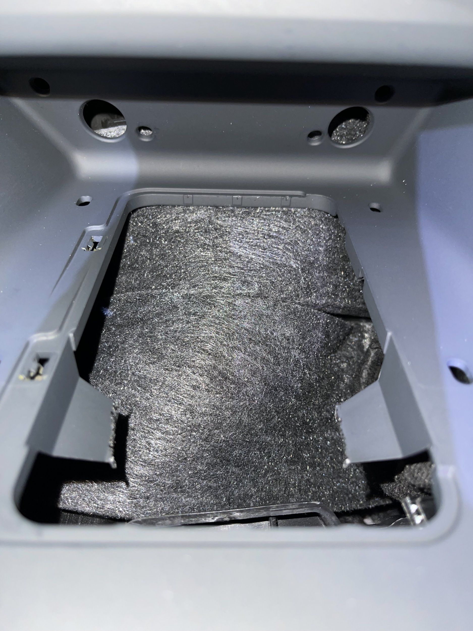

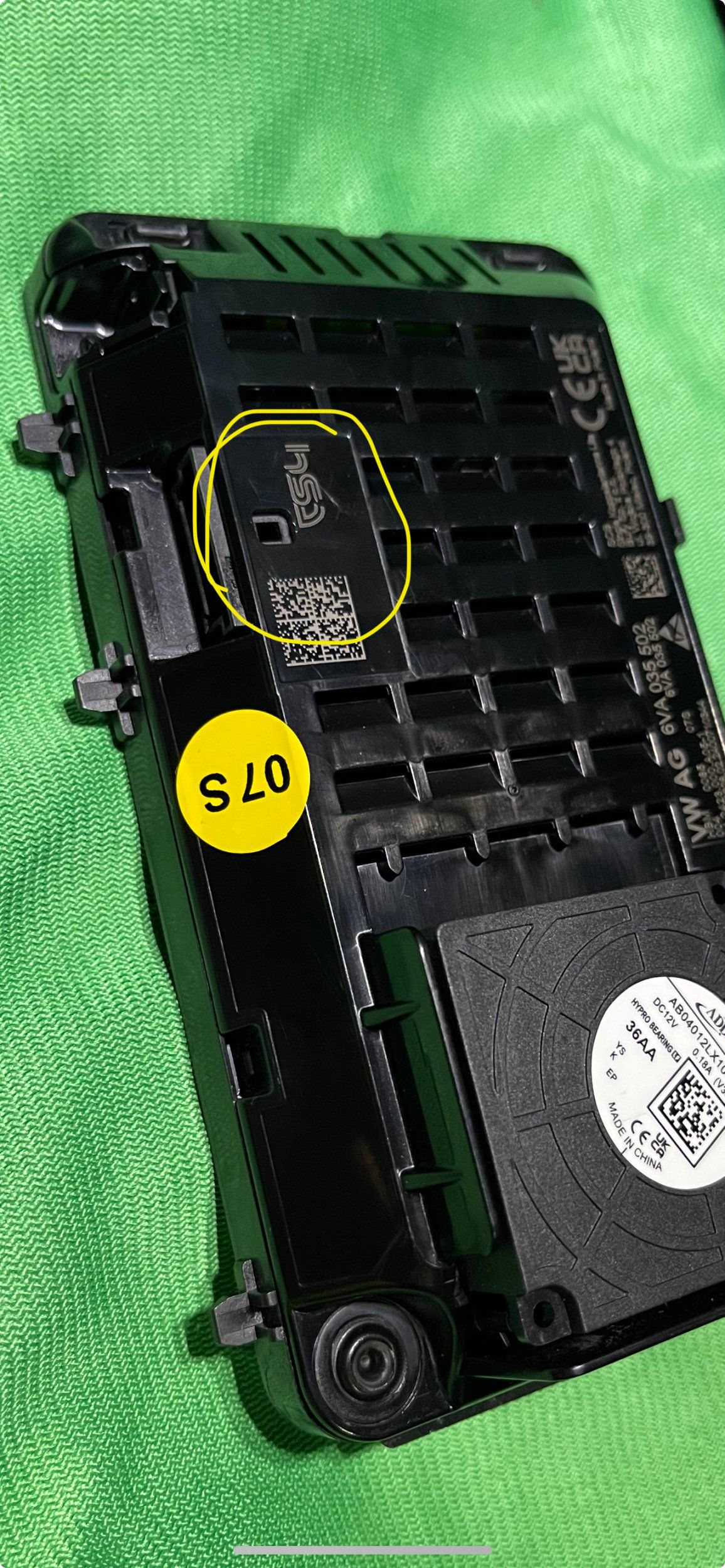

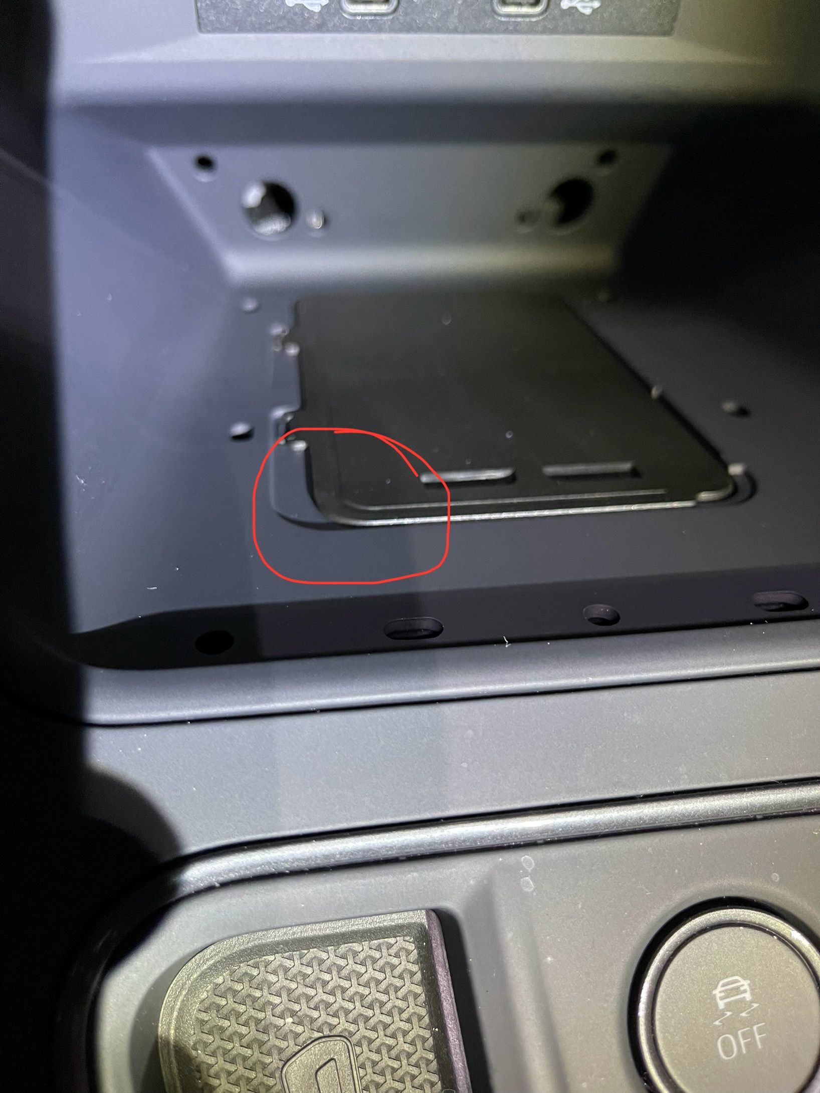

Sorry for delay, here some photos. For rubber mat push and lift where red circles. For charging pad just put some cloth (to prevent scratches) and use plastic card to lift corner.
To unplug connector push plastic holder in that square hole where yellow circle marked.
So far all good, phone charging with no issues and no heat warninga (carplay with waze and spotify is always on).

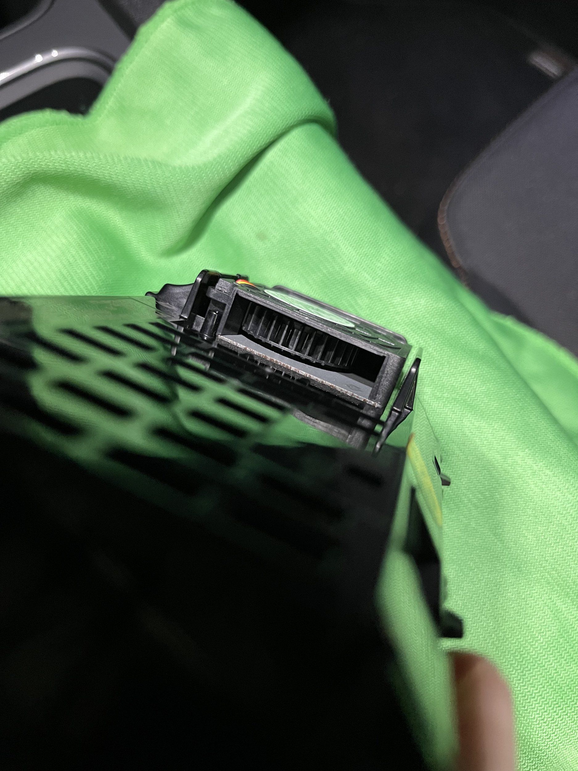

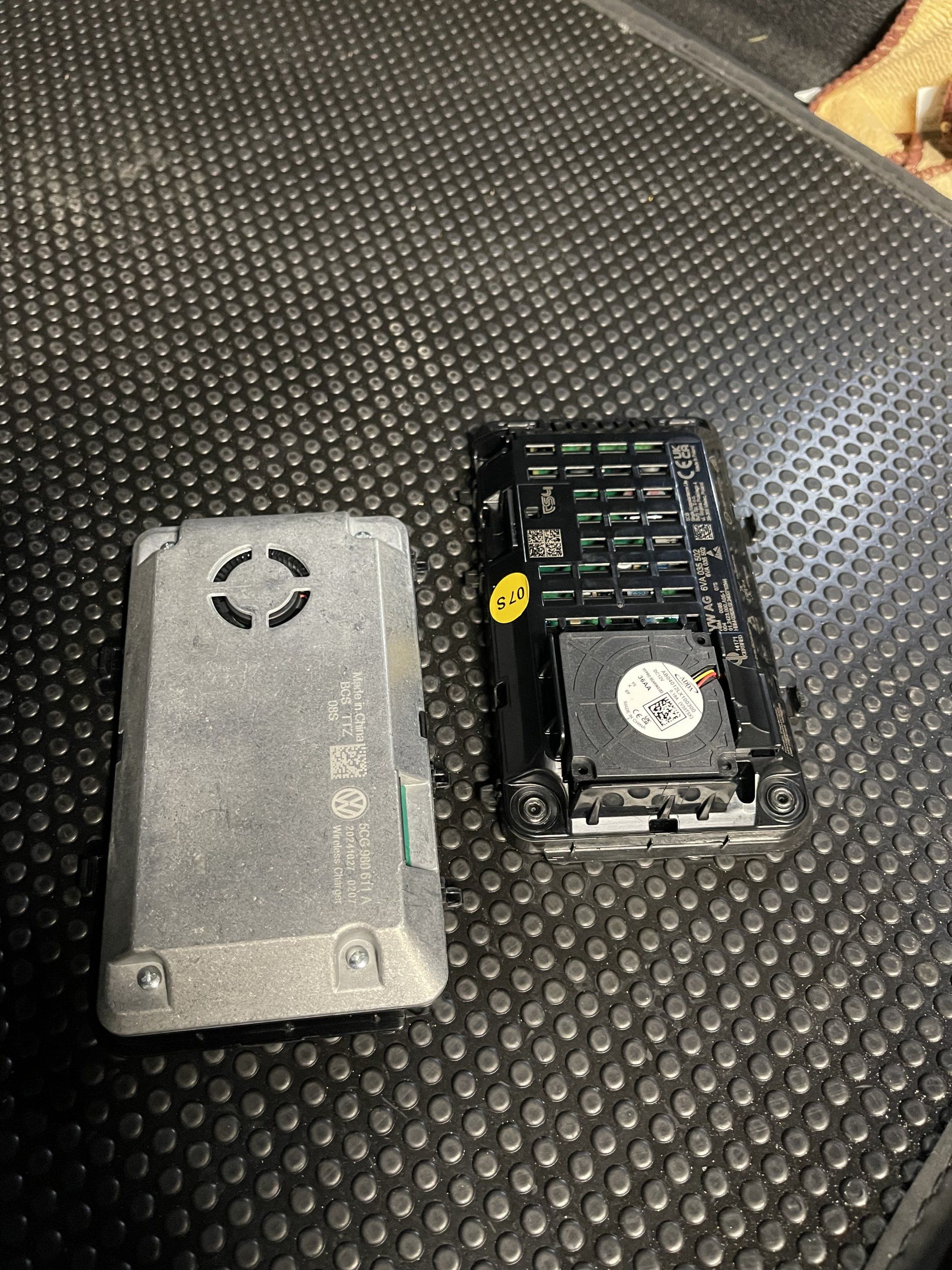

Plug-and-play, apart from one plastic beam modification (needs to be cut as it interferes with the fan housing on charger pad). The antenna’s purple connector should be left disconnected since the new charger doesn’t include the phone box feature (which enhances mobile reception). Didn’t noticed any difderence on reception compared to when it was connected.
There is no need to disconnect the battery; simply leave the ignition off and open the driver’s door to ensure the infotainment system is completely powered down.
And no coding needed. Fan kicks in when phone placed on charger.
