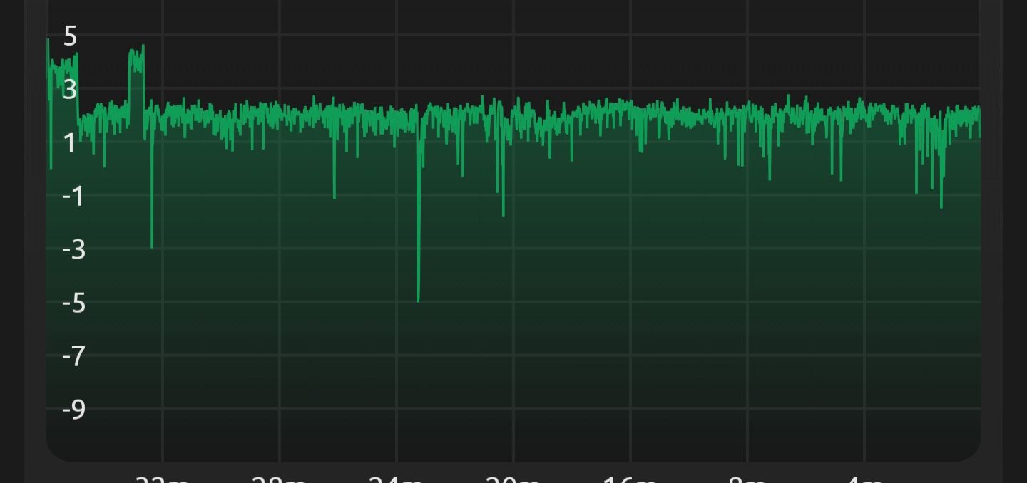

Do we know if 6VA035502 is 5W or 15W?
I have a Samsung galaxy s25+ and when I place the phone on the charger it says "fast wireless charging" but I wsa trying an app to check the charging speed and it stays around 5w.
It could be because I was using android auto and is showing the "charging" minus whats being used
According to a Russian retrofit blog, it is known to be 15W.
One retrofitter using an iPhone reported 5W, but thought iOS might be limiting non MagSafe chargers.
Another one confirmed that they got 15W.
I´ve tried today with another wireless charger that I know it can go up to 15W and my phone was only charging at around 6-7W. So is definetly my phone. I´ll try again with less battery to see if the phone is limiting it because is almost full.

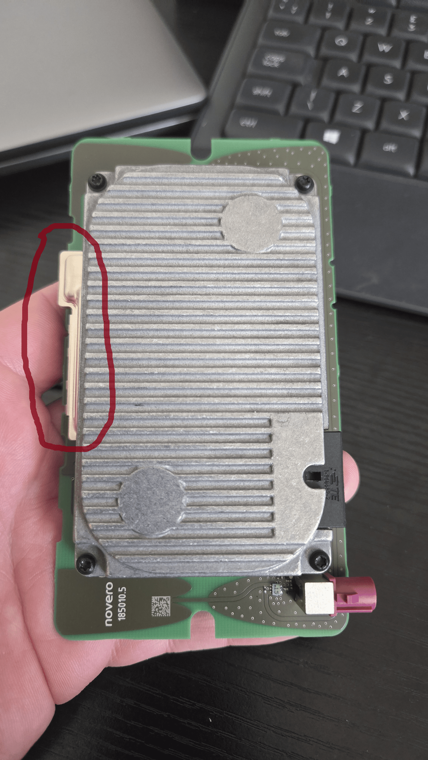

Also For those of us that changed from the charger with antenna to the 6VA035502 that doesn´t have the antenna; I´ve opened the original charger and the antenna seems to be a PCB board glued to the charger. there is no connections between the charger and the PCB board except for the heat disipator that connects where the red circle is but is not connected to the antenna circuit. I wonder if the 6VA035502 would have a blank board just as holder and it could be replaced. Or if we could take the antenna board from the original charger an place it under the charger.
