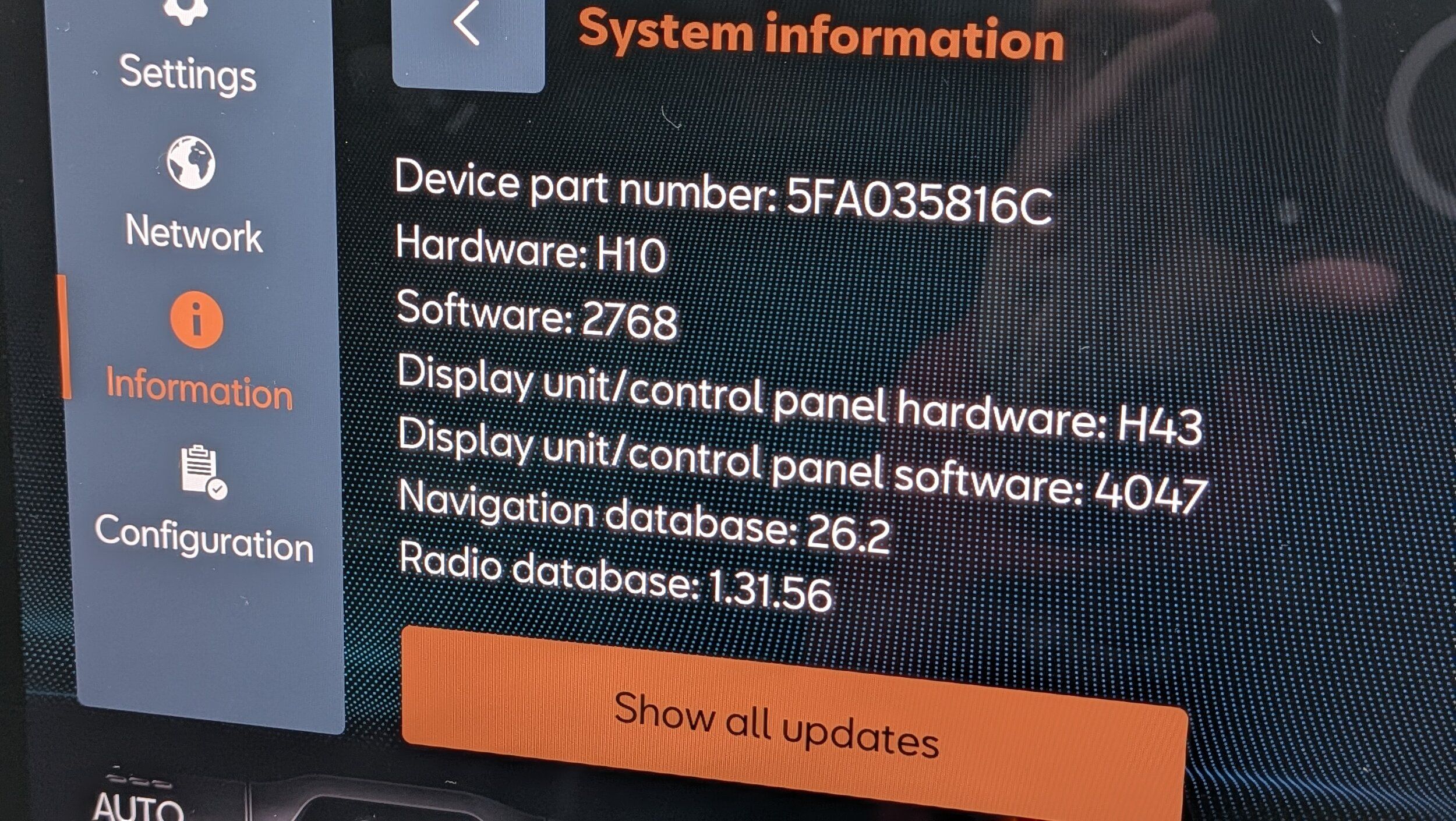

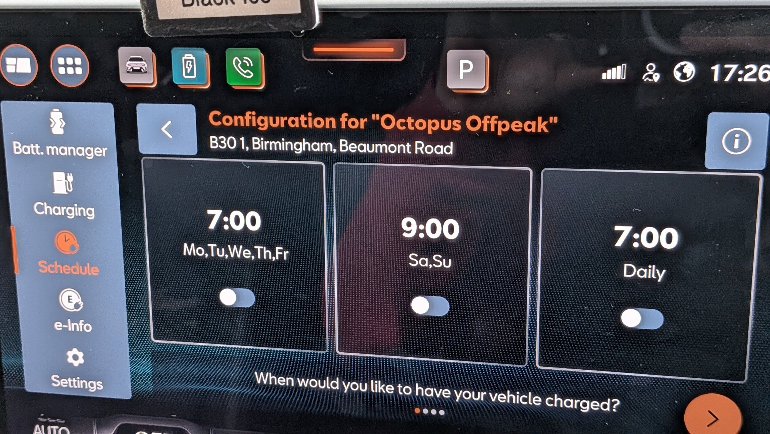

We have had an update applied to our Seat Leon and now scheduled charging is available and works. The Update ref: is 90Z1 and took the dealer two days to apply.

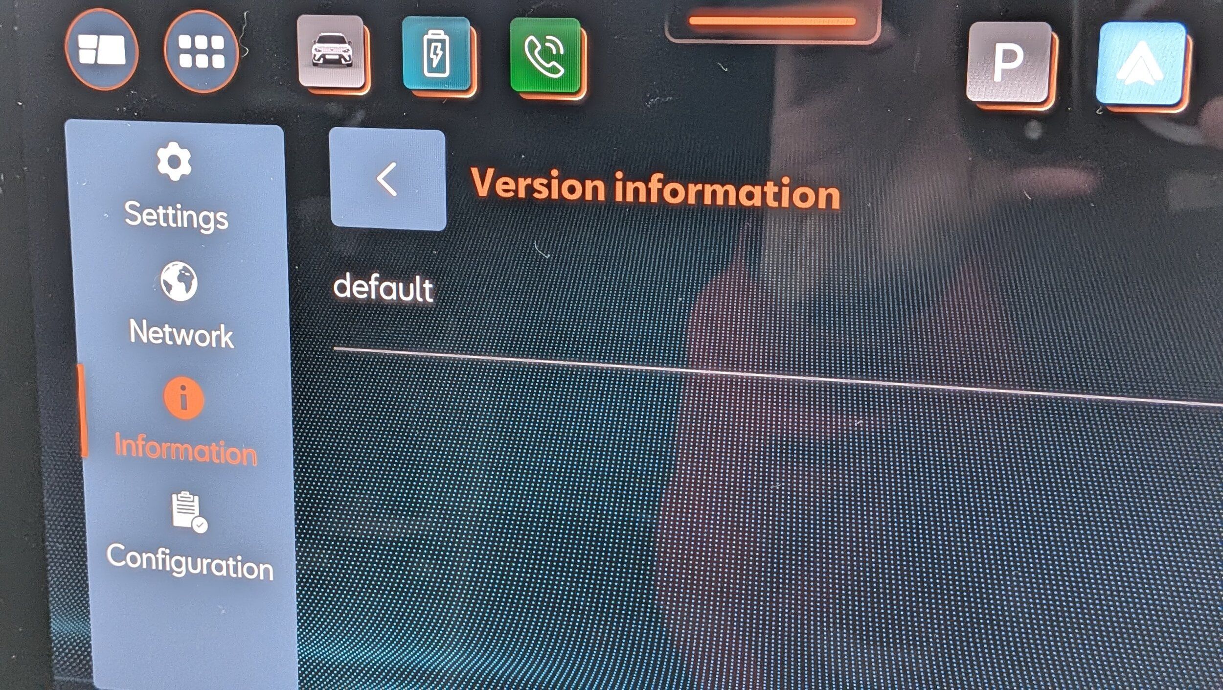

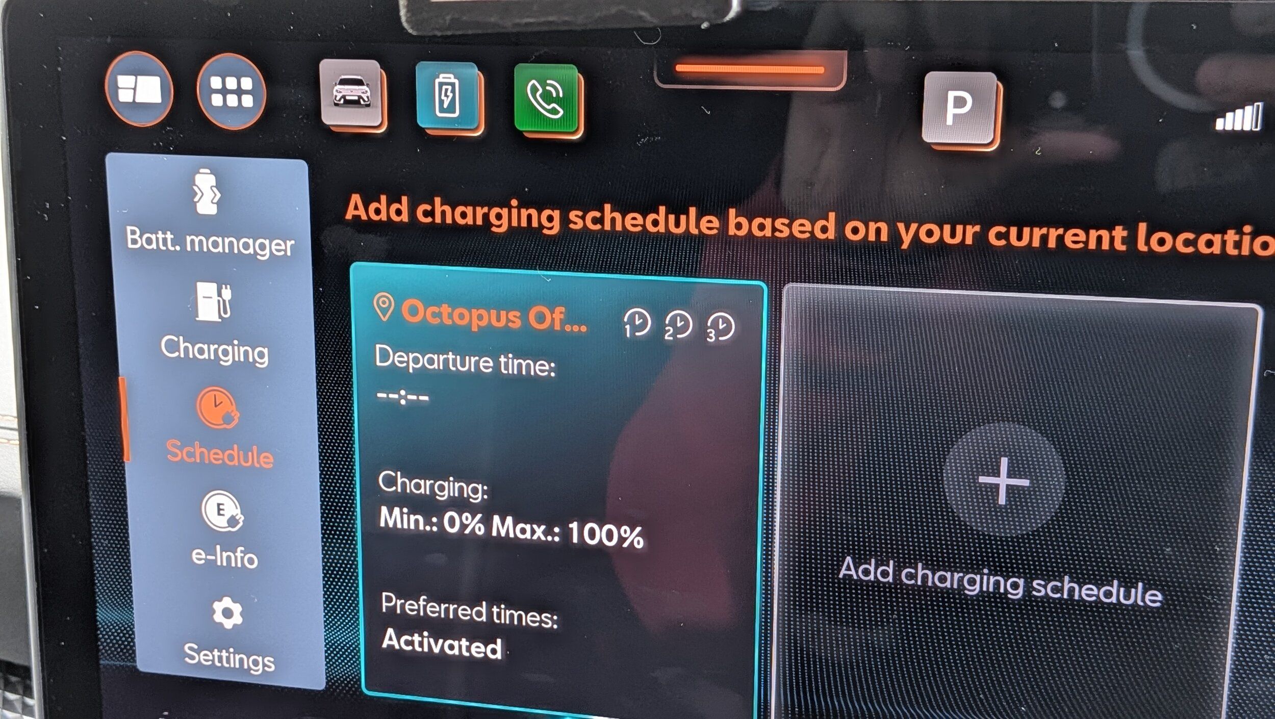

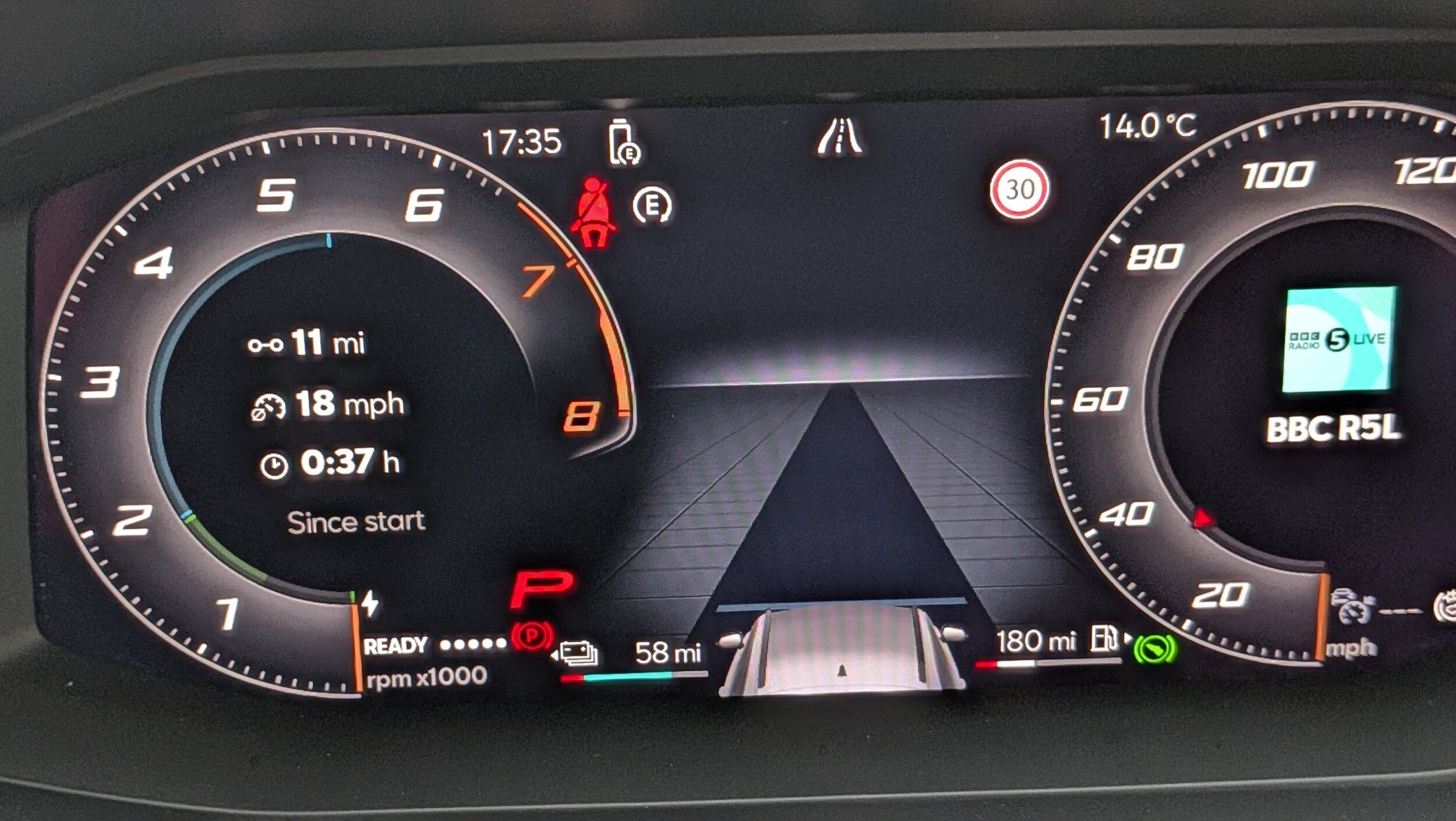

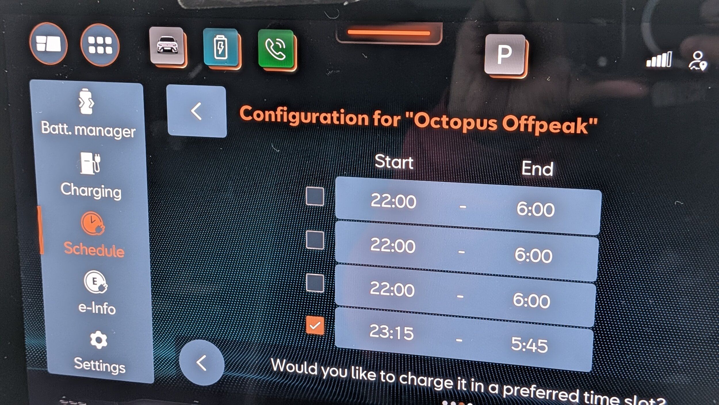

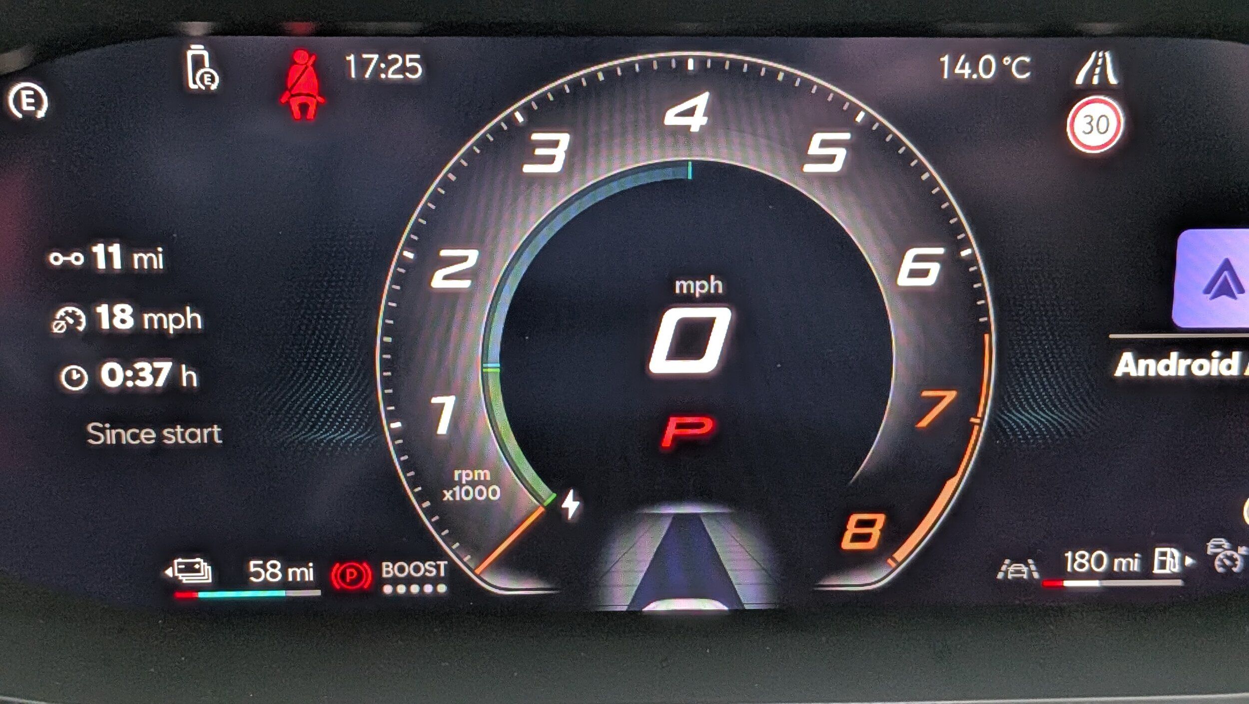

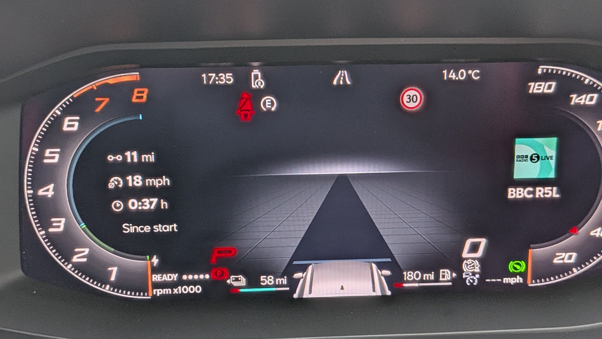

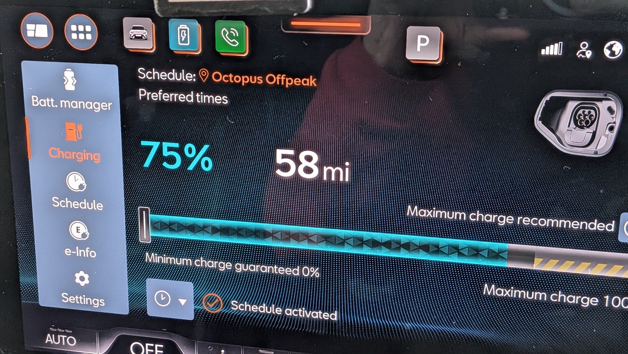

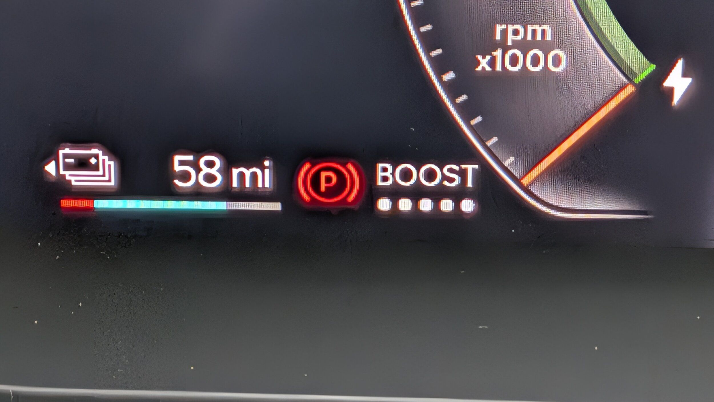

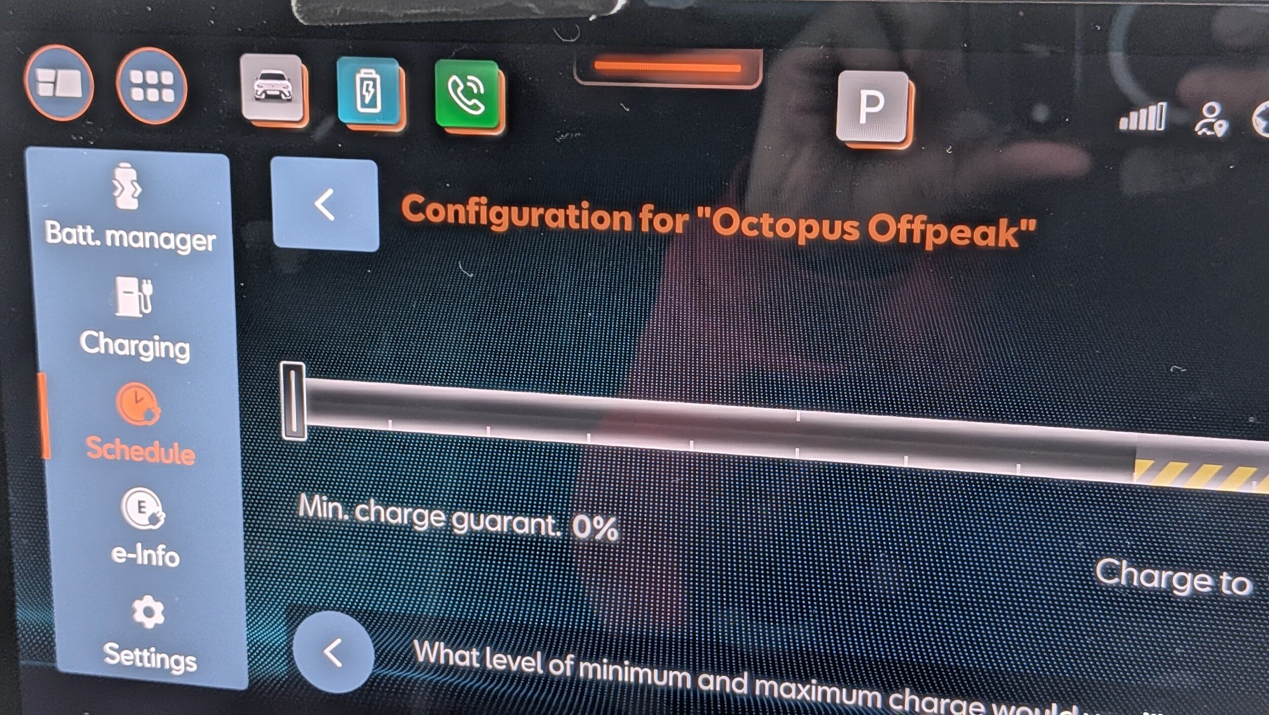

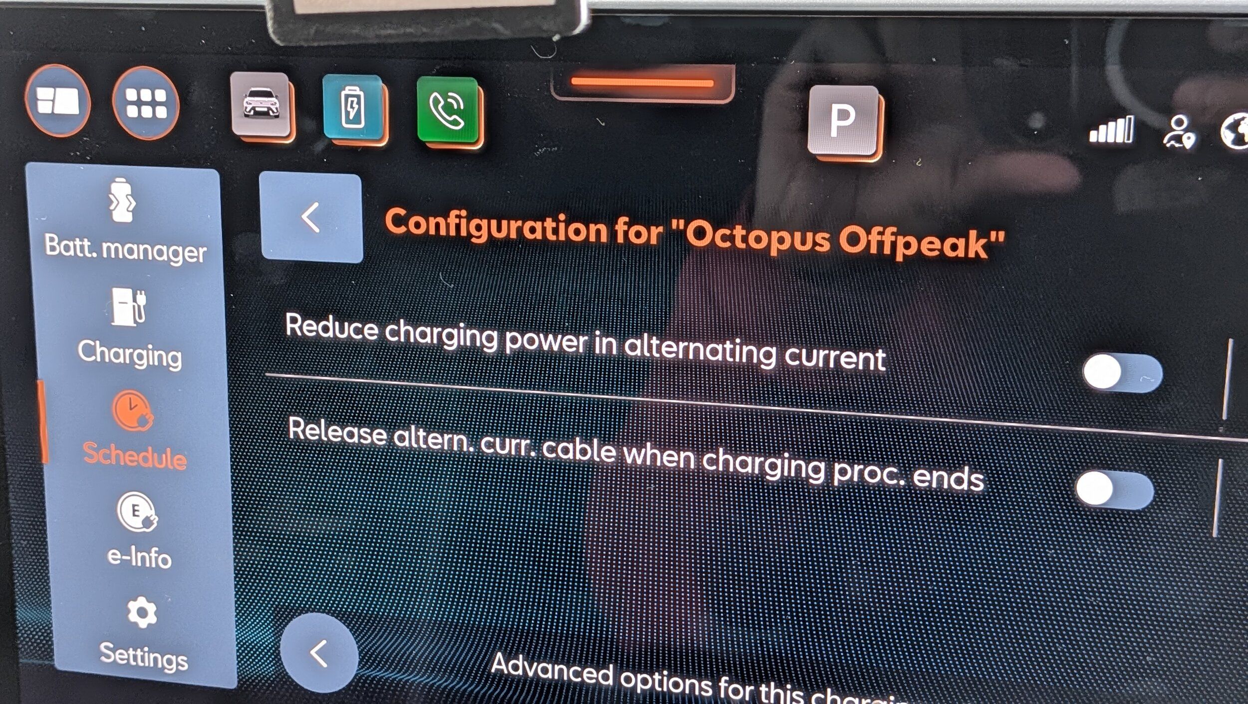

Had mine done about 2 weeks ago. Charging schedules are there although I continue to rely on Octopus to control.
Has cleared most of the defects although still occasionally get a warning about the rear tailight not working. Flickering lights in the cabin all good. Digital dash looks slightly different from memory.

Had mine updated last week, took 2 days at dealer. (1.5 really).
Schedule in place only charged twice since update, but does hold the red light off and was fully charged each morning. Haven’t had any drained 12v again (yet).
I’ve just set it to a schedule during the octopus off peak hours but this morning I plugged it in and selected charge now from screen and did a load of washing. Whilst octopus are offering the chance. So it’s fairly simple to override.
