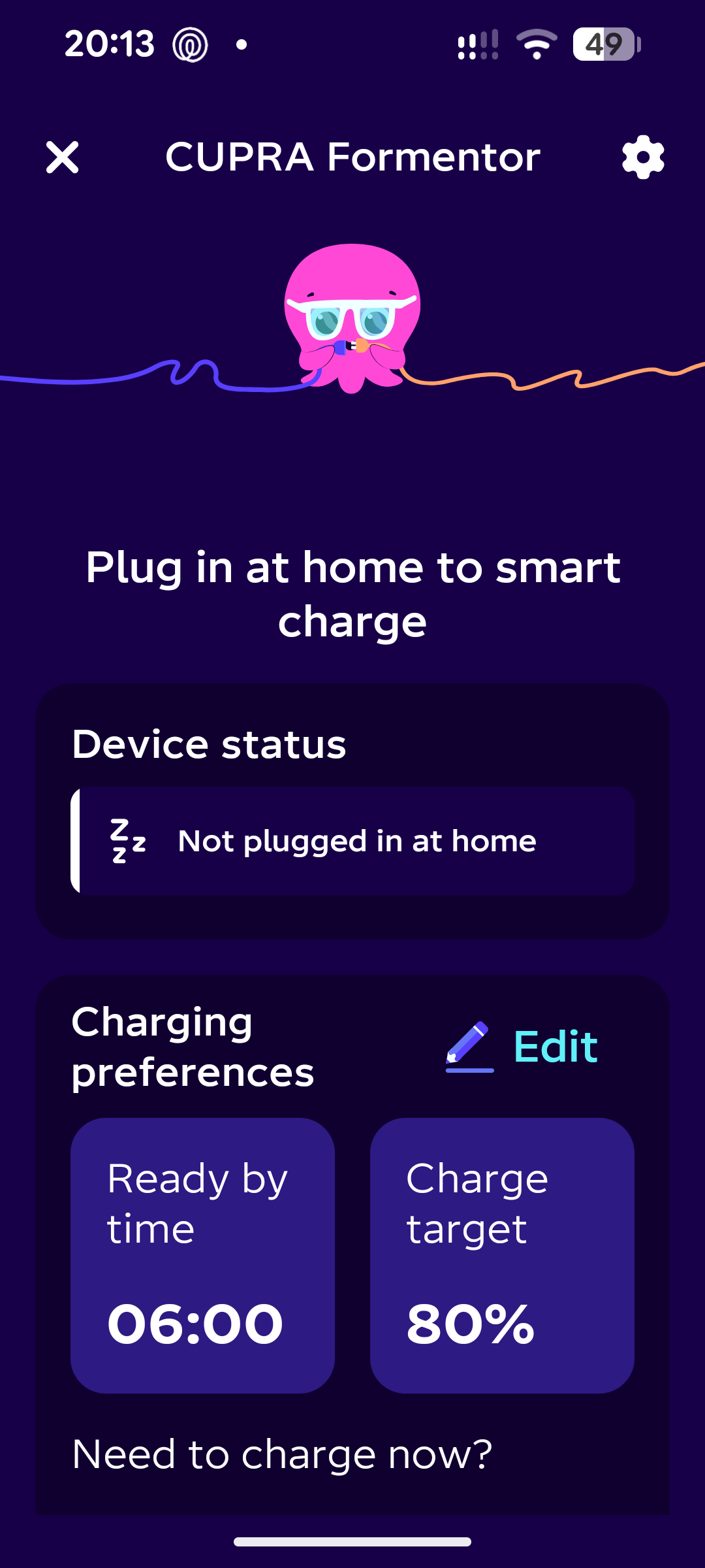

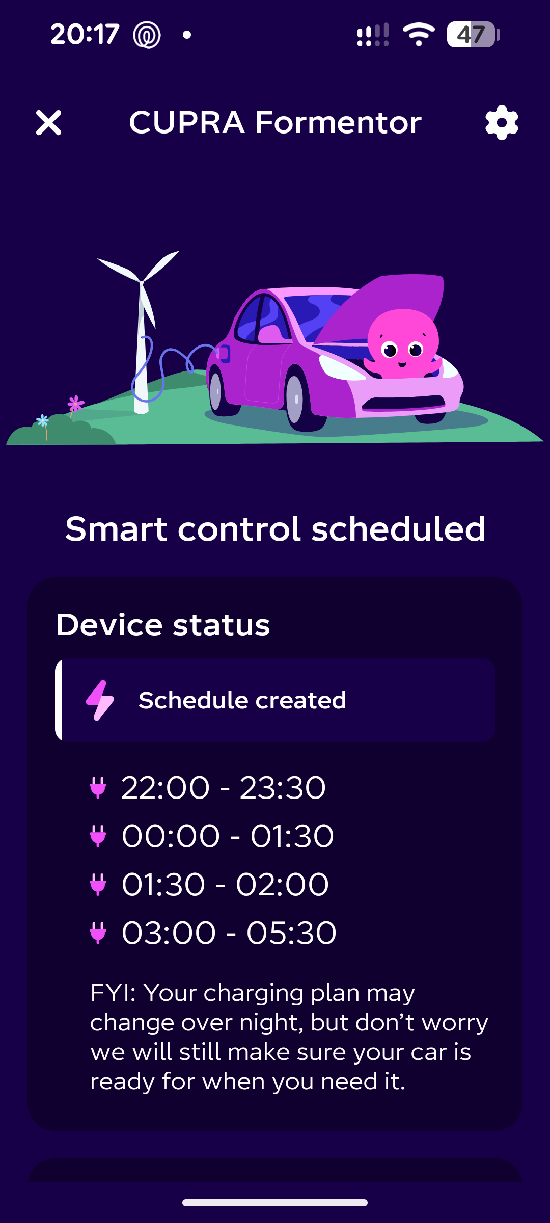

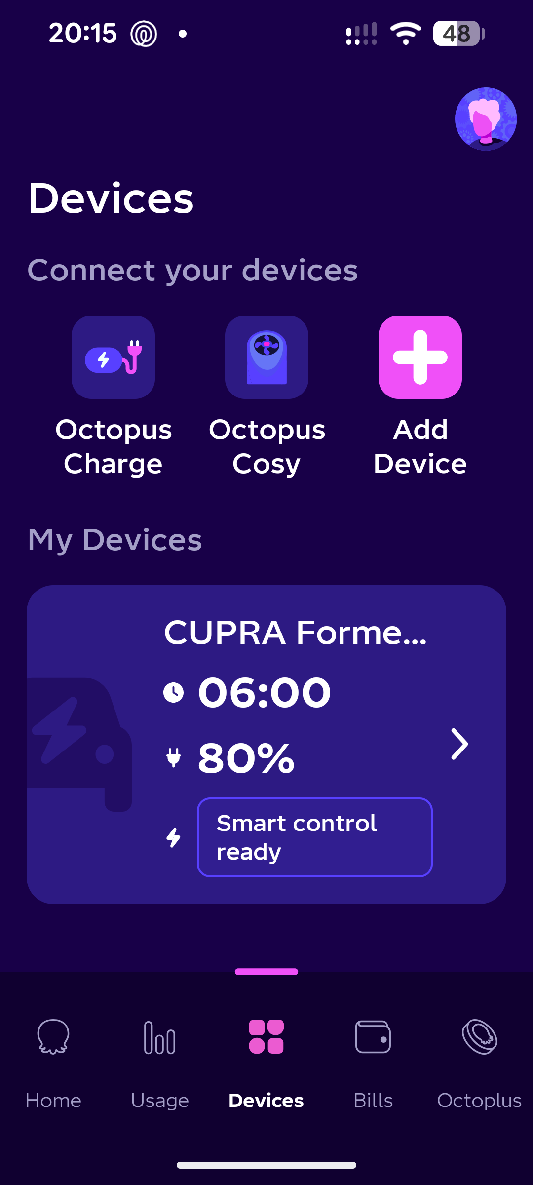

Hi, Octopus Intelligent Go requires you to log into your Cupra Account (via a third party system that Cupra use). When the 3 pin charger (or other compatible charger) is plugged in, the car starts to briefly charge. I am no tecky but the car, via the third party, let's Octopus know you want to charge the car. From what I can see, Octopus then schedules the charge (something Cupra themselves seem to be unable to do currently).
You will already have set within the Octopus App how much you want the car charged to (probably 80%) and what time eg 8am. Octopus then sets a Charging Schedule to get it to that % by the time specified.
Whilst Octopus Intelligent Go has off peak rates from around 11.30pm to 5.30am, Octopus could decide to charge it outside of these times but will still charge you the off peak rate - it works faultlessly and once set up, as long as you don't need to change the % or the time, all you need to do is plug in the charger.
The Octopus App will then shortly display the schedule.
If you do want a referral code (both parties get £50 account credit each) - https://share.octopus.energy/loved-shell-69
Some images attached which hopefully show how it works?

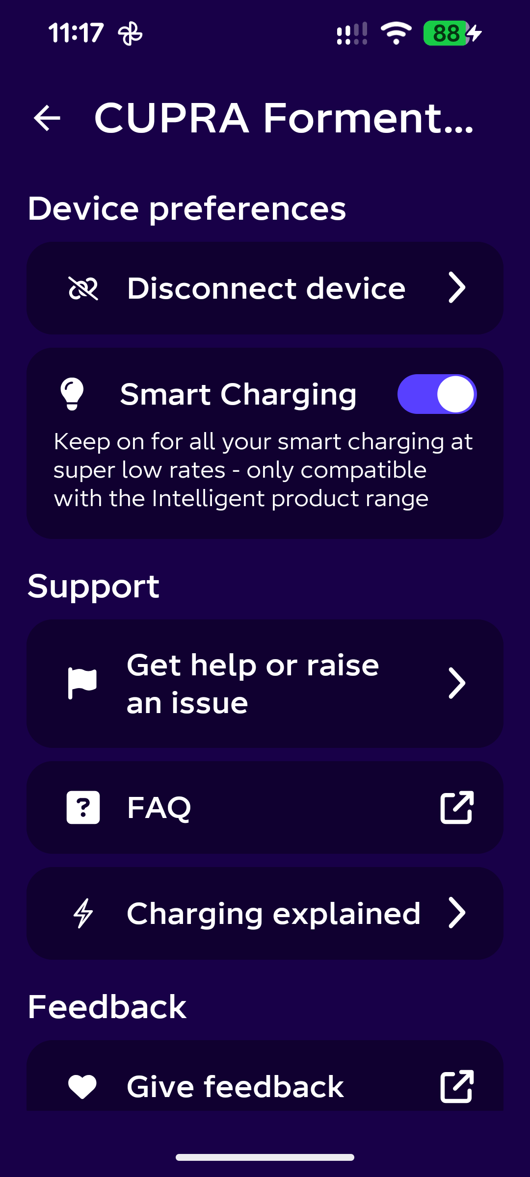

Do you have the correct username and paaword for Cupra Connect - these can easily be reset within the Cupra App. Once you are past this point stop, u. Plug TH charger, wait a few minutes then reconnect. Ensure Smart Charging is toggles on within the Octopus App

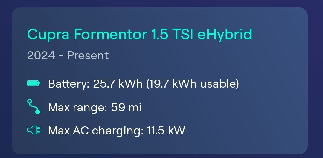

I wonder if the problem is that IOG sees SEAT instead of Cupra. I think IOG works if the old ehybrid is chosen (SEAT Leon eHybrid (10.0 kWh)) but only gets 50% charge. Might be worth trying, or even try SEAT Mii Electric (32.0 kWh) and select 50% charge to get 80%.
