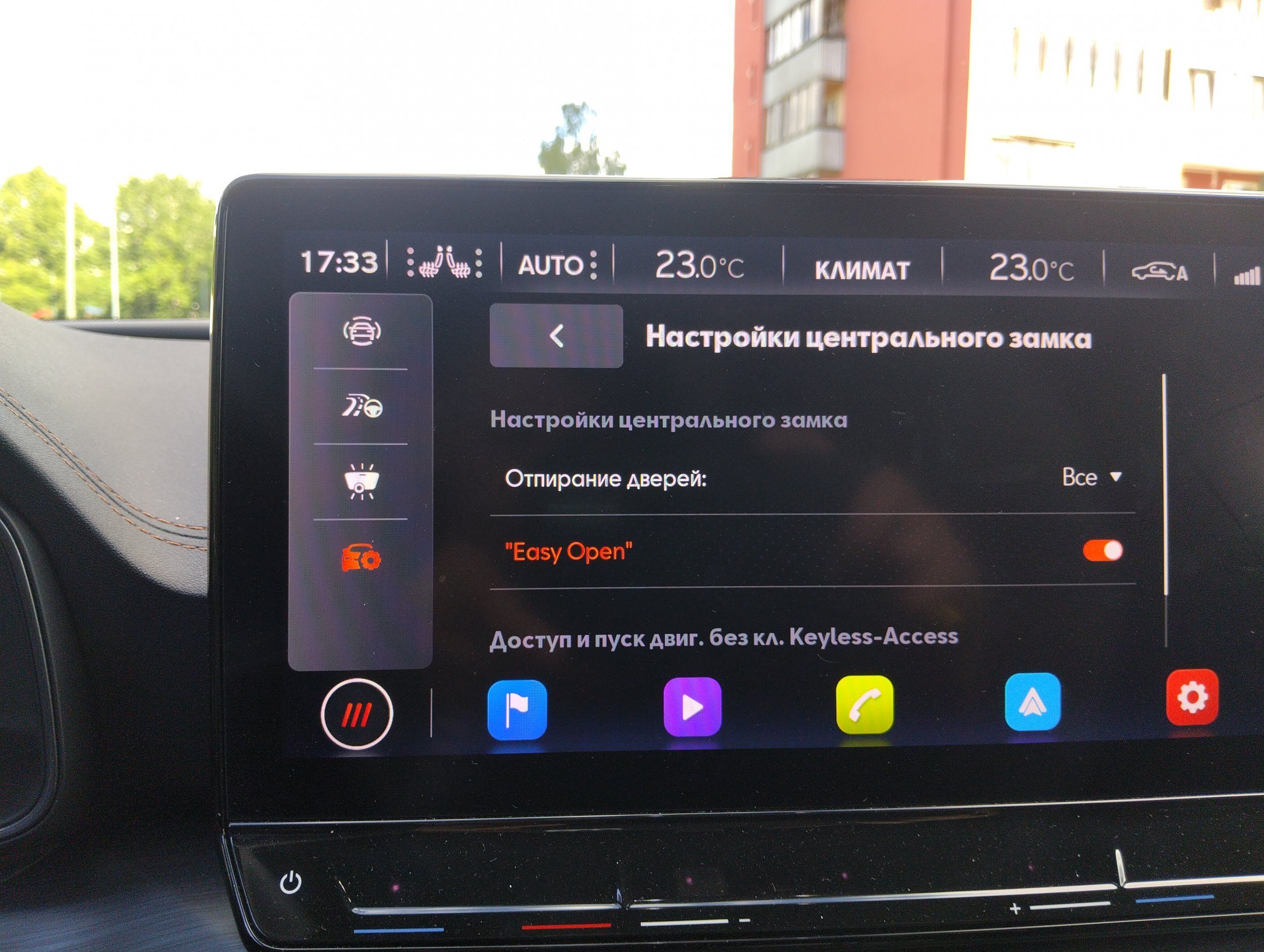

ifa Active Member Jul 4, 2024 30 3 Estonia. Jul 6, 2024 #1 Hola , friends. Can't understanding, what function? Thanks so much. Attachments 17202764188851677787088477432333.jpg 656.9 KB · Views: 646

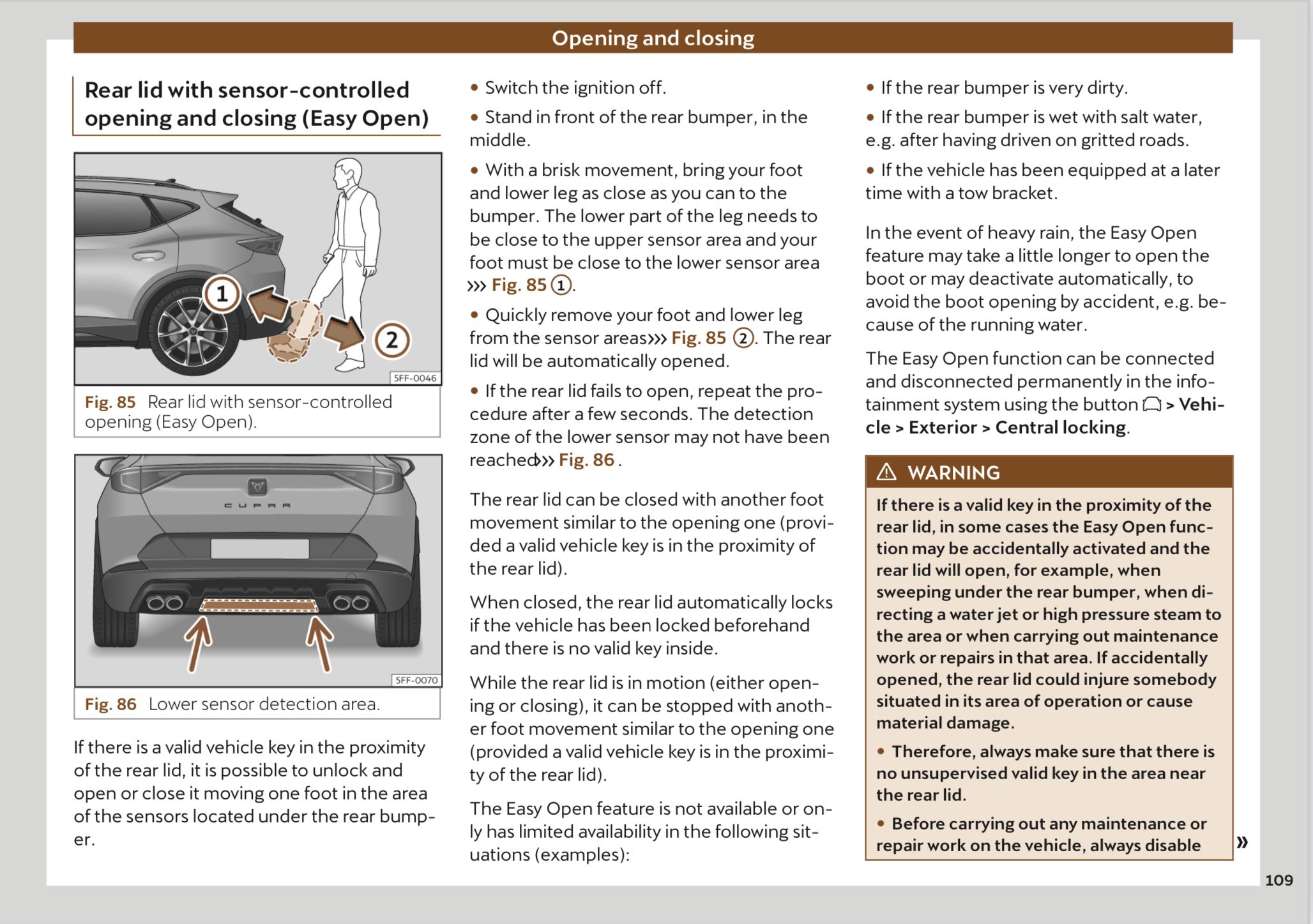

SRGTD Active Member May 26, 2014 3,030 1,934 Jul 6, 2024 #2 Easy Open is sensor controlled function for opening and closing the tailgate. From the UK version of the owner’s manual; Reactions: ifa
ifa Active Member Jul 4, 2024 30 3 Estonia. Jul 6, 2024 #3 Thanks, friend. Is working!!! First good news about my car from one year possessions. (I must celebrating ).
