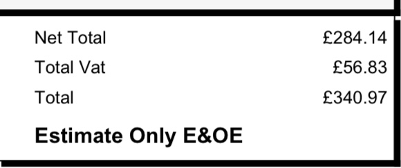

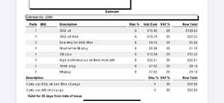

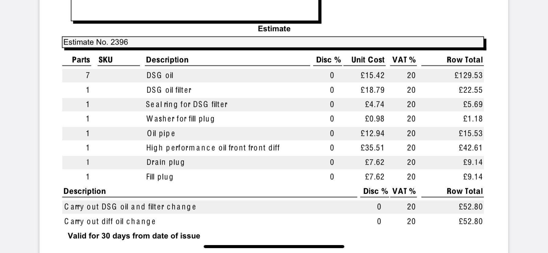

Hi guys,
Posted in this thread previously trying to get some info as the servicing for the Cupra diffs is hard to come by.
Just got a quote and wondered if anyone could tell me if the price looks good and wether what’s down will cover the servicing for the diff and also dsg whilst I was at it to satisfy the warranty (that states I must maintain the car as per manufacturer instructions)

Why is the DSG oil so stupidly expensive? £155 for some oil seems rather steep!

Also, does anyone know for sure what the intervals for servicing the DSG and diff are? My manual doesn’t really say much. From reading on here I gather that the diff is every 3 years or 30k miles? And the dsg is every 4 years or 40k miles? Is this correct?
Stephenator280
Nov 5, 2017
112
40
I paid £344 for both a month or two back (although I think this included the excess on the courtesy car). This seems to be about right for main-dealer prices.
mitchybenny
Oct 19, 2019
33
Oh that’s good so my quote seems about the same. That price also includes a courtesy car if I need it. It’s not from a main dealer but a very reputable specialist
