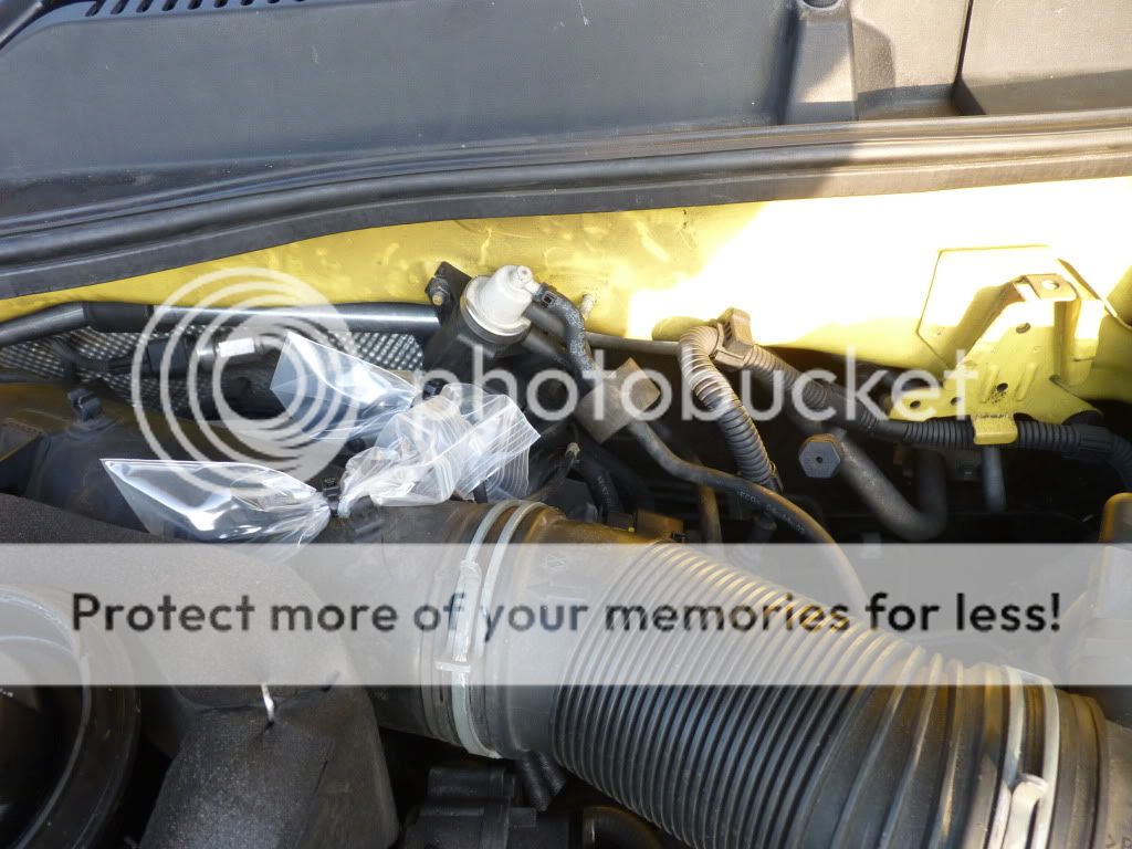

Just been off to take the pipe from the EGR off, and mine does look soothed up, but not too bad luckily. So taken the pipe from the actuator off, and plugged both ends. But has anyone disconnected the pump instead? Or does the ecu see this as a fault? And it looks to feed something else, but just wondered if it does.
I may opt for the delete pipe, but at the moment will just see how it goes with it plugged off.

With regards to your pipes, you can remove ALL pipes apart from the one to the turbo, the vaccum pump and the airbox. (leaving the N75 Valve in the system)
This is what you will be left with lying around afterwards
Trying to retain the anti shudder valve though, well for the moment anyway lol
