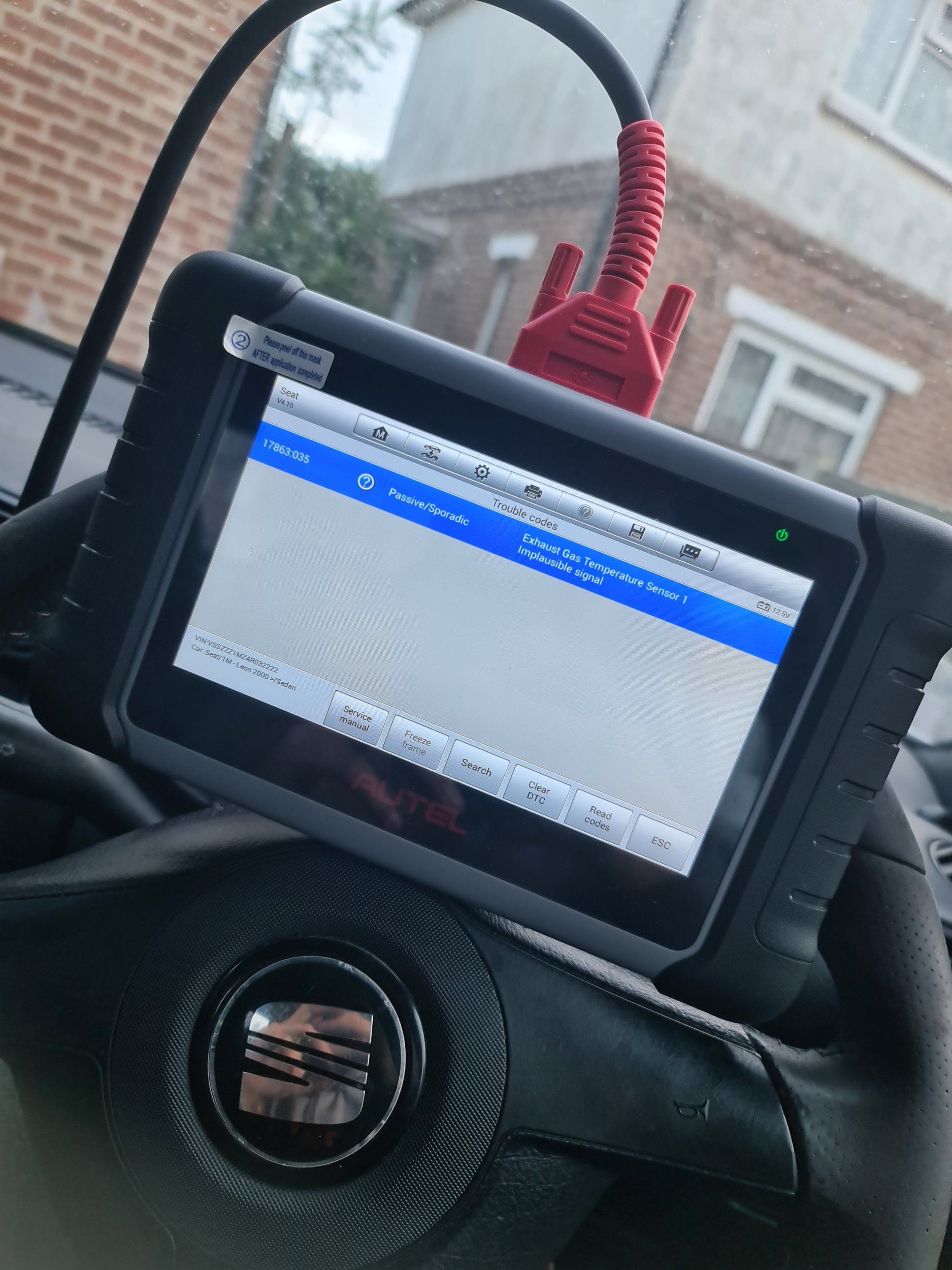

I don't really know when this problem started,
because it never triggers the EML and my old scanner didn't pick it up, but occasionally the fault code: 17863 pops up on my LCR. It will clear and stay off for a bit, but sometimes I randomly scan the car and it's back again.
I'm not sure if this is related, but sometimes the car feels completely gutless. For example I could be cruising in 3rd at a steady speed, then when I put my foot down I can hear the turbo but the car just doesn't go anywhere. This is very intermittent though. I could do the same thing straight after and it would boost/gain speed absolutely fine.

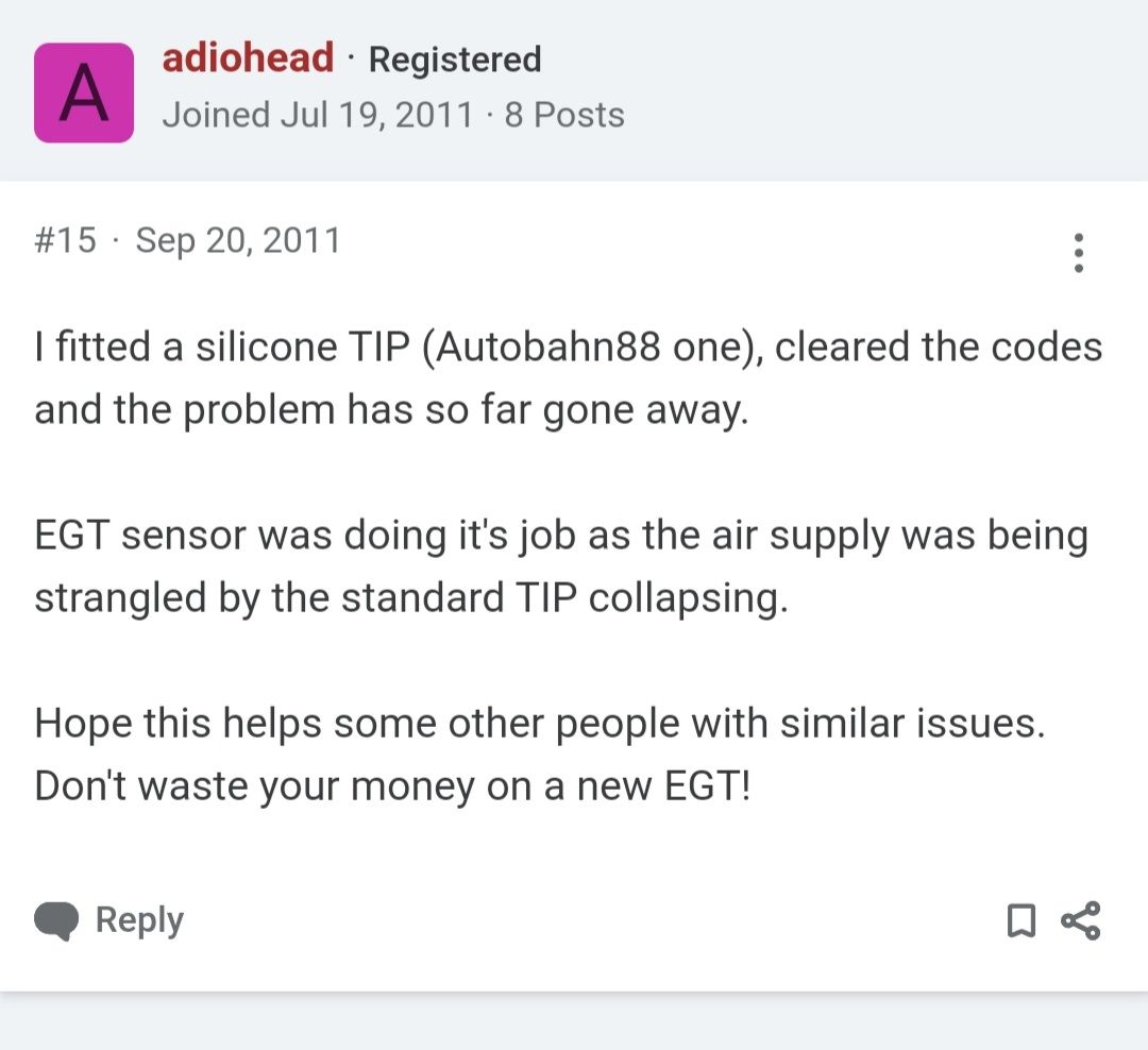

Most people go straight to the sensor being faulty, but I can't actually find the right one for sale (not even second hand), and from what I've read it's a very expensive part to replace, so I don't want to be spending loads of money on parts that might not fix the problem. Especially close to Christmas. I did however read a comment on the Audi forums, from somebody who owns a Cupra R, and they said their problem (same fault code) turned out to be the stock TIP collapsing. Does that sound like it could be my problem?

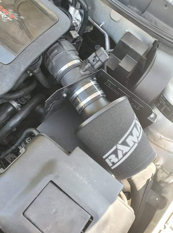

Hows the air filter looking?
Pure guess off the back of you mentioning the stock tip collapsing.

It has an aftermarket ramair one on it, which I installed (brand new) a month or two ago...I do plan on upgrading to the proram filter at some point, but that's just down to personal preference really. There doesn't appear to be anything wrong with the current one from what I can tell.
An oversized TIP has been in my basket for a while now, so I guess this would be a good excuse to finally buy it. But again, I'd rather not start randomly throwing money at it, when I could put that money towards replacing whatever is actually at fault. I just don't really know how to go about diagnosing the problem. It seems to be intermittent.

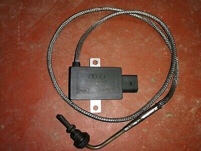

First job is to make sure the EGT sensor is screwed in properly. It can become loose and work its way out.
If you need a new one the part is 06A919529. None on eBay, so you might need to find someone breaking an LCR or Audi TT. I bought a second hand one and it's still fine 2 years later.
The fault is usually with the solder on the circuit board in the box, so it can actually be repaired.

That's actually good to know...Will there be something visibly broken inside the box? I've done quite a bit of research in to this, and haven't seen anything about it being broken inside the box, or coming undone. I have to jack the front end up tomorrow, so I'll check both while I'm at it.
If not, I'll start looking for somebody breaking a Cupra R. I did look on ebay for either a brand new or second hand one, but like you said, there isn't anything on there at the moment.
It's these 5 solder joints on the circuit board inside the black box:

Can see the wire in the image...It's braided all the way along, and it's pretty much fixed in place on the car (doesn't move), so I wouldn't have thought that the wires would break. I guess it could still be possible though. But making sure the sensor itself is done up tight, and re-soldering the box seems like the easiest things to do, so I'll start with them and go from there.

Yeah the only two things that can go wrong really are the sensor becoming unscrewed at one end and the circuit board at the other.
