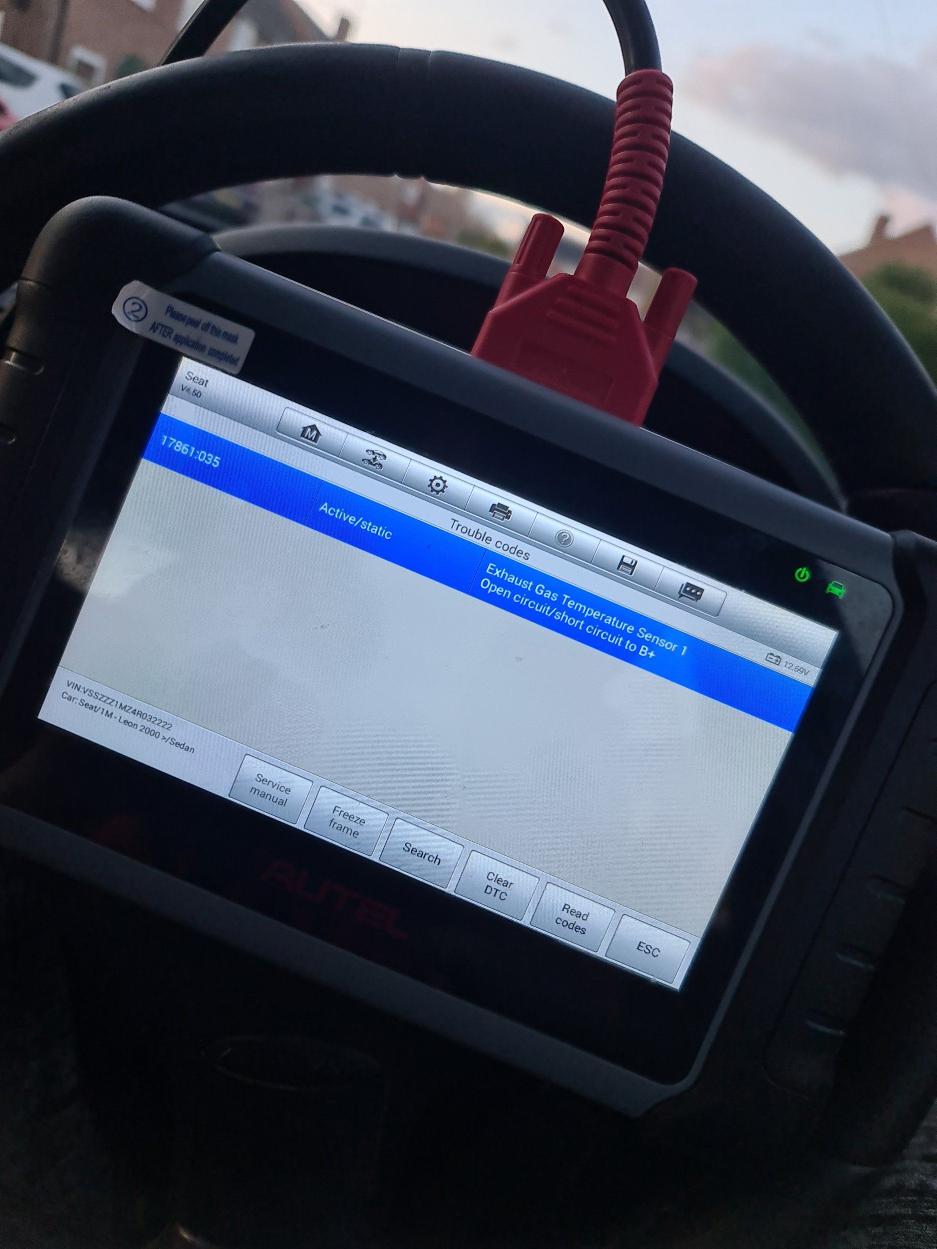

Typical. After doing the various trips to the relatives I'm suddenly finding I'm not getting any higher than 27mpg. Plug in the code reader - 17861.
So the second hand sensor lasted only 18 months ?

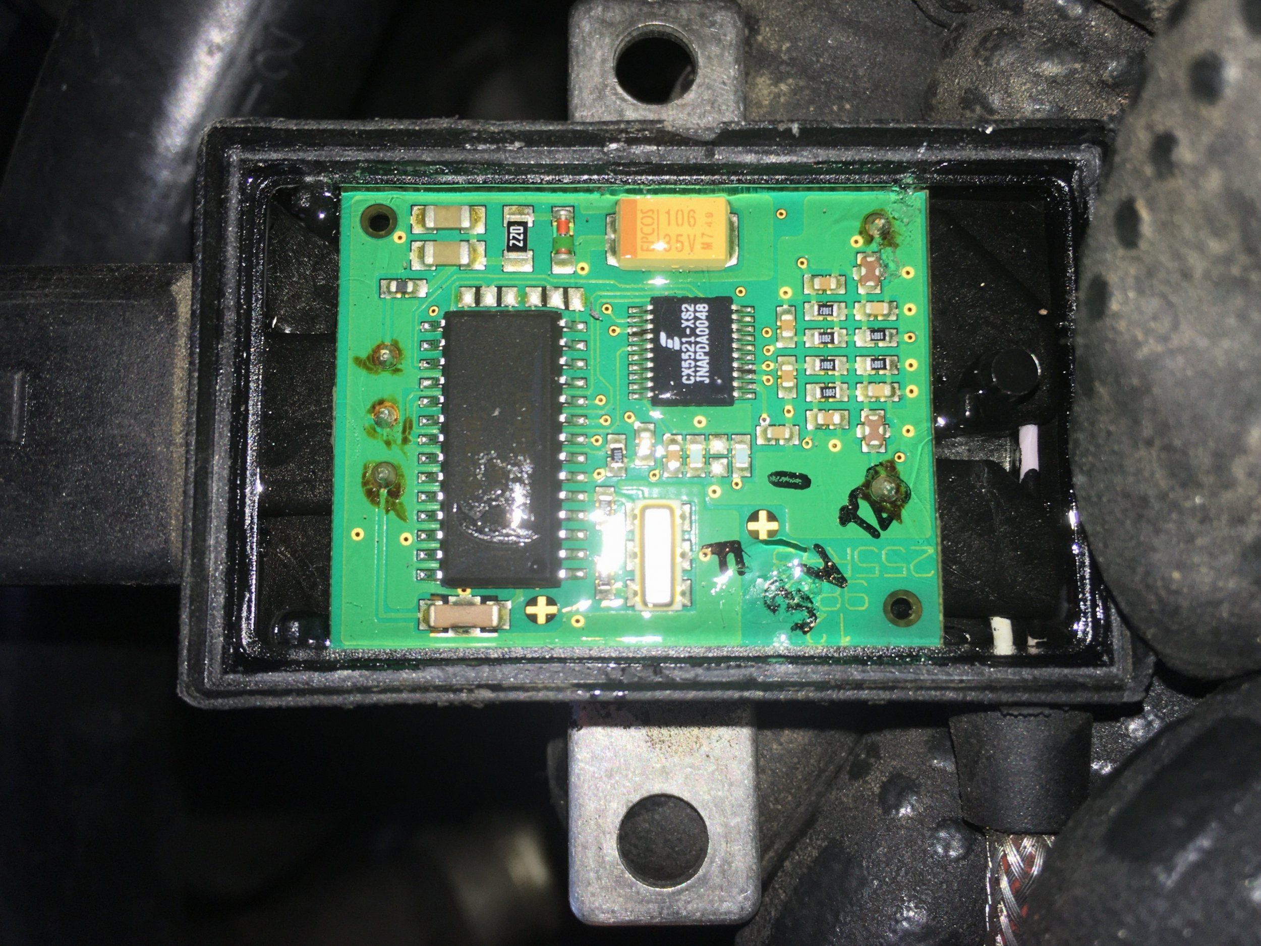

Apparently it's the five rusty looking pins (dry joints) that are the issue. They need re-soldering.
I've got an electrical engineer mate so I'll see if he can do it.
Yeah, those are the ones that I re-soldered on mine but it didn't make a difference...I'm just going to replace the sensor when I get the chance. Had a lot of time off over Christmas and New Years, so I haven't done anything to the car at all. Just been driving it the way it is. But I'm going to start putting some money in to fixing all the little problems that is has, very soon.
I believe my EGT sensor is now gone completely ? I never got around to replacing it, and it never triggered the EML...But I plugged my scanner in for a different reason and I have a new code regarding the EGT. The temperature on live data is also permanently stuck on 1110°c and never changes. So it might be time to finally replace it lol

There are a couple of fault codes with the EGT. I think one is a permanent no-signal and the other is intermittent.
You might be best emailing [email protected] in Poland - he sells improved replacement circuit boards for £40

I have already ordered one now, for £50 ?‍♂️ If I have any more issues, then I'll definitely look in to that improved circuit board...I was originally getting the code 17863 - Impulse Signal, which was intermittent. Sometimes the fault was there, and sometimes it wasn't. But now I'm getting 19861 - Open/short circuit, and the sensor isn't working at all on live data. It's permanently reading 1110°c now.
