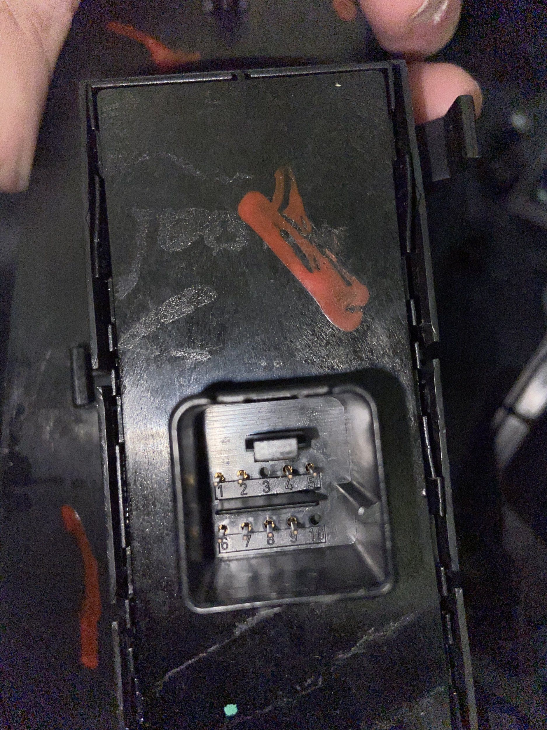

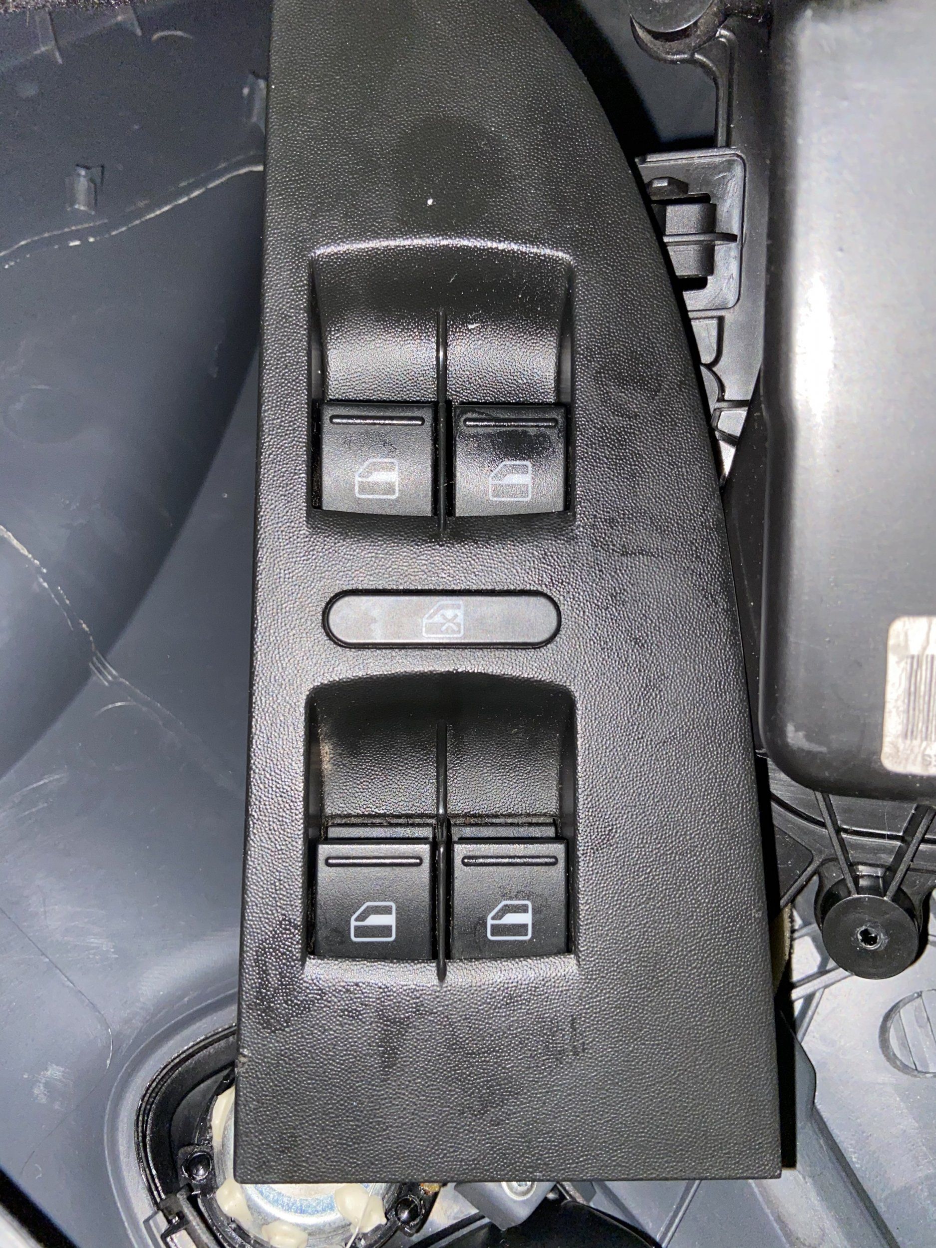

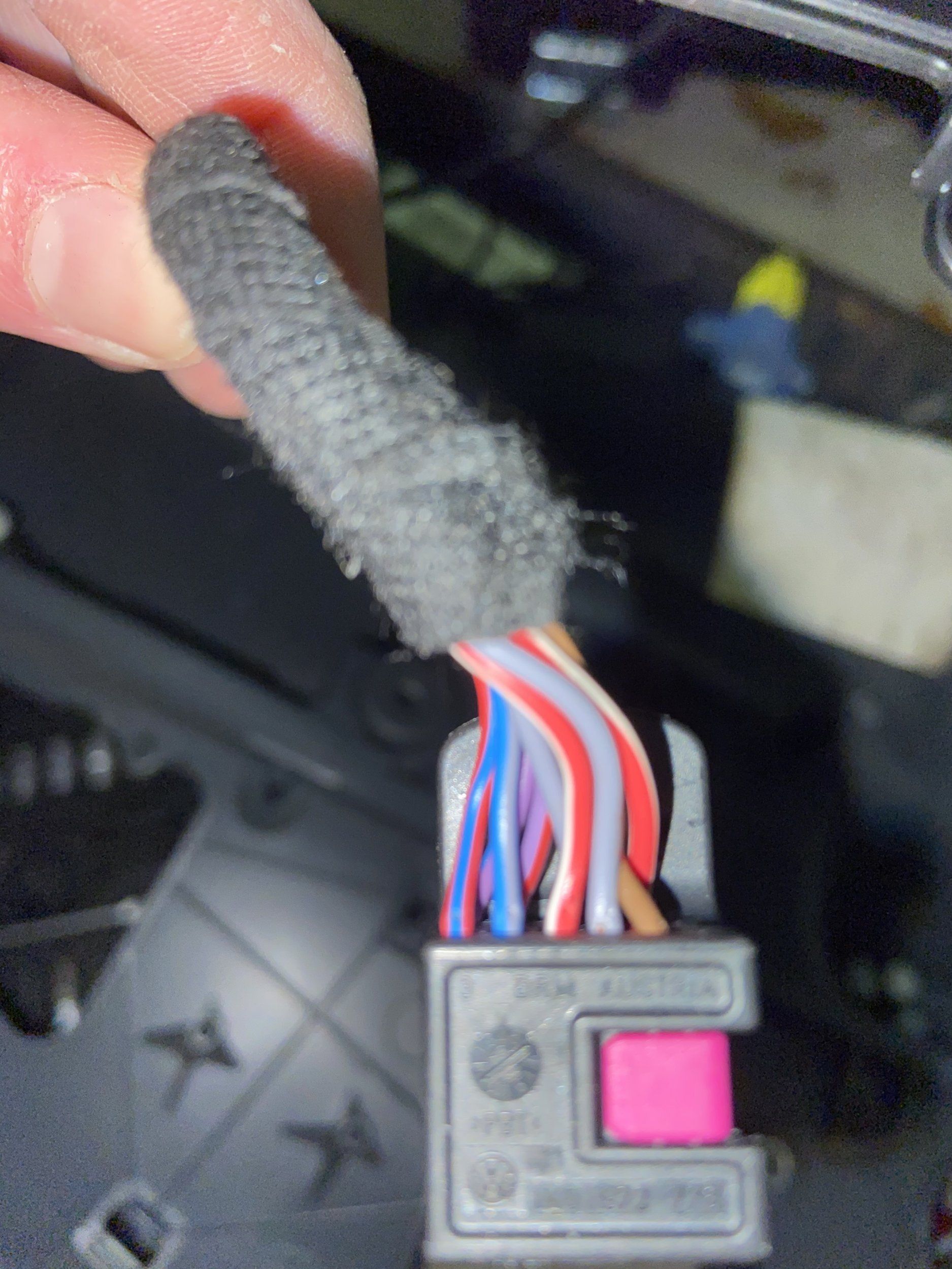

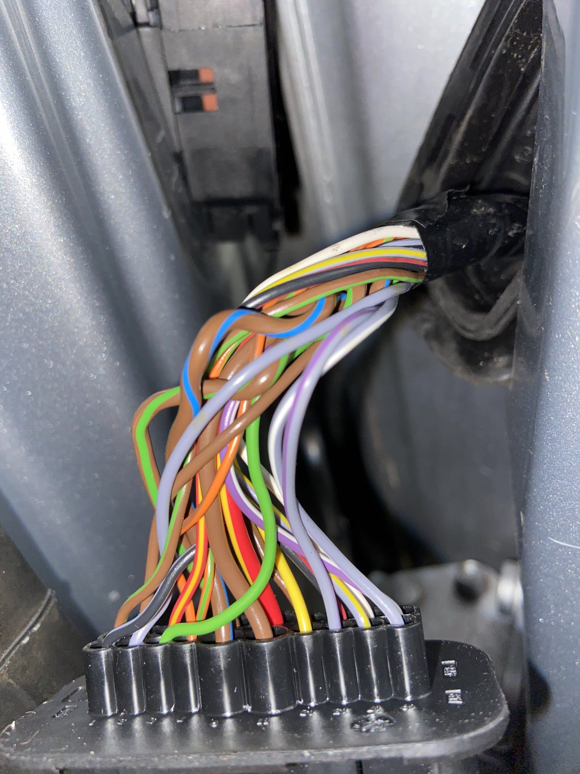

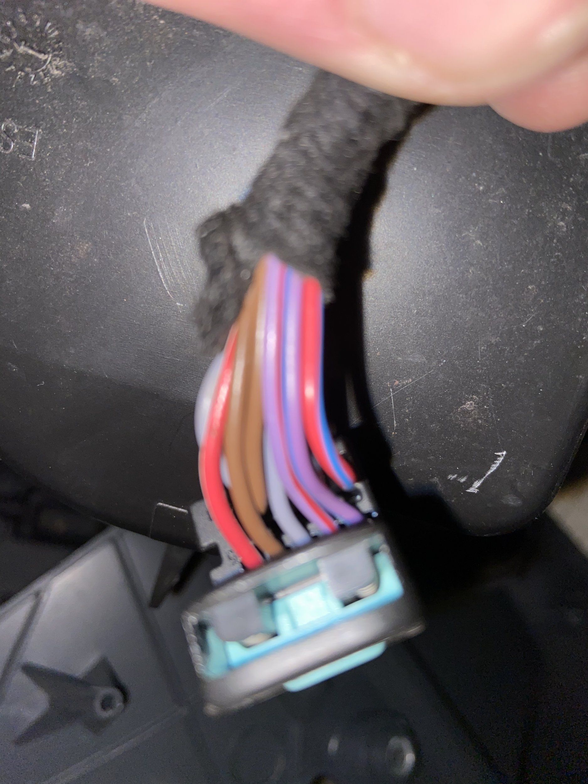

Hi all,
I have a fault with rear passenger electric window it will go up and down off it’s own switch but not from the drivers switch. I’ve opened the switch up and circuit board looks also the cables that come in between drivers door and pillar seem in good condition. Can anyone help point me in the right direction?
