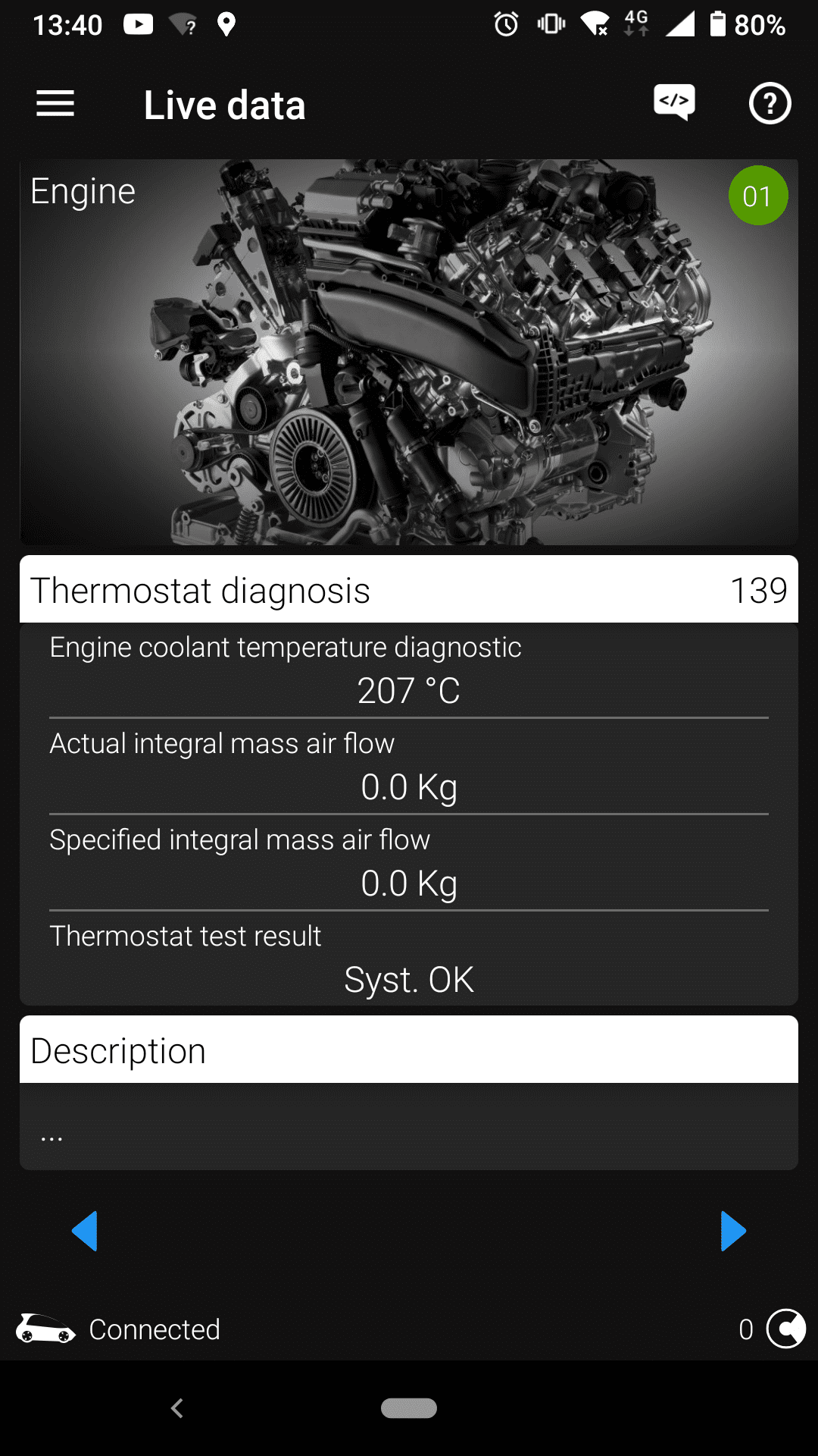

I'm trying to figure out what this first line-entry is? It is bank 139, but I have no luck finding out more info, nor finding out if this temperature range is normal?
That being said, coolant temperature sits happily at 98"C so I'm not sure what I'm looking at and what is burning at 207"C here.

Does that 207 number change with driving? Does it warm up normally from cold?
Apologies, I was out of country and couldn't reply. So, um, no. The number doesn't change at all. Also, on other banks, oil temp. stays at 40" Celsius as well.
Not sure if there's a problem with my sensors or MK2 simply doesn't have those.
