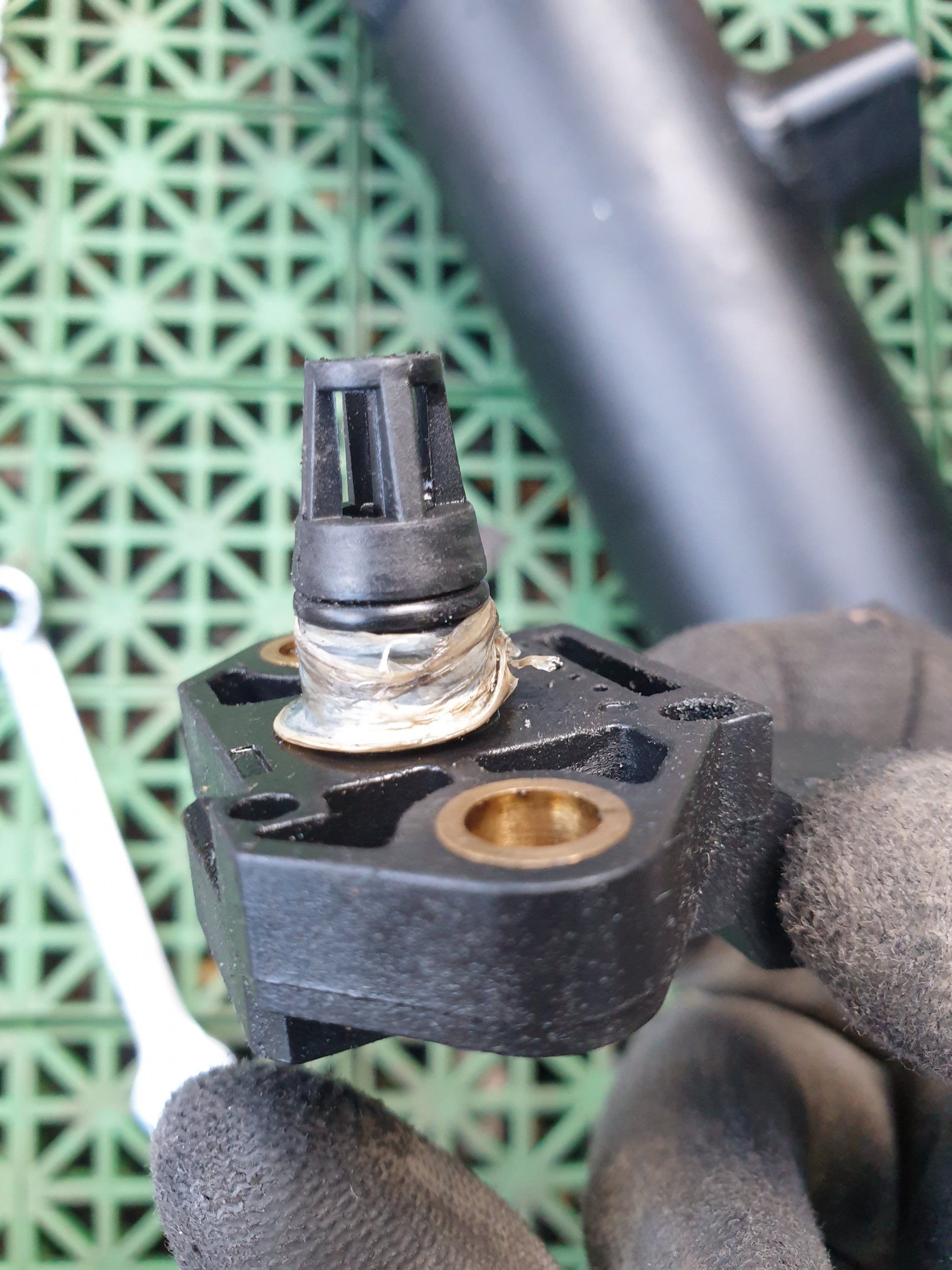

performed boost leak test, heard hissing and took a while but eventually traced it back to the MAP sensor... took it out and found this:
the o ring wasn't sealing as it was the wrong size so it was PTFE taped - this was not sealing and leaking, also the actual sensor itself has been blown to bits - the crack at the front was like a flap lol.
replaced it and ran the car - heard the diverter valve for the 1st time... however still went into limp after a boosting fully.
