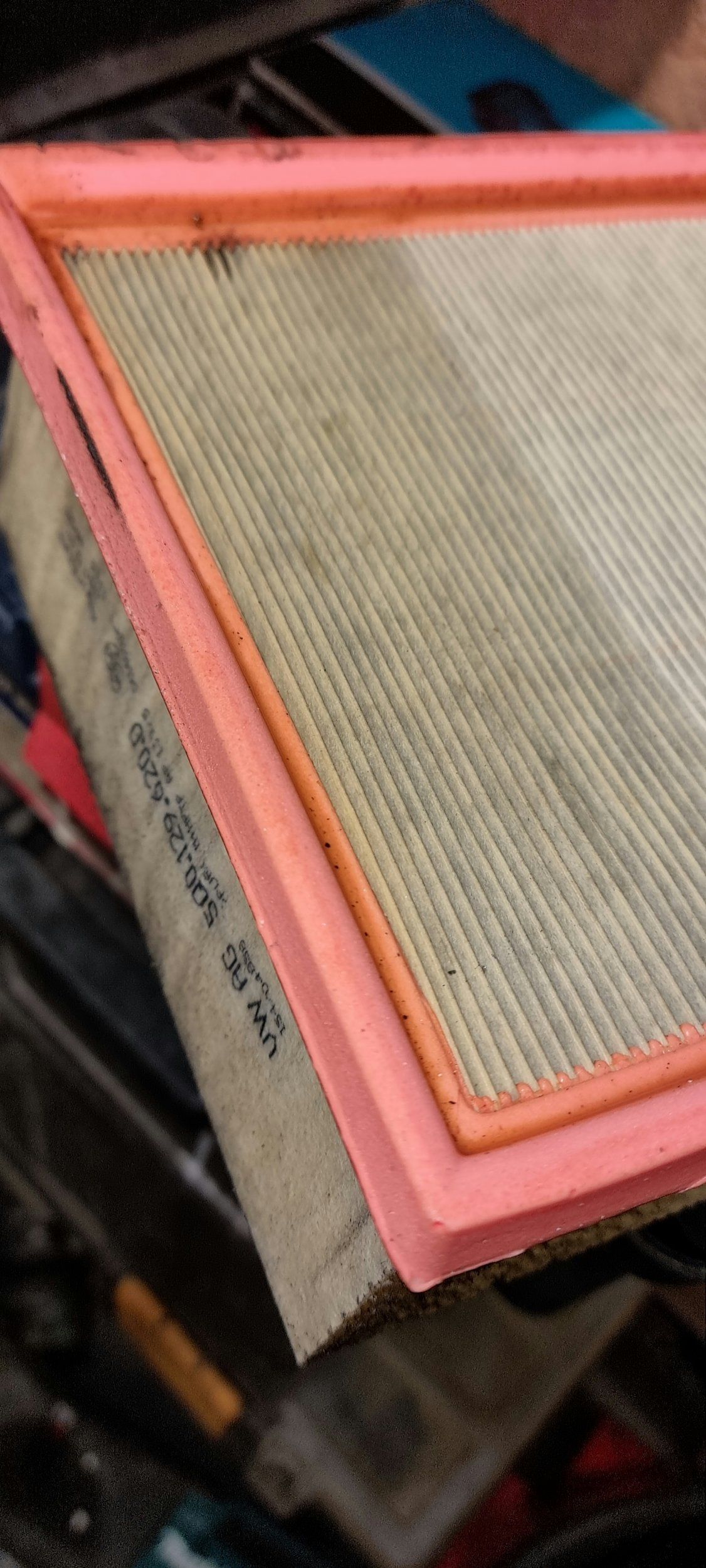

Air filter was dry no traces of oil.
Air intake pipe had few drops / trace of oil but nothing alarming.
I'll keep an eye.

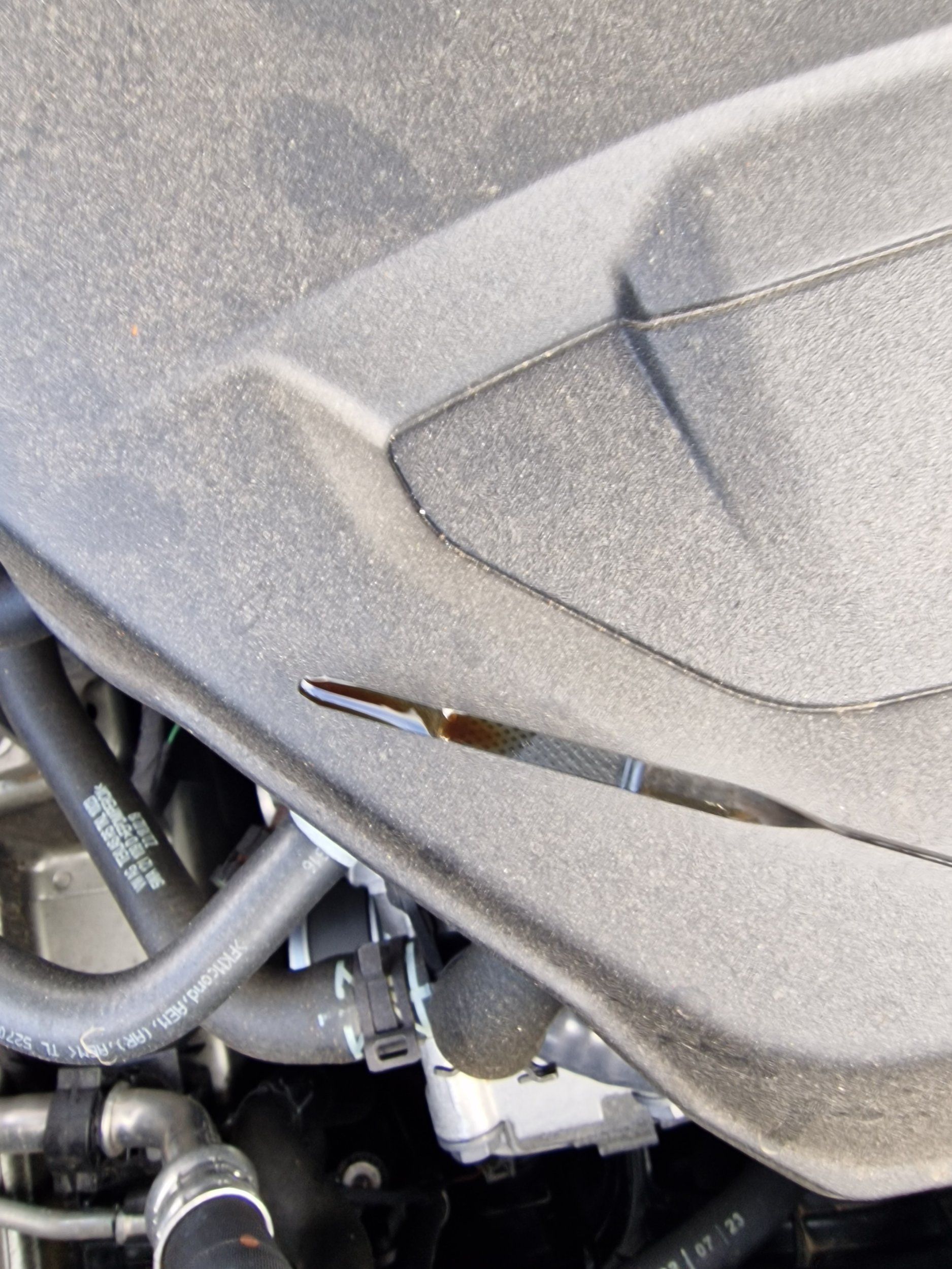

I know im checking oil regulary, and normally on the indicator it shows 100%, but this time i have followed instruction manuall... after driving on m25 for a while, i have stopped on petrol station, 100%LEVELED SURFACE and checked my oil after 5 min.
To my surprise on the dipstick it shows around 140% level, which means 40% more than it should.
Im thinking if it could be the case, if that mistake made by cupra service on my last ool change caused that.

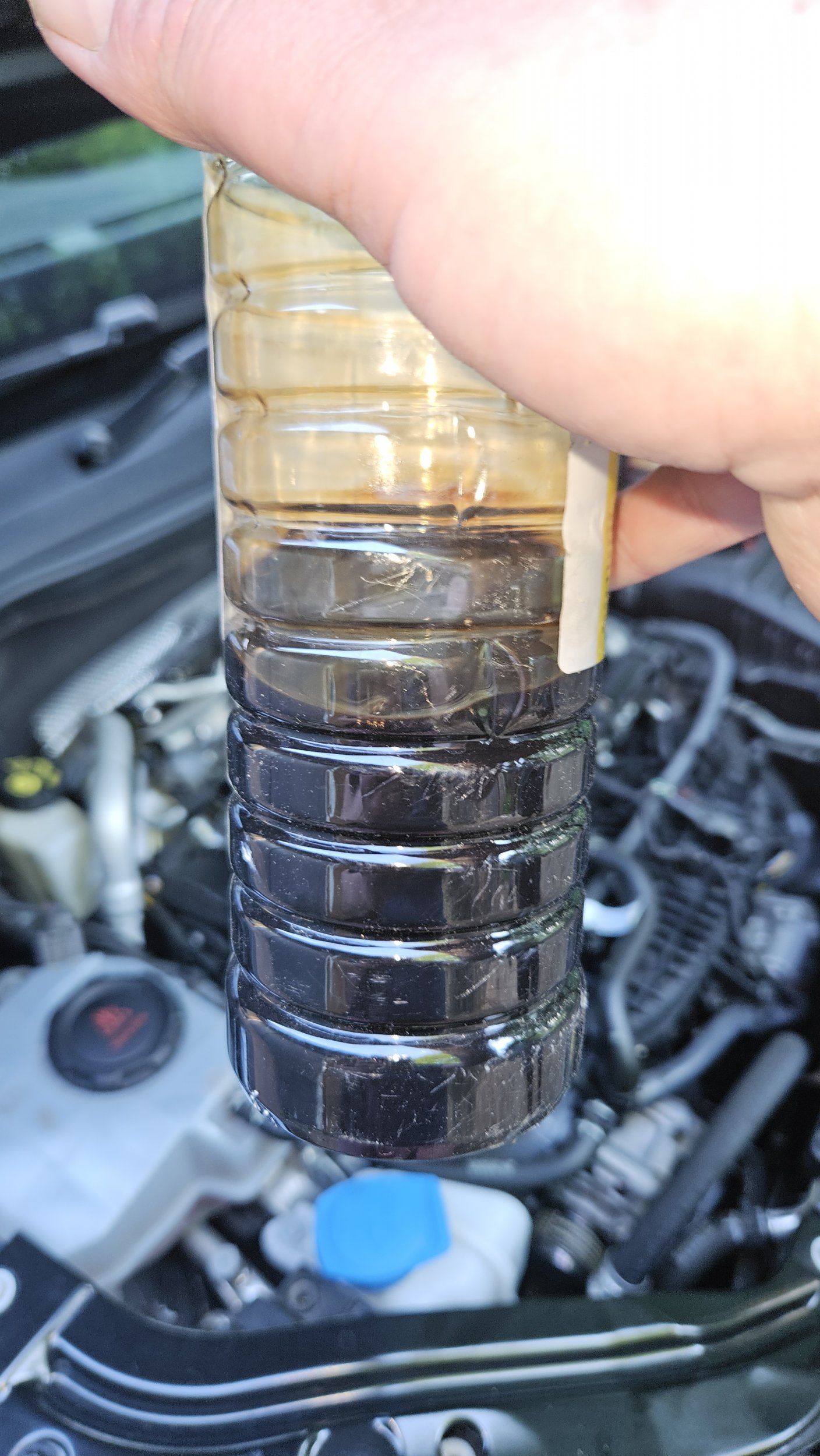

I ha e Pumped out half a litter of oil through dipstick hole and car seems to drive a bit better i thing, placebo maybe..
But i will be looking at it..

Have you tried cleaning the intake pipe and housing with degreaser, repla ing filter? I would do that, document it all and observe..

Its around 2/3.
Also noticed that it is very sensinive on how level car stands, just a tiny hill, and already 100%.

Thanks for the heads up. I will check this with mine. The only comment i would make regarding the dealer refilling with oil is i would assume the dealer measures the new oil by quantity as stated in the vehicle specification rather than using the dipstick as reference. It would be plausible though that if a trainee technician did the oil service they could have possibly overfilled it.

How much oil are we taking about here?
Engine oil does expand but it's not exactly lemon juice. I wouldn't expect cold start oil level to be 2/3rd and expand to full level at drive time on a regular road going car.

Τhats what exactly happened to me on the lat oil change at 45 k km! A day after and while preparing to travel I checked the dipstick and to my suprise it was all the way up over the full point and about half way to the point where the stick starts to swerve. I didnt drive the car and Monday morning I went to the Cupra service where I did the oil change and yes they also confirmed overfilling of abt 300 ml. They did take it out but not even apologised or anything to that matter. They actually even took out more than that and had to refill!
Checked after reading the post and apparently I also found some oil moisture blended with dust at the same place where others found it. Didnt open the filter box, just wiped the area and checked again after a few days but nothing new showed up. I think tha muste have happend probably when they overfilled the first time. At some point I will check the filter but so far the oil level on the dipstick is the same since the last visit when they had to take out the excess oil they put. Yesterday and today I drove quite aggresively on a weekend trip and will check tomorrow to see if the oil is still at the same level.
Reactions: Cupra_33 and KJA
Checked today, its near the max so no oil loss. Didnt see any oil moisture around the airbox either. Im at almost 50 k km.

Little bit less than 2/3, just above half on cold engine, after long motorway drive dipstick on full in my case.
