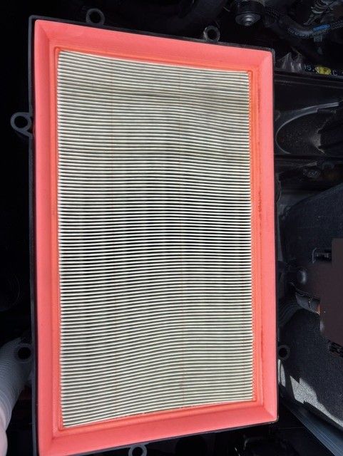

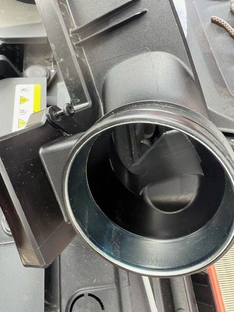

so whipped off the pipe and filter and there was a very small amount of oil 5-7 drops id say in the grove where the hose from the turbo is fed by the air box lid, nothing showing on the air box lid pipe work (see pic) and possibly some very slight residue on the filter foam surround bit no oil whatsoever in the paper pleats of the filter (I did remove it and checked both sides).
I've cleaned up what little residue there is, Mileage is just over 34100 so will check again in 100 or so miles.
I ran a paper towel down the pipe towards the turbo (very carefully and didn't pick up any more oil so this may just be a similar issue to Zenoteck's only my one probably wasn't over filled so much.
