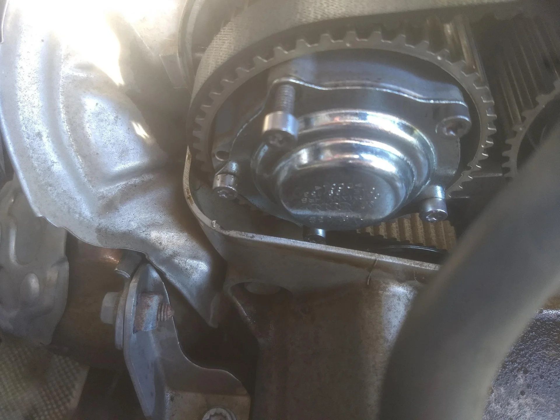

Another issue known on certain VW group engines (1.0 & 1.4 TSi) is the cam exhaust variator bolt unscrewing themselves, causing a rattle. Normally an oil leak around the cambelt area is a telltale sign of this.
Hmmmm. Ok mate, I'll get it checked out.
Thanks for the reply ??
