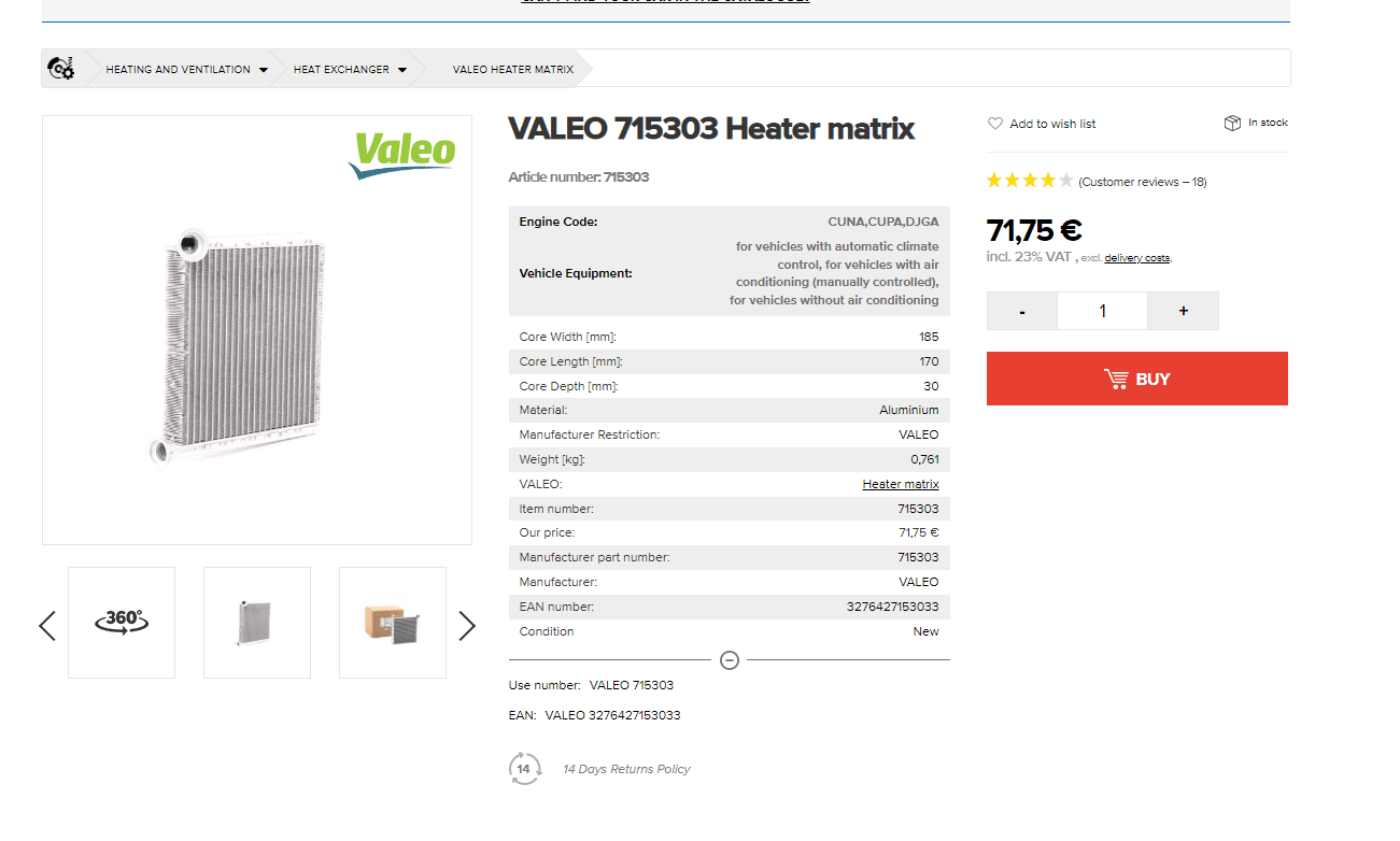

Yep - that's the same that I fitted:
It's a like for like replacement.

I bought my matrix from Europe due to lack on UK stock. Cost me about €90.
