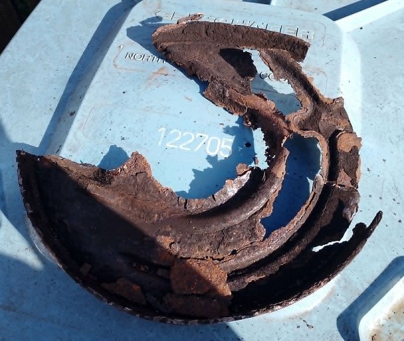

I pulled the back right wheel off to have a look at the ABS sensor. Look at the state of the splash guard! The ring looks perfect, I cleaned it up anyway, but what I think is a possibility is that a bit of that splash guard got stuck in or near the sensor and tripped it up. The whole guards was lose and falling about. It ripped right off with little effort.
Cleared the codes and the lights stayed off during a short run. Not conclusive, see what happens when it’s used more.
What’s annoying is that I put the car into the dealer last year to get the rear disks/pads changed as I couldn’t get the calliper carrier bolts out. They were rusted to bits. Specifically asked them to change the bolts and they didn’t, they took off the hub instead. They must have seen the state of the guard and they just left it. And now I can’t change it because I can’t get the carrier bolts out! :0(

I see metallic debris fouling the sensor and pickup ring quite often.
It does make sense. I'll see what the car does over the next few days and report back.

The rear disks and pads were replaced by the dealer exactly one year ago. That guard must have been in a bad way then, and they've just left it. They had the brakes off, the guard only costs twenty-odd quid. How hard would it have been to give me a call and offer to replace it? My thought is that they would have to wait for the parts and didn't want to be held up so just left it.
