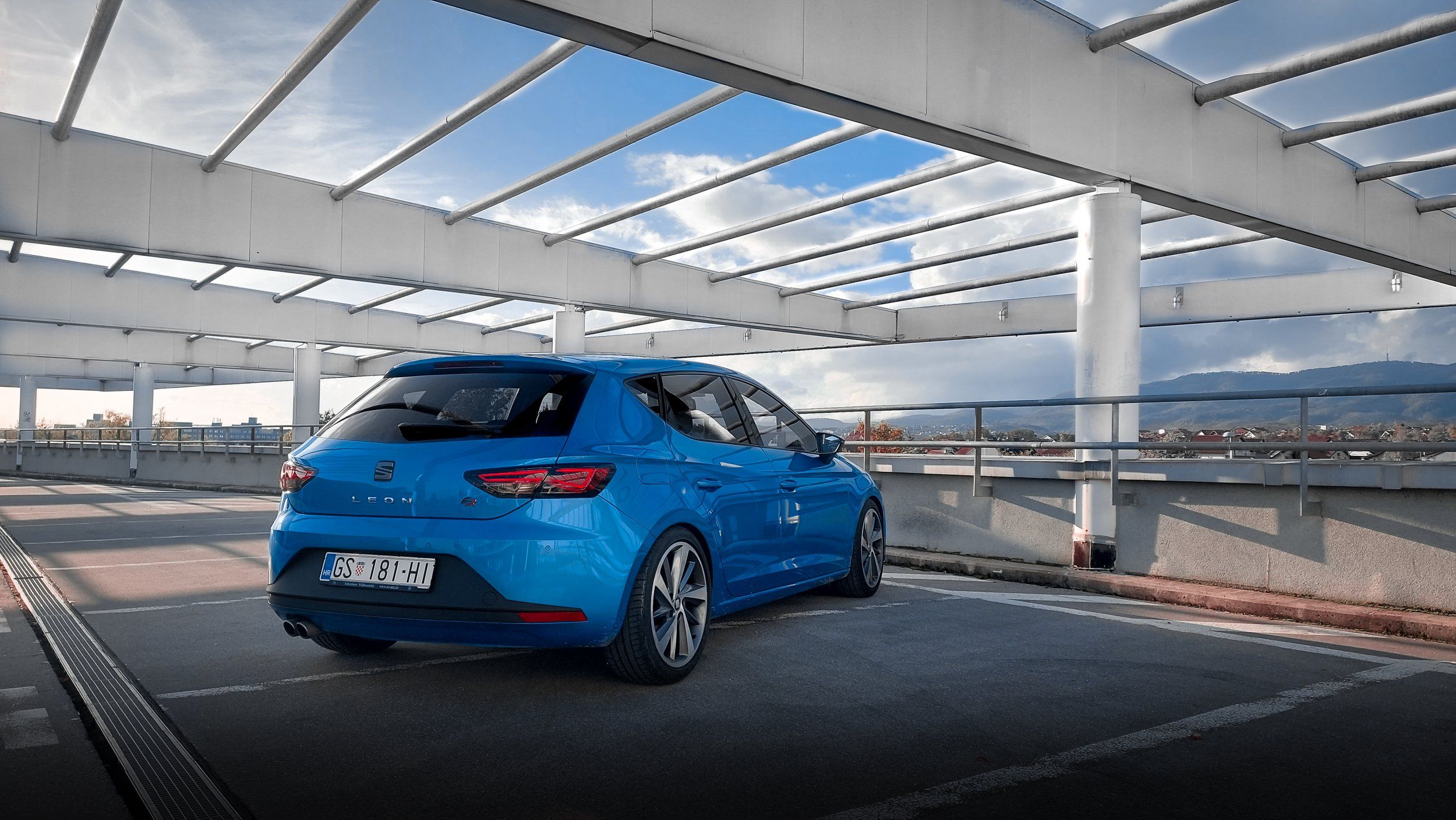

Hi there. Does anyone have any idea what ET would bring an 18inch wheel to he flush with the body?
I have the OEM ones and they seem too much under the wheels arch IMO.
Also if you have photos that would be amazing!
Thanks!

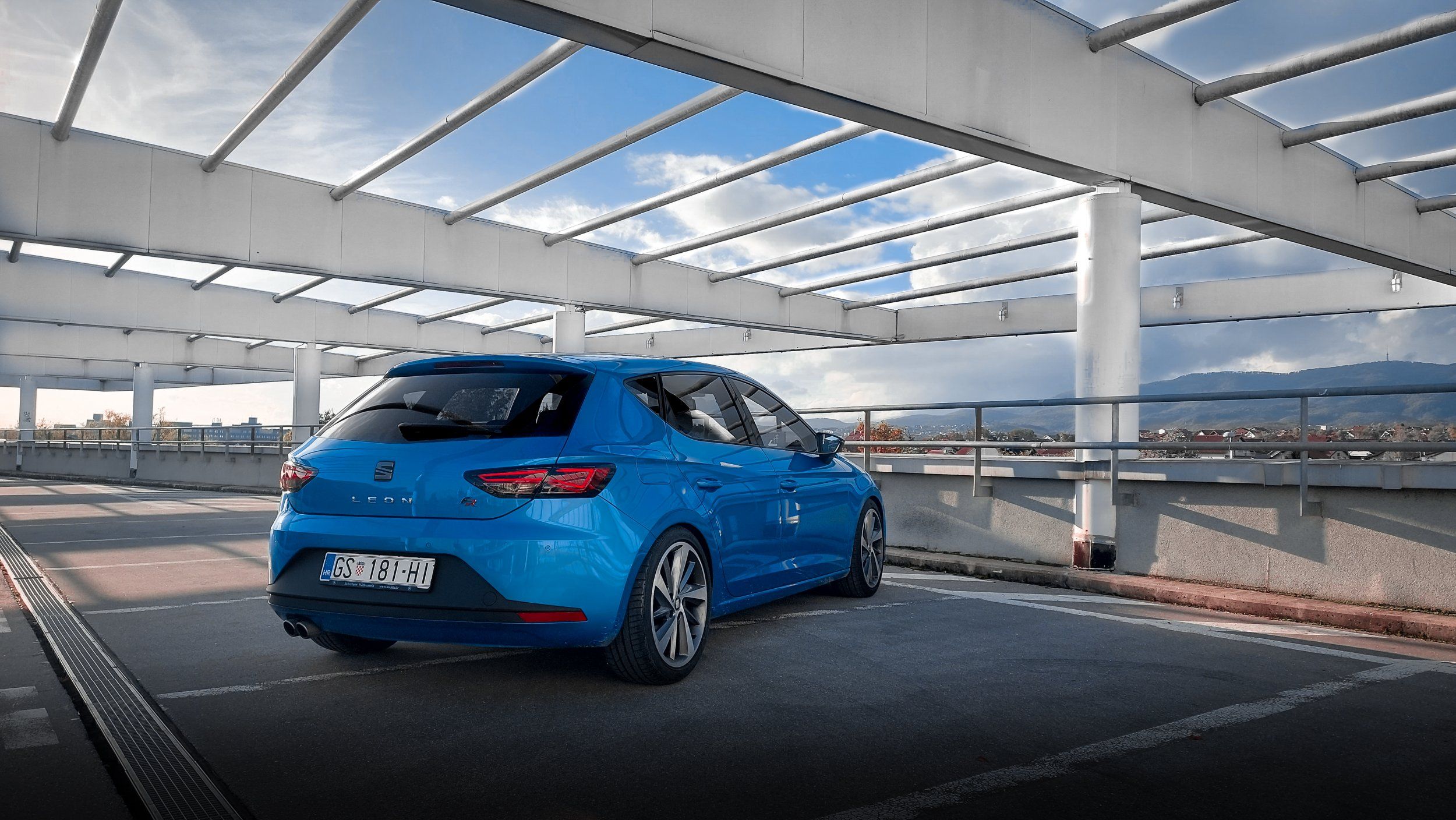

Hello! If you mean to use original wheels (7,5x18, ET51) then I recommend 15mm spacer on front & 20mm on rear. Here is mine (lowered on eibach sportline springs):
If it helps, I’ve got 18X8 wheels with an et45 and they are not flush but close enough.
