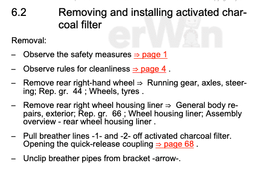

Does anyone know where the evap canister is located? I've heard it's in the engine bay, but also heard it's behind the nearside wheel arch. Also a part number would be great since I cannot find anything online.
