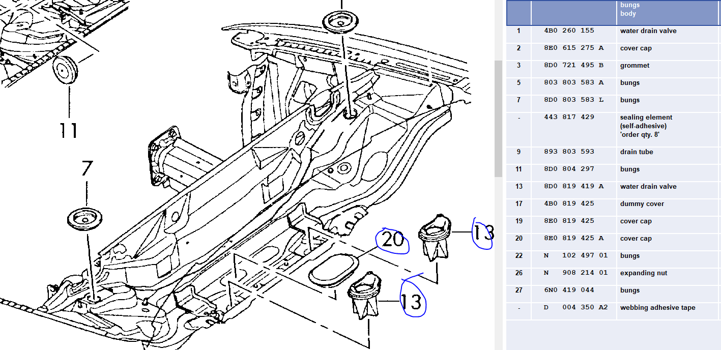

Get a long 2ft thin bar, put steering on rh lock and follow the track rod on the NSF to under the battery from the wheel arch on the NSF. You will see a rubber bung hanging down about 2 cm long, gently push this out. Done, no more water leaks.
Fantastic I will give that a go much appreciated
I reached under the plenum by hand, on the near side, and simply pulled it out.
I’m going to try the same on the offside.

How did you manage to reach under the battery to get to the bung in plenum chamber ?
Gonna be sorting this out today, but i understood it was a battery out job?
Glad I could help, I have removed the battery from 2 Passats and 1 Exeo, its no fun and if you just clear the leaf debris it comes back to bite you, even if you remove the round duckbill valve the hole can get blocked, I have had this happen, just make the biggest hole you can and the oval bung is the way to go.
Hi i did the same, i pushed the bung nr.20 out without getting the battery out. Works like a charm :)
The bungs nr.13 are the original ones for the water drain, but they are more inside located and not enaugh big to drain ewerithing witout getting blocked.
See the pic for Seat Exeo from ETKA 7
