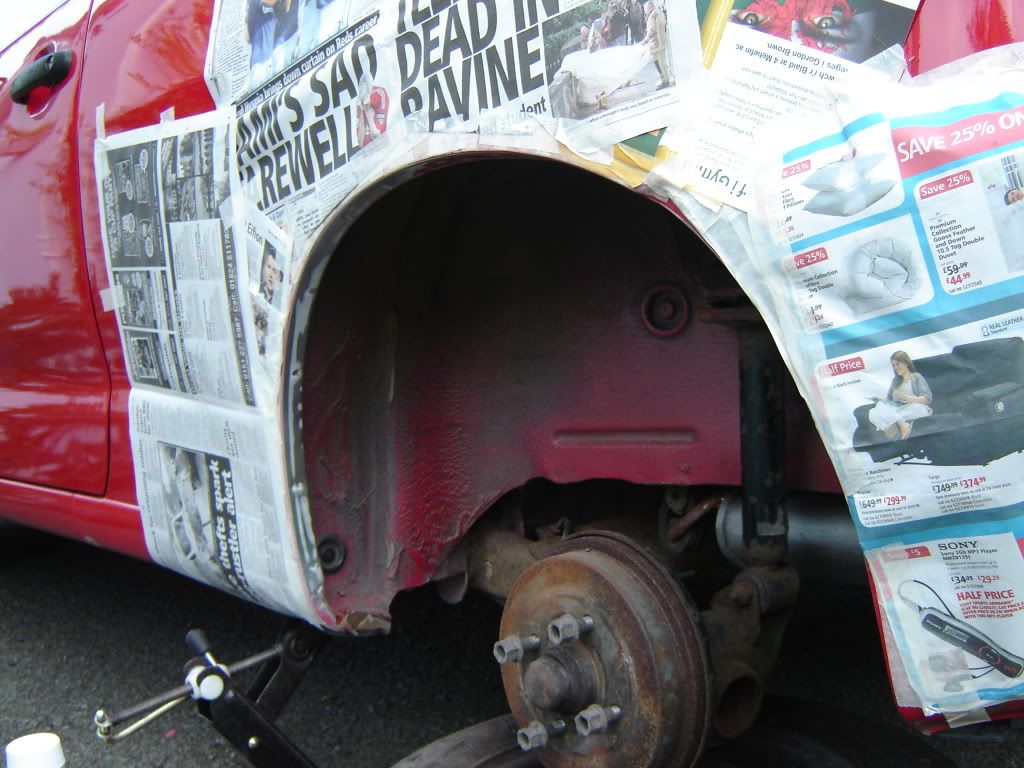

That bottom metal bit (covered in newspaper (bottom right)) kinda sticks out doesn't it, that's my only concern...
And the cutout for the exhaust on the new bumper, (getting a double backbox soon), but will you see the olf red skirt through the cut out?
Not if you *persuade it* to hide out of the way ;) (the exhuast bit I mean)
the rear bumper should fold over the metal skin of the rear arch and if you run a bit of Silkaflex around the edge and then use self tappers it should sit over the edge quite tidily
Wont bulge out at all will it?... I was thinking of getting the newer arch liners... Sorry to be a pain, it's just, I'm getting the arches done etc, and want it to look pretty mint eventually...so I want a pretty decent looking job :)
mine looked ok (unfortunately, Ive no pics of it from an angle that shows it properly, as ive only few pics of the old cars on this lappy) As I say, the silkaflex/self tappers did their job ;)
