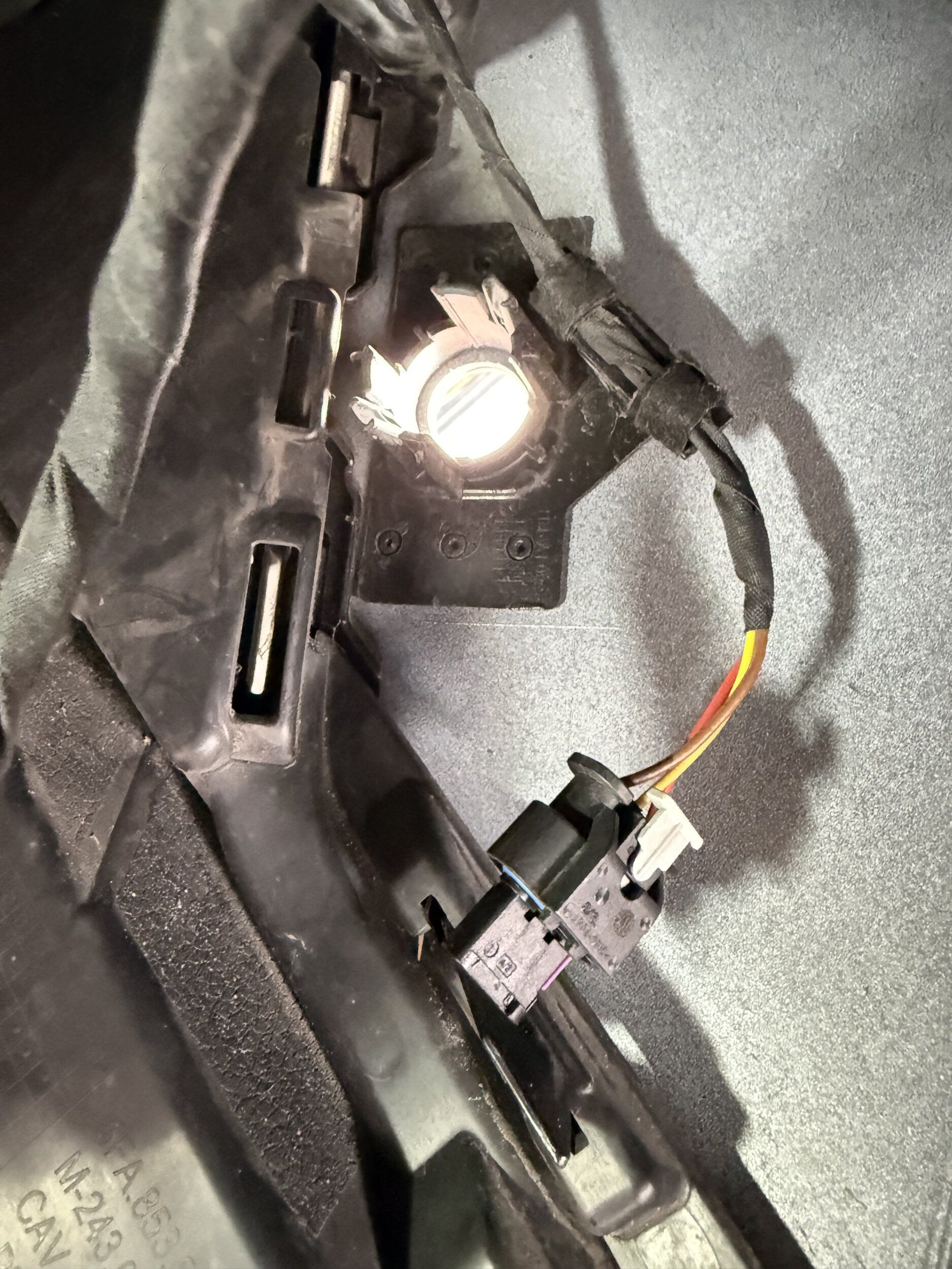

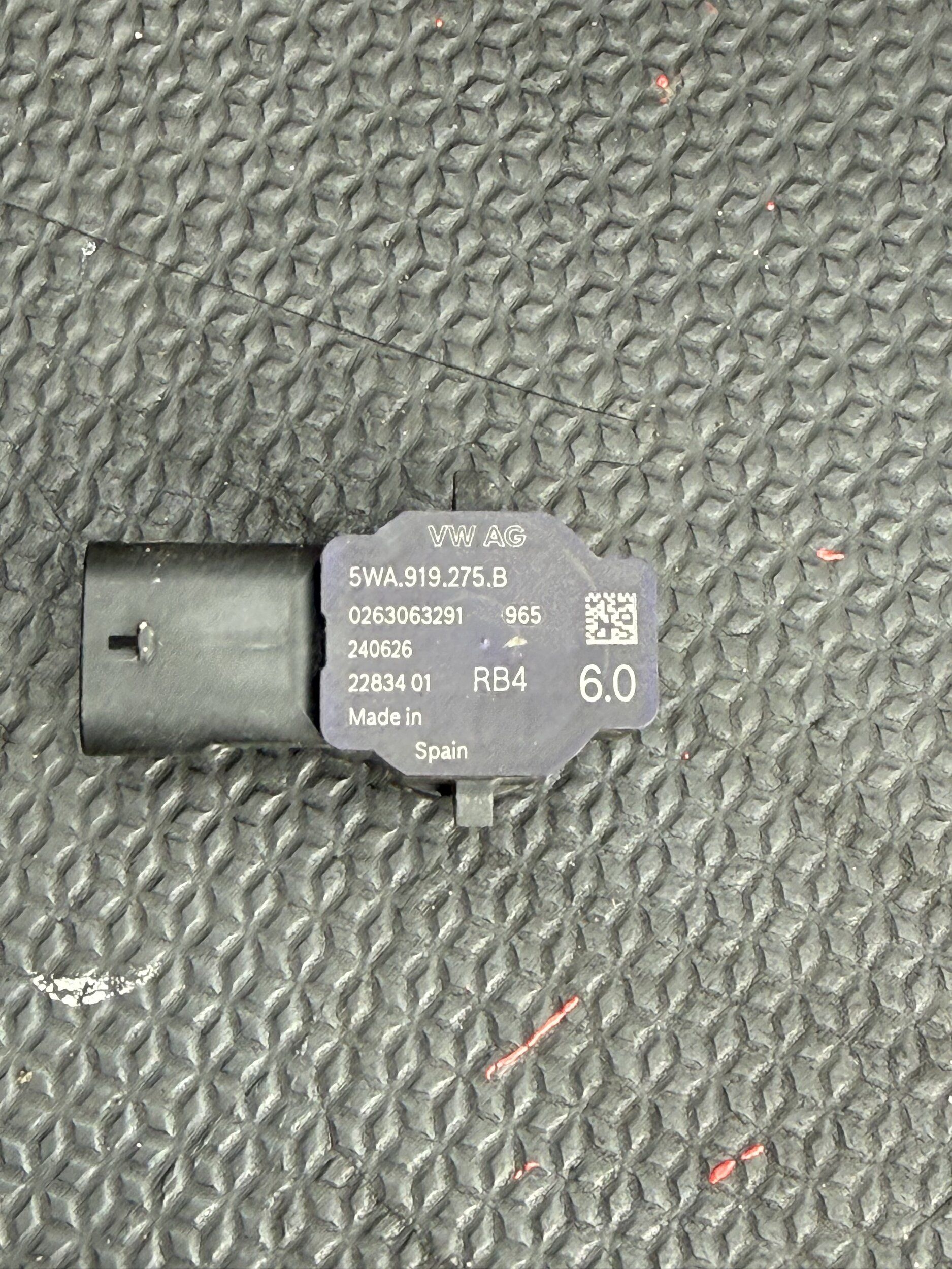

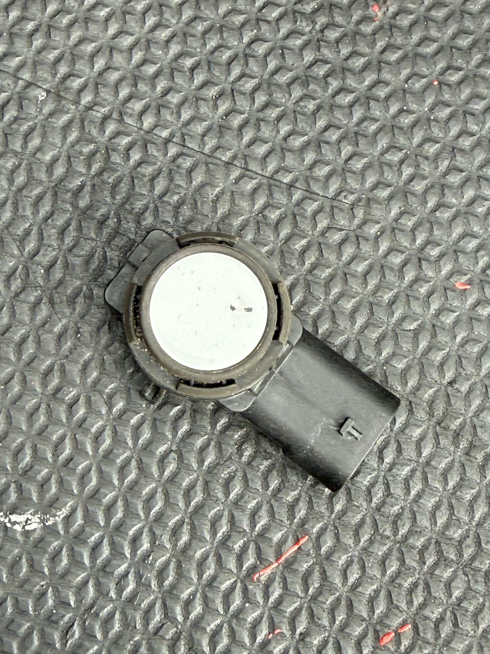

Does anyone know how to replace the outer parking sensor on the facelift models? I’m getting the clean parking sensor error.
I’ve ran obdeleven and it’s shows a fault on the right parking sensor which does have a tiny stonechip.
Would prefer to do it myself if possible rather than spending hundreds at the dealer.
Turns out it’s not that difficult.
I removed the wheel and the arch liner, and you can access it from the back. Just need to order the part now.
The centre ones would probably need the bumper to come off so glad it’s the outer one.
