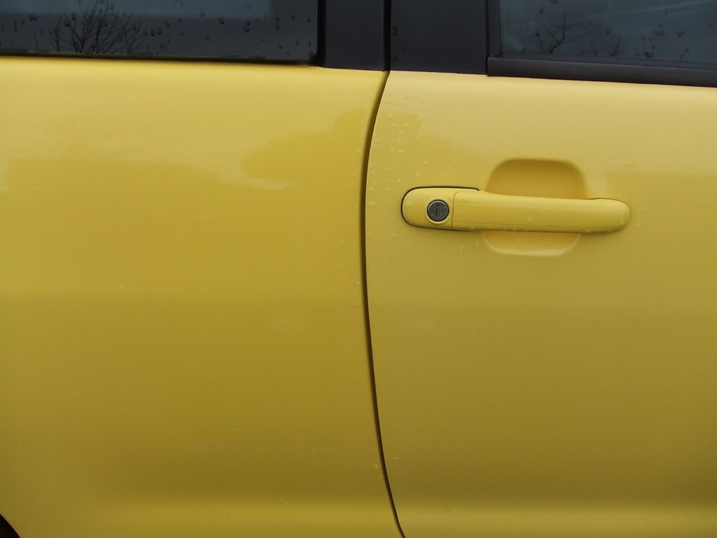

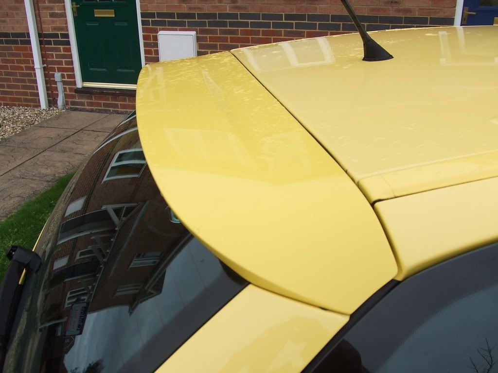

just wondering what can be done to get my yellow seat ibiza cupra back to its original colour all over. The car has faded in places i took it to my local valeter and he said that the car could not be buffed up as he could not get to the paint because of the way the car was originally sprayed, something to do with the lacquer they put on it. he said the only way i would get it sorted was to have a full respray
i have a couple of pics to show you guys
any sugestions would be great
cheers
I hate to say it, if its got clear coat on then there is nothing sort of a respray that can be done about it. I went to see a guy who had taken stickers off his Cupra as he wanted me to machine the faded paint back to the colour where the stickers had come off.
After explaining it wasn't possible, I ended up machining the bonnet to prove my point, he ended up getting it painted :(

This is not the first yellow Seat I've heard of suffering from faded paint recently, those pictures show it to be really bad! I haven't seen any other colours do it though.

It won't work like that because the paint you are talking about was called Single Stage, which means it has no clearcoat (laquer) over the top, so when you use an abrasive polish you aer removing the dead top layer of oxidised paint to reveal fresh paint underneath.
On paints like yours the clearcoat seals the colour in, so if UV light has caused the paint to fade underneath it, there is no way you can revive it.
