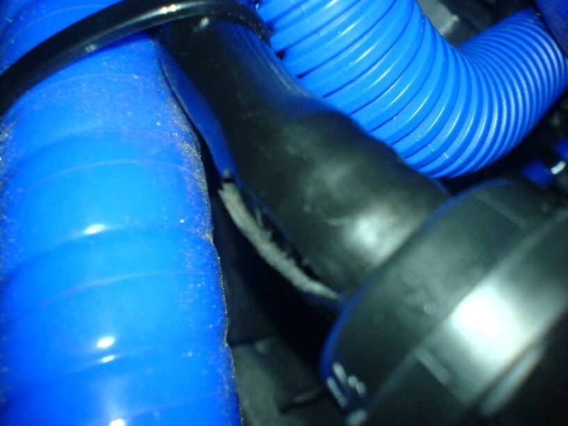

Yeah ive checked it mate, looks fine. Was replaced a few months back under warranty after splitting like yours. Ive checked over and over for leaks but not found a sausage.
All was fine till i had the ko3's and milltek downpipe fitted, which made me think it was a fault with the turbo itself or the actuator is set incorrectly. Im just stuck for ideas now...

A standard k03 will hold 11psi at 6k.
Olly, check the intake temps with vag-com. From your logs on block 114 it looks like the car is defo pulling back, go careful until you've got stage 2 fitted.
Hi Martyn, i dont think its heat related to be honest as im running a fmic and havent seen temperatures over 40 degrees even after a few back-to-back runs.
Maybe its pulling back due to fueling issues as im still only running 3bar at the moment?
Any other suggestions?
Thanks Ollie.
Thanks Ollie.
Ollie, it'll pull back on anything it's not happy with not just temps.

:lol: at Baz. Martyn thats what i mean, im sure its pulling back, but i dont know why. Thats the problem. Im just hoping things will improve after the stage 2 remap on friday.
