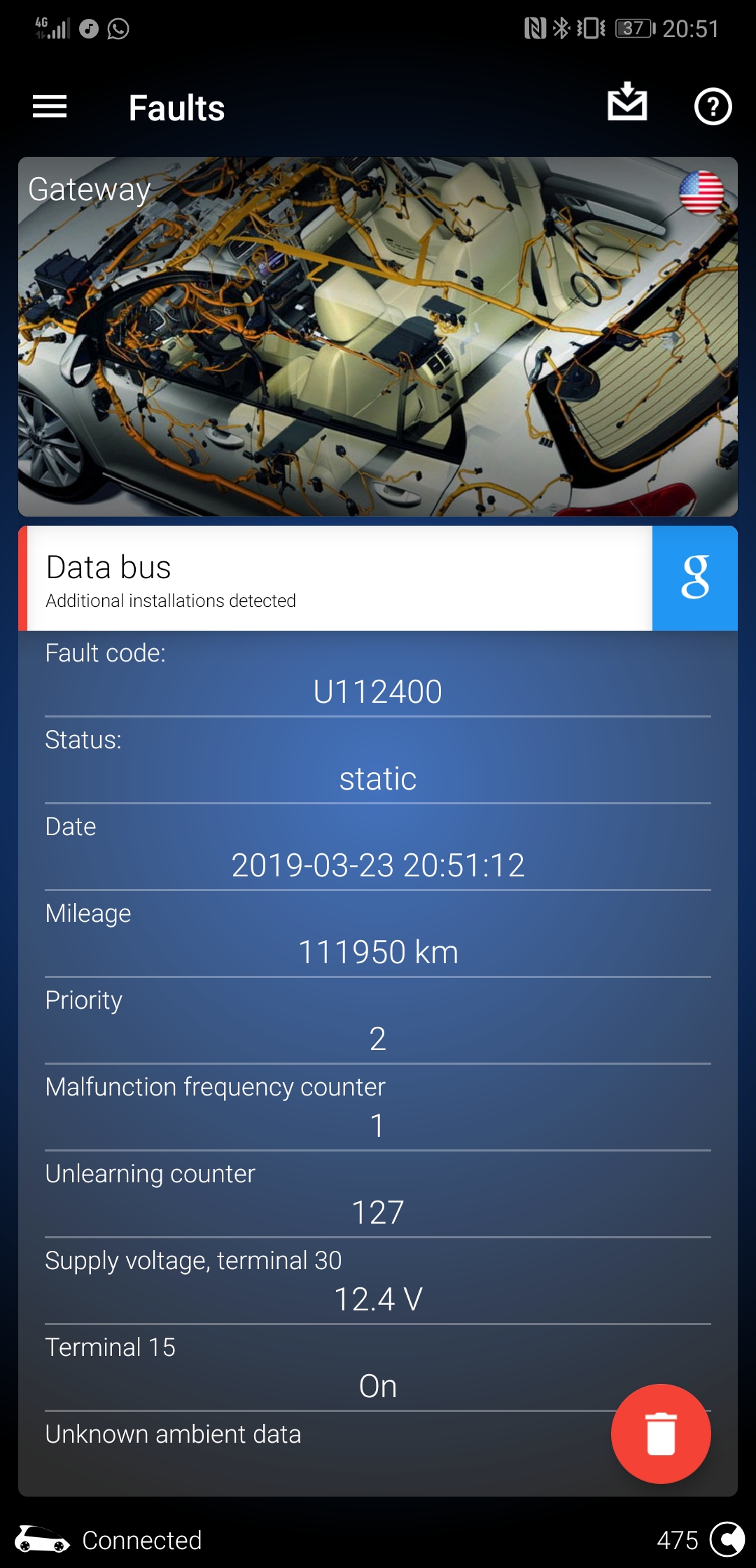

Would any one be able to help me with an error code I have. I recently bought my Seat Leon FR and got a OBD11 and it shows the error code U112400. I tried to clear it in the app and it doesn't leave. Any help would be greatly appreciated
