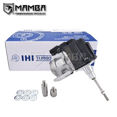

The actuator was part number 06K145725K but its no longer sold separately
There is a listing for it here - https://www.ebay.co.uk/itm/405155017284?_nkw=06K145725K&itmmeta=01J5X8C07KZ9B0RADGAK95BP83&hash=item5e551ef244:g:J14AAOSwILBmtenm&itmprp=enc:AQAJAAAA0HoV3kP08IDx+KZ9MfhVJKm1YkhTbOj3MB6UgEsCHFv5ok5Z/EWTK0PKRDYuhPtv28iYvQISIXryJ9JtKByOMqPfIbzP/QNXVld9hVxcOjkDq/S3x/ifZeNX8FigVQtAUIot676mWrAiTZBUO2/qcr0RceBEh5g2crpGJ12gTQOCLSmG3+o1BfoAhmpzK67zpQ4eb/8tFm9WenYjFYJtTW8SuGSyIhk6hEvkzIDtX4ULkVqzX5nhH0avIdr3NKqCxf4TlXyCXtHm+HqZCGmMPNM=|tkp:Bk9SR_CDsKivZA
Or MAHLE do a multi unit actuator listed as a replacement

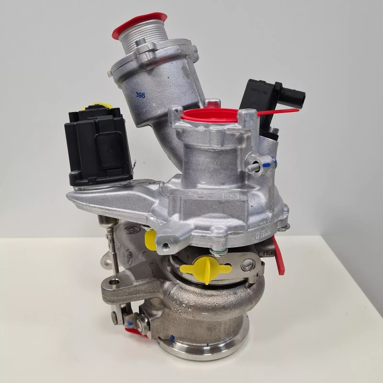

Yes, This was my original plan, but having had three very thorough look s and feels around the engine bay, it doesnt exist on my car, hence the apparent need for the whole turbo to be replaced according to SEAT? Has anyone else had the same experience?
The turbo unit should look like this. ( the actuator is on the left side with the rod coming from it )

Hi Deano - thank you so much for this which is so helpful.
I can now feel (but not see) where the actuator is!
I gave it some lubrication in the form of GT85.
So my questions are:
1) Is it possible to make the repair by installing a new actuator (as above), and is there any special proceedure for 'charging' the new actuator? and/or
2) do i need to buy a new turbo unit SO6K145721QXXP as recommended by SEAT (and does this include a new actuator)?
3) why did the main dealer say that SEAT no longer sell the the actuator 06K145725T ?
In either case it would be supplied and fitted by an independent specialist.
Thank you again for being so helpful. Tony
1. sorry - don't know -would guess you just need to match the rod length.
2. That would be one fix and yes they come with the actuator.
3. Guessing SEAT no longer sell the part and the aftermarket suppliers have stepped in.

The only thing my car had was the fault with the turbo actuator that caused underboost fault, but I´ve been solving tha problem readjusting during the last 3 years the turbo actuator rod, unscrewing the nut, spinning the rod until the actuator voltage reading on the diagnostic tool obdeleven was between 3,5v and 3,8v and later screewing the nut again.
It has worked 3 years, but now the rod can´t be sppined any more because I think the actuator has reached its final peak, so I´m going to change the actuator and readjust the new one.
Thanks to the good info of this thread I´ve been able to find the correct Mahle turbo actuator part number for my car (06K145725K, now with the last part namber 06K145725T) and have bought it to and american supplier who is sending it to me to Spain from China, staying right now waiting for it to arrive here to Spain.

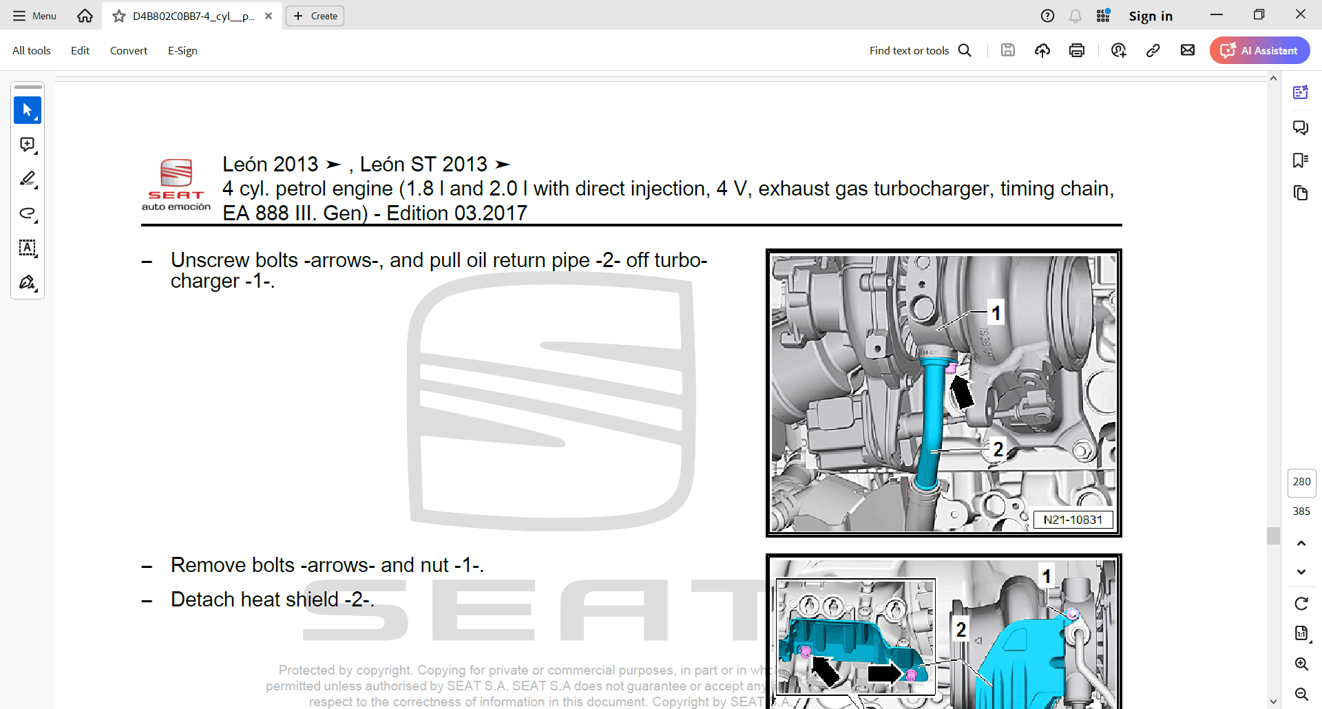

Now what I would like to find to be able to instal the actuator correctly is the guide of this car, because I´ve found here the links in the forum (https://www.seatcupra.net/forums/resources/leon-mk3-official-seat-workshop-manuals-link.24/) but they don´t work anymore.
I mean, I need exactly the guide from where DEAN0 took the photo posted above but with all the pages.
Please, if somebody can tell me where I can download that guide, exactly the "D4B802C0BB7-4_cyl__petrol_engine_" part, I will be very grateful.
