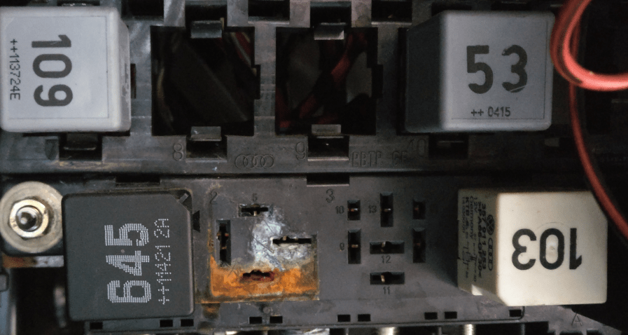

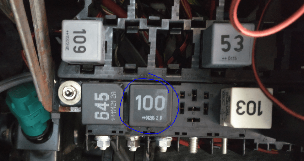

So after replacing my Hazard switch which is a common failure i still lost my wipers , indicators , washers and fan blower.
My fix was to replace the 100 marked relay below the steering column which was all corded (Pictures in post below)..... Its likely it could have been this before i broke my hazard switch.

Relays under dash, i think it COULD be the X contact / 100 ?

I managed to fix this issue by swapping out a spare relay i managed to find, When i scrapped my B7 Sline Avant i kept a load of fuses and relays.
Looks like relay marked 100 under the steering column was corded and likely my switch was fine all a long.... I have about 5 relays on order which will be here this week which is sods law but not a lot wasted in the grand scheme as i need a car!
Anyway here's some pictures
