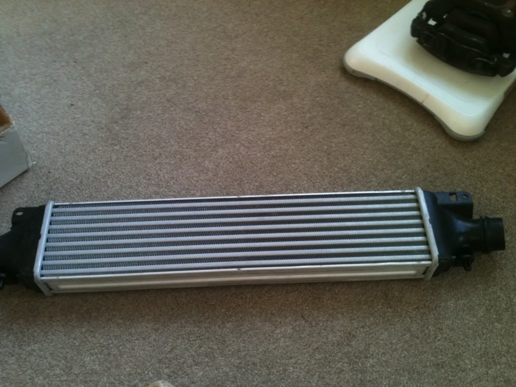

I picked up a FMIC last night really cheap:funk:............ but its not for a leon, infact its not for VAG at all. It came off a Corsa VXR. :whistle:
I am unsure whether to pursue trying to fit it and get it working or whether to go towards a TX kit. Please help

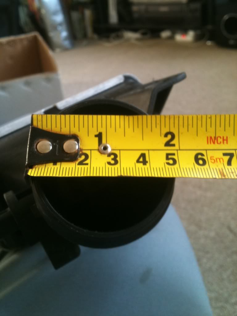

I know the guy I got it from ran 60mm hoses on the kit, so thats the first qusetion i guess, is that going to be suitable for the leon or will a smaller hose starve the engine?:shrug:
The cooler measures:
Core : 590mm
Overall length : 850mm (tip to tip)
Height : 130mm
Depth : 52mm
Im really hoping its going to work and not cause any trouble but want your opinions first.
What I dont want to do is fit it for no gains and then end up buying another.
So.............Hit me with it guys! :think:

That looks as useless as the original IC. After all the effort you made, I wouldn't even bother trying to make that fit.
Toyo / TX / Custom ftw. I might soon switch to the turborevs IC, made for the mk4 golf, it's on eBay. It's a bit more tidy when it comes to the pipework then the Toyosports
Plus @ 232Bhp, you've maxing out the K03S / your car's set-up. Temps must be soaring.

i would say any front mount is better then the single sidemount, so if you have a "free" FMIC upgrade why not do it.
you only need to do some pipe works, and if you want a better/bigger size intercooler later, then you have the pipe work done, only need to adjust for the new cooler IF you want bigger later!
There are a few second hand intercoolers floating around on the web suitable....

The one Ive got is massively wide and wont really fit.
Dont think I can be bothered with the hassle and its really not very big :(

Buy/borrow my twin intercoolers as they are coming off when my garrett core arrives.
Cooling on them will be better until you can afford a decent FMIC instead of scrabbling bits together.
Ports on the corsa cooler are tiny and major bottleneck, probably less volume too

I was trying to work out total volume today and I'm pretty sure the vxr one is smaller hence it's on eBay now lol.
