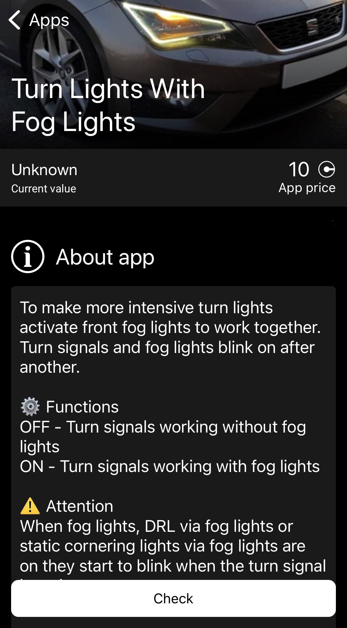

Its a pre facelift model 2014 leon fr and What I am trying to achieve is when I turn the left/right signal on for the fogs to flash with it. Thank youI was just about to post the same as @martin j.
In summary, yes it would be possible via coding - fronts only as there is only a single fog bulb in the rear cluster.
